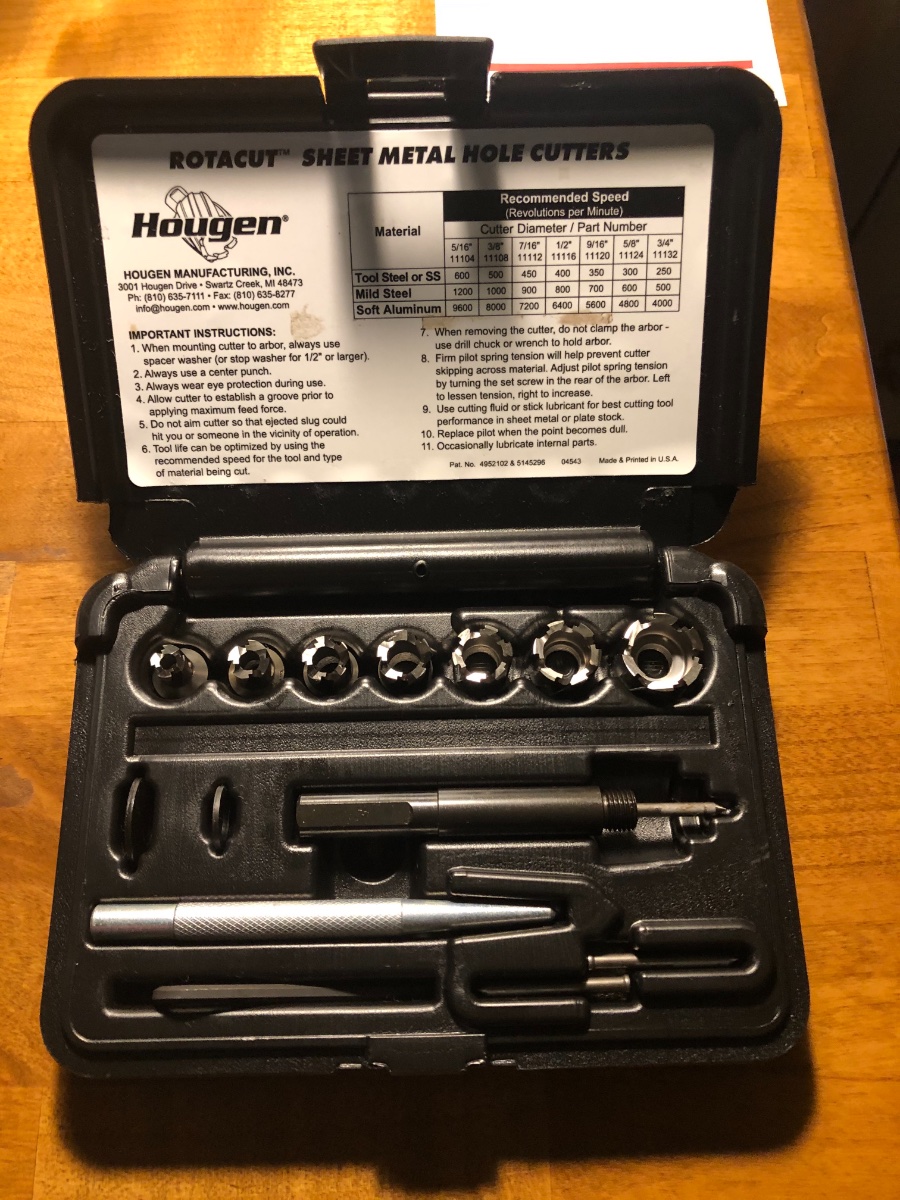

Another option after removing the head and hopefully you have a straight on access is to use a Hougen Brand Roto-broch. It is a hollow drill bit with a pilot. You can remove the pilot and carefully use either a 3/8" or 7/16' bit just enough to get around the broken piece. It has saved me many of times. Hope this Helps!
Hank
Hank
- Posts: 5603
- First Name: Henry
- Last Name: Lee
Re: Broken head bolt
They will not drill out the easy out extractor but are very sharp and of a quality to deal with the broken bolt.
