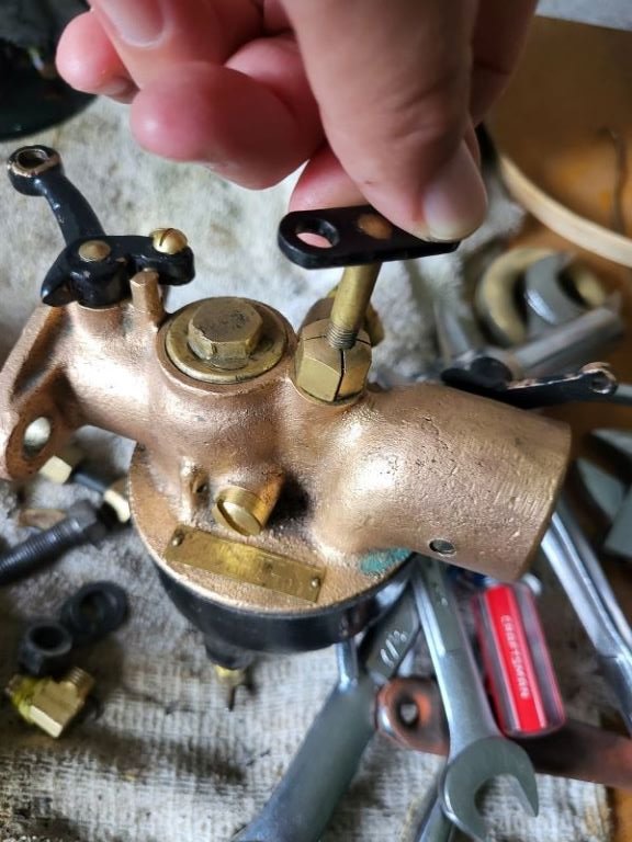

I'm trying to set this Kingston Carb, however, it wants to idle at a fast speed. I've cleaned it out and replaced the original needle/seat with the new ball bearing style. It wouldn't adjust right. I recently went back to the original needle/seat and it still idles fast. When I first started, I set spray needle at 1 1/2 turns, car started. I lowered the throttle to idle with spark fully retarded. I then adjusted the spray needle from lean to rich until I felt it was smooth running, but fast. I tried adjusting the throttle adjusting screw on top, still running fast with the lever bottomed out on post. Not sure what I'm doing wrong, any help would greatly be appreciated. I normally run a Simmons Super Power but found a crack in the casting that started to leak. Trying to get Kingston running for 4th parade.
Thanks,
Matt

Sounds like you may have a vacuum leak somewhere, check the carb flange and the intake manifold seals at the cylinder head.
