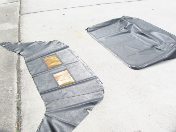

I have read a lot of posts about top installations, but I am unclear on these points which are appearing as I start the installation of my Classtique top. I purchased this kit 10 years ago and did not unpack it for a couple of years. I have been advised that it will have creases in it for life, but that is a chance I will take.
WIND-BREAKER
My old top had a wind-breaker that spanned completely across the front bow.
The new wind-breaker does not span across the front bow.
Old and new wind-breakers together:
Asking for experience here: Is the shorter style wind-breaker enough, or do I need to have sections sewn on to span across the bow to prevent air coming over the side curtains when they are installed?
REAR BOW ANGLE/HEIGHT
I have read that the rear bow should be plumbed even with the tack rail on the body, making the rear curtain perfectly vertical.
I have also read where the rear bow should be angled further back, which would make the rear curtain lean slightly rearward.
I welcome comments from those with experience in this area.

You have the windbreaker on wrong. It should be on the bottom side of the front bow and wrap around the front and back of the bow. The flap with the snaps should hang down in front of the windshield to block the wind between the windshield and top. Snaps are for the side curtains to fasten to.
The rear bow should not be plumb with the body.
My advice would be to stop and get some good instruction befor proceeding.

The windbreaker on my 1924 top is like the shorter one that you have in your "new" kit. It has a snap on each end that the side curtain snaps onto to help seal that corner.
I chose to angle my rear bow such that a plumb bob hung from the rear bow fell one inch behind the body sill. I'm happy with it, but two inches might have been even better, IMO. :)

I recently installed a top on my ‘26 Runabout. I started with Cartouche and finished with Classtique.
The windbreak you show straddles the top of the windshield frame and the Vee is supposed to line up with the windshield wiper hole in the metal frame. There is no snap on the outside corners; your side curtains install on the back side of the stanchions and never touch the windbreak as they did in 1925 and earlier.

The long grain in the material of the "original " windbreaker you show is not original as used by Ford, so having it fitted is a later error.
The front corners are a little more difficult to make tidy. More than once I have seen the material drawn down firmly and tacked to the bow, which makes the bottom hemmed edge low. Then the top material was cut backwards for 3-4" so the bottom edge can be lifted back into line, and tacked into place. The cut and the tacks are then hidden by the binding. Tom's corner looks like the cut step has not been done, so there is a tuck to get the bottom line in place.

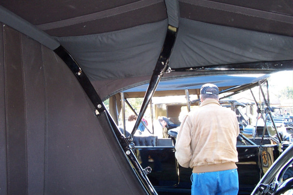

That's sound advice Jerry. It's true that the front bow side arms move very little compared to the rear bow.
I'm looking at pictures of the old top, and it does appear to almost match the windshield rake. I really hadn't ever noticed it, not until a new top had to be fitted.

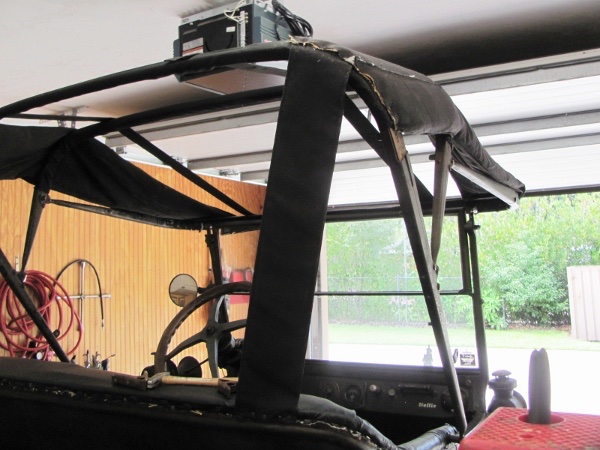

Eric
Those pair of rear straps from the back bow to the tub wood trim strip are wider than 2", and are made of several pieces of fabric with sewn edges. Reason is a lot of stress on those, as the top is erected, and when folded. (1926 pictured)
On my '23 cut-down pickup, worked to fabricate a used '24 top covering, and related pieces, to make a top. You can see the wide rear straps from the seat trim wood to the rear bow. Plain webbing is used for the top straps that run to the front bow. The bow pads cover the curved portion of the bows to give body to the top, and prevent the 'starved horse' look of a top that doesn't have enough support.
IMG_9297 (600x450) (600x450).jpg (138.53 KiB) Viewed 23 times

Pieces of used '24 top covering, the body and the rear curtain used to mount on the '23.
IMG_9295 (570x428).jpg (105.75 KiB) Viewed 19 times

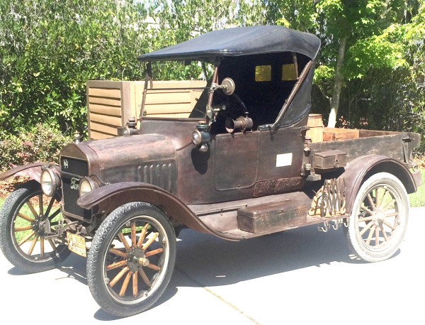

Finished top job. ;)
