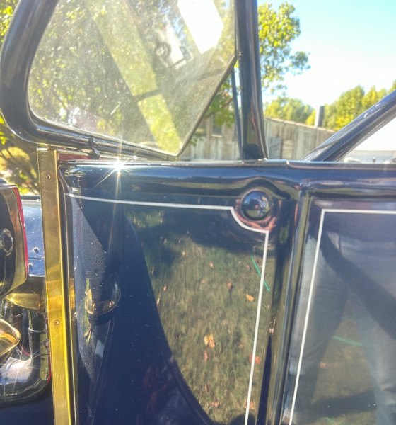

Maybe I shouldn’t air a pet peeve in this thread, but it speaks to the issue. My ‘13 runabout carries stripes that are way too broad, and would have looked better if the striper had consulted period photos. You will never see a top stripe on a ‘13 or ‘14 in period photos where the windshield support bolt is bypassed like this. Originally the stripe would have been low enough to miss the bolt !

By the time 1912 rolled around there was much less pinstriping than earlier years. It is a very, very thin pinstripe, about 1/16" not more than 3/32" located 3/4" away from the bead. (The photos make my stripe look wider than it is) My pinstriper used 3/4" masking tape or painters tape for a guide.
NO boxes on the hood! Pinstripe between the rivets.

Pinstripe over bolt heads, not around them.
No pinstripe on fenders, axles, or frame.
