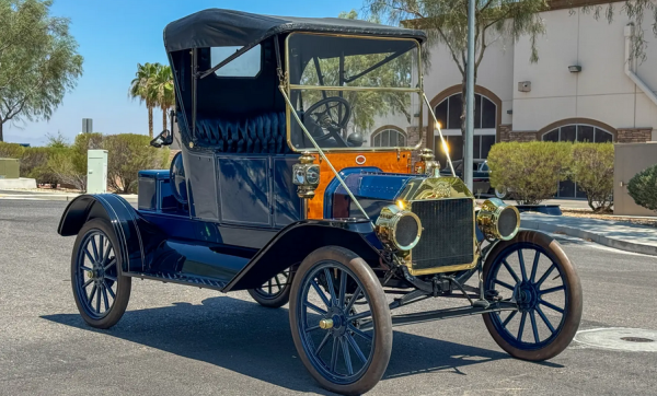

Taking my 1912 Roadster to get it pinstriped. My understanding is that the only pinstriping is on the hood, the back of the seat, and the back of the small "rumble seat." I see some do lower body pinstriping which I am not criticizing but I want my car to look like it did coming from Henry's factory.
Any experts out there on this subject? I have attached a picture of a car similar to mine. It is beautiful, but is the pinstriping other than the hood, back of seat, and back of small rumble seat correct? (By the way, I know the hood striping is not boxed like that originally) Again, not criticizing this pretty car just trying to figure out what was bone-stock from the factory.

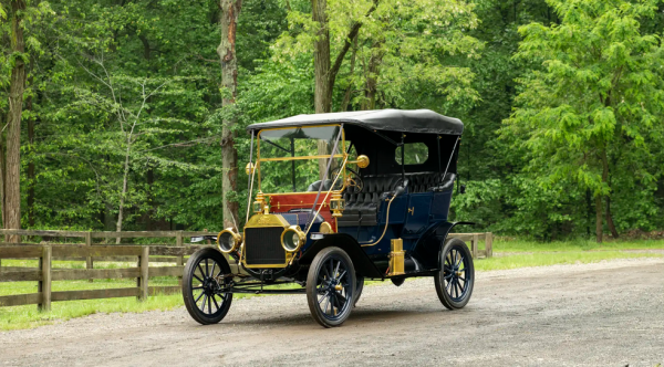

The link below is to the current Sotheby's auction being held at Hershey, in particular a 1912 Touring (Stynoski Award Winner) with plenty of photos:
https://rmsothebys.com/auctions/hf25/lo ... t-touring/

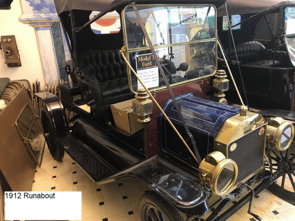

There is also a 1912 Torpedo at the auction tomorrow, here is the link and a photo:
https://rmsothebys.com/auctions/hf25/lo ... -runabout/

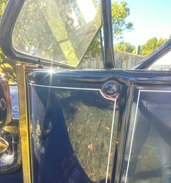

Maybe I shouldn’t air a pet peeve in this thread, but it speaks to the issue. My ‘13 runabout carries stripes that are way too broad, and would have looked better if the striper had consulted period photos. You will never see a top stripe on a ‘13 or ‘14 in period photos where the windshield support bolt is bypassed like this. Originally the stripe would have been low enough to miss the bolt !

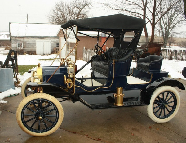

Re: Pinstriping Details 1912 Roadster
This shows only seat backs and front and back of hood.
