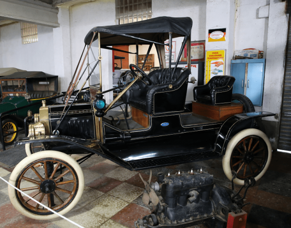

Taking my 1912 Roadster to get it pinstriped. My understanding is that the only pinstriping is on the hood, the back of the seat, and the back of the small "rumble seat." I see some do lower body pinstriping which I am not criticizing but I want my car to look like it did coming from Henry's factory.
Any experts out there on this subject? I have attached a picture of a car similar to mine. It is beautiful, but is the pinstriping other than the hood, back of seat, and back of small rumble seat correct? (By the way, I know the hood striping is not boxed like that originally) Again, not criticizing this pretty car just trying to figure out what was bone-stock from the factory.

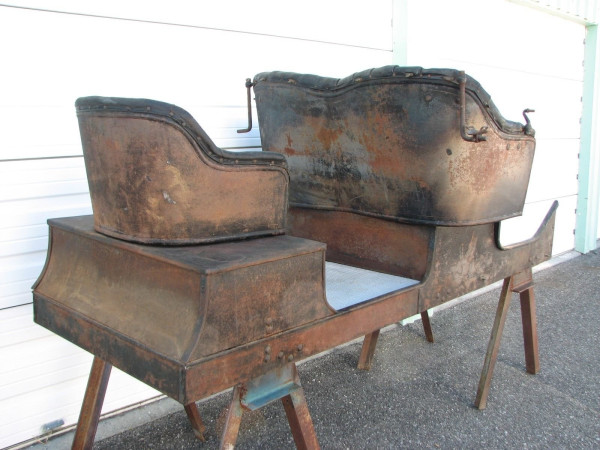

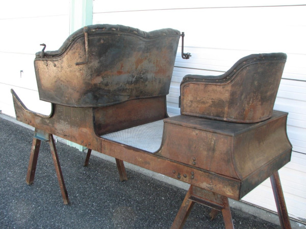

Rich, in fact I have saved numerous photos posted by Dollisdad, and they have been very helpful. I also have an original "rumble seat" or "mother-in-law" seat that has the striping still evident. You are correct, it is almost a hairline stripe, very, very thin.
I posted this in case there was other "definitive" information that I have not run into yet. But I dropped the car off at the striper today, and told him EXACTLY what I wanted: only the backs of the seats and the hood. I shared many of those pictures with him so I guess I am set. Oh, and the wheels will get striped too and I see many use what I would consider too heavy of a striping on the wheels too.

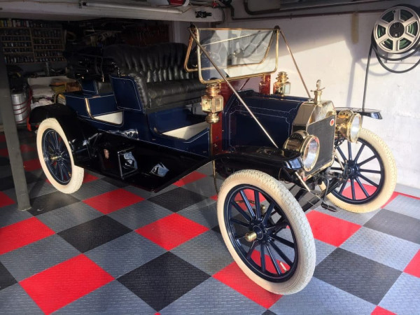

By the time 1912 rolled around there was much less pinstriping than earlier years. It is a very, very thin pinstripe, about 1/16" not more than 3/32" located 3/4" away from the bead. (The photos make my stripe look wider than it is) My pinstriper used 3/4" masking tape or painters tape for a guide.
NO boxes on the hood! Pinstripe between the rivets. No striping on the flat part below the seat:
No pinstripe below the seat
No pinstripe on the heel panel or toe kick.
Pinstripe over bolt heads, not around them.
No pinstripe on fenders, axles, or frame.
One shot medium grey is very close to French grey. You could add a little gold or green if you want. In my opinion, darker is better and a little more subtle. If the grey is too light it will look white.

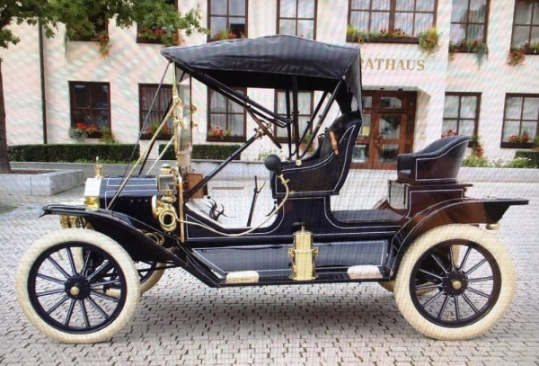

Here is a great example of what NOT to do...
https://billsvintagecars.com/car-1912-m ... llery.aspx
