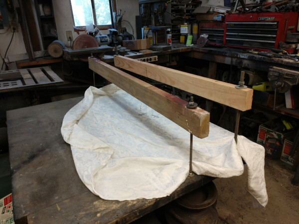

As far as the wood clamps go I bought 4 new ones at my favorite store, but is there a chance on the sewing machine. What model is it, does it have a walking foot, and is it a 1/2 foot? Well It will be easier to bring the car over. Do I need a number or where am I on the list ? Mike

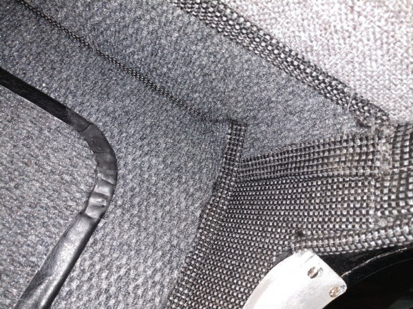

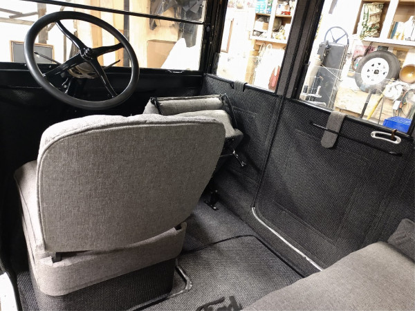

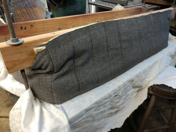

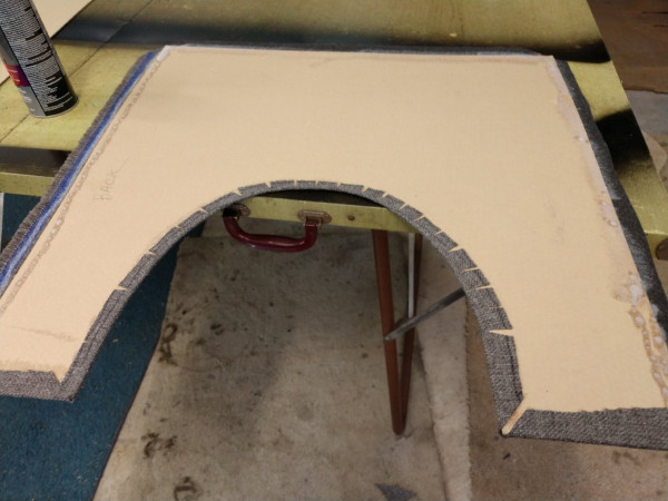

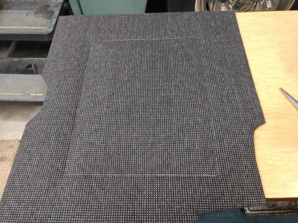

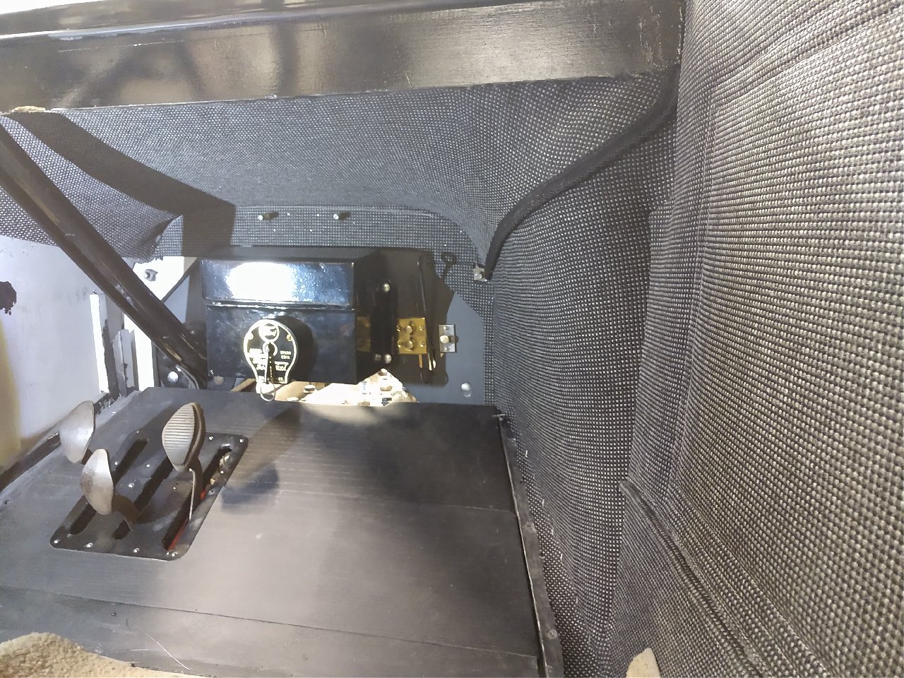

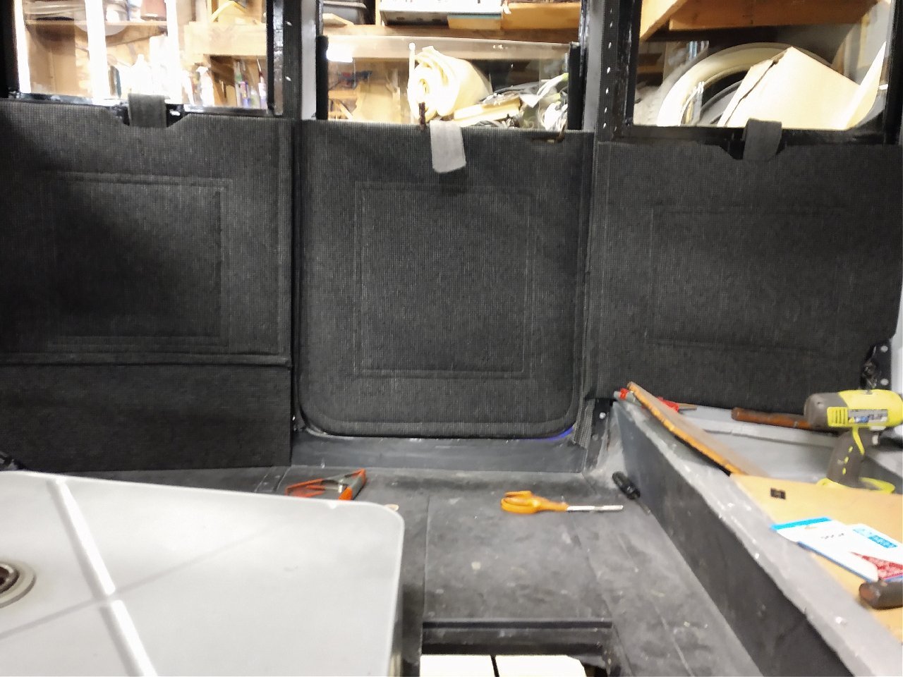

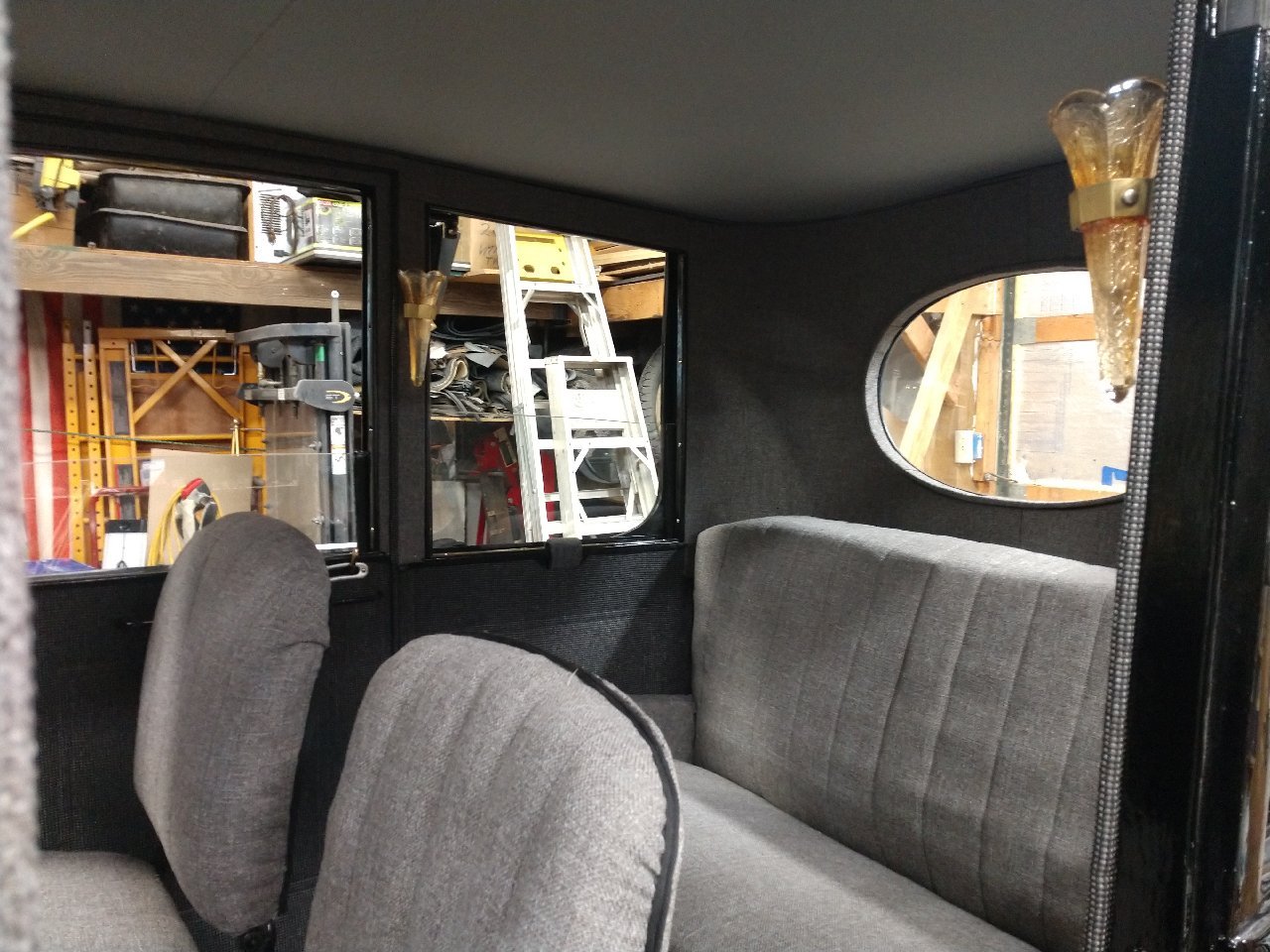

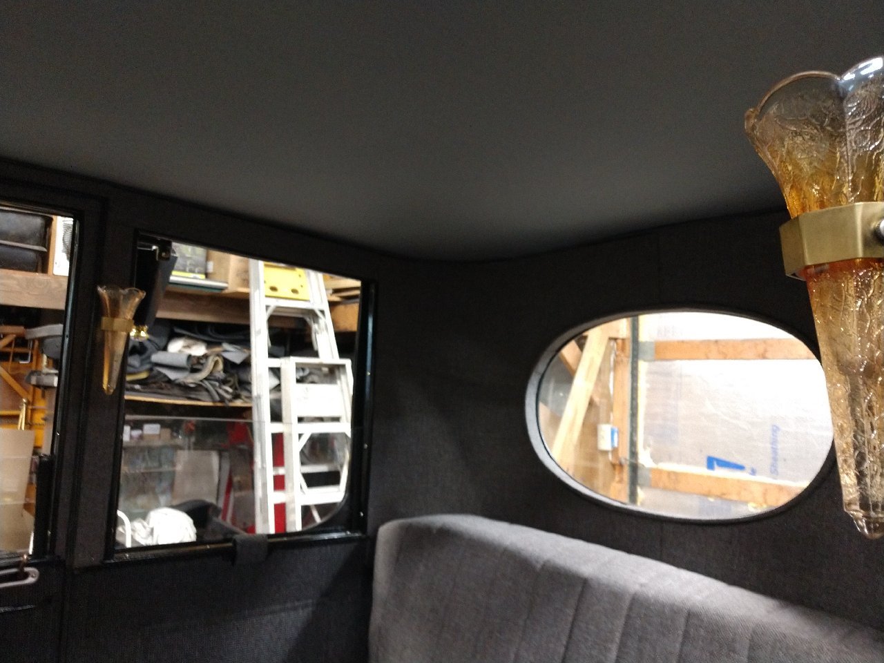

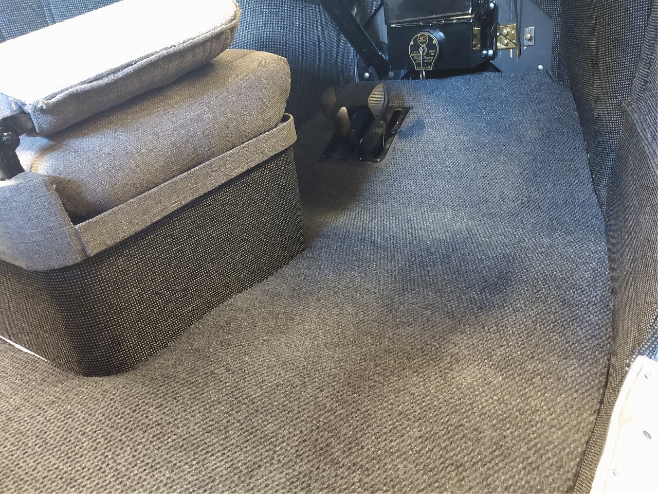

Having no choice, I have to do the interior myself. Many hours of frustration, failure and elevated blood pressure that would blow a stainless steel brake line, I think I have it figgered out. I think I do...

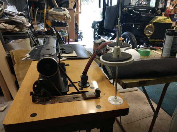

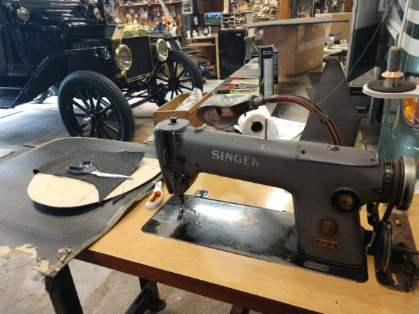

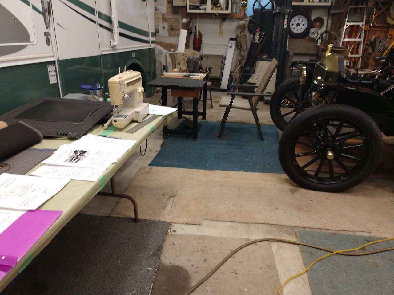

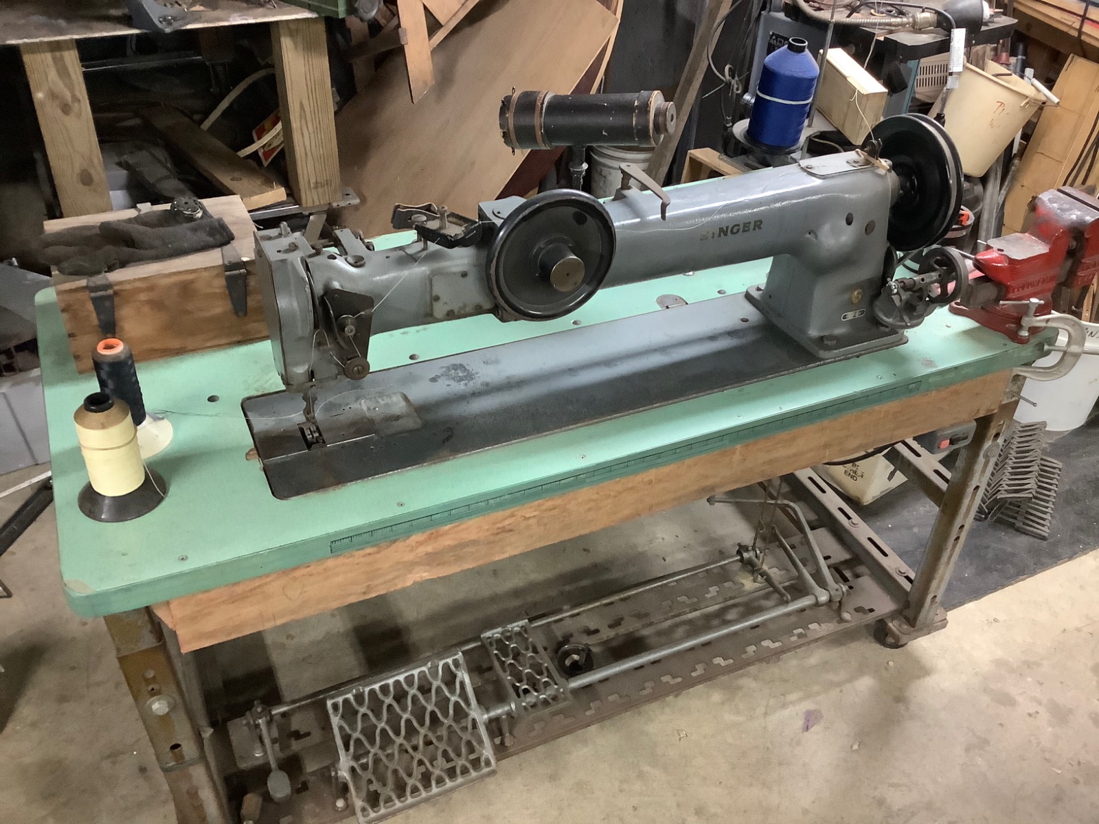

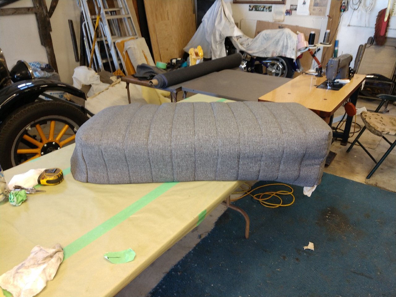

Since we are showing off our equipment, here’s mine. I was an upholsterer in a past life. Most people think size matters, and if so, I win. Don is proof, though,that it’s not the size of your equipment, it’s how you use it. This can all be done by hand sewing, if you have the time, so don’t let lack of equipment hold you back. Beautiful work Don, and you’ll really enjoy the “new” machine.

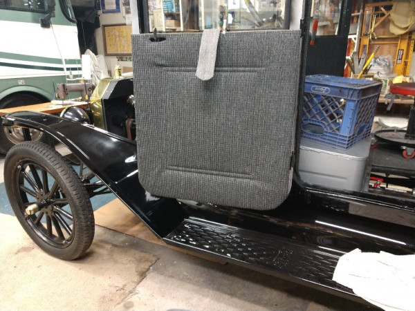

I'm learning that there is a learning curve Tim. But, it's coming along, not perfect but typical for me. You do have "big equipment". !

I just picked up the "Led Zepplin" for this job. Sweet machine for being born the same year as me.

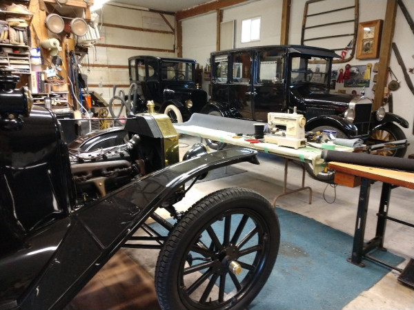

I'm get'n a bit cocky now that I have this sewing machine tuned in....

Funny how you dread doing something because you can't fathom how to go about it. This cowl upholstery has bugged me for months. Then one day you decide its time to tackle it. Turned out the worse part was getting a 66 year old dilapidated over weight body contorted enough and still be able to breathe to operate a staple gun. Now, as soon as the muscle spasm's calm down I will finish the job.[image][/image]

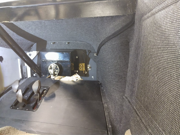

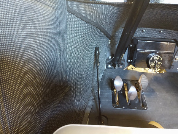

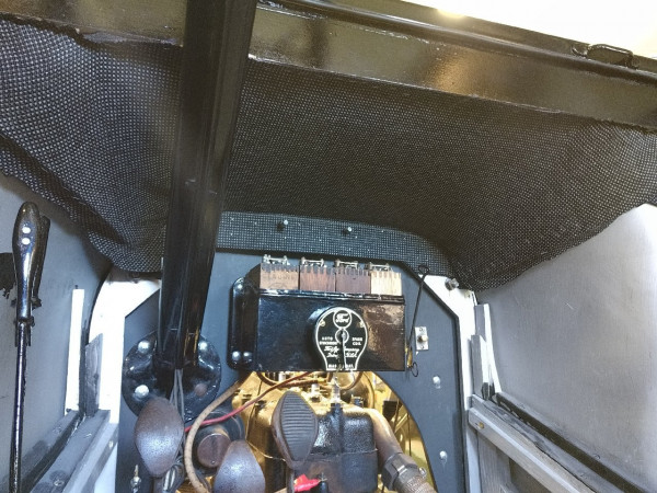

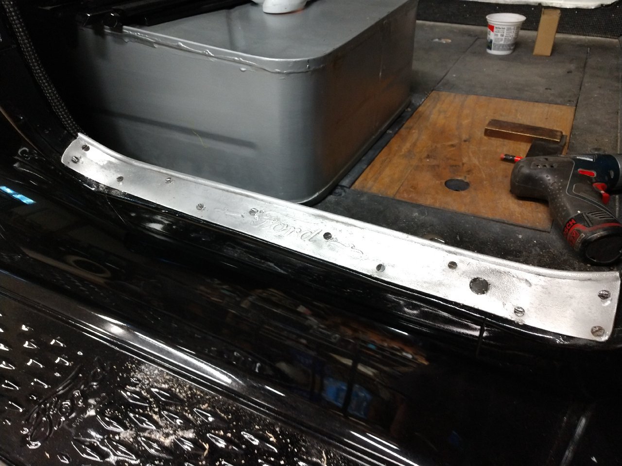

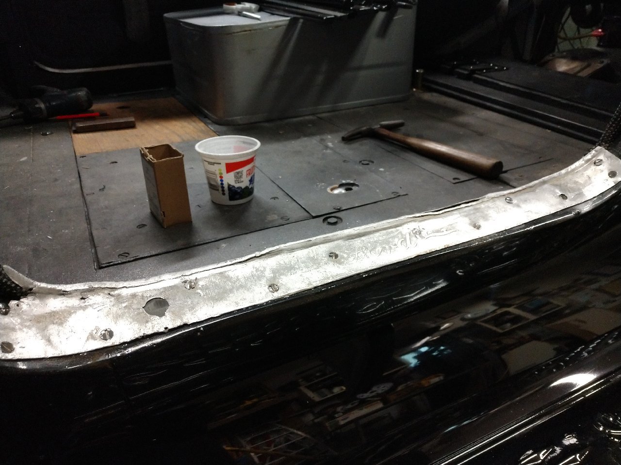

Thank God that's over with, still have to do some straightening out but the worst is over...

Come on Don, Tell us you didn't do all that work with the gas tank already in place! Ha good job. Les Sumner

Re: '16 Centerdoor restore...

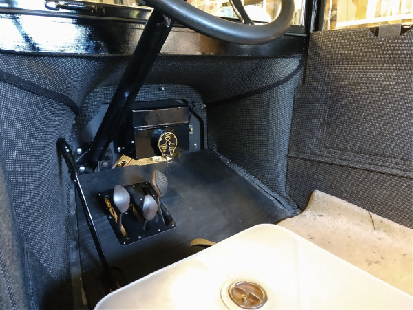

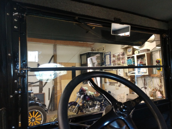

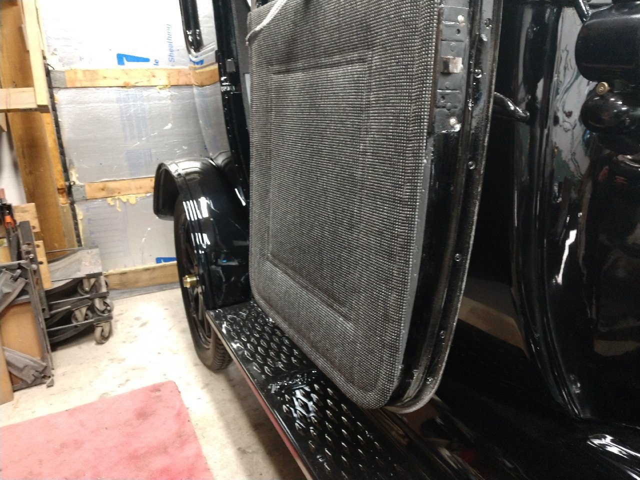

Yup Les, I did a belly flop on it to get around the steering shaft. Worked good.

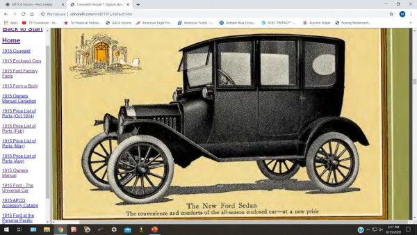

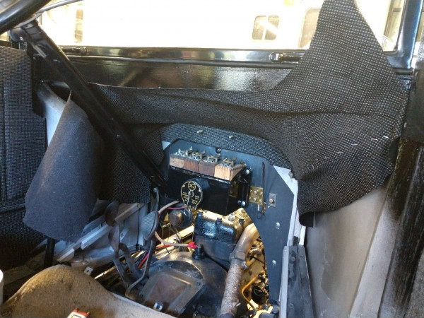

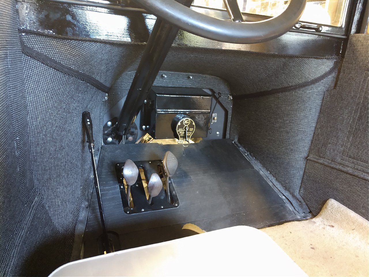

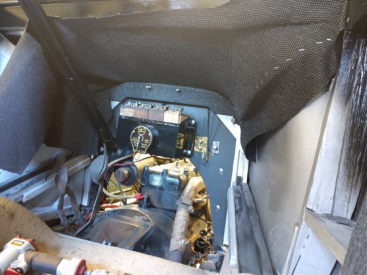

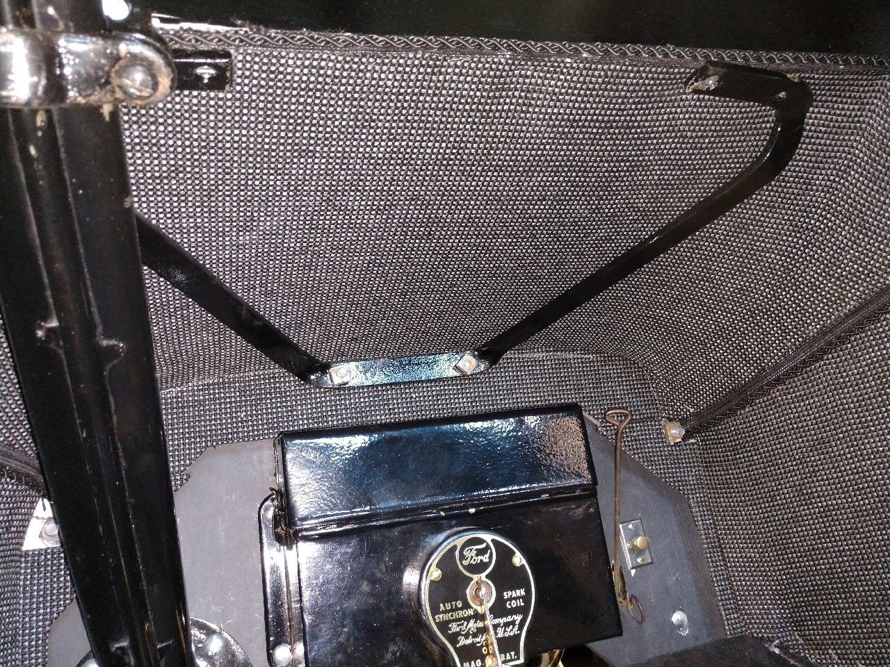

Ok, does anyone know anything about this firewall/dash brace? Did the 1915's have it? Was it on the '16's ? Thanks in advance...
Super cool! My late C-Door project sure doesn't have that brace.
They treated the sedans very nicely! No Tin Lizzie with upholstery up on the cowl section...

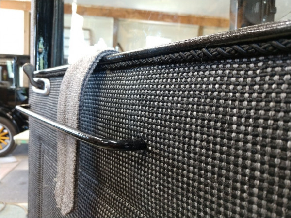

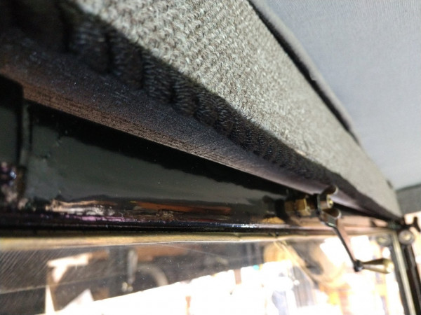

Those tin plates that the window straps go through are right. That is a good Idea on the rollers and I will us them but it will take a box of twinkes and
a week to build them. I need to get a new bag of caramels also.

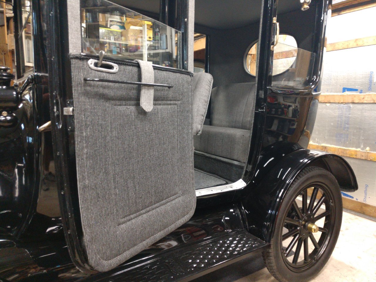

WOW! all this beautiful work and NO chocolate stains on the material you get an atta boy!
I did notice that the pattern by the firewall is 1/1000 of an inch off center so now you need to rip the entire interior out and start all over!

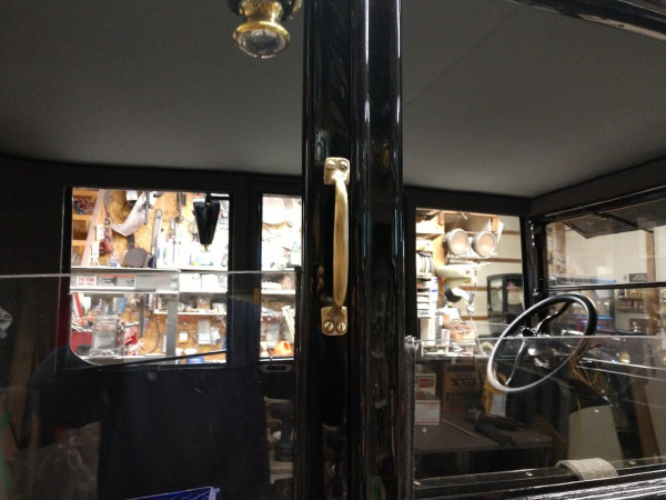

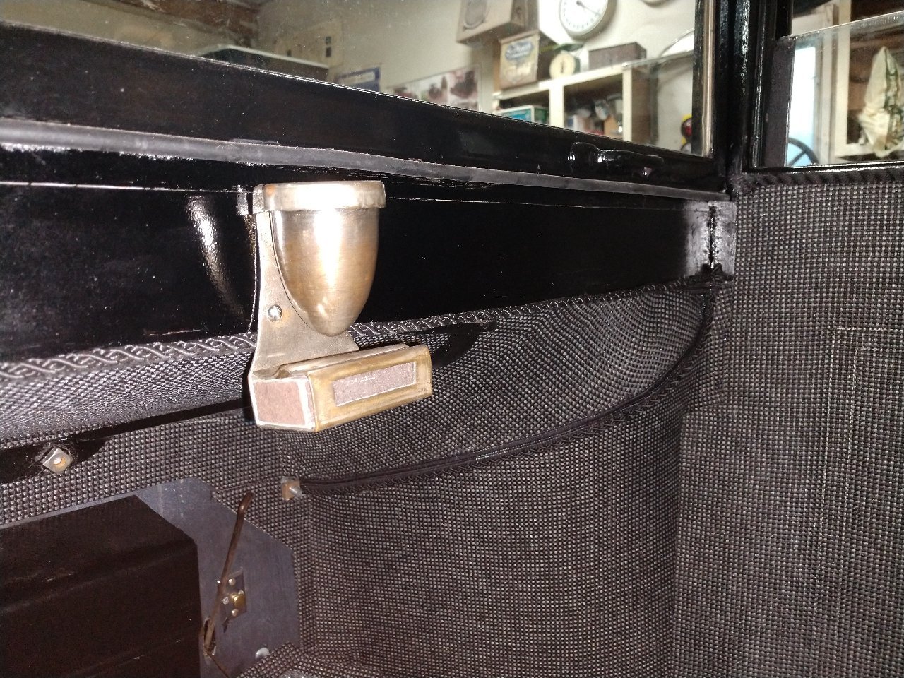

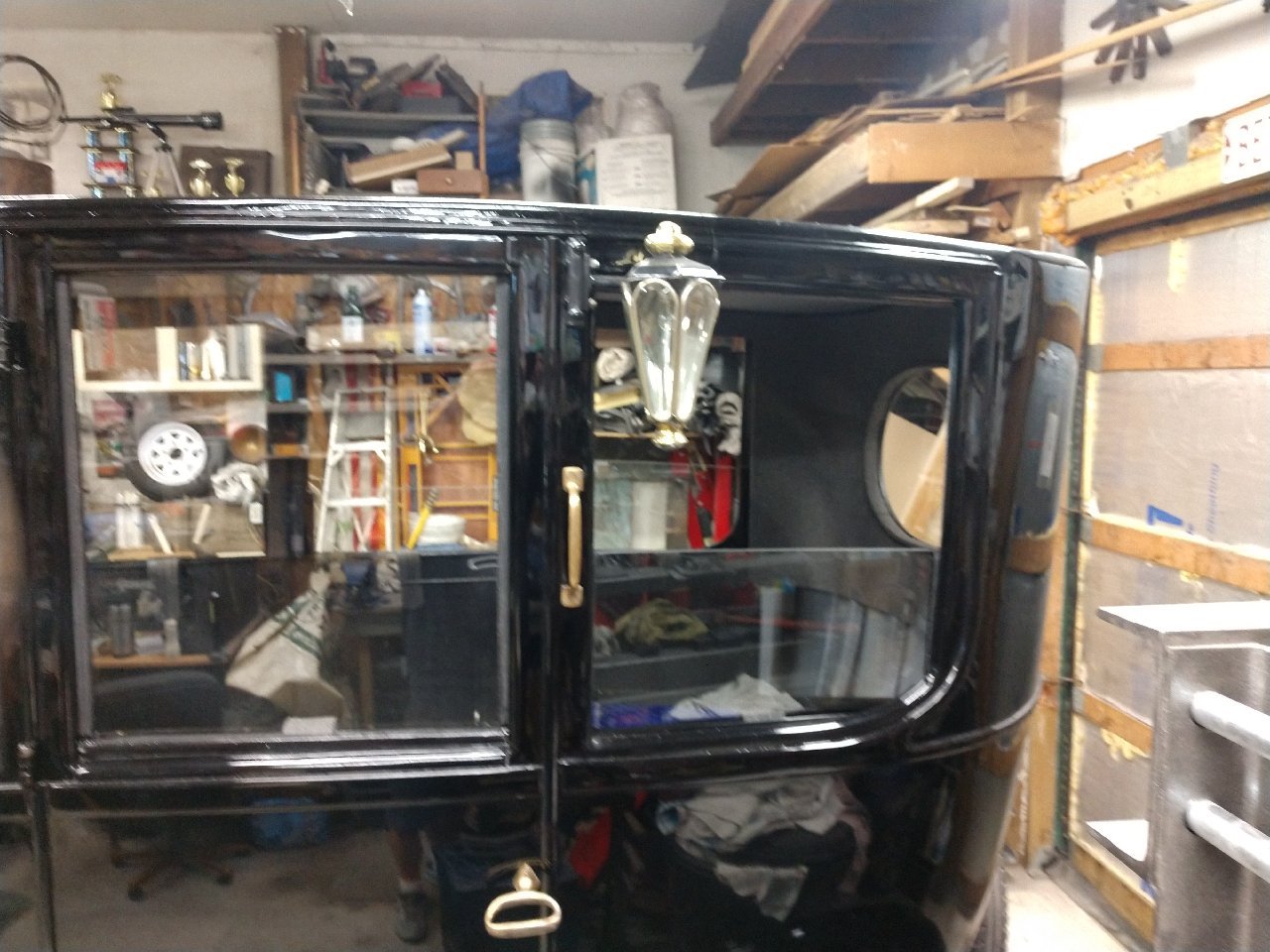

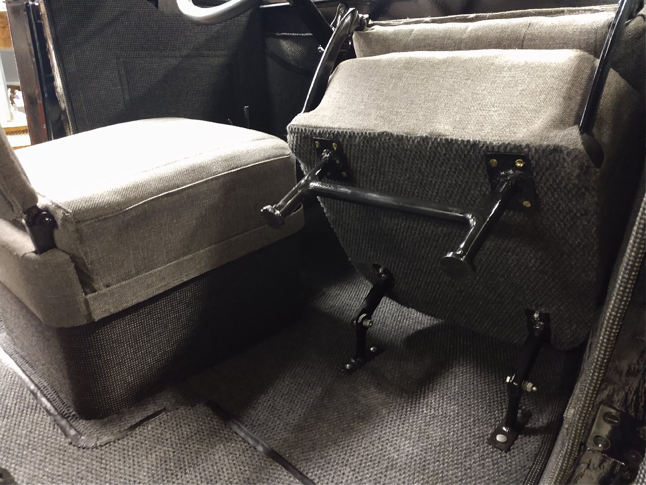

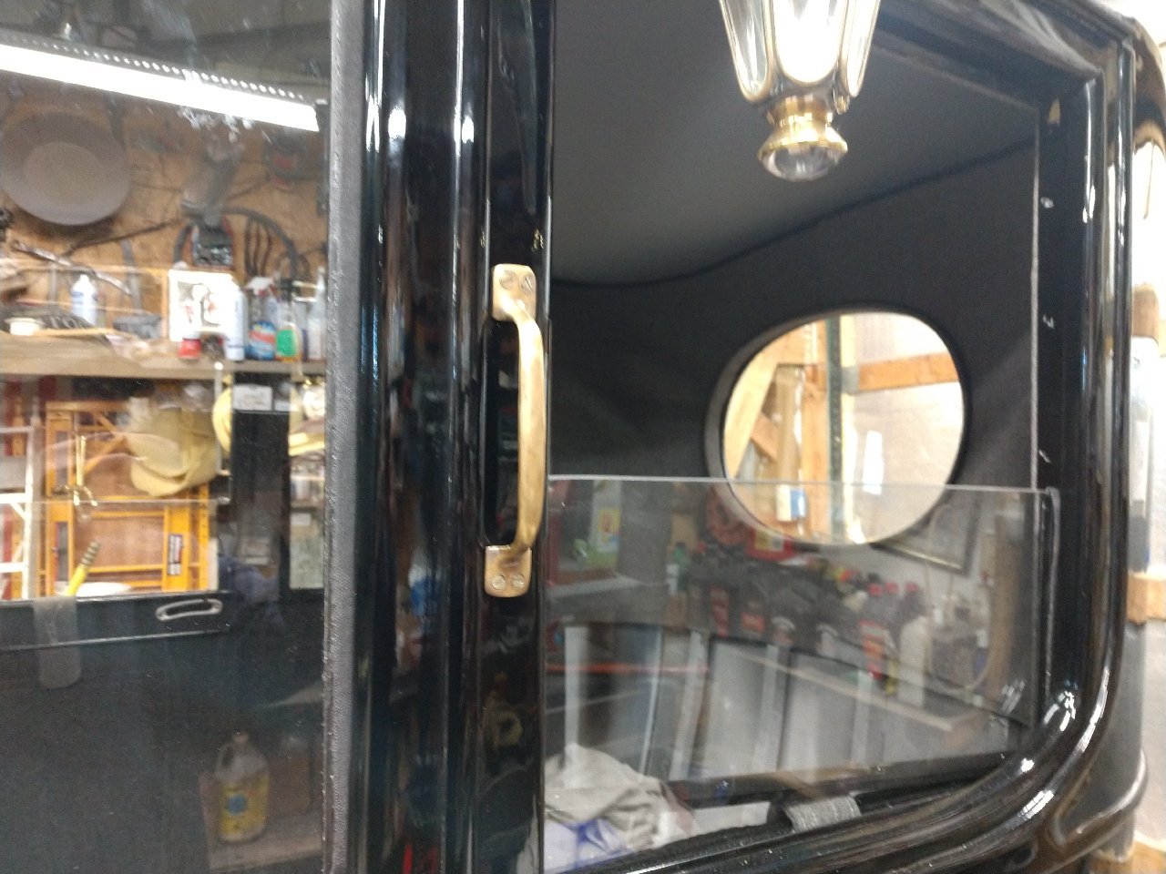

Oh Henry, please forgive me... I found these period solid brass handles and couldn't help myself.
- Posts: 1683
- First Name: Dennis
- Last Name: Seth
- Location: Jefferson Ohio
Hey Parakeet plucker ... Looks like you finally got a handle on your project!
Oh and by the way their is a Centerdoor for sale in the classifieds!

I only have 3 boxes in reserve. Thankyou again. Are you done with my sewing machine?

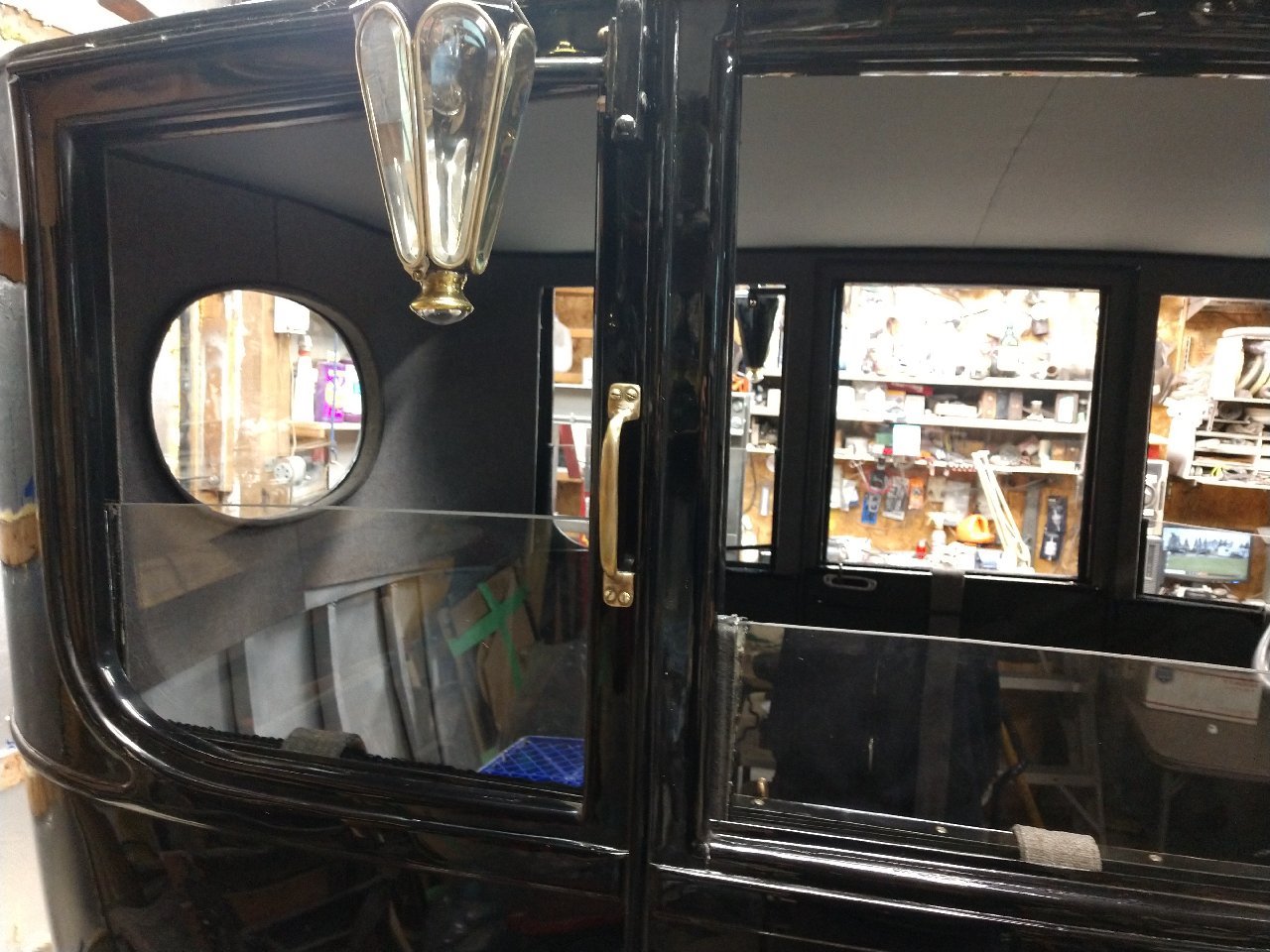

While those handles are nice, I can't believe you drilled holes into that beautifully done body to mount them.
Though not yet finished, that is already one VERY fine Center Door, and although it takes forever for the pics to load on dial-up, they are worth waiting for!
Now about that Parakeet. . . .
Dave, it wasn't easy. But, this car really does sit high and it is difficult to get in to. Plus I have the most fun taking elderly lady friends for a ride and decided to consider them a safety item.
That's my story and i am a gonna stick with it ~~
See pages 202 and 207 of Bruce's book to see photos of an original sedan "assist handle".
FordorGalore
Topic author - Posts: 430
- Joined: Fri May 03, 2019 8:20 am
- First Name: fore
- Last Name: door
- * REQUIRED* Type and Year of Model Ts owned: 1922 centerdoor 1927 fordor 1916 centerdoor
- Location: Nowhere Michigan
Mark, were they a option at the time? A Ford item? I'm sorry I don't have Bruce's book …..yet ~
- Posts: 2549
- Last Name: Strange
- Location: Hillsboro, MO
- Board Member Since: 2013
I've never spoken with Henry Ford or his contemporaries, so I can't be positive.
Period Ford catalog photos on pages 198 and 199 of Bruce's book show the sedan with assist handles, at least on the driver's side as shown in the illustrations.
The photo on page 202 (and a closeup on page 203) are labeled as contemporary photos of an "original" 1915 sedan owned by Charles White of La Puente, California. His car only has an assist handle on the driver's side.
The photo on page 207 of Bruce's book is labeled as a period picture of "two new Fords in front of a dealer's showroom in 1915". The two cars are a coupelet and a sedan. The dealer photo shows a handle on the passenger side. The closeup photo on the same page shows a corresponding handle on the driver's side.
All of the photos show that the handle has a black center grip section wrapped around metal (presumably brass) brackets that attach to the body. The handle has a rather "squared off" appearance compared to the graceful curve of some all-brass handles.
I hesitate scanning and posting the pictures in Bruce's book here due to copyright concerns.
Looking elsewhere on the web at the Cimorelli site, I noticed he had scans of a 1915 "Universal Car" brochure. It shows the sedan with the squared-off assist handle with black center matching the style shown in Bruce's book.
He also has scans of a 1915 "Enclosed Car" brochure that shows the sedan without "assist handles", so go figure! Even Ford's own period catalogs weren't consistent with each other! See the attached scans of the pages from the two brochures on the Cimorelli site.
http://www.cimorelli.com/mtdl/1915/default.htm

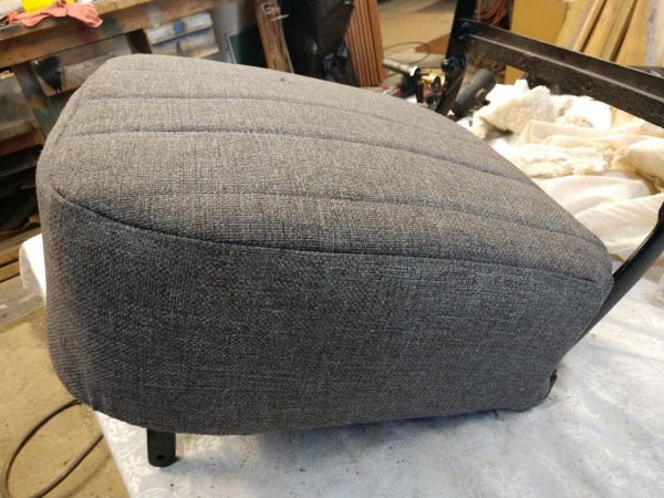

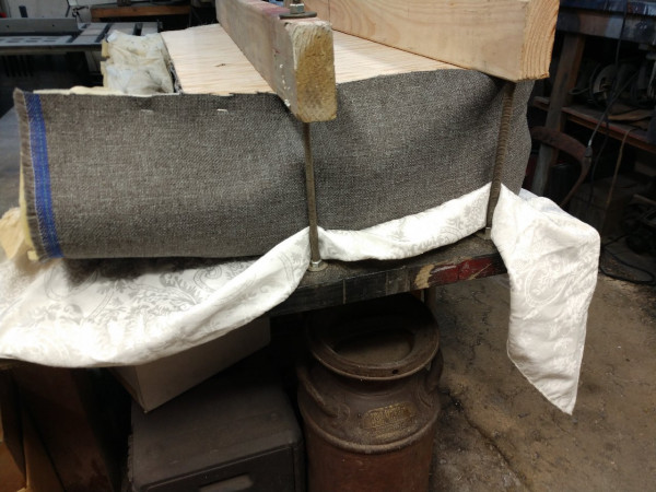

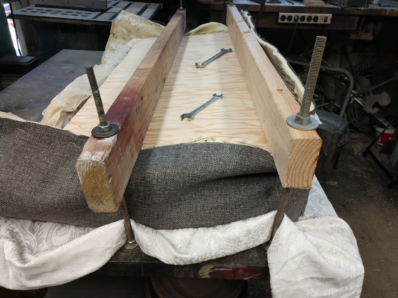

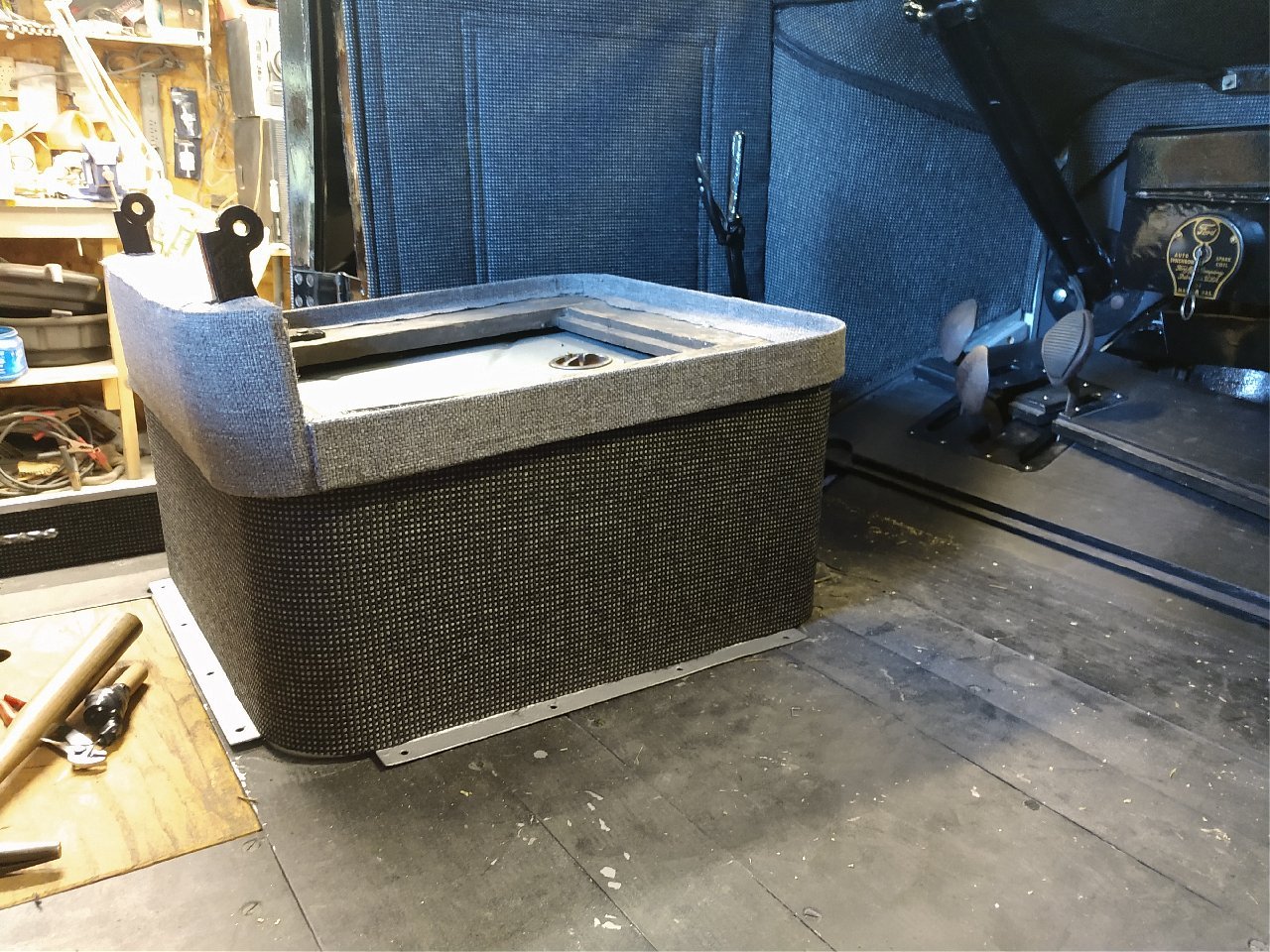

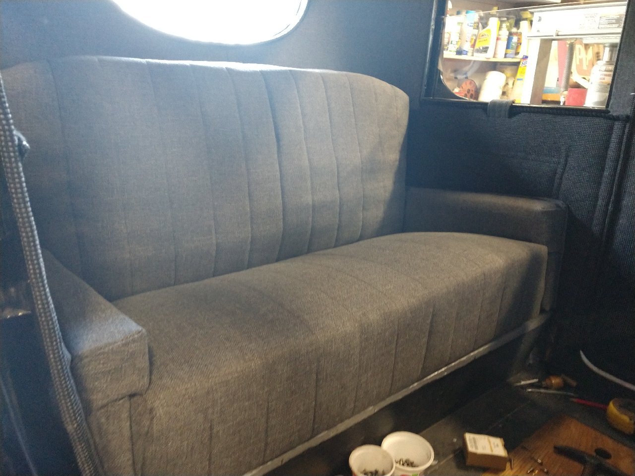

I worked on the rear seat bottom today. Its already in the spring compressor and ready to be stapled. That will have to wait until tomorrow morning.

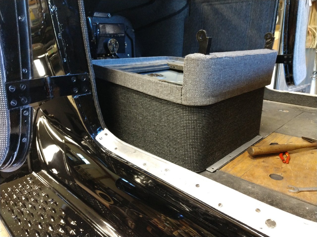

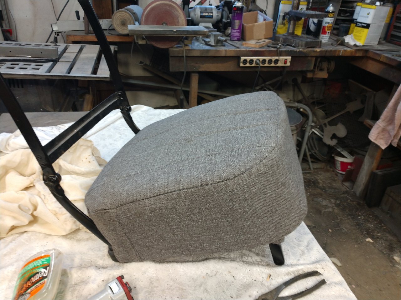

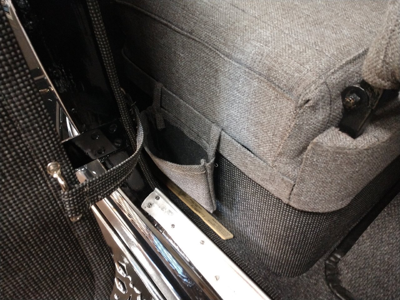

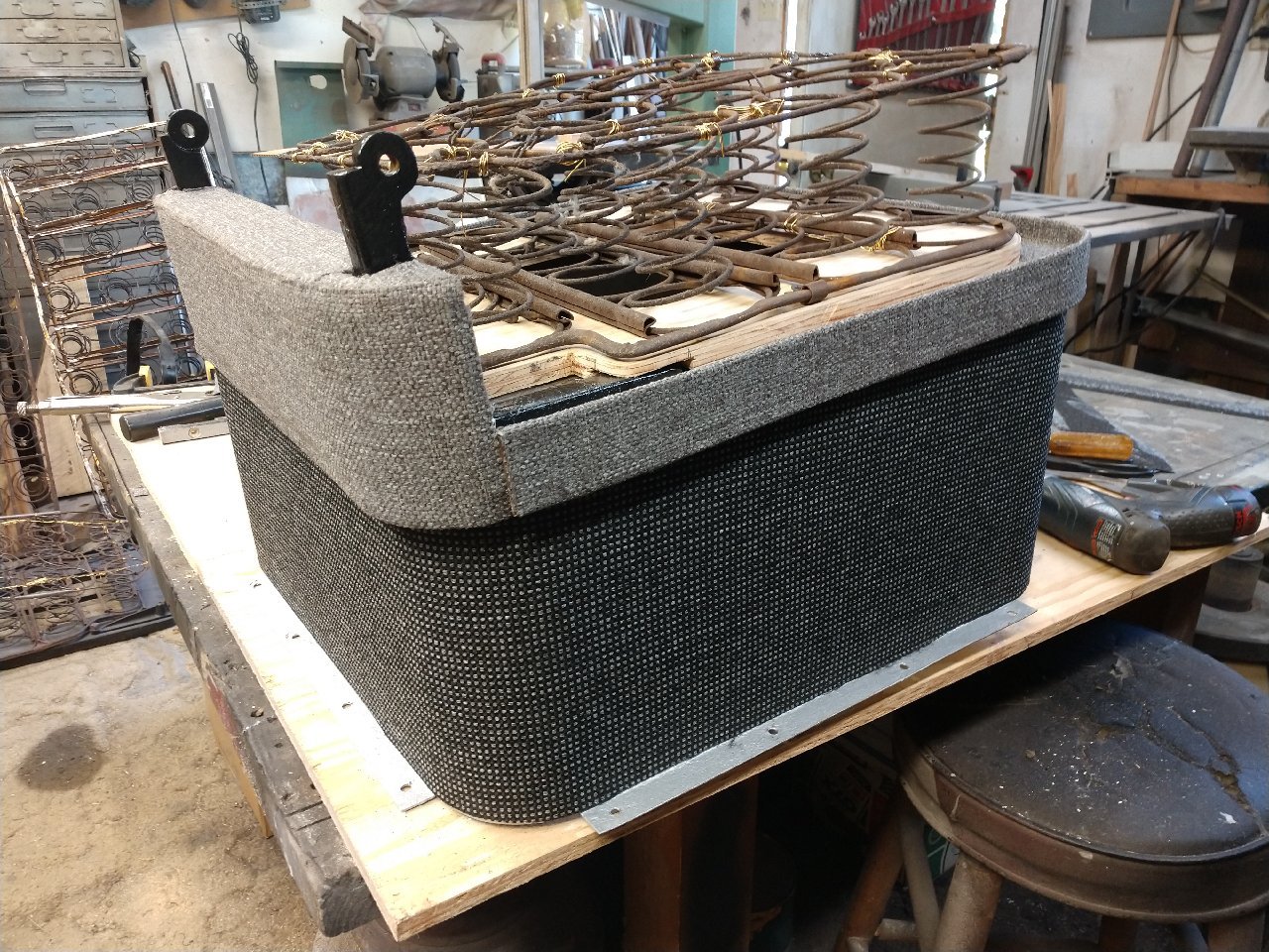

Suffering through the sewing snaggle. Nobody had seat springs that fit this so i improvised. There was a 2" gap at each end of the bottom springs.
- Posts: 1683
- Last Name: Seth
That seat is very well done and looks great.
It's almost big enough to fit my butt while YOU chauffeur me around from ice cream stand to ice cream stand! We can get ice cream with M&M's mixed in!

The people making seat springs do not care to correct the issue> I had the same issue with the coupelet . That is the way they have built them
for 40 years and you cannot reason with that mind set. It is like the hoods they have been making them wrong for 65 years and even when you
send them pictures of the correct parts, they do not care, same with the wood fire walls being 3/4" thick and then Henry down sized to 11/16 and today they send you one that will not fit 3/4" . It does not take any longer to make it right then to make it wrong. There is no pride in doing it right.

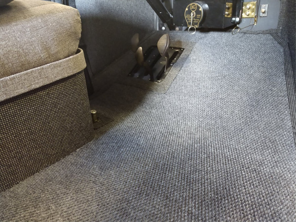

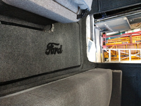

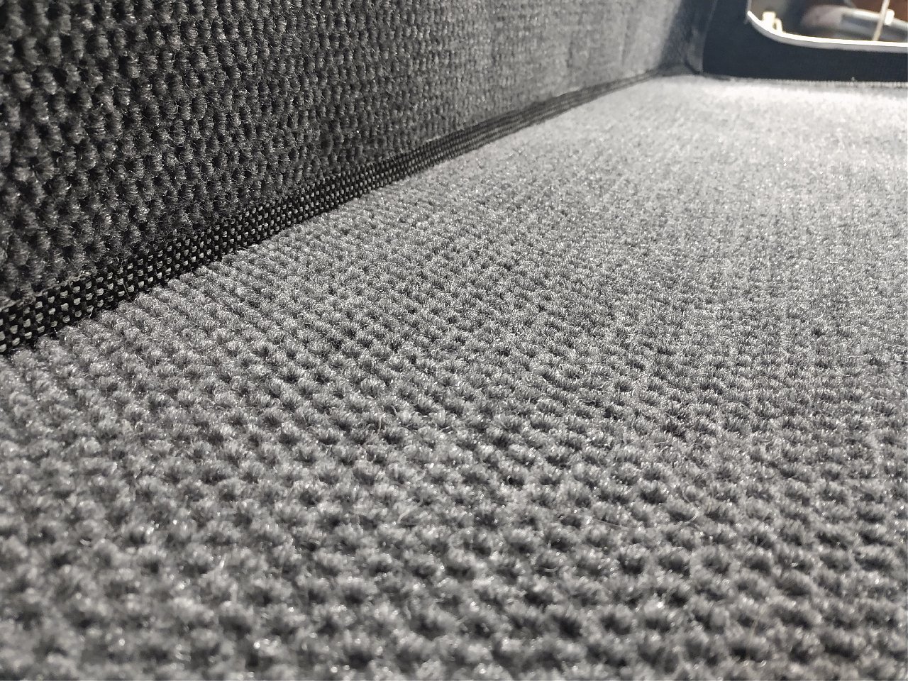

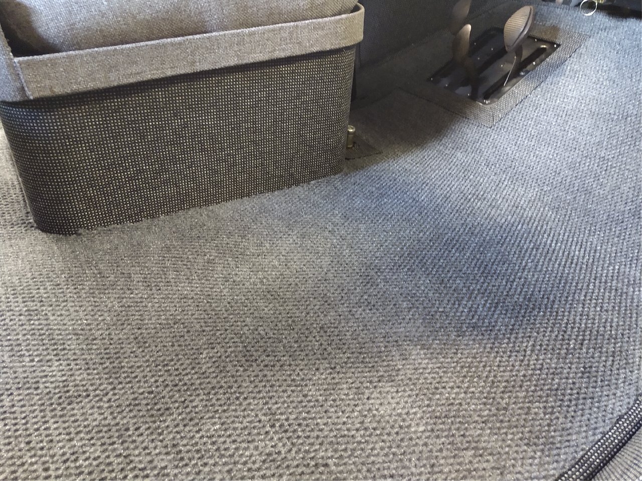

Well I worked on the carpet today. 91 degrees in the shade and i'm guess it was 191 degrees inside Henrys death trap. These pictures are of the fitting of it. I still have to sew the borders and put in some snaps. Fun stuff...if you like torture.

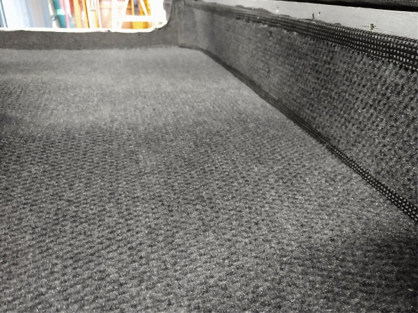

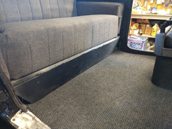

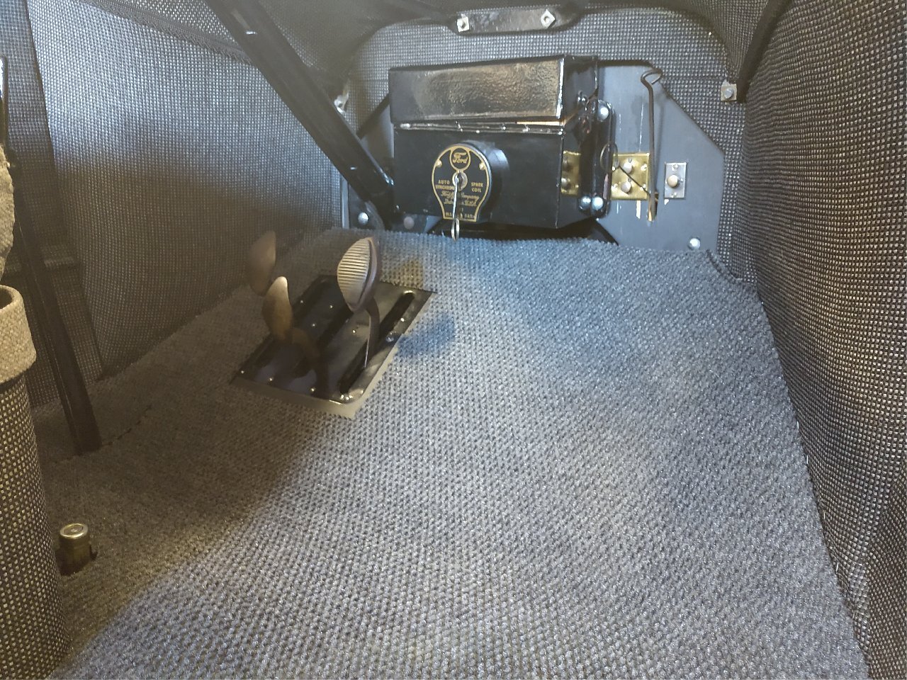

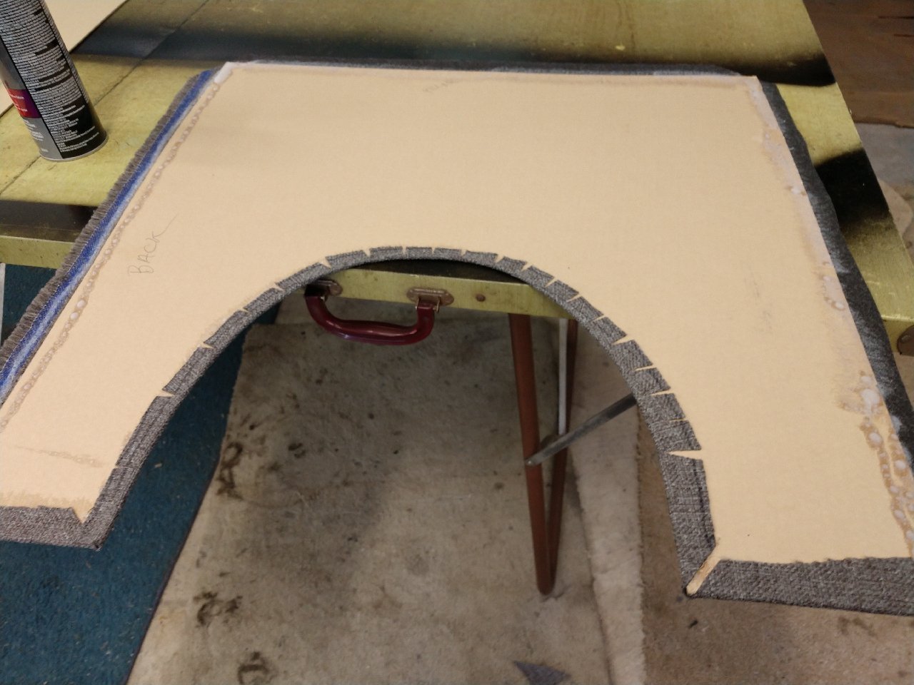

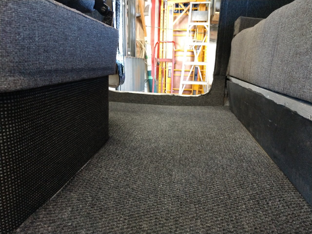

Well, the carpet is now complete with the bordering.... Thank goodness, that was similar to lifting weights in a outhouse...
- Posts: 2549
Beautiful! Will you be making some matching sacrificial floor mats to protect the carpet?
Why yes I will Mark. Just after my nooner of a nap...
Yeah right Scott, i can't tell the wife how much....

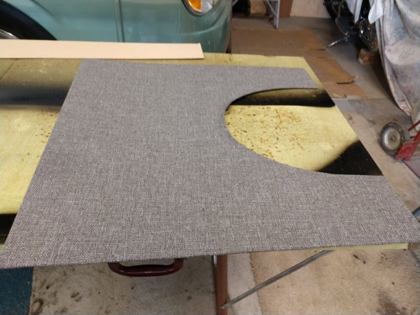

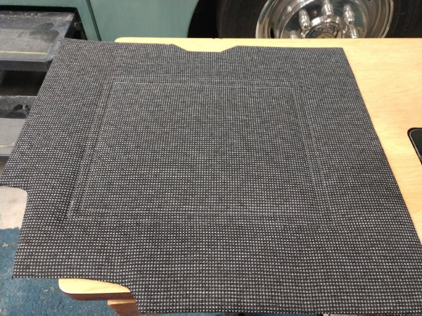

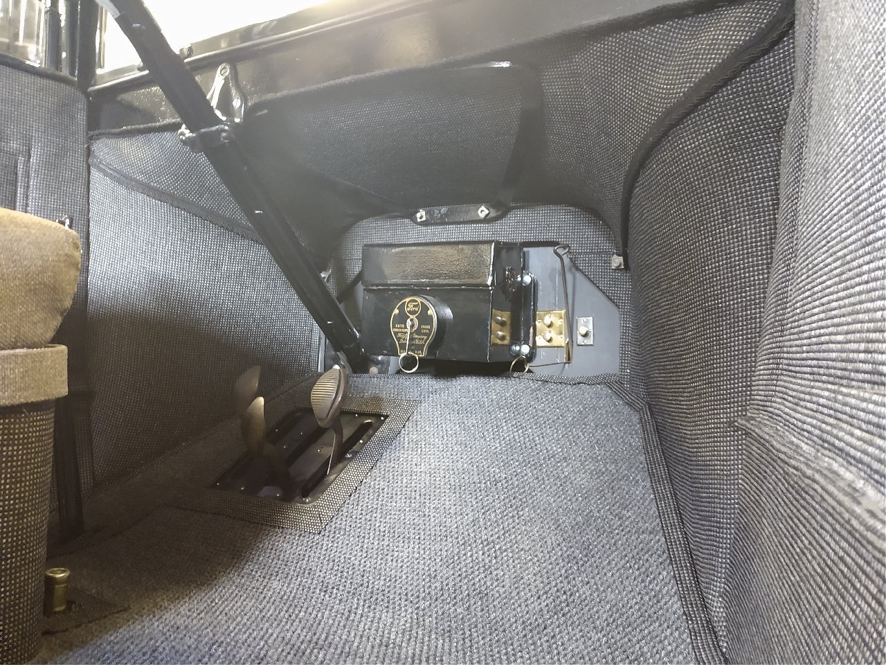

Well Mark, this is what i came up with. I still need to finish it off but you get the jest of it.
- Posts: 2549
Awesome!
- Posts: 1683
- Last Name: Seth
WOW! that looks fantastic! ... But did you have it Scotch Guarded in case I drop my ice cream?

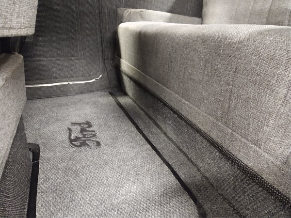

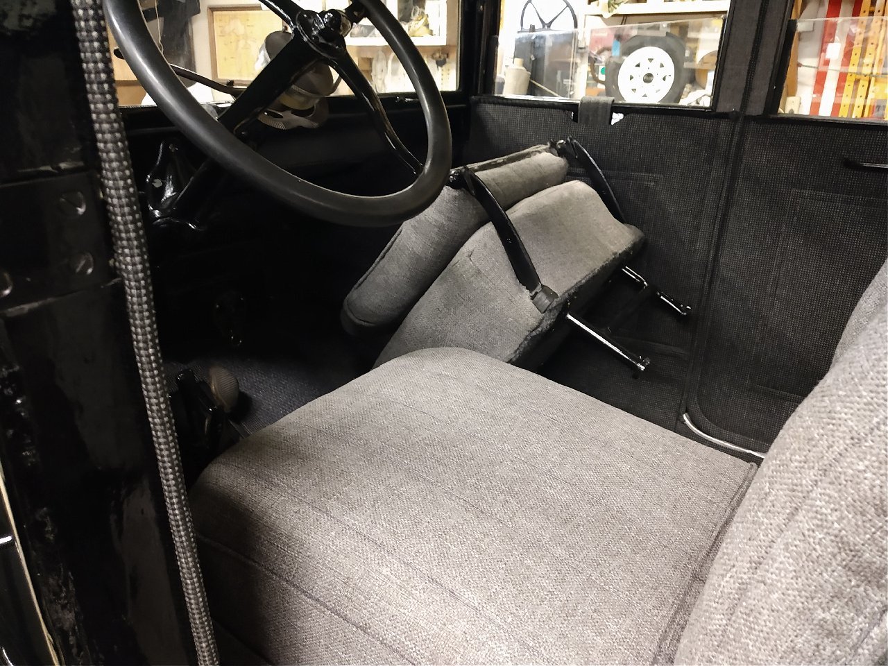

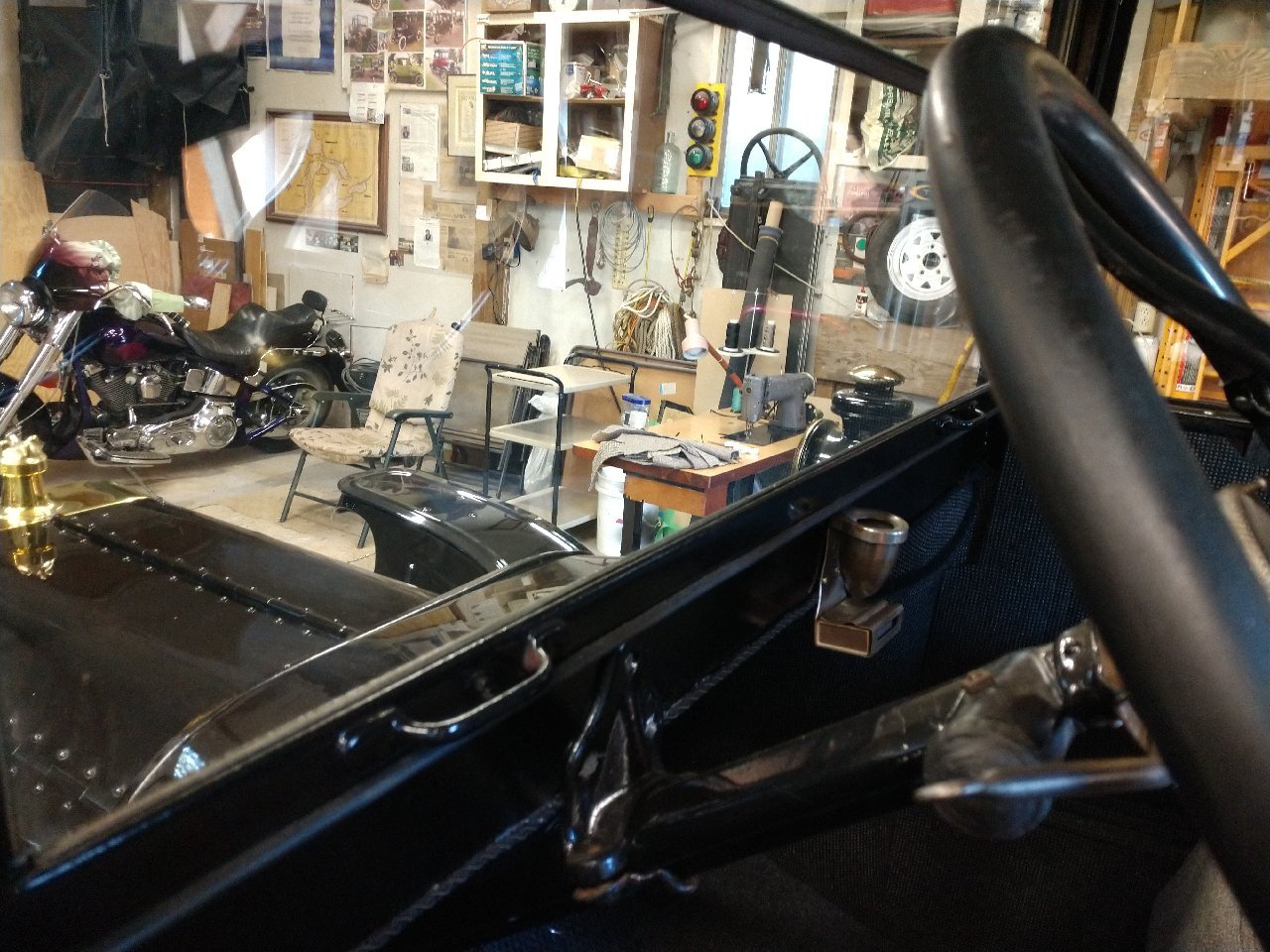

Push'n the bottom passenger seat cushion.... I will NEVER say I know how to sew !!
Thanks for the kind words ladies !!
Duey_C
- Posts: 1558
- First Name: Duane
- Last Name: Cooley
- Location: central MN
No, no. Say it ain't so. You're actually putting the other front seat in?
That view "of the tunnel" is priceless.
Maybe the only way for me, in and out.
Awarded "Best Ever Thread" according to me too. Or was that just in my mind...

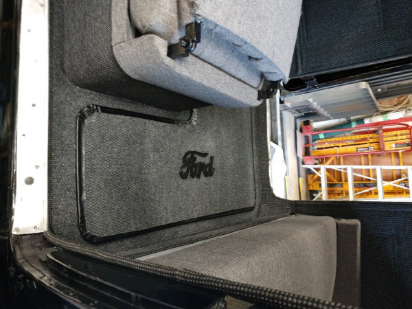

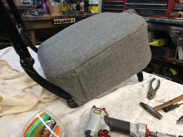

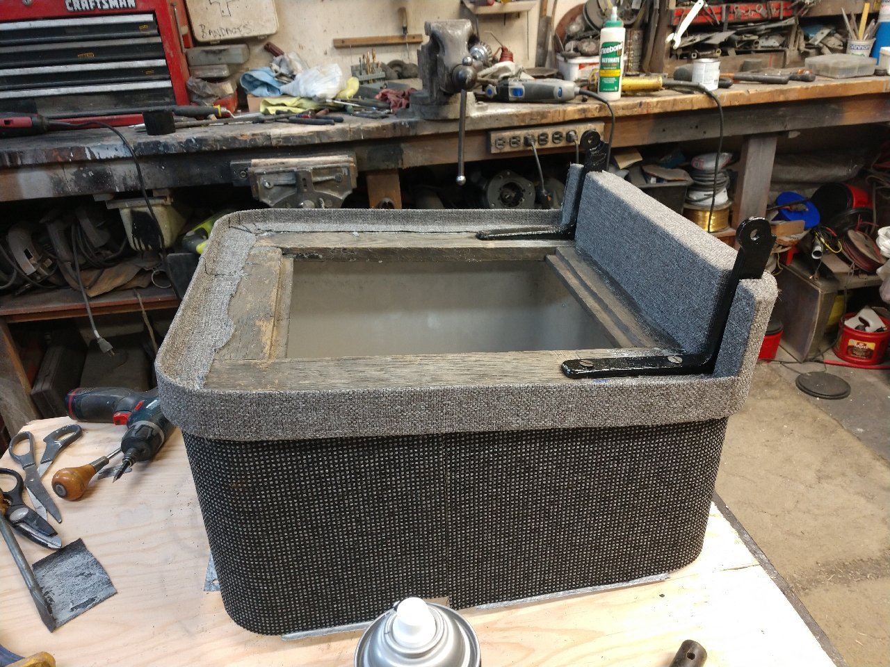

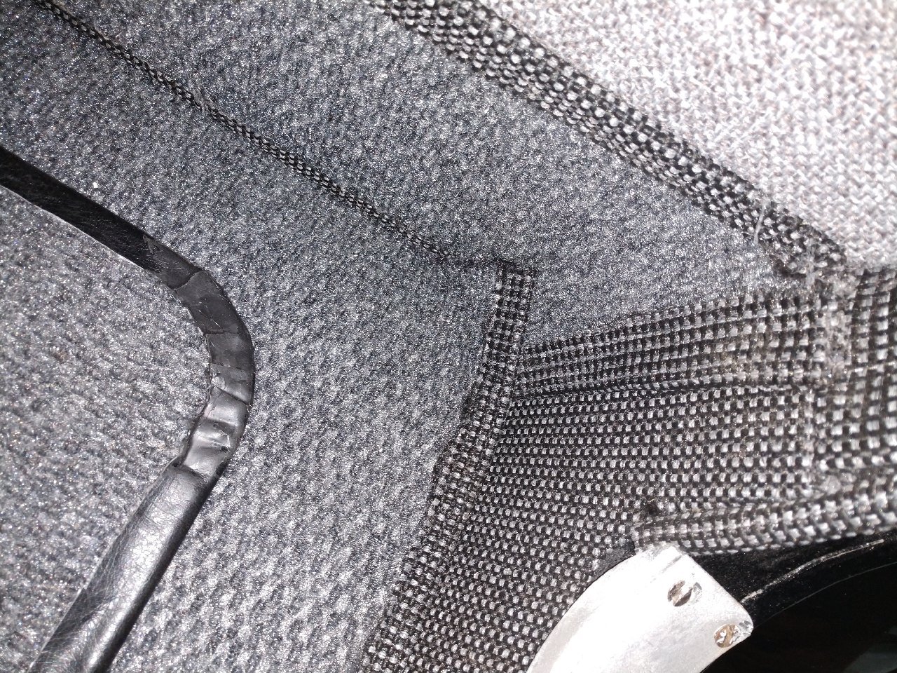

So i did some cleaning up of the upholstery today. I also fab'd the front passenger seat hardware. I used the picture of the hardware on a 1915. Still lots of correcting...
- Posts: 1683
- Last Name: Seth
This car is beautiful and the workmanship is fantastic it not only needs to be on the cover of "Vintage Ford Magazine" but the centerfold and a main story following the rebuild.
Congratulations on your beautiful car.

Wonderful Don ! What a craftsman you are from wood to paint to interior. You do it all and very well. Thank you for taking us along and all the research and work is documented for the future generation to reference. Your pace is hard to believe or match. My old wood truck took 2 years and still not 100% finished. I hope to see yours in person and lay eyes on that beauty.

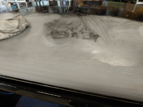

Thanks guys, but if I'm going to post the progress then I should post the regress. The top paint felt dry when in the barn but when it had the sun hitting it, it got sticky. I hoped it would dry but no luck. I did something wrong mixing the paint. So today I'm stripping it and its a freak'n mess !! Oh well just part of the fun.
Mikes 1912
- Posts: 125
- Joined: Sun Jan 06, 2019 6:05 pm
- First Name: Lester
- Last Name: Husted
- * REQUIRED* Type and Year of Model Ts owned: 20
I had the same problem on some car parts last winter, not once but twice, it was the catalyst, was out of date and it has to be used at a certain temp
range, also they do not tell you that catalyst has a short shelf life. You are lucky it was used on top of fiberglass, I had to media blast twice. Scratch it down, re prime sealer and repaint do not use the same paint, primer or catalyst. The paint Co. was sorry, they did not offer to pick up the tab. With
3 unopened gals they did not offer to take them back.

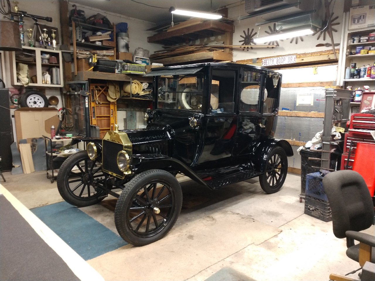

A salute to the flag and what it stands for !!
(the top is repainted on the '16)

Better put another leaf or two in the rear spring.

Well the '16 rear is sitting in a low spot on the lawn. The '22 is sitting on a big old tree stump so the rear of that one is sitting high. The Fordor is sitting on the level spot of the yard.

I was just looking at the space between the fender and the tire. For a sedan I thought it should have more space for hauling passengers. Might just be a optical illusion.;

Just doing some final touches....which will go on until the day I die.
Mikes 1912
- Posts: 125
- Last Name: Husted

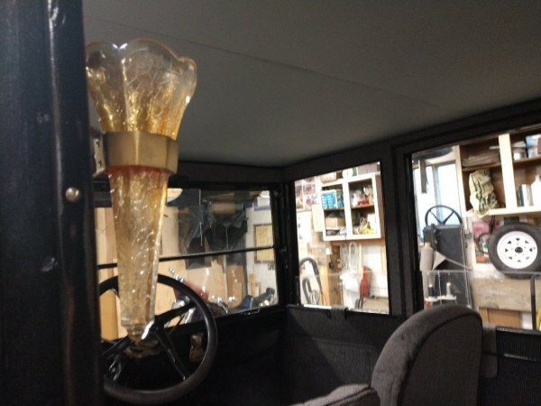

Someone might think those yellow things that look like bud vases on the door pillars are actually, you guessed it twinkie holders. The one thing that
is missing is the coffee pot and frig. Thankyou for the shell. Mike
A bit off subject but I just wanted to share. My Dad was decorated WWII P-51 fighter pilot. He flew over 115 missions over Germany. Most of his missions were solo with precise targets such as freight trains and radar towers. This soon to be available book has a entire chapter dedicated to his accomplishments. Shot down twice he managed to find his way back and hop right back in the cockpit to get back in the fight. The book cover has a picture of him standing on the wing of one of his Mustangs. RIP Dad, rest in peace...

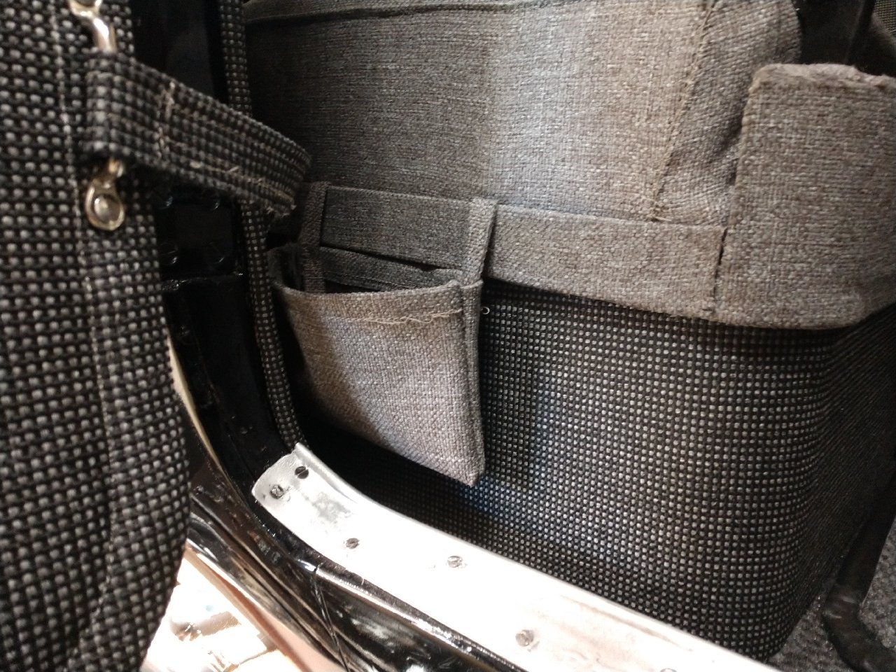

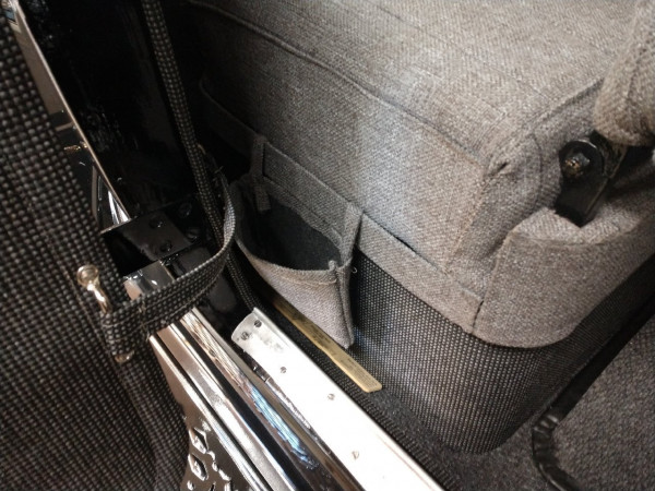

Back on the subject. I decided to make a pocket to keep things like sun glasses, cell phone and etc. Also i have been cleaning up the upholstery work. Still have a ways to go. Installed the door strap's.
- Posts: 1683
- Last Name: Seth
The little pocket idea is a nice addition to keep track of personal items in the car. It looks to be the perfect size to hold a pack of TWINKIES!

The pocket is a good idea, who would have thought of it, other than 2 pockets are better. You know what for. Not spare parts. That screw head in
the sill plate is about an 1/8th of a twinkie off, it is OK, if you add another pocket a little bigger. I'm only thinking that if you have company, but then
you have the twinkie holders on the C pillars in back. Nice touch of class.

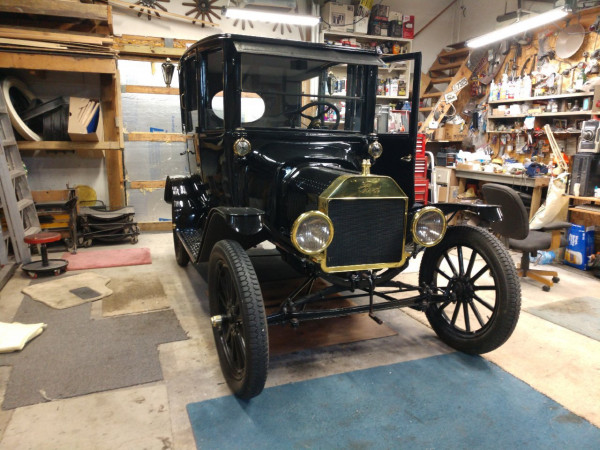

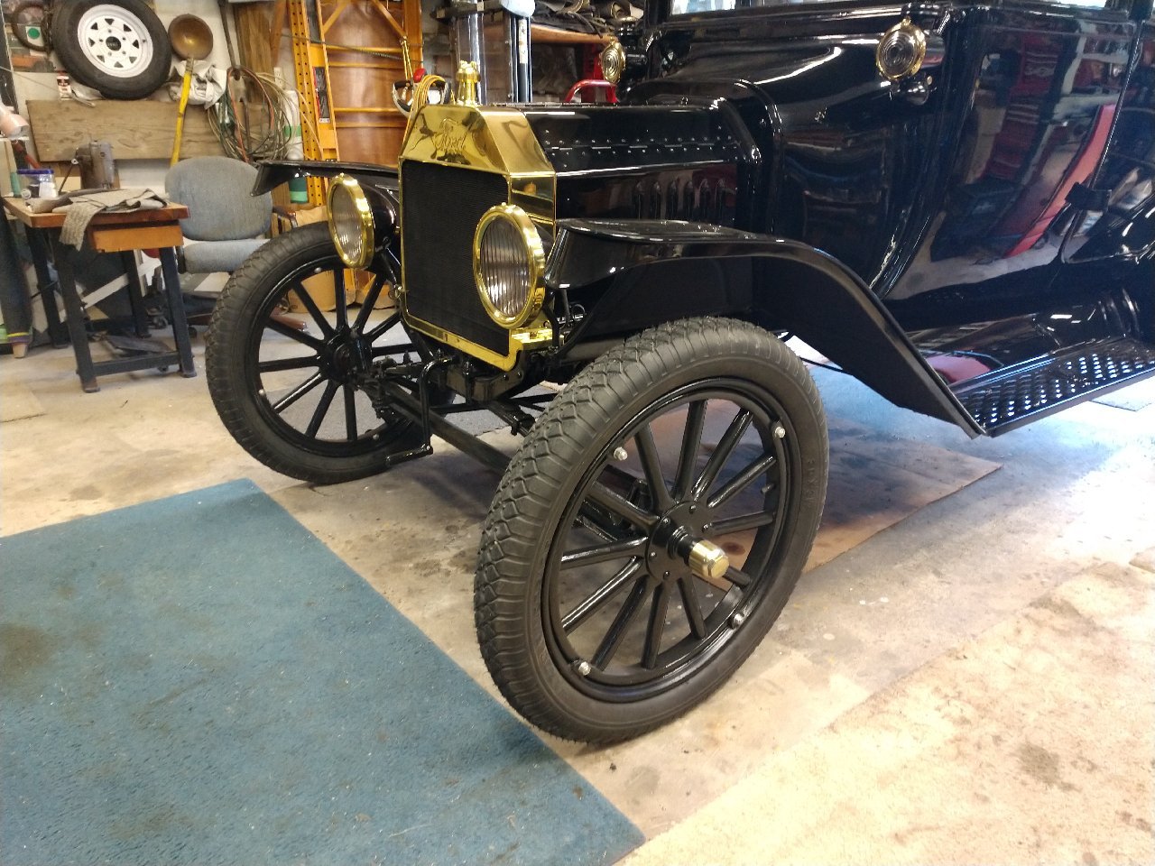

Still doing cleanup on the car. Everything from upholstery to the wiring. I have drove it about 50 miles and what a hoot it is. The expression on peoples faces is priceless, from smiles to "what the #$@% is that !! ". I am also looking for a correct pair of assist handles, if anyone out there can help please do. Meanwhile Gregory Wells editor of Jag Journal and associate editor for Classic Car magazine has contacted me. He wants to write a feature article on this artifact. I don't know if anything will come of it but it is humbling to think there is that degree of interest. Henry would do the jig for that kind of recognition !!

THAT CAR IS BEAUTIFUL! I can't wait until you drive it over to my place to give me a ride!
