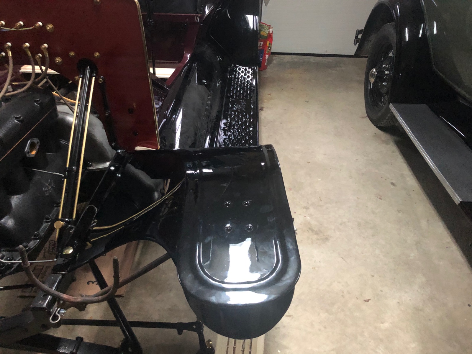

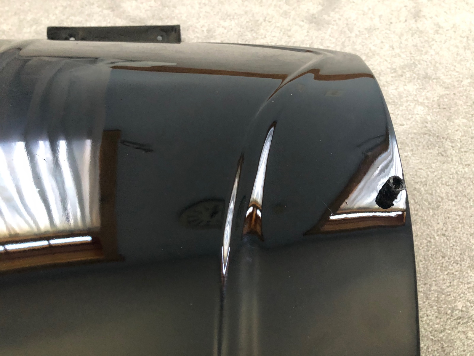

I have what i believe are original fenders and running boards and repro aprons for my 11 Touring. One rear fender has a piece of painted over rubber attached with a screw on the front body side . There is also a hole at the very rear body side of the fender. What are they for? It looks like they are screw holes to attach to the under side of the wheel well. Also where does the end of the running board apron end up at the rear wheel well and at the front of the body firewall area? Can someone post pictures of the apron to rear and front fender gaps? Mine just does not look right Thanks. Art

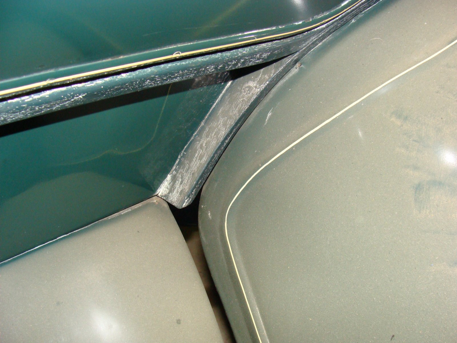

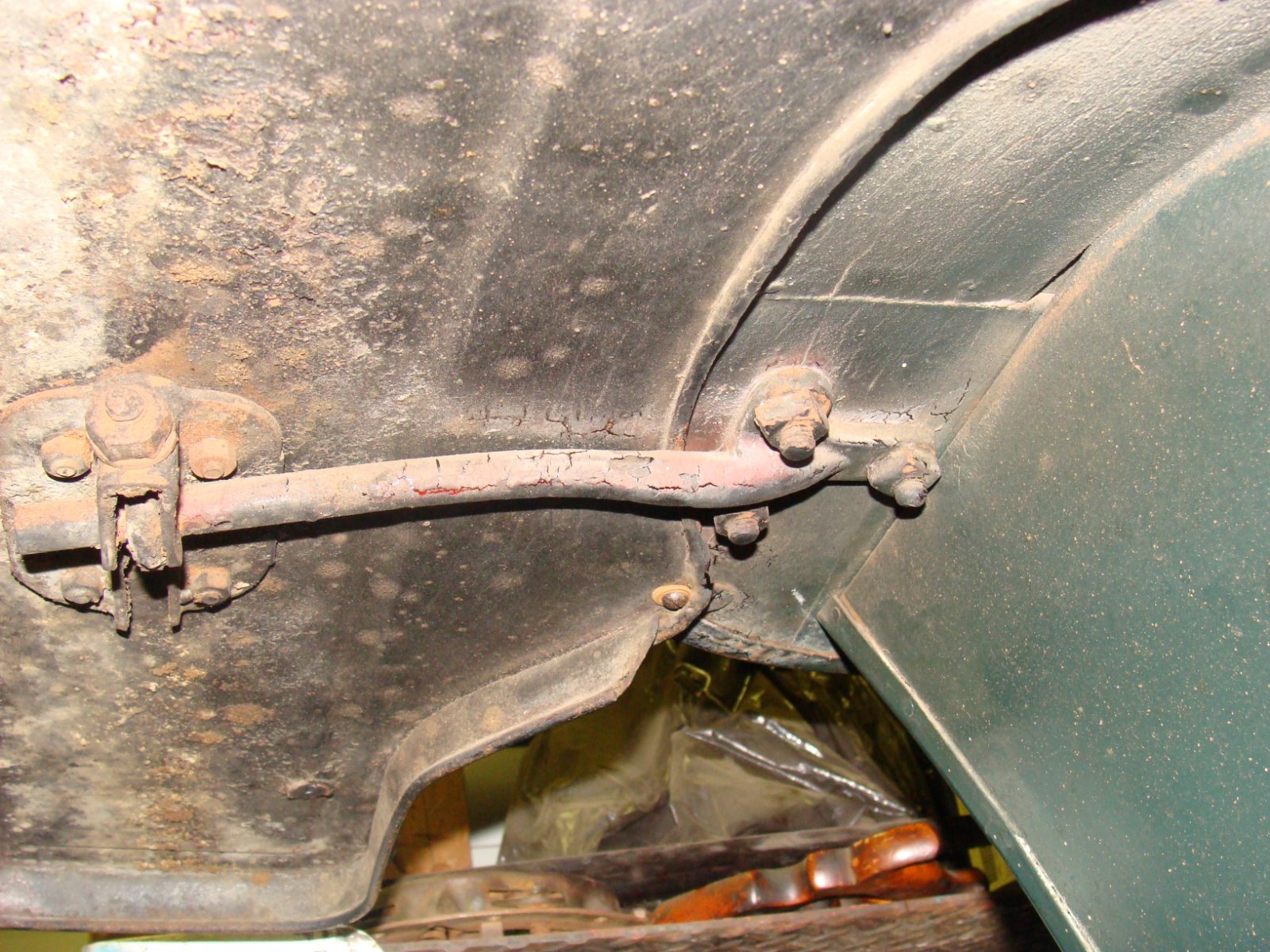

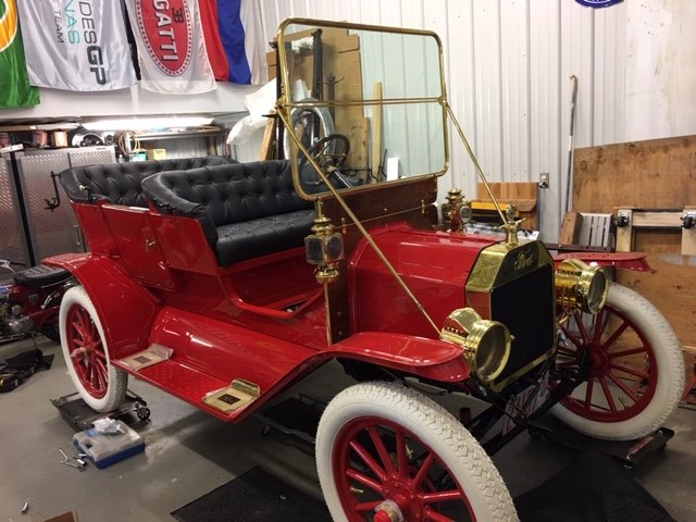

Art-
The hole in the fender is for a screw to attach it to the underside on the body.
These photos are of the 1911 of the late Chad Champlin.

Post by Art Ebeling » Sun Feb 02, 2020 8:59 pm
Thank you, That fit about what mine looks like. Now if I could just figure out how to get the front fender's front bill from pointing up and out. Art

I have heated and bent the front fender brackets up, down, forward and back, but I cant’t get the front fenders from pointing to the outside at the front. The front fenders bills are level, and the running board brackets are straight and level. Any suggestions? Thanks, Art

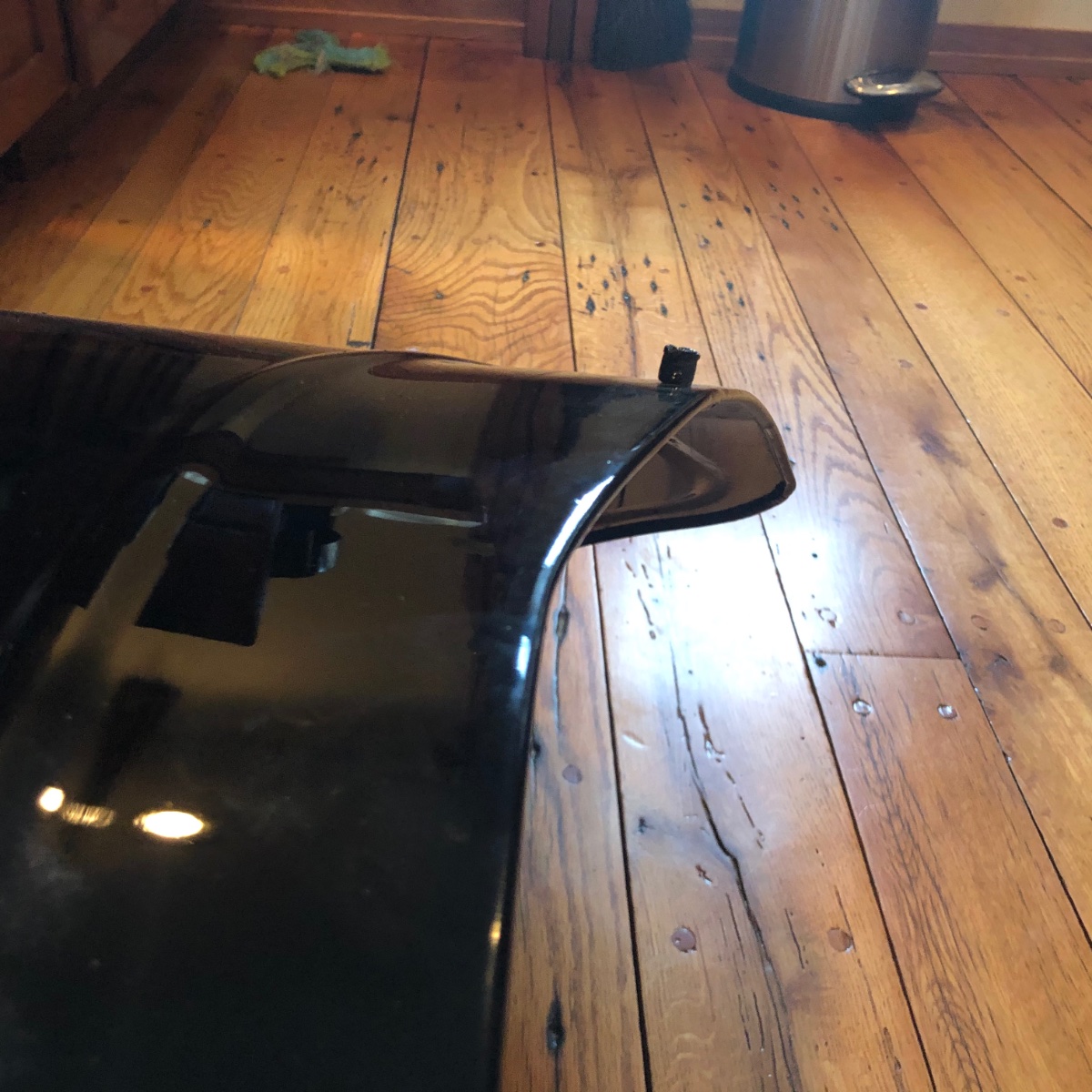

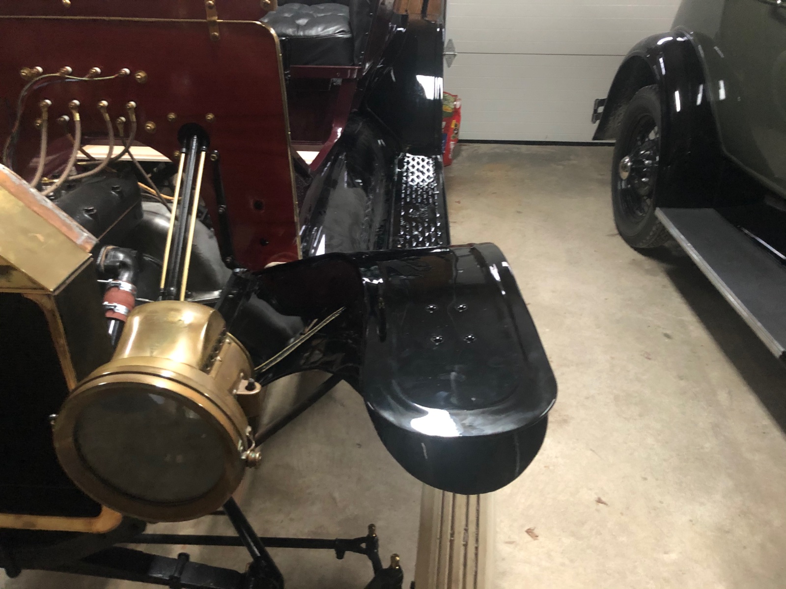

This is what I am trying to correct. The outside edge is high and the front points outward. Thanks, Art

i would check the fender iron it self it could be the wrong one . it appears to be to long maybe a wide track iron ,do you have this problem on the other side. If not compare the two irons . I checked my 12 and it is straight and I only have about a quarter inch through the fender bracket . Thats why my thought is your fender iron is wrong. Cheers Colin
Art Ebeling
Posts: 525
First Name: Art
Last Name: Ebeling
Location: Hillsboro IL
Re: 1911 fender fit
Post by Art Ebeling » Sun Feb 09, 2020 10:55 am
Thank you but even with the fender iron loose and hanging below the fender the fender looks the same. The right fender is not as bad but it also points out. Art

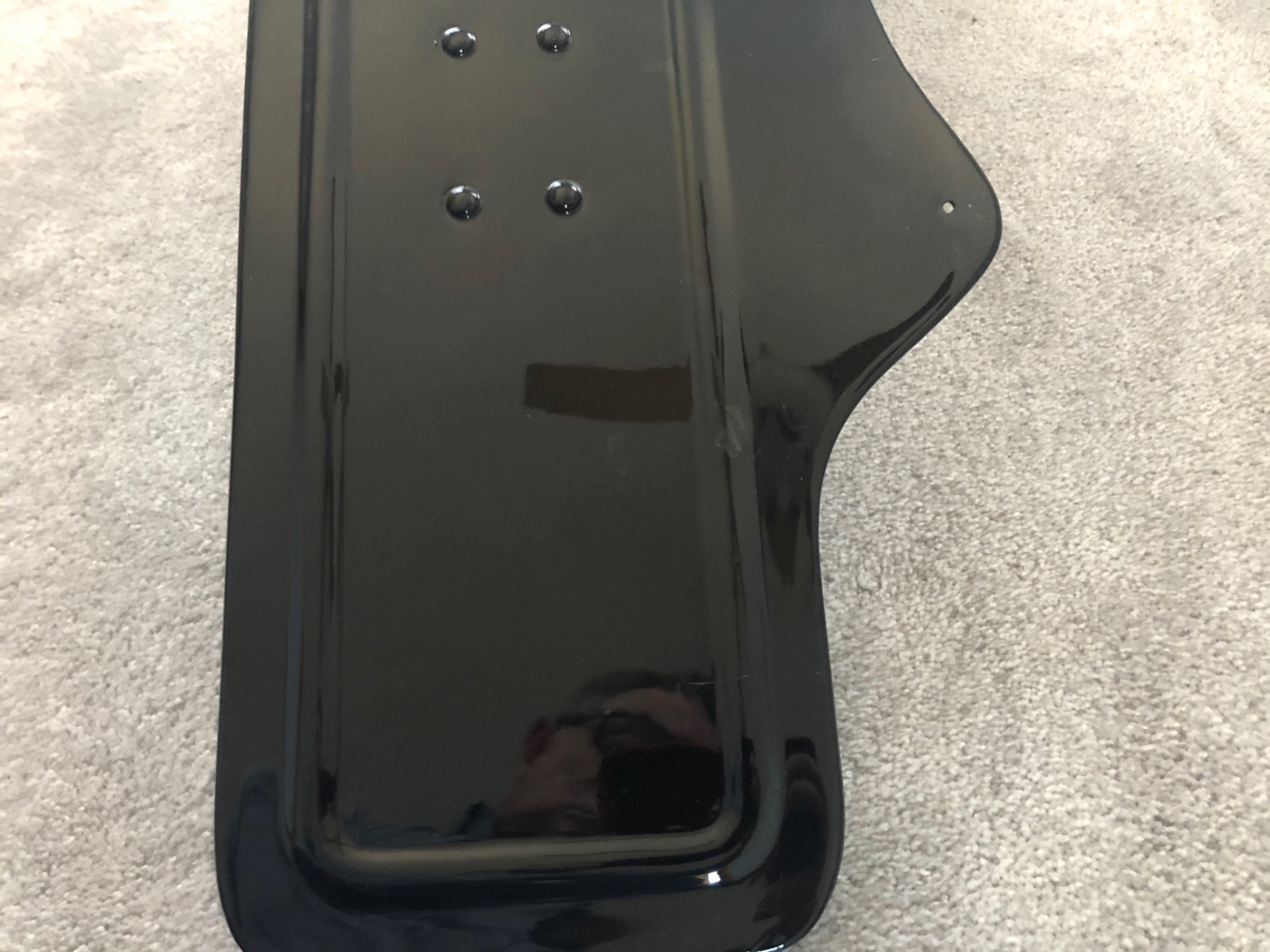

On the underside of the fender where the bracket is riveted on, is there a notecard-size piece of sheet metal sandwiched between the bracket and fender?

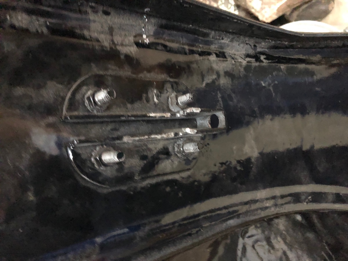

Art Ebeling
Posts: 525
First Name: Art
Last Name: Ebeling
Re: 1911 fender fit
Post by Art Ebeling » Sun Feb 09, 2020 1:34 pm
This is the underside.

What makes you think they're original fenders -- are there signs of old repairs, pitting, etc.? The brackets being bolted on doesn't assure that they are originals that have been unriveted and reinstalled because it is my understanding that years ago reproduction fenders didn't come with the brackets and they had to be sourced from an old set of fenders.

with the fender iron removed can put the fender in the proper position, if so the problem is with the iron, if you cant get the fender to sit correct with the front loose than the problem is with the fender. When I broke the crank I had the fender off when i put them back on they fell right into place . Your fender is repro I,m guessing because the under bracket is bolted on all the original fenders I have seen are rivited . You may find the something is wrong with the making of the fender, the front of the fender cant move to toward the rad unless the side skirt moves in toward the engine . I hope this makes sense If you unbolt everything except the fender to running board bolts the fender should sit in the correct place than see if the other holes line up if not you have a fender issue. Cheers Colin

I was thinking they were original fenders because of visible old repairs. I appreciate the advice. Art

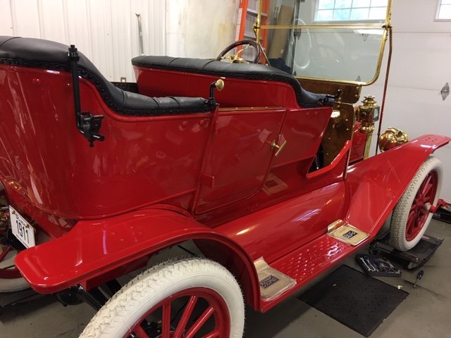

Post by Quickm007 » Mon Feb 10, 2020 4:22 pm

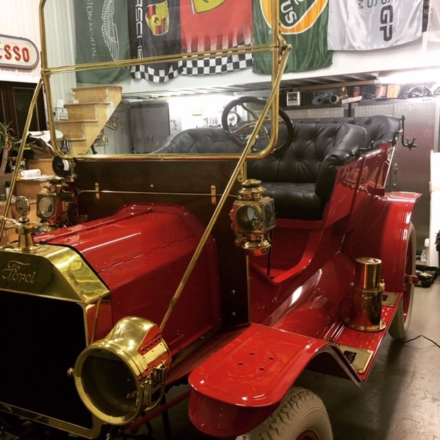

Hi Art, I Agree with Tom. I did on that way. I sent you couple pictures last week-end. Here other images, hope that will help. If you need more pictures or different angles let me know. Good luck.
