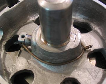

Showing center Point that was making the shaft off center, I cleaned it up, and it centered
Hose clamp to hold the fingers back

I see you used a safety wire on the screw that retains the clutch hub instead of a cotter pin. Why? Is there a chance that the wire could work its way up and become loose?

grandpaford wrote:
Sun Feb 24, 2019 9:04 am
I have taken at least 500 Transmissions apart, and rebuilt them. many the key would allow the set screw to move, back and fourth, a 1/4 to a 1/2 turn before the key would stop the set screw from going any further. The moving set screw had taken out the Disc Drum and set screw threads, and the rounded set screw end, and main shaft hole, other wise parts would have been still usable.
So I started using Bailing Wire, not light wire, you want to send a Man.
Thanks,
