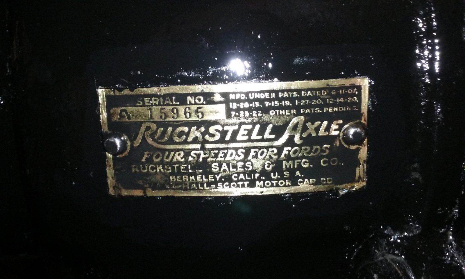

I'm sure the information about dating Ruckstells based on the serial number has been published somewhere, but I was just wondering where to look. I have a Hall Scott Ruckstell I just finished installing in my 1915 and was curious about the year it was made. It's number A 15965 which I assume means it was the 15,965th one made, but I don't know what year. It is a small drum with Hall Scott cast into the backing plate and has the lip for an enclosed driveshaft spool. One additional question, did any small drum Ruckstells come with smooth backing plates or did they all have the extra support ribs?
Thanks in advance,
Chris

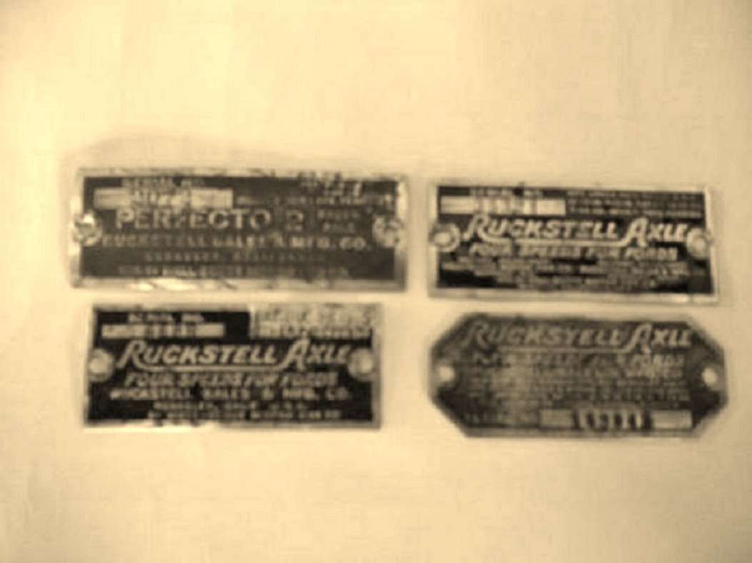

One method to date would be the style of patent plate on the axle.
Your's appears to the third series plate, with the larger address line on the bottom. The photos are blurry, but someone posted this picture before. Nice comparison. Can almost make out the serial numbers that give hint on age of each plate for dating an axle.

I have Ruckstells in all of my T's. The earliest one has a different patent plate than any pictured above. I believe the serial number is 6,XXX. It has a boss in the upper RH corner with some patent numbers stamped in it. Regarding backing plates, I like the late ones made by Eaton, because Eaton arranged with Ford to buy genuine Ford backing plates from them. The advantage of that is the Ford backing plates have a removable brake cam bushing. When rebuilding a Hall Scott unit, you have to bore out the backing plate to accept a bushing. I guess Hall Scott never dreamed that people would be using their product almost 100 years after they were made.

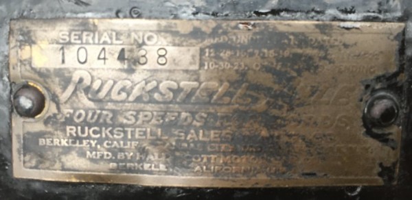

maybe interested,
another plate on my Ruckstell, see the other patent date
its on a 1927 T pickup. Hight number I think so could be installed origional
Bert
Bert

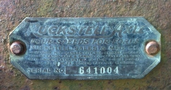

The plate with the clipped corners is an Eaton plate. Mike Spaziano had a bunch of them made last year, and sold them to Chaffin. I'd like to see a clearer photo of the plate with the fuzzy rh corner. It looks like a pretty early one, like the one I have.
I have a Ruckstell in my touring, which is one of the worst castings I've seen. They must have been having a bad day then!

This Ruckstell plate is from my TT rear axle. Given the serial number, it most certainly is a later example.
Rich C.
