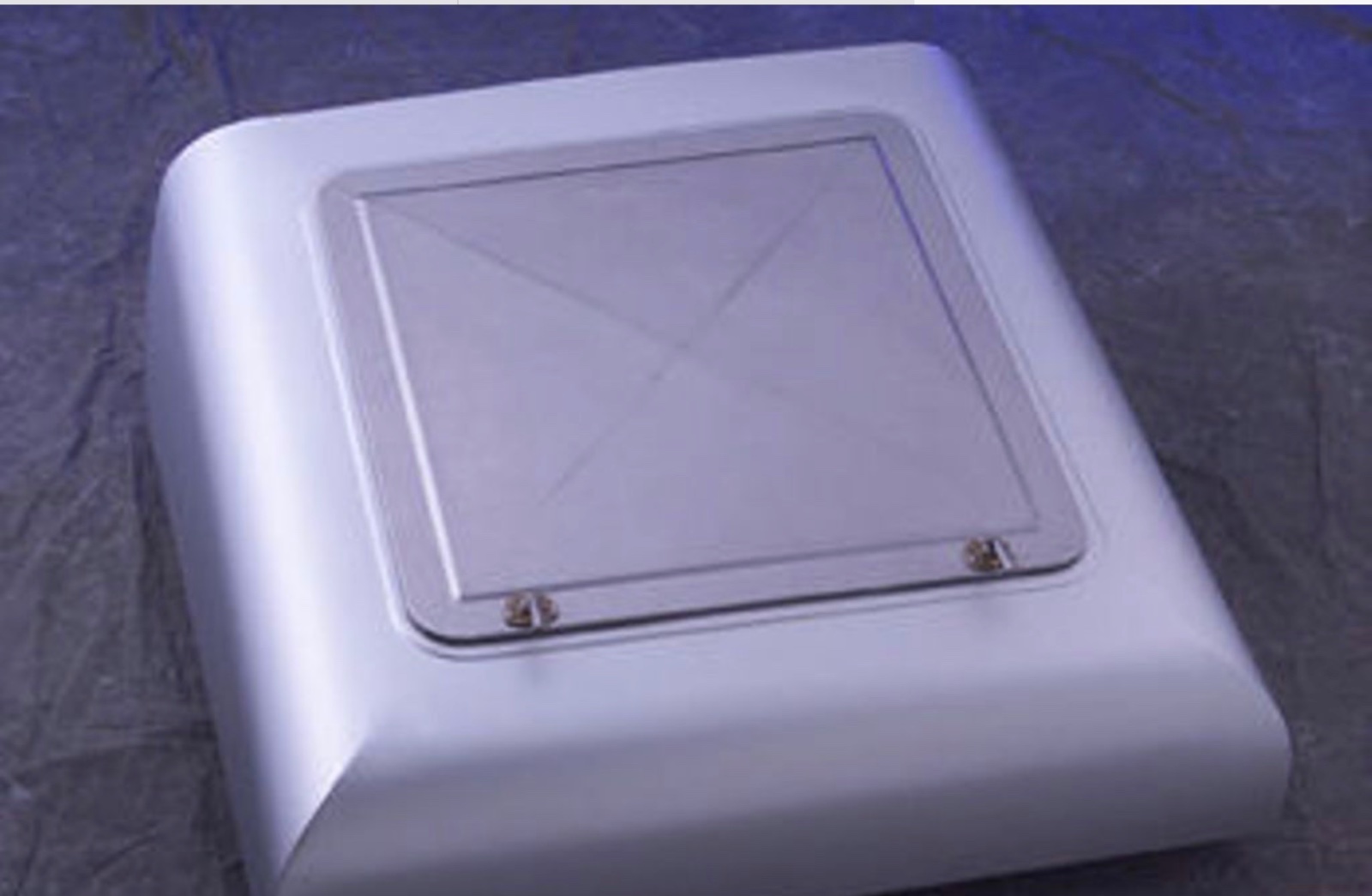

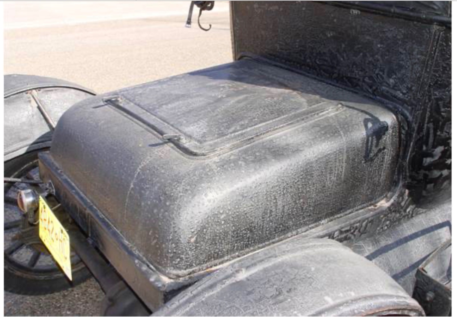

I was wondering about the removable turtle decks that Ford produced for the model T. Am I missing any?

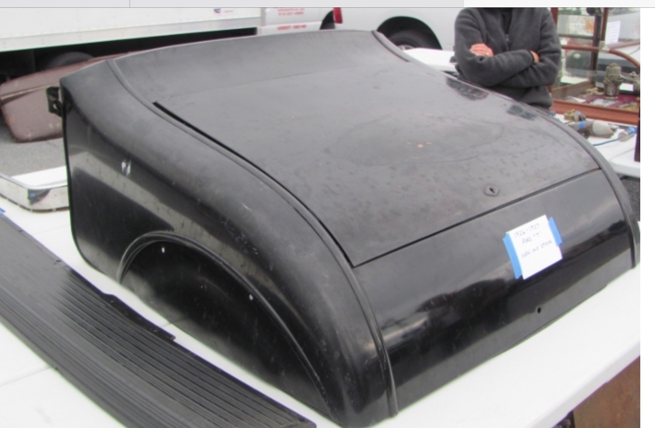

Oh 1923-24 roadster

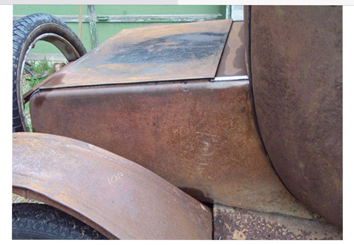

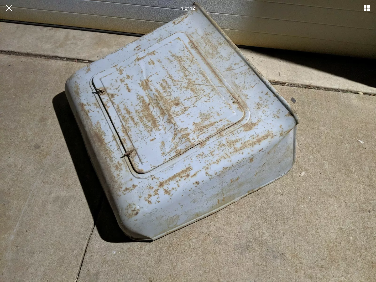

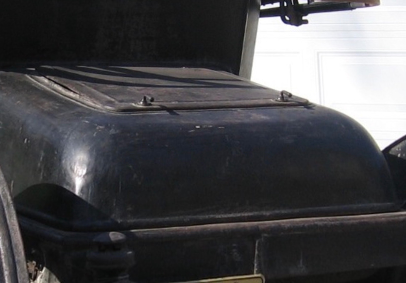

What about these? If not Ford then whom?

The trunk on the coupe shown is not readily removable, it is inset into the body and there would be a big hole in the back of the body with it removed.

Mark I believe you may be right though I’ve seen this picture of one that was removed. I know you have a lot of T experience, do you have an idea about the unknown 2 posted. The rusty one looks 26/7 but the curved panel in the back bottom looks, at least to me, larger and the other one pictured it looks 23-25ish but the lid and latches are different but look factory.

Yes but if you will look close the wood sills are cut just in front of it. The sheet metal along the front curved edge is nailed to the inside of the pillars on ether side. Yes it can be removed but not in the same way as the normal T-deck.

Agree on closer inspection. Any thoughts on the other 2?

The rusty one can't be 26-7 as there are no mudguard attachment points.

I would like to find one like number 4. Somebody took the one off on my 23 along time ago, and made a wood box for it. It nice , but I would like the turtle deck instead.

Just to be clear; the sides and rear panel on the pre 24 style coups are nailed to the underside of the sills like the rest of the body panels. If the sills have been shorten or changed, you would need to need to start at the firewall and work back to renew them. The coupes had a trunk that was part of the body not a T deck that was removable.

That gray primered turtle deck is interesting. I did see an original speedster kit that used a similar trunk on the back. Don't know if that is it or not?
Saxon had a small turtle deck on their runabouts. But I am fairly certain that it was a slightly different shape than that.
