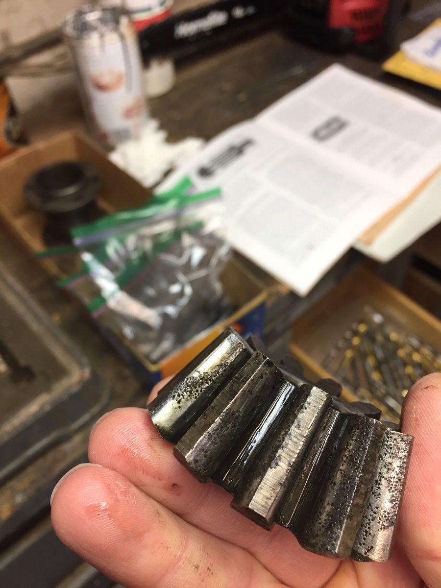

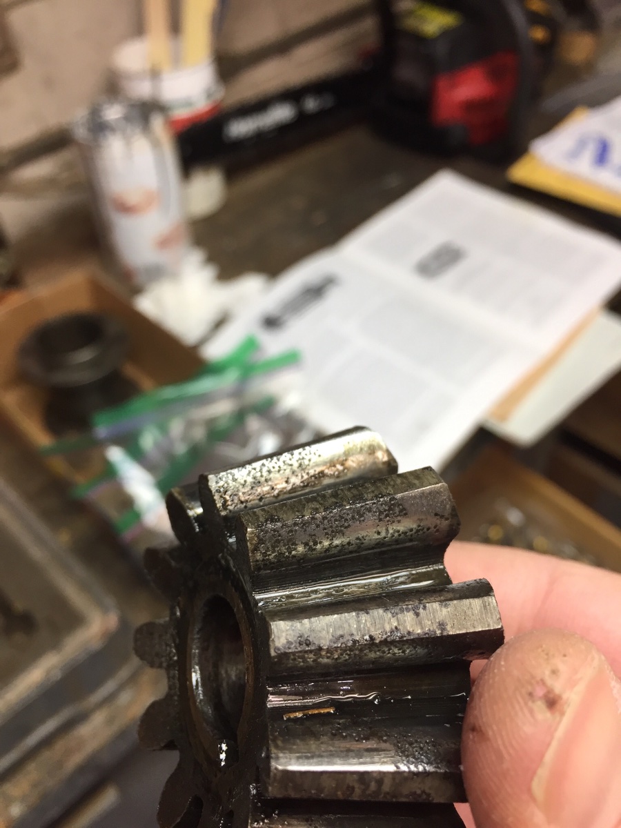

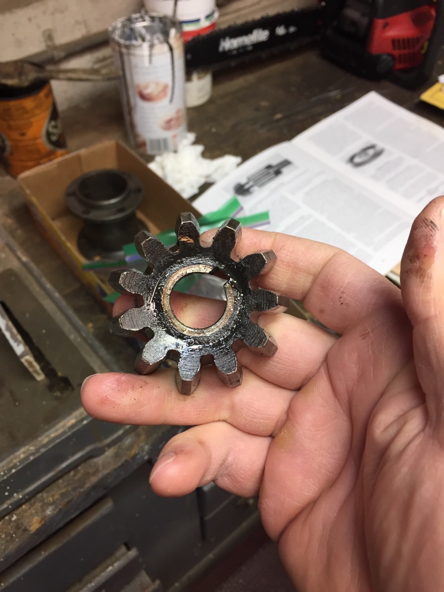

Hello All,
I am in the process of rebuilding my Ruckstell axle. The last time I had it apart was 20 years ago when I was 15 years old. Now I’ve got a little more experience (and a little more $$) to do things better this around.
Here are photos of my ring (40 tooth) and pinion gear (11 tooth). I do not have a better photo of the ring gear as we haven’t split the axle halves yet. No chips, fractures, or missing teeth. But as you can see, lots of pitting on both. The ring gear has some wear and burrs along the top edge.
As you have probably guessed, I’m looking for some opinions from the gear doctors in the house on the current condition and long term viability of these gears.
The car runs great and I am happy with the combo of Ford standard gearing with the Ruckstell. I am open to considering new gears, and would like also like to hear about any recent experience with the quality of new gears that are available from Chaffins and others.
I’ll be making a separate post about what I found while disassembling the driveshaft. It was NOT good.

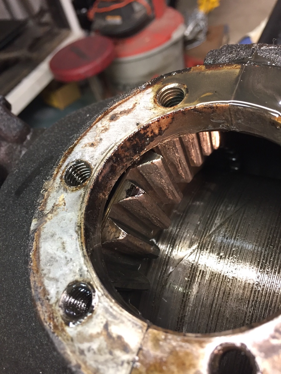

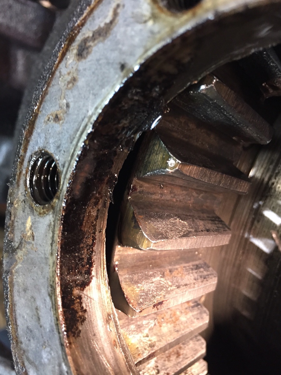

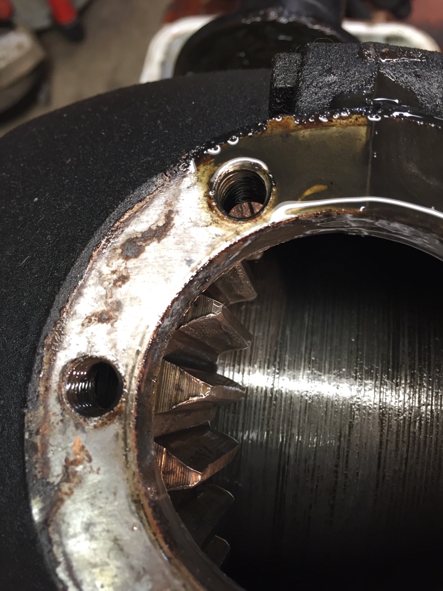

Ring gear pictures.

Dan
you did great as a 15 year old, but being older and wiser plus better endowed with $$, spring for another gearset and be a little more careful about mesh.

In the last photo it looks to me like the ring gear teeth are rather pointed on the outside edge indicating improper gear mesh. There appears to be heavier damage in that area. That pitting (fretting) is probably caused by high tooth loads; due to improper gear mesh. Fretting occurs with repeated high loads in an area over time.

It looks like Hertzian fatigue/macropitting on the crownwheel.
The pinion looks like corrosion. Could it have been like that when you assembled the axle 20 years ago?
I would replace both.
