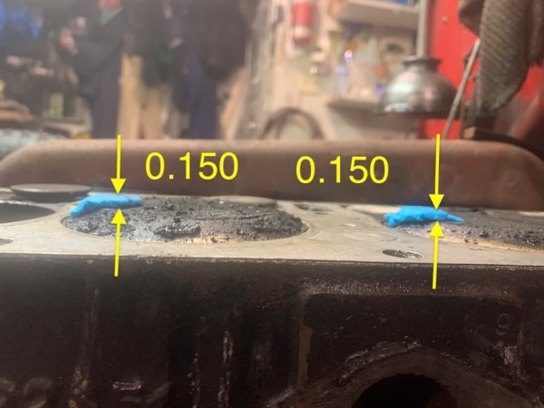

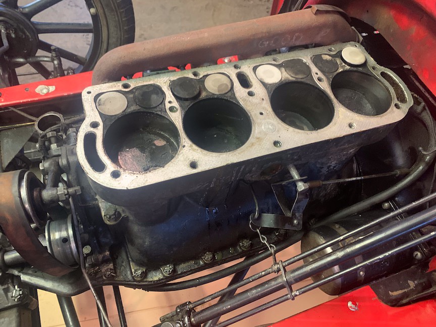

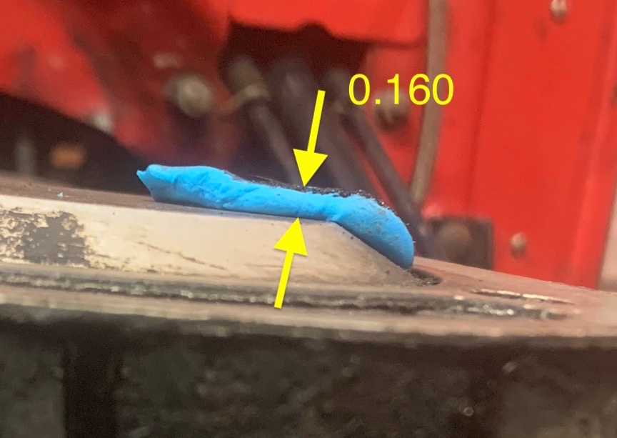

By my estimation, there is currently some 0.150" space between the pistons and the cylinder head "horseshoe" squish area. This is including the head gasket (photos below)
There looks to be ample meat in the head casting to mill, say 0.050 — 0.075 off the head.
The engine is a 1924 block with aluminum pistons, SBC valves, Stipe 280 cam, Simmons SuperPower carb and enhanced splash oiling, coupled to a period cast-iron Warford, in a medium-weight speedster.

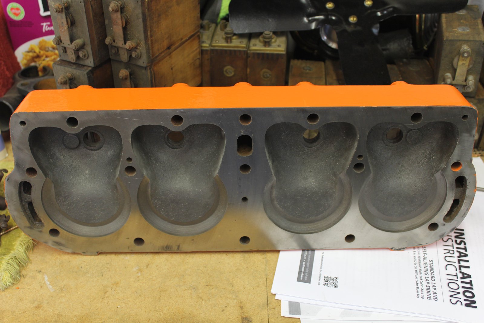

My experience with Z head was some of the pistons caused interference, needed to grind away some alum at the lip inside the Z head. The Z combustion chamber is ‘as cast’, and each chamber is slightly different. Shaving the head may cause issues.
Changed out the Z and installed a Prus head, really significant change in performance and smoother running. The Prus head has CNC machined combustion chambers, all are identical. My preferred hi—compression head now.

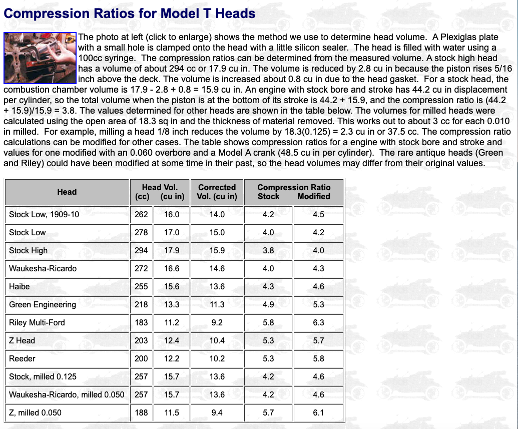

As has been noted, milling of a head with a Ricardo-squish type combustion chamber is limited by clearance over the piston. The book "Souping the Stock Engine" says better performance is achieved if the clearance does not exceed 0.090". It needs to be at least 0.040". You can easily calculated the CR change due to milling. I put some examples up at the Tulsa website years ago - http://mtfctulsa.com/Tech/head_design.htm. Milling a Z head 0.050 increased the CR from 5.3 to 5.7. The stock combustion chamber is so cavernous that milling even 0.125 increases the CR from 3.8 to only 4.2, but you still have a very poor combustion chamber design. You could fly cut the squish area above the piston, but if you go too far, the bottom deck will be too thin. The other idea is a custom popup piston, as has been mentioned. Why doesn't someone offer a true 6:1 head? Instead we have all the false advertising about 8:1 heads. - Larry Young

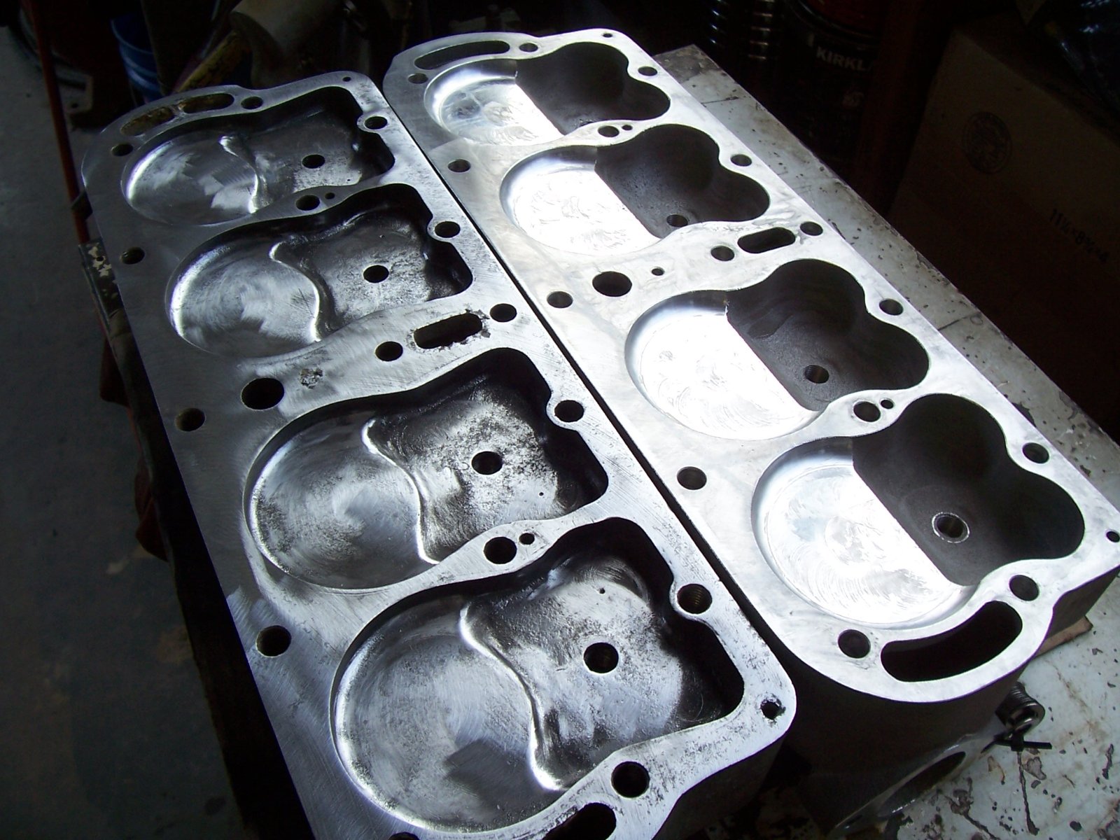

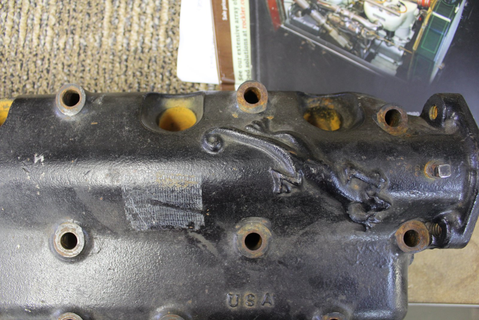

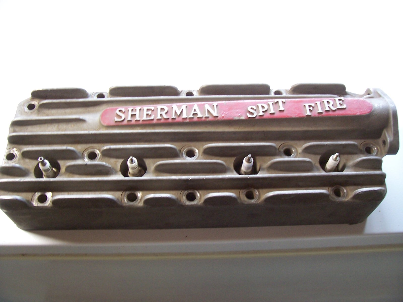

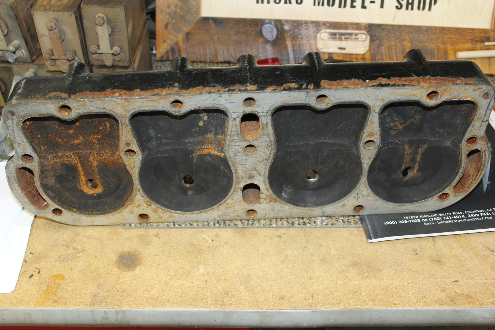

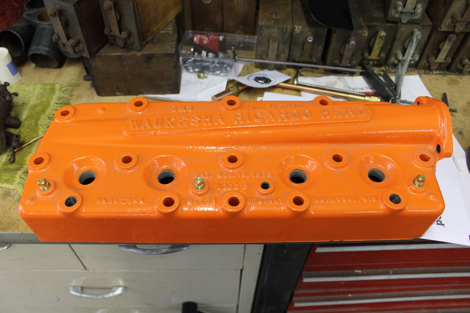

Several makes of heads that have different combustion chambers and claim high compression. A Waukesha Recardo, Sherman and a Prus.The Prus is on the right in the combustion chamber comparison photo. As you can see the Sherman has very high compression. I was told not to run it on a stock lower.

We named those Lizard heads Yapp Crapp for a reason. I cut mine in half with my chop saw and threw it on the iron pile so it would get hauled in for scrap instead of causing problems for somebody else.
IMHO or NSHO the Prus Iron head is the best of the new heads. The PRUS Aluminum head is next. Of the old ones, the Haibe Highpower - which is the same as the Giant Highpower - is the best of all. I've had a couple Waukasha heads, virtually every one I've ever found on an original engine since I started looking for them in the 50's came off a Baldwin combine power engine. I wasn't much impressed with the ones I ran.

If you check the Tulsa MTFCA club's site, they have a entire section dedicated to cylinder heads and testing. I think they tested a 'stock' Z head and one milled .050.

Further up the same page the author states the preferred clearance above the piston is 0.050-0.080". What I have now is double or more this ideal.
https://mtfctulsa.com/Tech/head_design.htm
