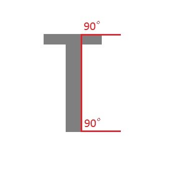

I don't understand the use of the word "Butt" in reference to machining surfaces.
Can one of you guys explain it for me?

Post by JWalters » Wed Feb 06, 2019 4:10 pm
JEC wrote:
Wed Feb 06, 2019 11:58 am
Both ends of the lifters are ground completely flat and exactly 90 degrees from the stem.

TFan
Posts: 415
First Name: Jim
Last Name: Riedy
Location: Sandusky,Ohio
Re: Pictures of why "ALL" lifters have to be Butt, New, or Used!
Post by TFan » Wed Feb 06, 2019 11:34 pm
In my experience we would call that faced. Jim

You Face the Valve head, and Face the seat, and butt the valve stem.

I'm just talking general machining not just valves. Jim
