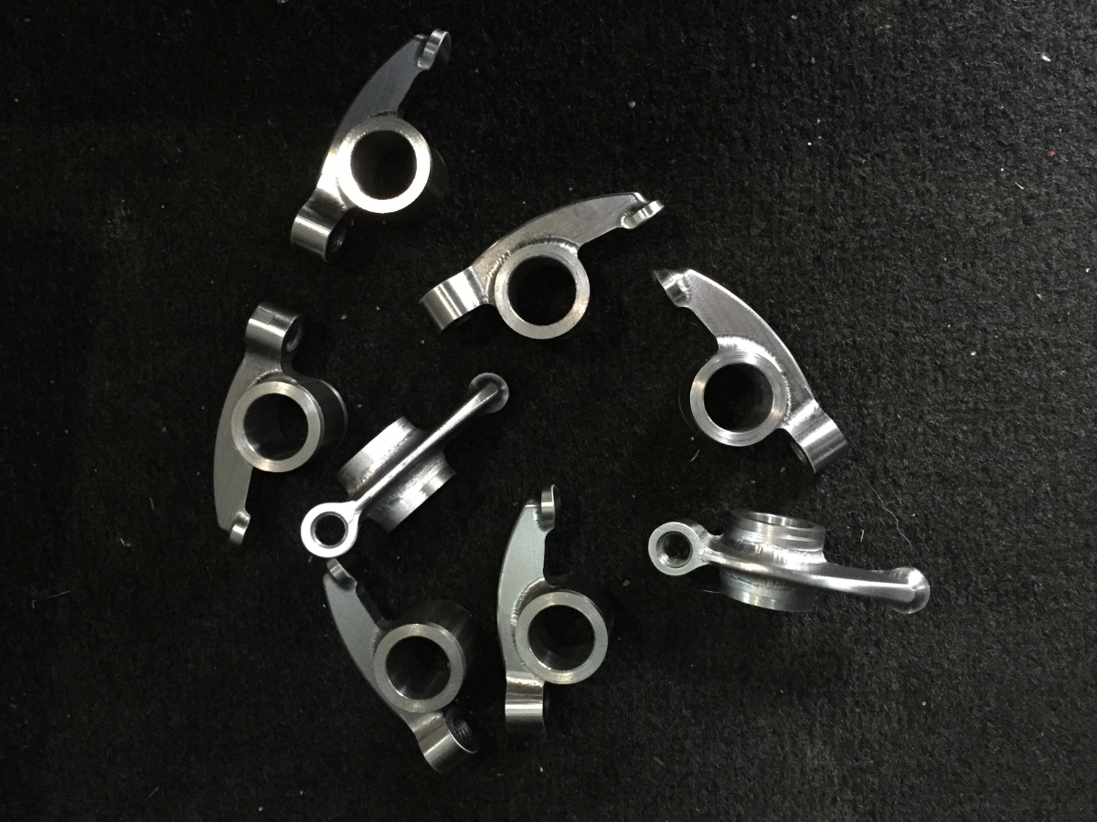

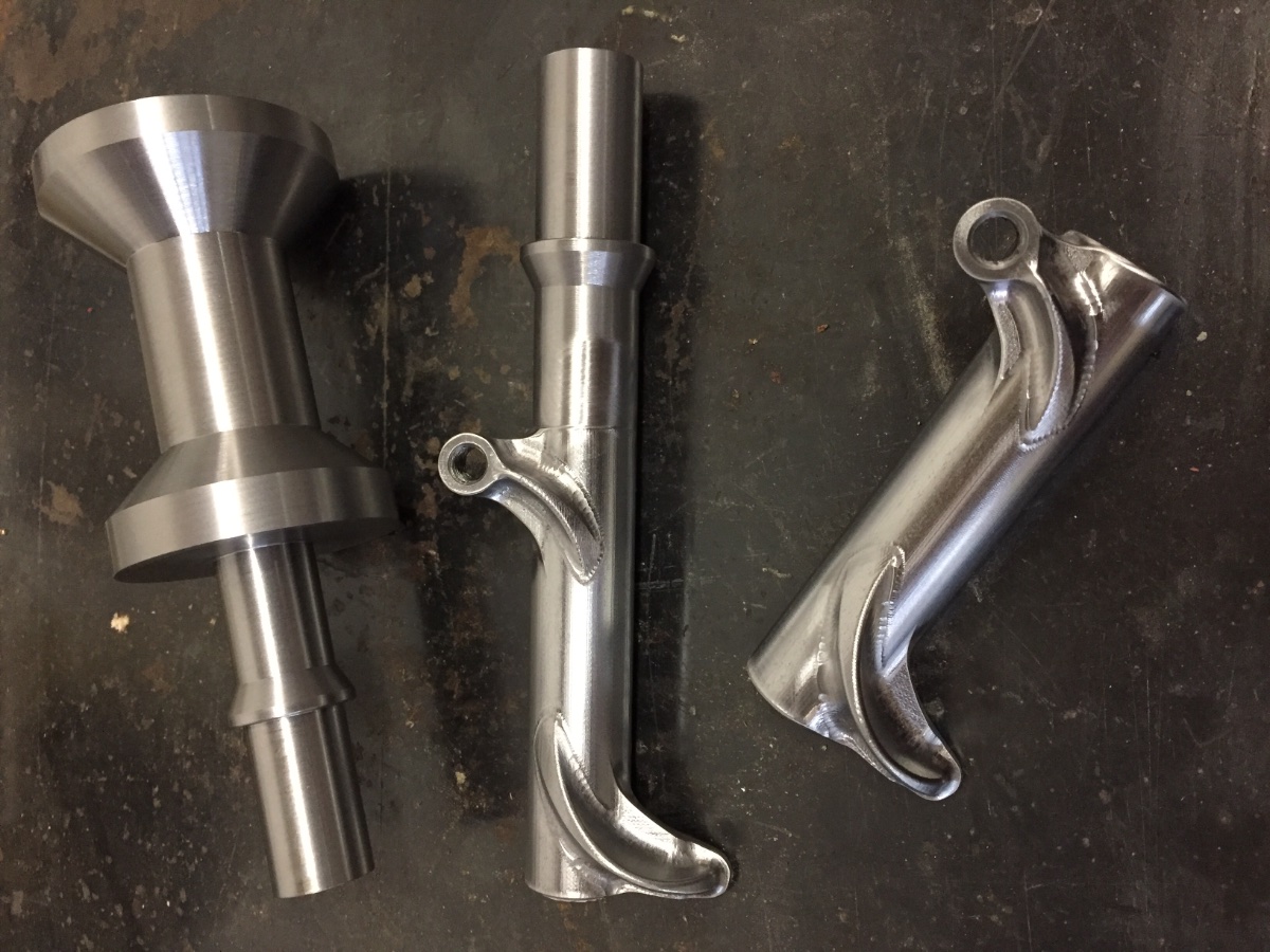

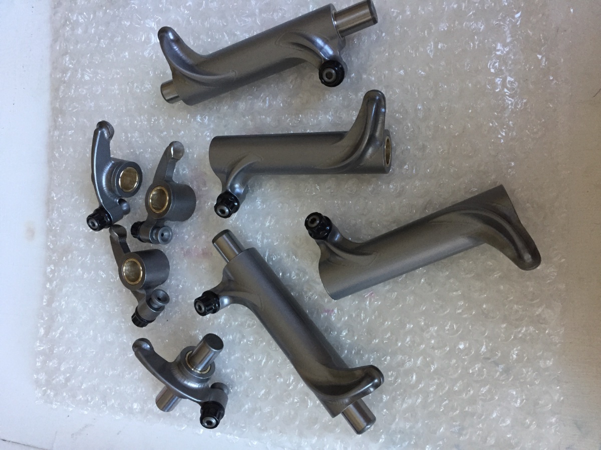

I custom designed and manufactured these rocker arms to retrofit my Akron-Hed from the original ball bearing push rod tubes, over to a (hopefully) more reliable conventional rocker arm design. RAU was able to take on the project with confidence, and performed the task without fault or complications.
The rockers were machined from normalized chromoly steel and I had a concern about material hardness at the valve stem friction surface. RAU flame hardened the tips of the rockers, bead blasted, bushed, honed, and ground the tips, all with beautiful results. They also set me up with the new adjuster screws, and all for a quite reasonable price.
The project took about 4 weeks to turn around, and I am grateful for their help

Lovely work. Thanks for sharing Kevin.

I had heard negative stories, and good stories too. And there is no doubt I was skeptical going in. But I figured they were only 3 hours away if I had to resort to plan B. I had several phone conversations with them to feel em out, and they were friendly and knowledgeable.
This project was in no way “normal” and I wasn’t sure they would even have tooling to complete the job. This was my first time dealing with them directly, and they did nice work. I am pretty picky when it comes to my own machine work, and I tend to be critical of others machine work too... and so I felt they deserved a kudos this time

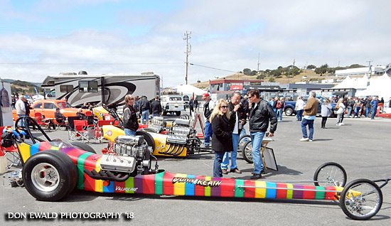

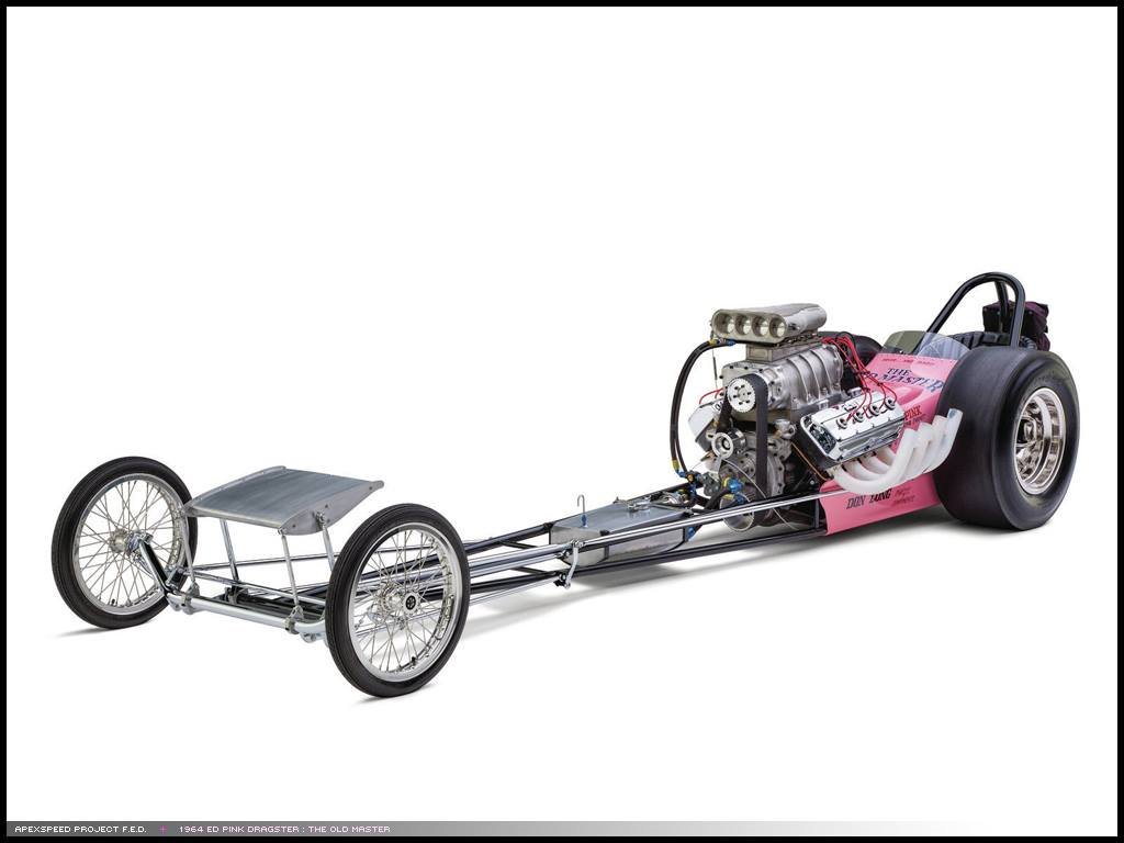

Kevin, they do the rocker arms for my vintage dragster restorations, Always had a good experience .
