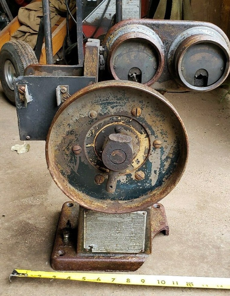

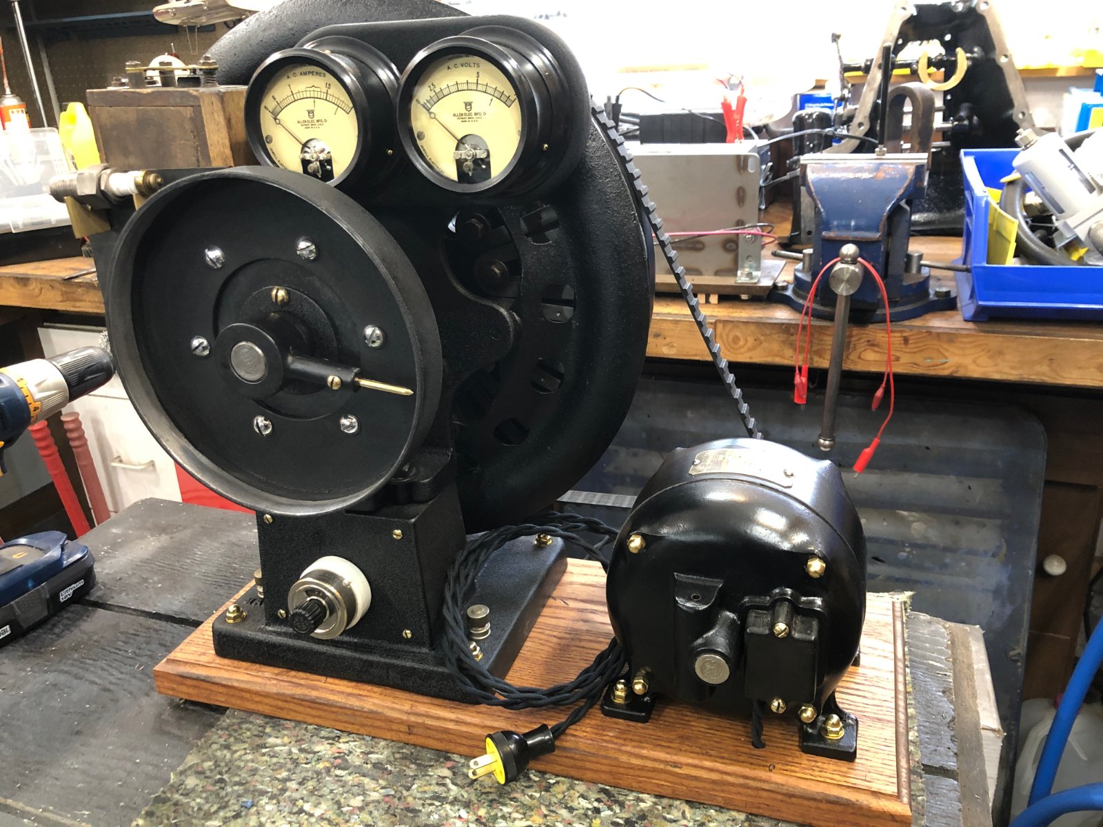

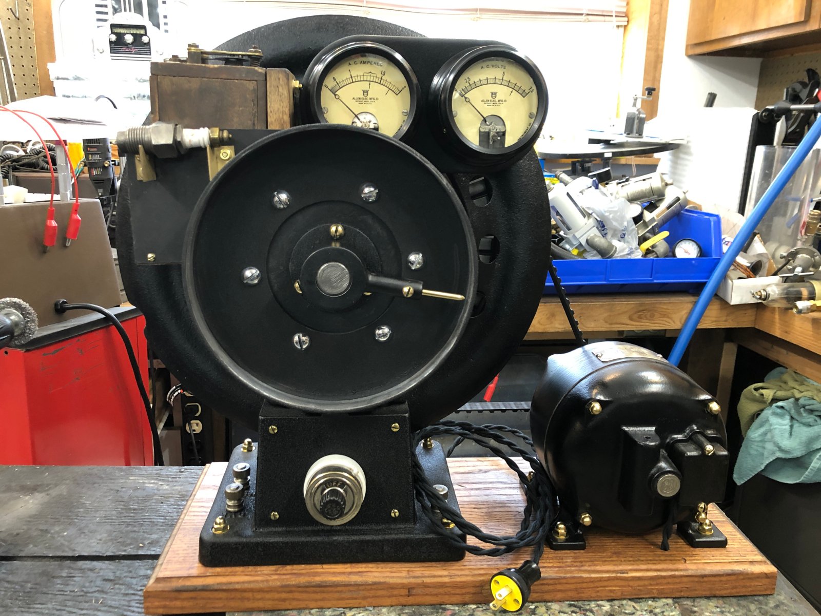

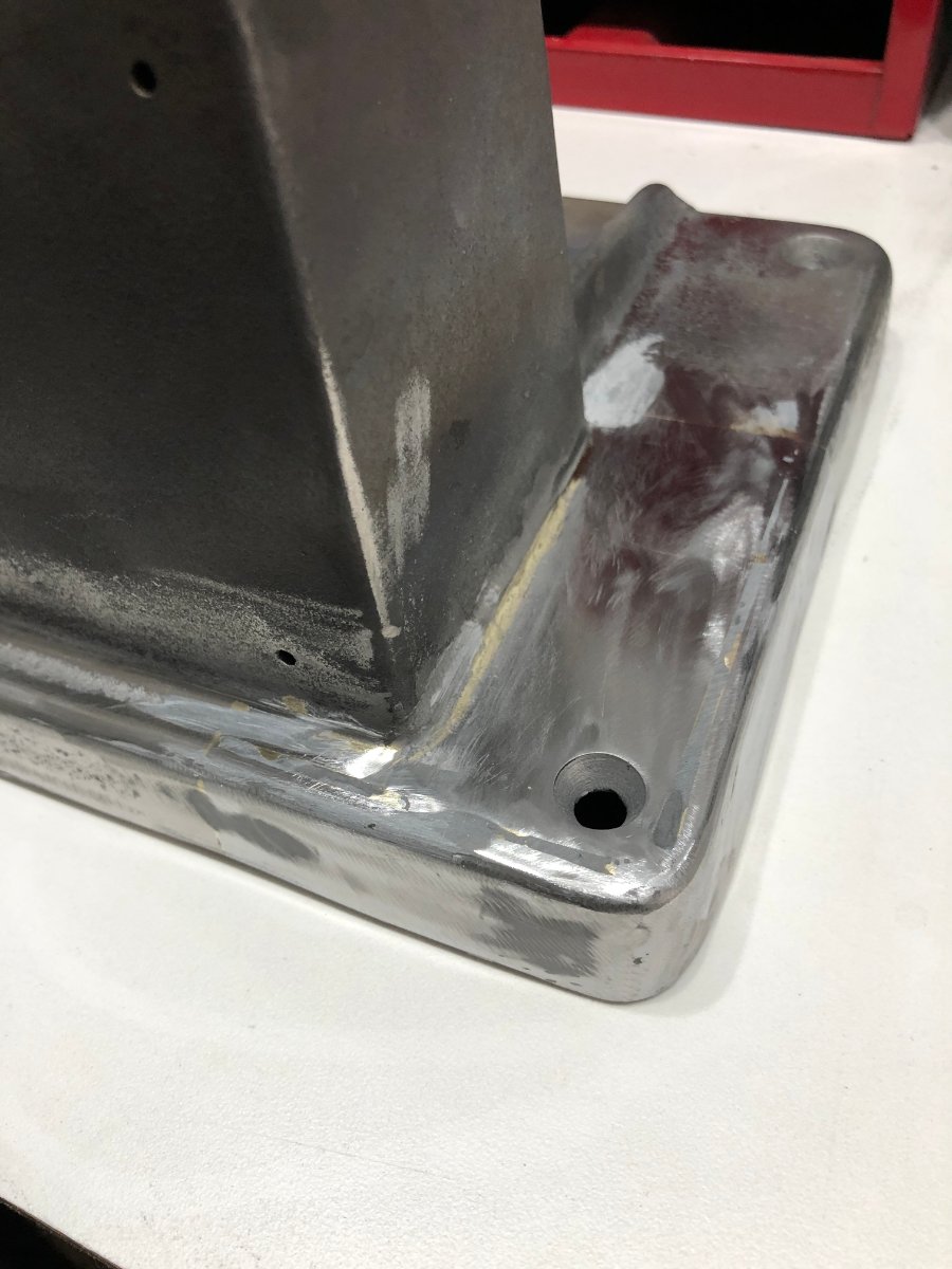

I finally finished my HCCT #2 - A motorized Allen Electric unit.
Allen Electric never made a motorized HCCT - Only KR Wilson did.
I did use the same exact motor that the KRW unit has.
So, in that vane, it is "Period Correct".

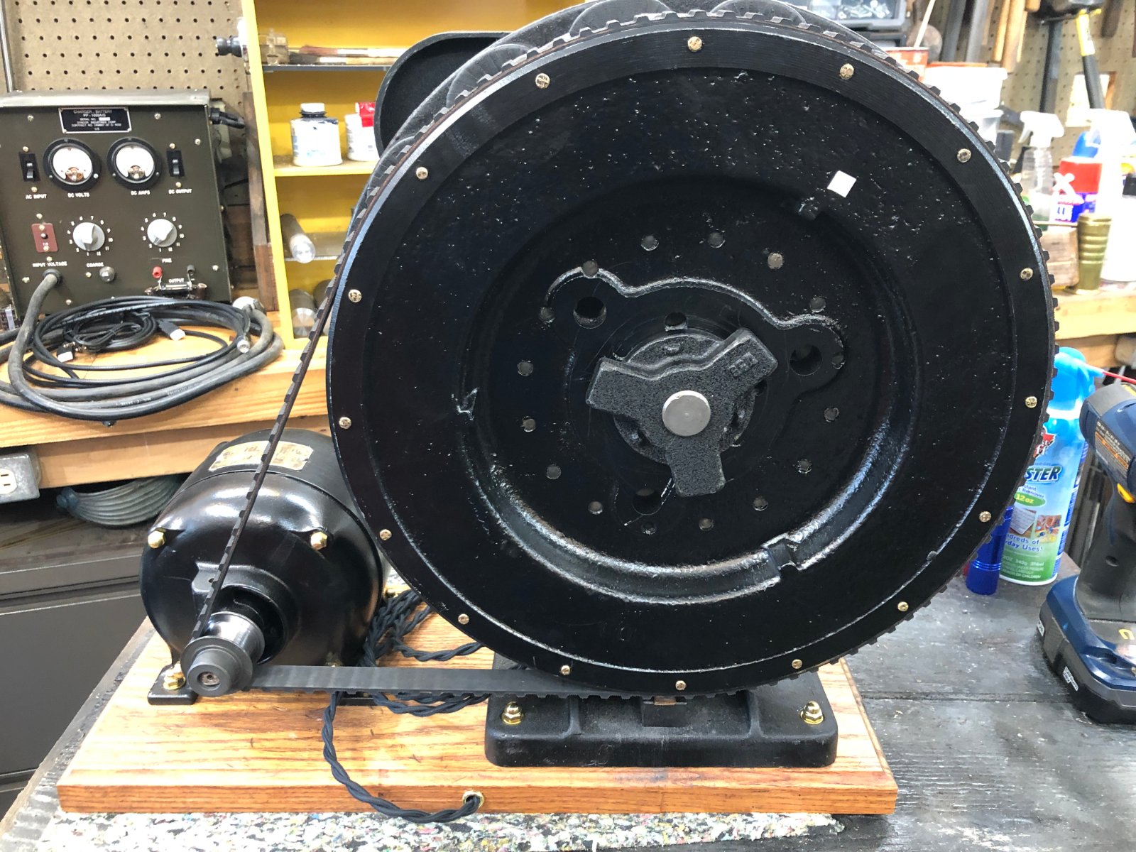

The final RPM of the flywheel is 157 RPM.
BEFORE AFTER
BEFORE AFTER

Lovely work and great choice on the motor. I have that model in 1/3 HP powering a 9" lathe and it is a sweet, smooth and quiet motor.
BE_ZERO_BE
Topic author - Posts: 663
- First Name: BOB
- Last Name: CASCISA
- Location: POULSBO, WA
Re: My HCCT #2 - From Junk to Done
Scott,
It's a GE 1/4 HP, 1725 RPM, 110 Volt motor made in Schenectady, NY.

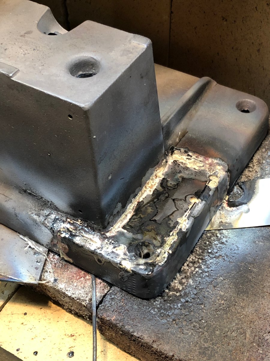

Looks great. How did you add the missing area of the casting?
BE_ZERO_BE
- First Name: BOB
I had a machinist friend do the work.
He squared off the broken area and made a piece to fit.
It is siver-soldered in place.
