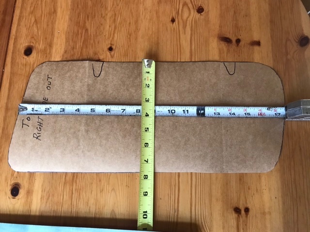

Does anyone have the dimensions for the glass? I guess I can fudge it but I'd rather get it right! Thanks.

While no glass dimensions are given in the Service Bulletin, you might get close to extrapolate them from the sketch and measures of the clamp placements.

Thanks for the information. I think I have a template on the way!

Topic author - Posts: 466
- First Name: Val
- Last Name: Soupios
- Location: Jupiter Florida
Re: Wind wings
Steve, here is the template I received. I don't have access to my car right now so I can't hold it in place to see how it looks but it seems to be very close to the glass pictured in the Ford brochure posted earlier in this thread. The bottom of the glass is somewhat rounded on the template but I would probably make it parallel with the top. Hope this helps.

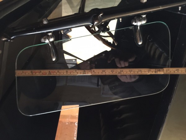

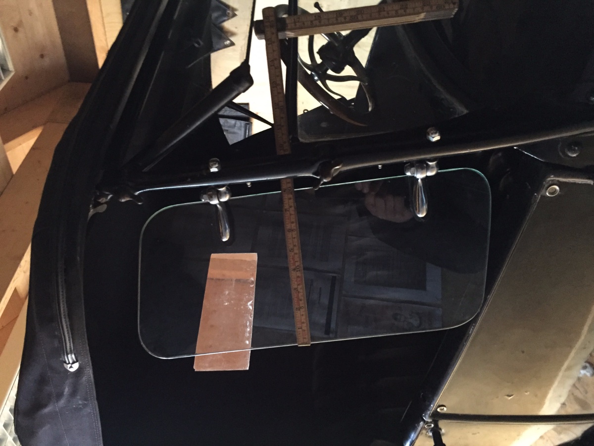

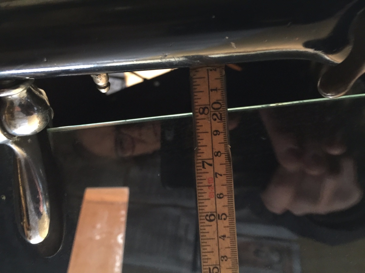

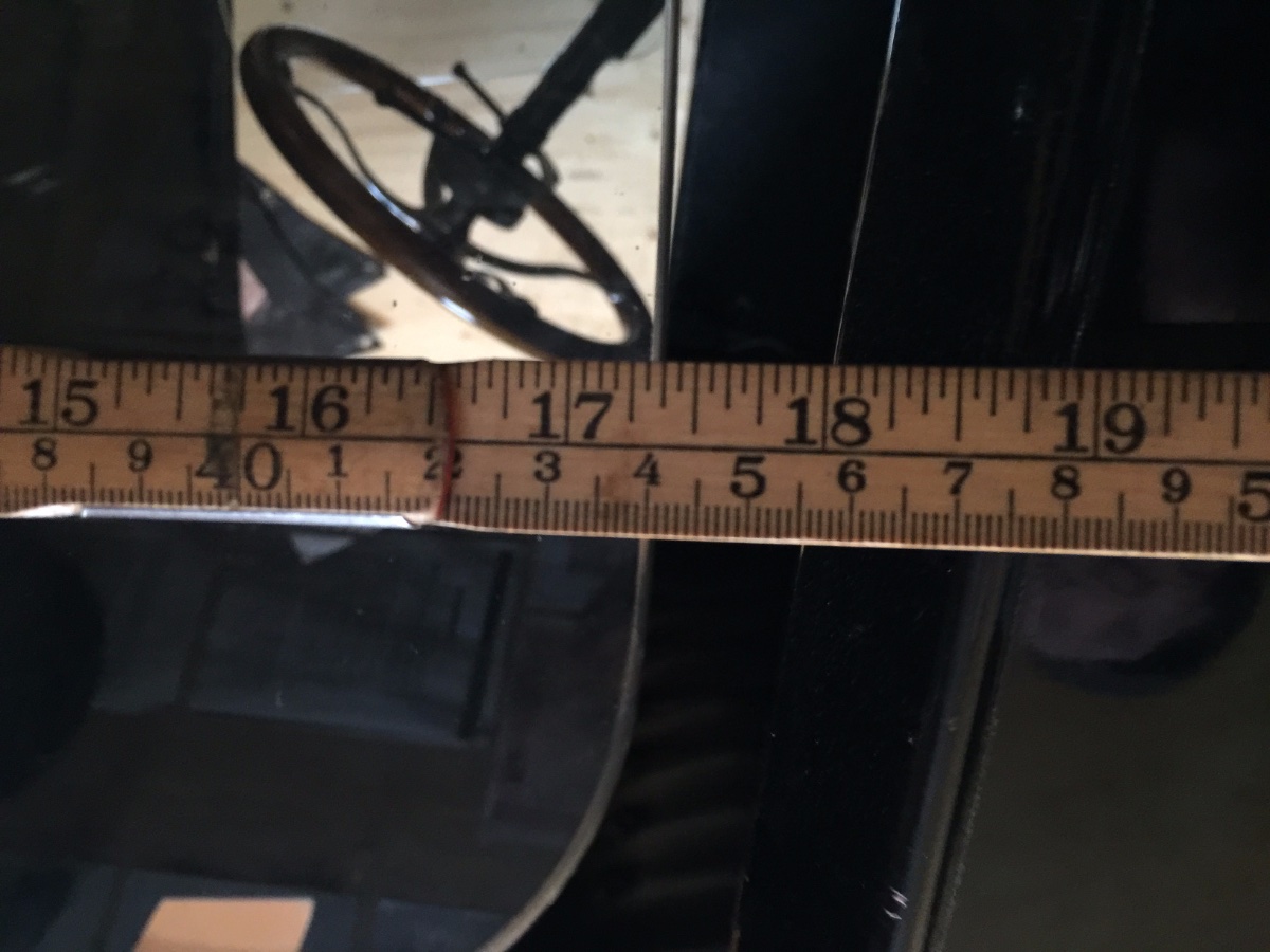

Re: Wind wings
Hi. Took some pictures of my 26 roadster. Seems the sides are parallel sideways and up-down. 200mm X 440mm.
