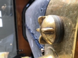

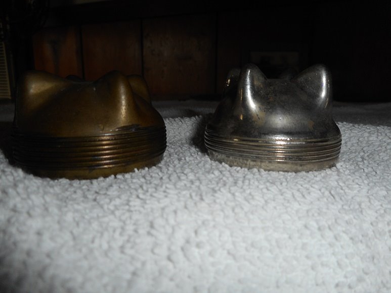

I thought perhaps some pictures might help. This is the pressed cap on my ‘13, presumed to be correct by two previous owners.

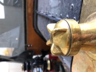

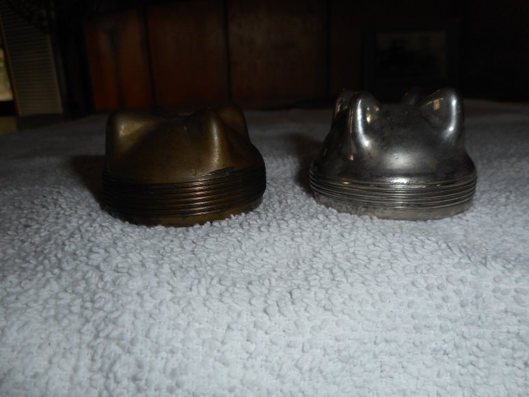

This one was given to me as “authentic 1913” by a friend who lost his ‘13 in a tragic fire. Small differences may be due to wear ?

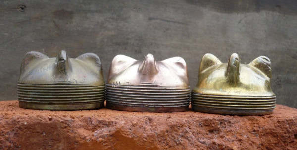

Last, both are pressed brass, bottom edges look the same. I know very early caps had very high, sharp, thin fins; I don’t know if these qualify as “high fin” caps, or unequivocally “1913” correct, but I do recall the later nickeled ones had lower, more rounded “fins”, and the “dome” beneath was a different shape. ??
Cast reproductions look like none of the above to my eyes.

Thank you Rich B for the photos! I wish I could figure out a good way to get pictures from my camera onto the computer. Once on the computer, I have no trouble posting them. But ever since my old (2005?) digital camera died about three or four years ago, both our new cameras have the most idiotically designed programs for downloading the photos onto my computer! NO options, NO choices where I want them. Once downloaded they are automatically ERASED from the camera whether I want them erased or not! The program puts them ANYWHERE! In specific folders they do NOT belong, in letter files, even in the word processing program!
(I think I have been stuck inside TOO-OO long!)
I have trouble thinking of the radiator caps as "high fin" and "low fin". There are simply too many variations on the stamped fin caps. Some dimple in from the threads to a sharp dome, others have a smoother transition into a gentler dome. The height of the fins vary considerably. I one time had four stamped radiator caps together that were all different. All of them were OLD!
Some of them may have been unauthorized replacements?
Certainly, the earlier cast brass and "high fin" caps were 1909 into 1912, but even in those, variations abound.
In the stamped brass caps. I would tend to think the two pictured by Rich B are earlier versions. While they are different, both have the smooth transition from the threads to a gentler dome than the much more common plated caps that came later. The second picture posted has the lower fins. The fins barely rise above the dome. Pure speculation on my part, I would think that one may be the earliest version of the stamped radiator caps. My reasoning is simply that this cap is more different than anything that came later. I am not sure but that one of the caps I have the fins don't rise quite even that much.
Rich B's first picture has somewhat higher fins. While the dome is different from the millions of later caps, the fins are getting close. Careful examination does show many later caps to have slightly even higher and sharper fin stampings.

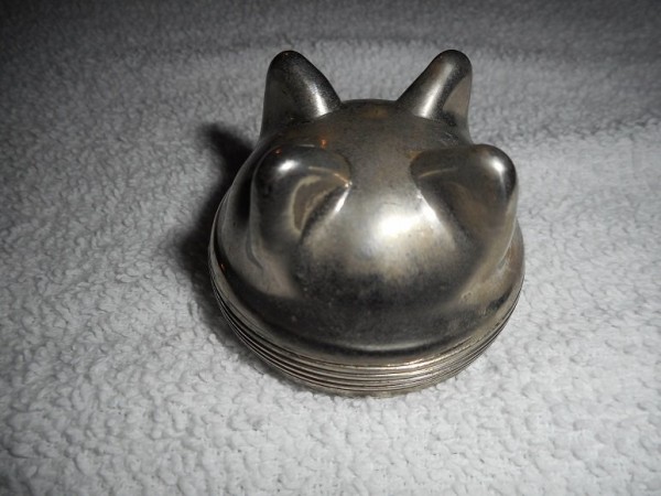

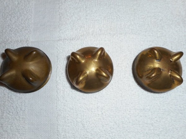

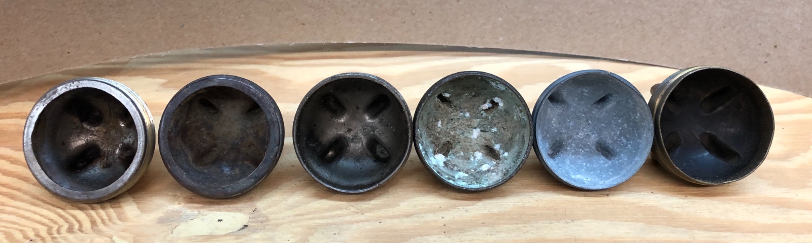

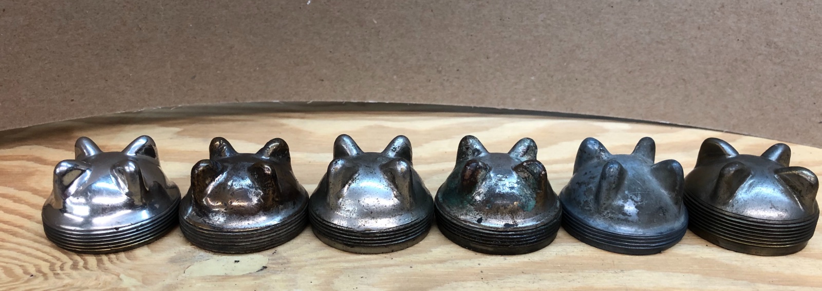

Here are some pictures of some of my radiator caps. I'm not good at taking photos as many of our members are. Please forgive me. The point I'm trying to make here is all Model T radiator caps are not the same as the judging guideline say!

Like the one that is rounded over on the inside bottom. Would work much better with the rubber doughnut gasket.

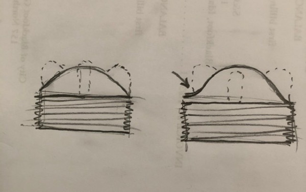

The "27 style" radiator cap with the flange at the bottom is an example of something I have noticed during my studies of 26-27 improved models. The more I dig into the Improved models the more I think the Improved models were a "test run" for the Model A. Most common belief is that the Improved models were a last effort by Henry to save his "baby". While I believe that may be a small part of the story, I think it was more of a test run to see if it was possible to "totally" re-tool the factory. And if the Improved model was too much of a hurdle to make, then they at least still had a Model T to easily fall back on. One of the things that keeps showing up seems to be , that every part of the Improved T was changed in some form or another. Even if there was no real need to change the part. It was almost like a "memo" was sent out to all departments of the factory to change their part in some way. Sometimes the change is subtle. Something like adding a flange to a radiator cap. With everything going on at the time, adding a flange to a radiator cap seems like something that should not be a concern at that time. So far every single part of the Improved model I have studied, there is a 26-27 version of the part. Sometimes the change happened during the 25 model year. Does anyone know of any part that was not changed on the Improved models. ?? Remember that the change may be subtle. It may just be how it is machined or manufactured. Ill use the cylinder head as an example. All they really did was "remove" the FORD script from the casting. I have not studied all the small things like nuts and bolts, but even those appear to be changed as to machining techniques. So I'm asking someone to find me a part that was not changed. Like I said, these are my personal opinions so far. But the more I dig, the more it seems to confirm my suspicions.

Great info , Donnie. Don’s NOS cap has the rolled edge. It certainly added a step in the manufacturing process or complicated the tooling, and we all know Henry didn’t waste steps. It WAS an improvement for the improved car. ( wow, I’ll never get it back from Don now!)

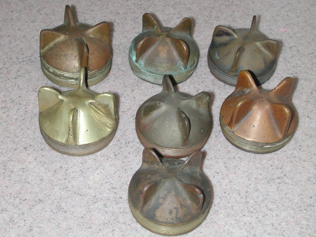

Posted before on old forum but now you get to see it full size. This is the cap on my 13 touring.

Bob, your cap on the 1913 looks much like the later high fin caps. Those with which I am familiar are cosiderably lower in the fin on the 1913-??? early style ones.

This is a fun thread, seems just the thing for research at Benson Ford records, but, no travels
now.
Would think good idea to define 'high fin'. To me the high fin are the early radiator caps with fins high and wide. This photo from forum discussion years ago:
To me, these are high. And now hard to know mfg. date or aftermarket, as Ford didn't scrip these caps in my knowledge, which is bit limited to just removing hot caps without having burned fingers
But for fun took this photo today of some of my caps, and lined them up to look it closely.
Click on all photos to enlarge them for details.
These are regular caps to me, and are made similar, but #1 on the right is heavy brass, and #2 on the right is lightweight alum or zinc ?cast, likely made in the '18 period, as some hub caps then were made of the same material too. The ones on the far left have the 'rim' under, these exhibit a more machined rim. Seems the 'rounded or rolled over' under rim of the cap shown in posts above is likely the '26 Improved version. Think these on the right end in my picture are maybe from '25 period. Who knows, need to do more investigation, if what Bruce found is the only change order info, don't know.
Bruce's C-D Encylopedia
6/4/18 Redesigned and changed material from Die-casting alloy to “S” brass. Caps to be nickel plated and polished on the outside. “This change makes the design of the cap the same as T-1103-B (the pre-1917 brass radiator cap), we have therefore specified the same size of stock that is being used for T-1103-B, also that these caps be made because the aluminum in the die cast cap corrodes too easily and is to take effect at
once. Die cast caps to be used up.”
8/20/26 A flange was added at the bottom of the cap
where it contacts the radiator cap gasket.
Here is the inside of each:
Finally, lined up with a straight edge to show the caps in center and on the end that lightweight one on the left from 1918 have 'taller' fins, but just a tad. Guess this is what the discussion is about

Thanks Dan for the post. You are far better at taking photos than I! Your stick on top of all the caps proves there was a change, and that is the point I'm trying to make. Now, I wonder if we are going to have to wait for the next edition for the guidelines to see this happen. or are they going to fight me like that did on the 1916 Ford script oil breather caps?

Re: Radiator Caps
Even the two '1913' caps I have are different.
The old forums are a gold mine of information.

Re: Radiator Caps
Thanks very much for posting that picture Dale ! More variations in shape than I’ve been aware of before. This is starting to be fun, and the kind of thing that may well defy efforts to identify any “year correct” cap styles. It would be fun to know, if possible, if outside vendors provided them, who they were, and if eventually they were made “in house” and when. We really can’t have too much production minutiae - obsessive minds need to know !

Those caps where the threads start to climb up the ears are the real thing. I wonder when in 1912, Ford adopted this style of cap from the cast ones?

Those two on the left in Dale's photo are the type I thought Bob McDaniel on his 1913. Larry, was the changeover from cast caps to this type made in 1912? Perhaps my September 12 van should have one instead of the cast one I have for it.
