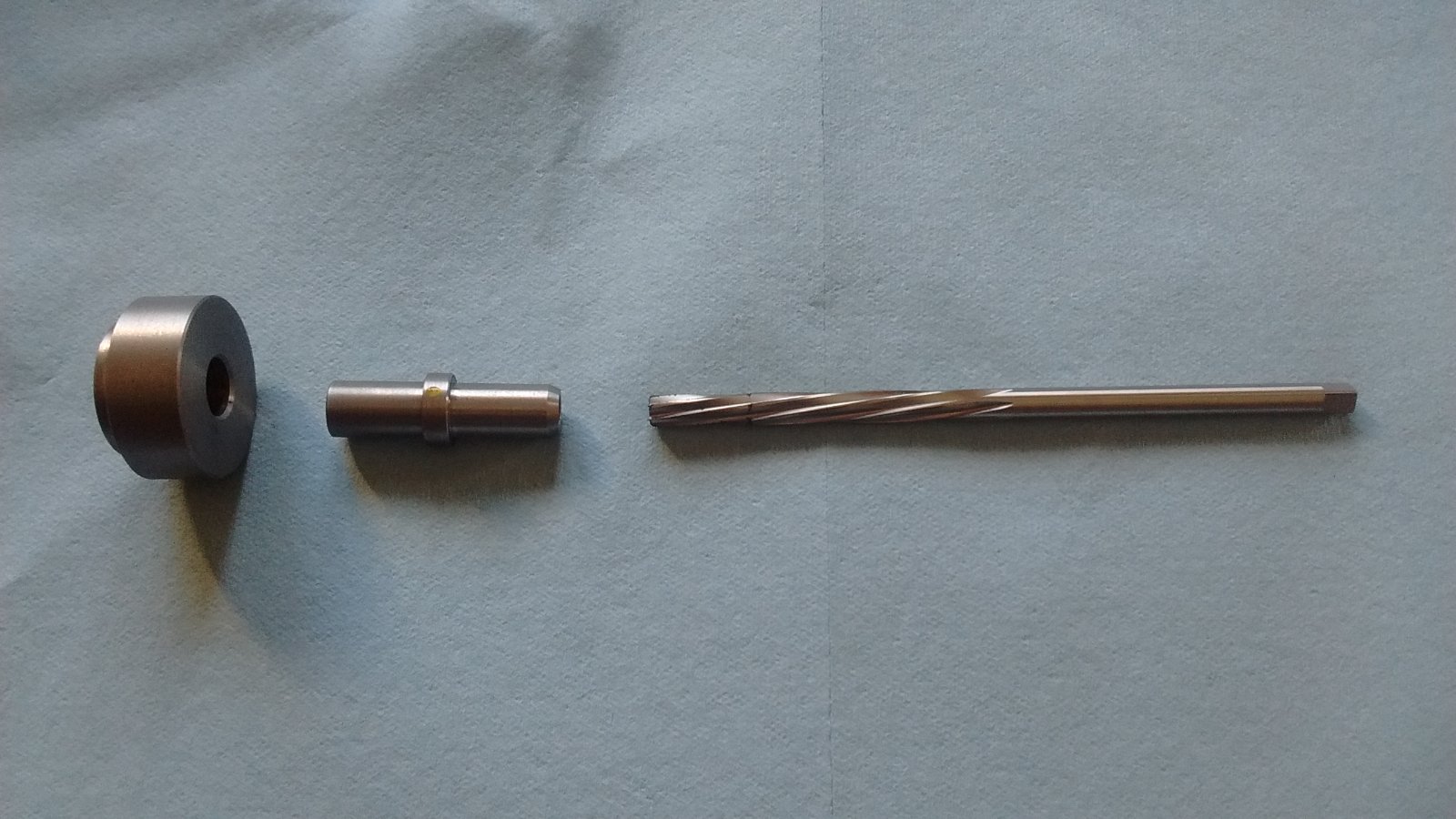

Be aware that the reamer requires a guide that fits in the valve head hole. Otherwise, the reamer can get tilted during the operation. Any machinist should be able to make one for you from mild steel, so that it's a "light" fit in the portion of the hole that is straight. After installing the guide, you simply run the reamer through the hole in its center, insuring a straight path. Go easy, never backwards and blow chips out as the reamer goes down.

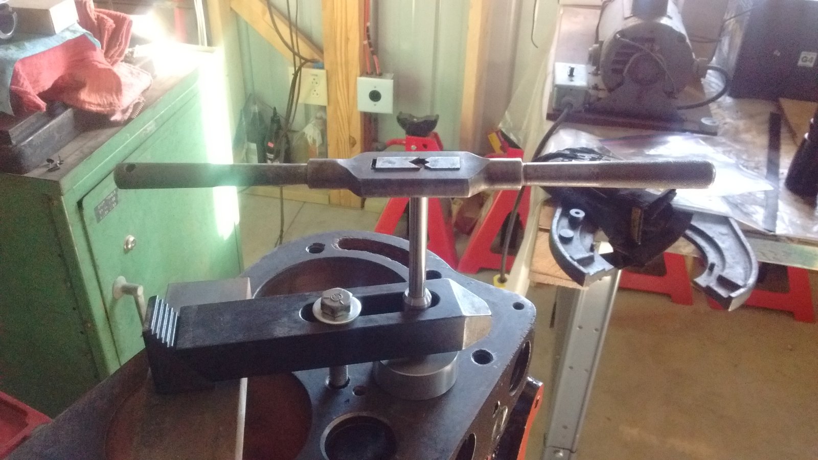

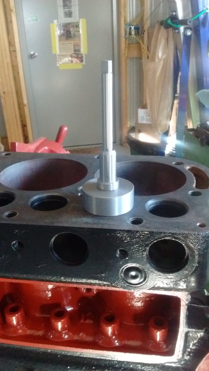

This is what George is talking about. Just did a quick refresh on a pretty good engine that came with a blown up Mag. Engine ran very well with no oil burning except for a "puff" of smoke when it was first started. Decided to renew worn guides while I was at it. This is my setup...Use of the piloted reamer by hand requires diligent attention to keep it cutting with each revolution. This will cut a true-sized hole. If you just fart around and talk to your pal while lightly spinning this reamer, you will end up with results that you will not be happy with.
