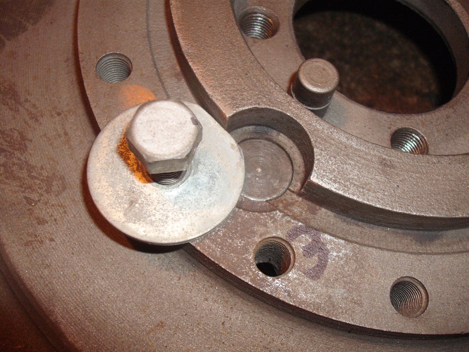

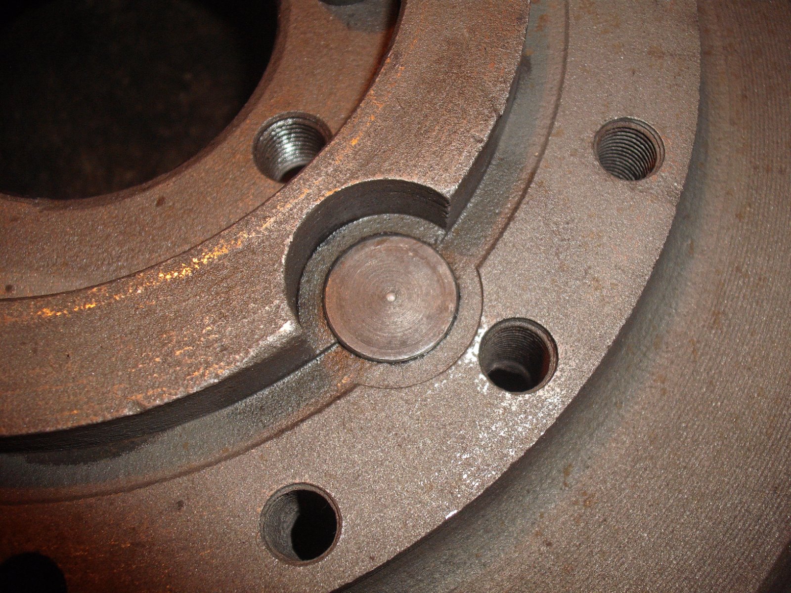

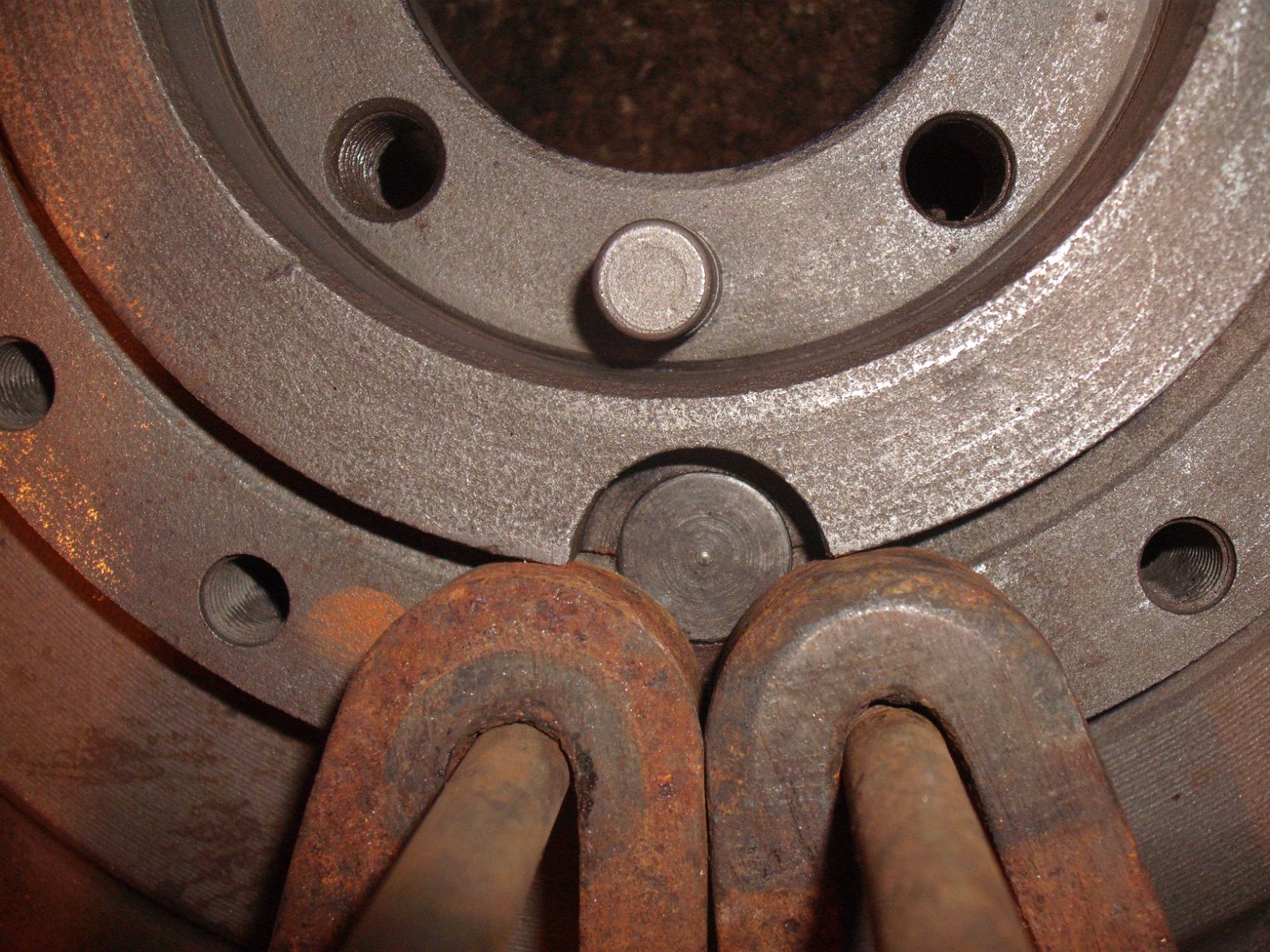

I am building the speedster engine. I think I just dodged a bullet today ... Today I was riveting the ring gear bolts in place that hold the ring gear and the 16 spools that Im using for oil slingers. While riveting the bolts one of the triple gear pins fell out. I thought they were in good shape. No wear at all and no signs of looseness. So today I ordered the new triple gear pins, and hope the old ones were not already oversize. If they are then Ill find a good flywheel. Does anyone know the size of a stock triple gear pin where it fits the flywheel. ?? I know they are tapered, so it may be a trick to measure them ...
All this got me thinking. (dangerous). What if I had missed it and the pin backed out while running. It would have been a total loss. So is there any way the speedster guys running no magnets handle this problem. Or does everyone just "trust" the press fit. Im thinking of using a washer and bolt at each pin. A thick washer made like a fender washer will cover the end of the pin and keep it from backing all the way out. It does not have to hold anything, just stop it from backing out in case a pin worked loose. . I can use three washers, three bolts, held in place with "LockTite" and then safety wire the three bolt heads together. I will pay attention to the weight of the parts to keep everything in balance.
One of my pictures shows how Ford used the magnets to act as a safety. I have seen way too many loose triple gear pins to feel comfortable with no safety of some sort. This is my first engine with no magnets. So any help, ideas, information about how others may have addressed this problem ...

Capturing the pins with a large washer & bolt is one procedure - another which I use & prefer I and I believe to be the best is a collar available (is/was?) from Dan McEachern - no way anything is "coming from together" with one of his gizmos !

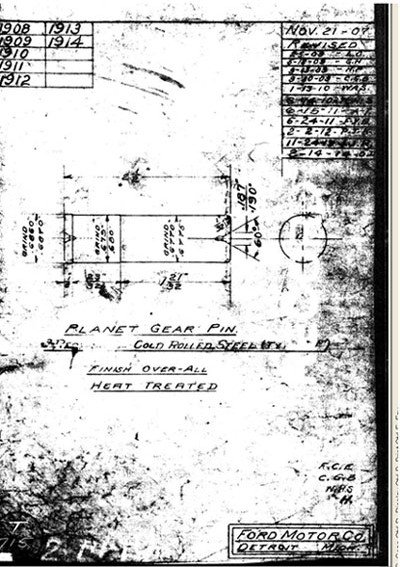

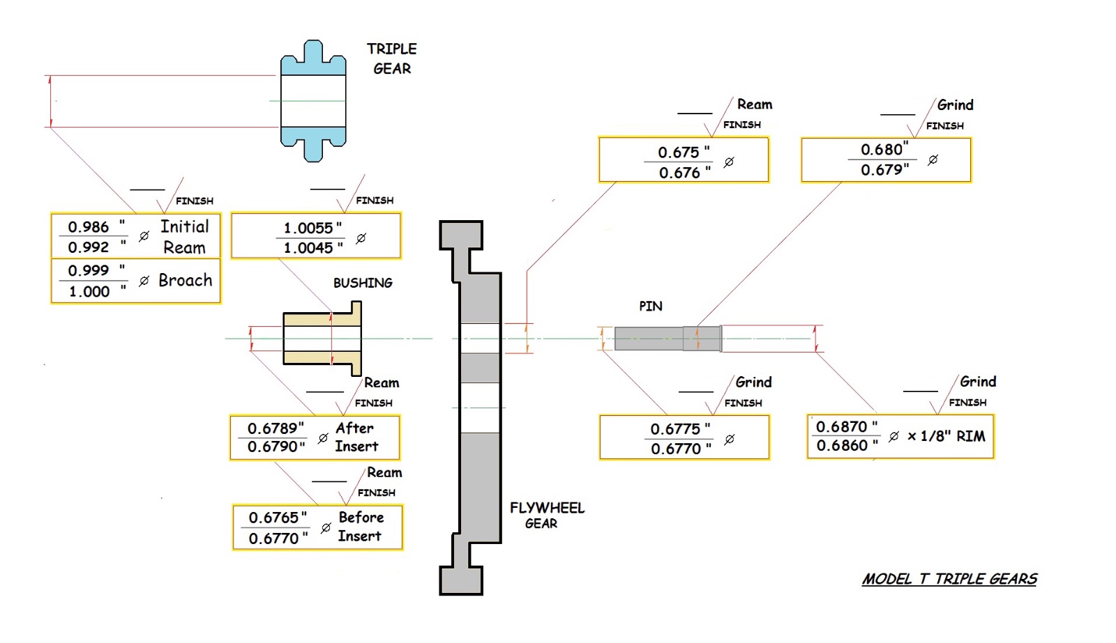

Back to your original question.
Here are the original factory dimensions and tolerances for the triple gear system parts as a reference.
Three points to consider before trying to interpret this drawing...
1- I don't think that the two pin suppliers today make pins to the original drawing specifications.
2- I have fully convinced myself that as surprising as it may seem, Ford DID hold transmission parts to the 4th decimal place on repeatability in manufacture and only used some 2/3 of that 4th digit range.
3- You'll notice a 'bullet rim' on the tail of a pin. This was apparently to seat lock the pin in the wheel. If someone tried to push a pin out into the gear side, it would have been tough, but if they just got a bigger press and got it out you can bet the fly-wheel hole got bigger in the process.

This is my first engine build with no magnets. So I am far from being an expert on the subject. I missed the fact that the pins could back out until my pin "fell out" while riveting the ring gear. Then I had that "bad feeling in my stomach" of Oh Crap I just dodged a bullet. I have rebuilt lots of engines thru the years and never gave any thought to the pins backing out. After all the magnets will not let that happen, and all my engines had full magnetos installed. . I always just checked the pins and replaced as needed. Mine were like new, no wear. and did not appear loose. This engine was rebuilt sometime in the 70s 80s era and has been running with no mag and no pin retaining system of any kind. Just by luck or the grace of god that the pin did not cause catastrophic failure.
I have seen quiet a few "loose pins" thru the years of tearing down engines. So I know it is a somewhat common occurrence. I have ordered Dan's pin retaining ring. It should solve any problems with the pins backing out. Ill try to remember to post photos when I get the ring installed.
Thanks for the specification drawing, The Ford service manual says that the pins need to be .003 larger where they fit into the flywheel. That is to make up for the holes being enlarged by driving out the old pins.

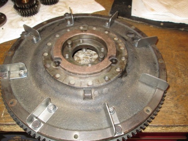

Somewhere I have a photo of the collar installed on my engine - here's what Dan's oil slingers look like installed - I'm still looking !

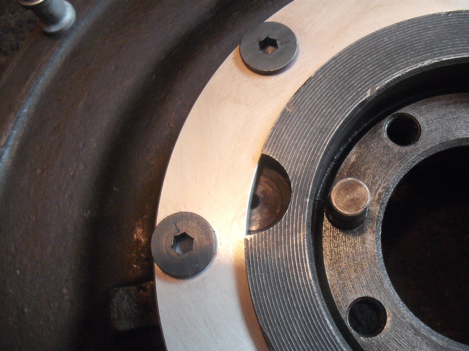

OK, heres the deal. I finally got to my T today to install the retainer plate made by Dan McEachern (which by the way is top notch, well engineered/manufactured part). Being that my engine and transmission was just rebuilt/installed prior to reading this post and it hasn't the magnets installed due to me running a distributor set up, and nothing backing the triple gear pins, I was concerned of the possibility of one of the pins backing out. Being that Dans retainer ring is suppose to be installed BEFORE the tranny is bolted to the crank because it is just that, a complete round ring (like a donut), I was wondering if I cut it into 4 exact measured/weighed pieces and went through the oil pan inspection cover, if there would be enough room to install them. A kinda tight fit but yes, it is doable. Easy peasy? Not so fast. I forgot the oil slingers I had installed on the flywheel which bolts up to the flywheel in 4 of the holes which the retaining ring would go into also. Still no problem. The problem comes in is where the oil slingers bolt onto the outer edge of the flywheel, I had to remove the starter to gain access to those (8) bolts in total. Tomorrow (?), I am going to mill the ends of the oil slingers where it bolts up to the flywheel to compensate for the height of the retainer ring and get it back together.

Autie, Sounds like you are making progress. If you cut the retainer ring in four pieces and label them as to where they originally were when solid and then install them in that order on the flywheel , I do not think weighing them will be needed. As an added protection I also used locktite on the screws Dan supplies. His ring is really a nice piece.
Here is the only pic I seem to have taken while I was installing his ring on my engine. I would highly recommend using his product when building a engine with no magnets. Thanks Dan for such a nice product.
