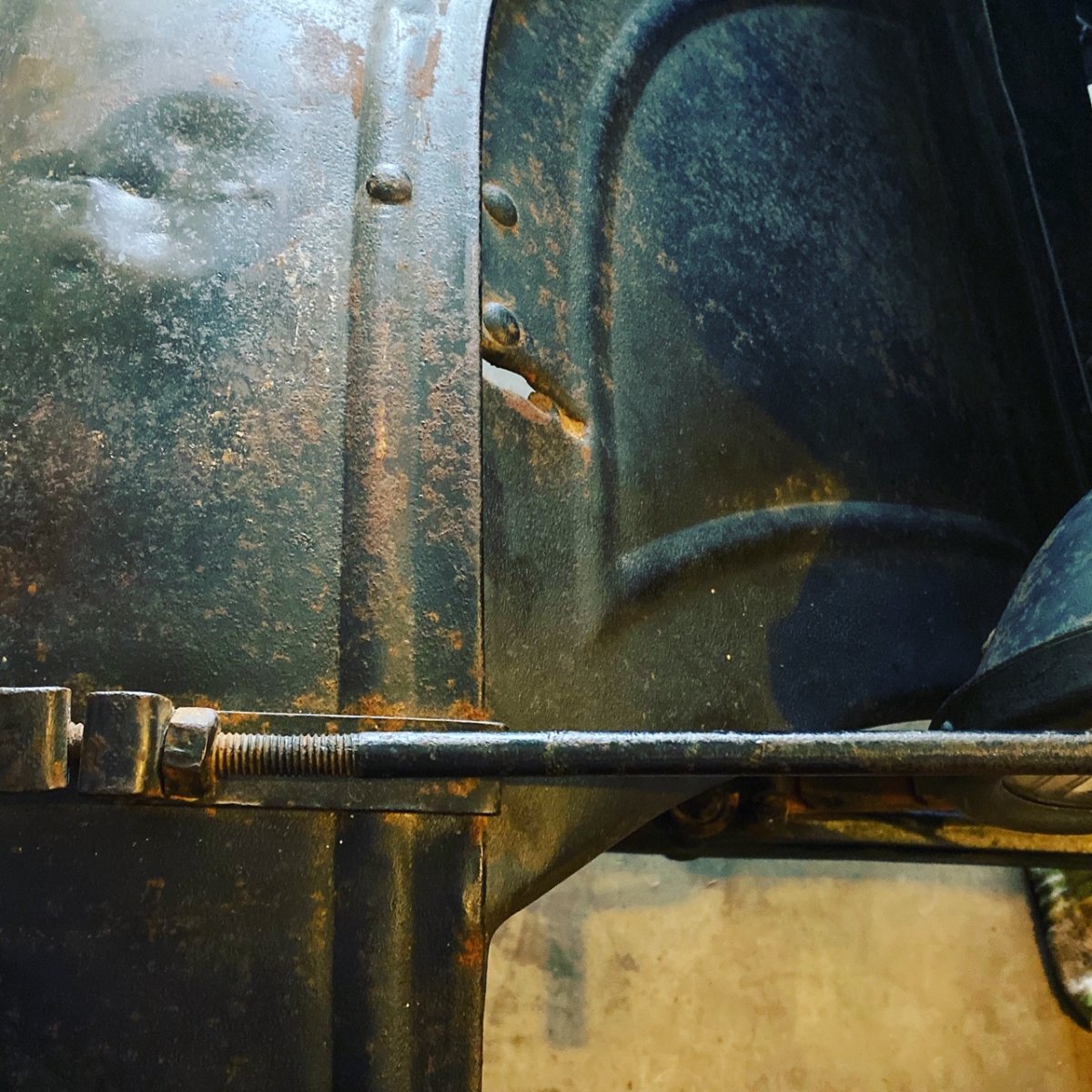

I've wondered, since I bought my car, how this damage was done to the passenger side fender.
Then I saw this photo and it looks like my car could've had a different brace on it than the one it does now....one the like one in the photo that would require such a hole in the fender.
Heck...for a second I thought that might even be my car with a different body on it because my car had previously had extra front spring clamps on it. But I think the car in the photo is a TT.
Any thoughts?

That type of fender brace didn't need a hatchet chop to mount. Those and others required the two inner most fender bracket plate rivets to be removed, and then use bolts and nuts to secure the brace.

IMO, that damage was from an outboard strike.
Could have been done by an errant fan blade.
Or someone thought a ravine there would be handy place to prop one side of the hood open.
Most likely a stress facture, the inner bracket plate terminates about there, leaving the fender metal free to flop and crack.
Obviously, adding the wrap around fender brace is a good idea. :)

I've always thought it looks like unintentional damage of some sort too Dan.

Wouldn’t you love to know??
I think it would take some quick and sharp force to tear the metal like that. None of the other metal around it seems to be deformed including that bead right next to it.

Ah, think I have it. ;)
One owner of that T was a lumber jack. So he carried saws and things on the rear floorboard. BUT.....
His most handy tool was an 8' pike pole. Can't fit that in the rear seat.
So....he laid it over the front and rear fenders, nice way to carry fish poles and lumber too.
However the spike on that pike pole bounced down on that front fender, and after a few chuckholes in that dang road, damage! :o

That damage is a puncture. Enlarge the photo and you will see the edge of the brace is nicked. Fatigued sheet metai will crack, but a rigidly riveted area will loosen and crack thru a rivet hole if the rivets become loose. A slight bend that works back and forth will fatigue and crack ALONG THE BENDING area only. A puncture hole starts out as a stretch around the penetrating object, this in turn carries the future hole edges down from the surface which action results in a puncture hole. These fender hole edges are classic puncture edges. :D

This damage looks to me like a broken off fan blade that hit the side of the fender and punctured it.

I think Ron got it correct. The trajectory of a loose fan blade would be slighty upward from that side. Probably no hood, as its doubtful a blade would penetrate a hood panel and still have enough energy to pierce the fender skirt.

I doubt a fan blade had anything to do with the damage. A flying blade would have a trajectory almost parallel to the inner fender panel, resulting in a sliding contact, which would surely have been impeded by the rolled edge of the fender top surface. There is no damage to that rolled edge. The rolling of the edge of the damaged area indicates to me a considerable downward force was responsible for the penetration. The dent to the top of the fender need not be connected to the puncture incident.

I agree with Ron, fan blade.

Nice forensic theorizing Allan. I’m a fan of the thrown blade idea but you talked me out of it. Who knows ?
Well...speculation may be it IS connected.
Seems Mr. Diddledo.... got sooo tired trying to get that stubborn Ford running again.....
In fit of heated disgust :x , he grabbed his pick axe...
and swung a terrible blow upon that Ford...
...so hard that the wood handle dented the crown, and the pick dug deep into the heavy sheetmetal of the fender, leaving that gash of despair :shock:

Do you still have the original hood that came with the car? If it was the fan blade the hood would have a good lick on it. But then again maybe the hood was off or?????

Someone tried to repair a warp in the fender, but ended up doing a hack job? :lol:
I'll take separated fan blades for 100, Alex! When you look at the slot, it came from the bottom traveling up, and was stopped by the lip in the top of the fender. If it were something come down from aboce, it would have either nicked the top surface, or the bottom of the hole would be larger than the top. Instead, it looks like a blade that cut loose from the bottom of the fan into the sheet metal of the apron, went sideways into the fender, and stopped there.
