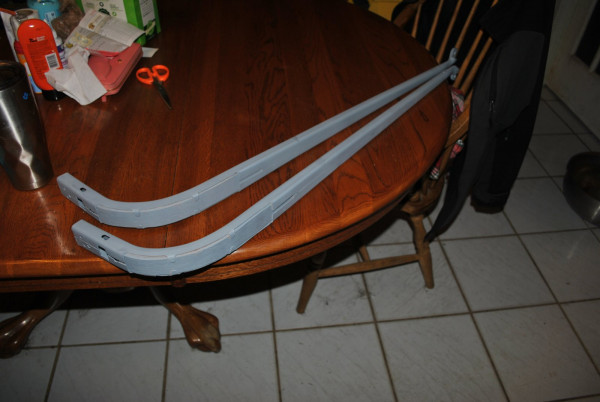

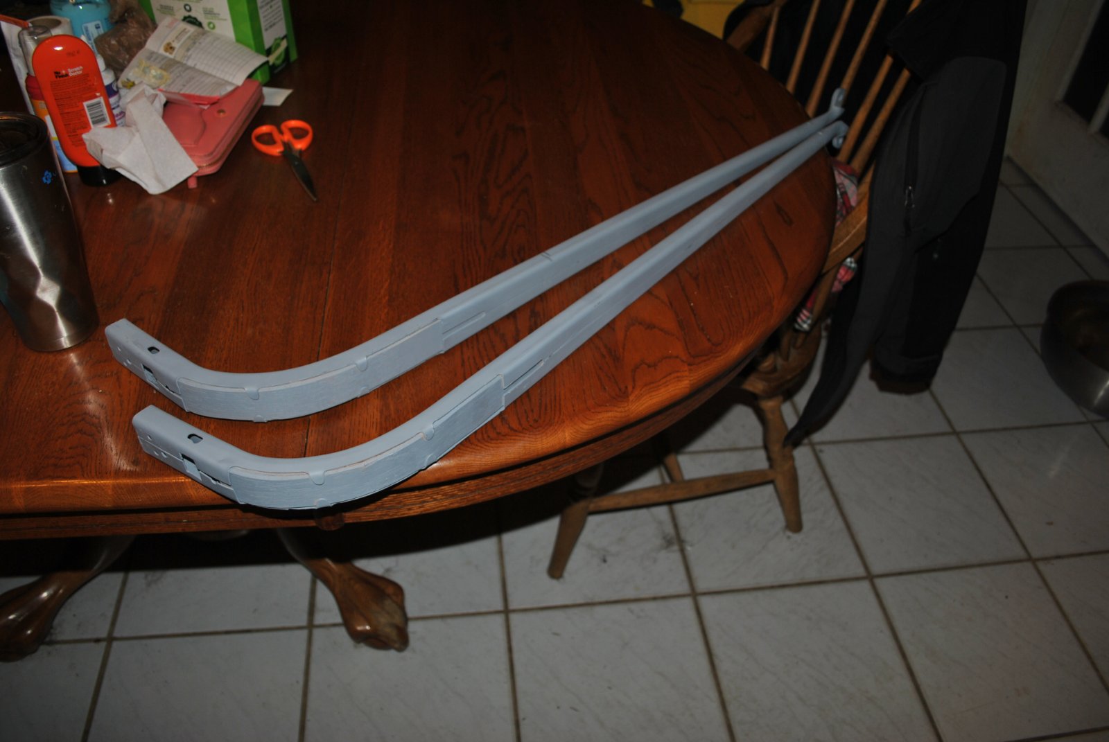

Very nice work John thank you a lot now maybe I can finish this '25

Those are gorgeous G. R.!
Keep us up to speed. :)
