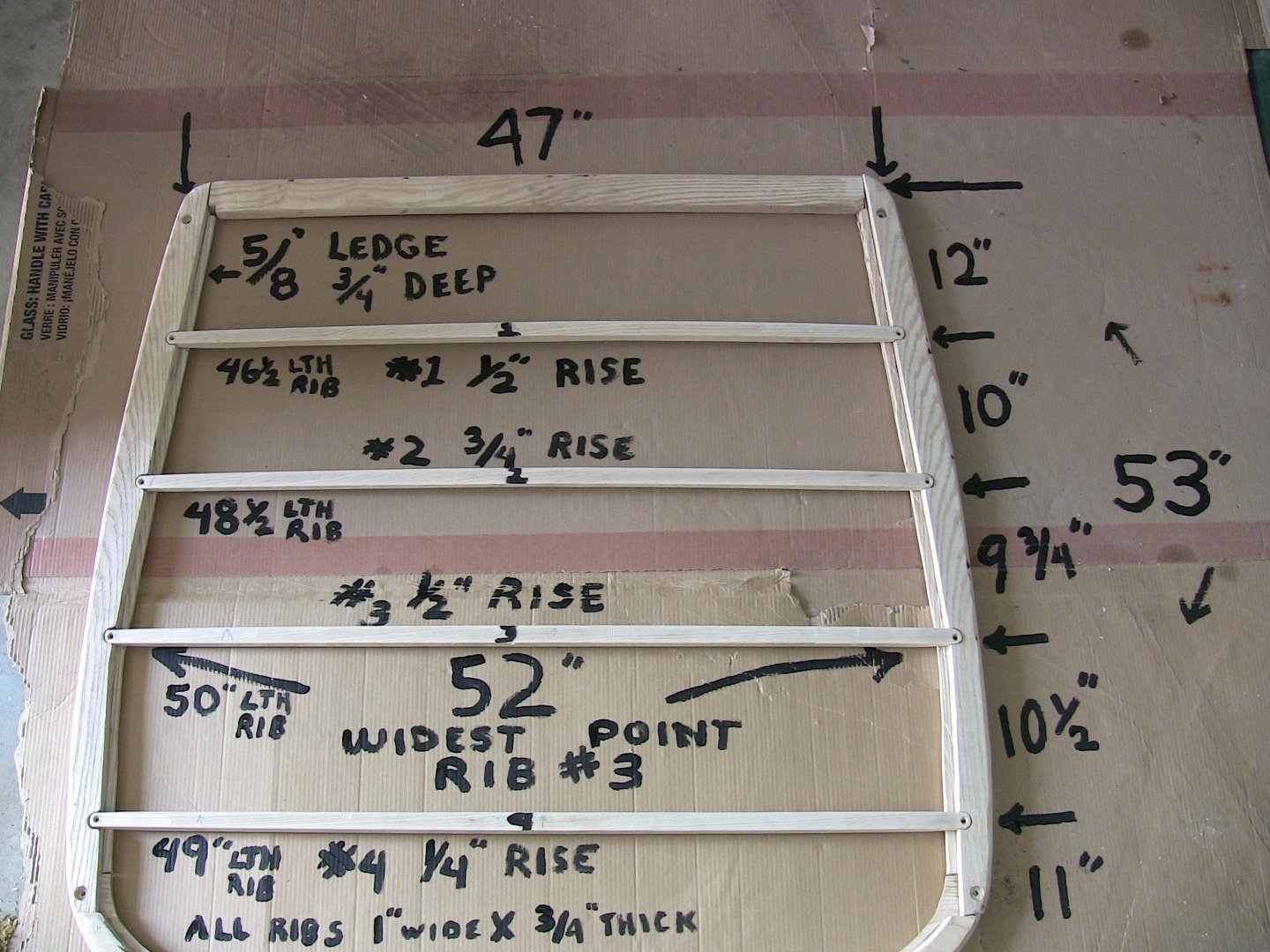

I'm in the process of restoring a 1926 Coupe and all the top (roof) wood is missing. I'm wondering if anyone has a drawing showing the layout and dimensions. Any help would be appreciated.

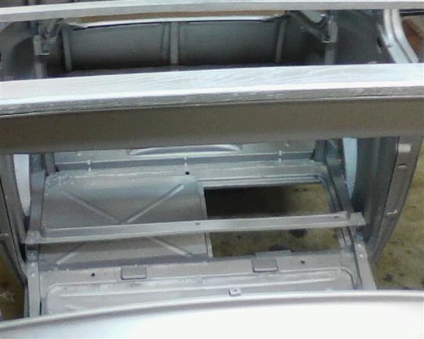

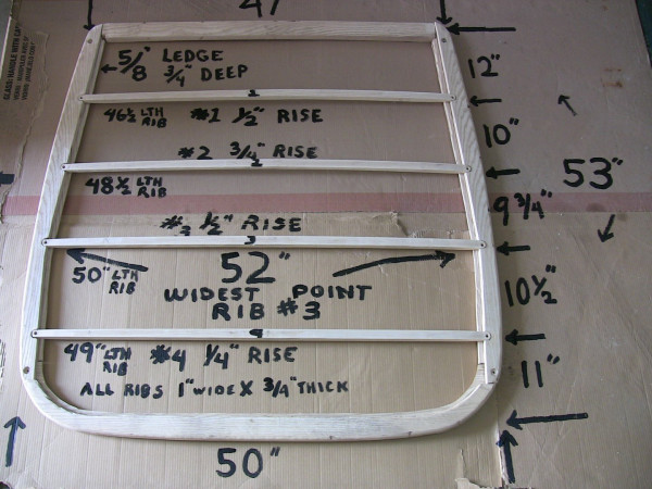

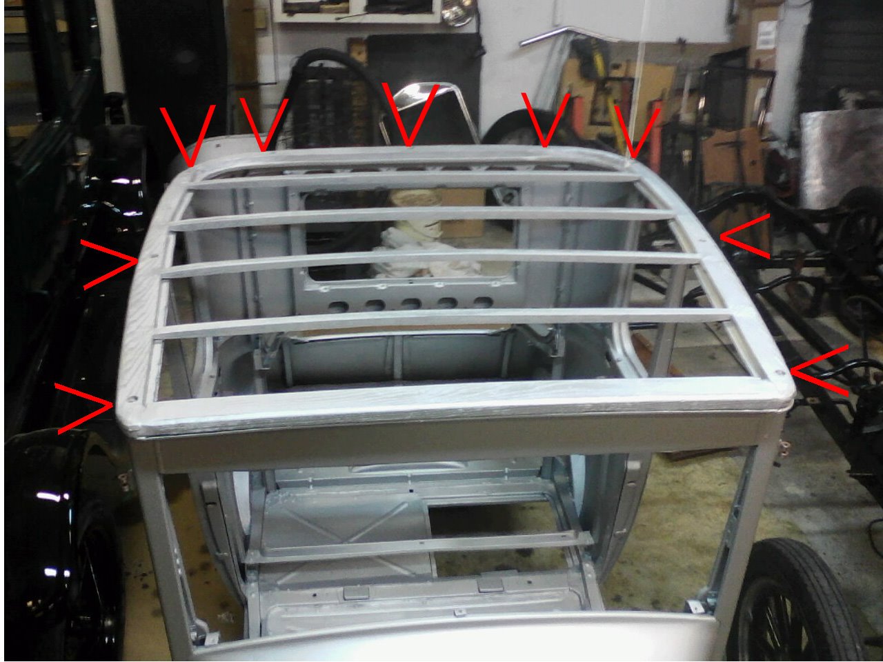

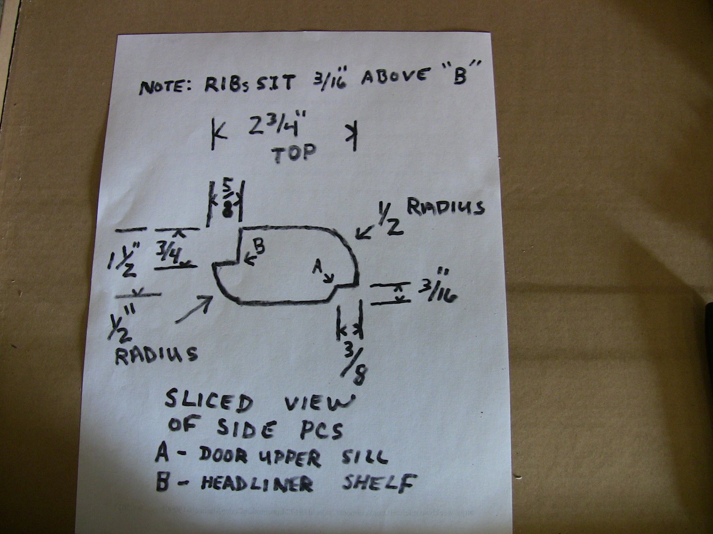

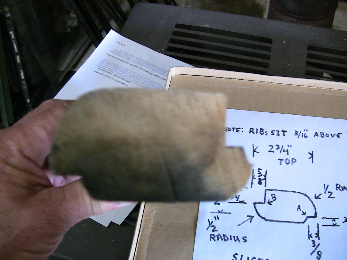

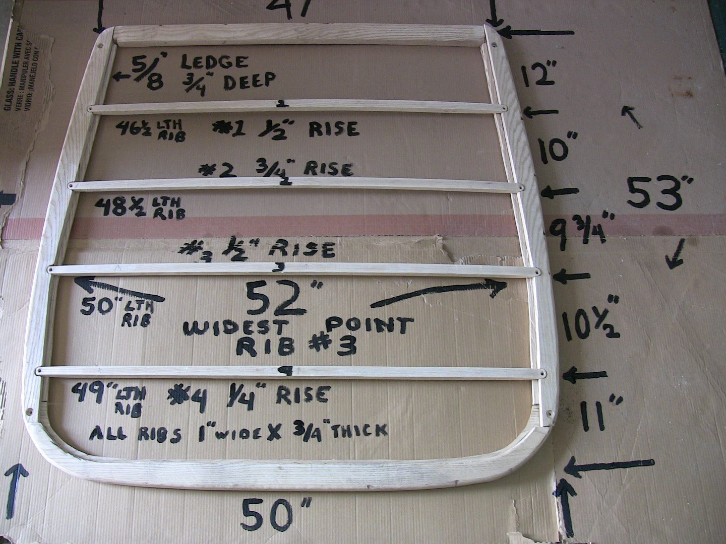

I have some pictures and also one of the original top wood.

This may help....

Don,
This is perfect....exactly what I was looking for. This will make it so much easier and will take all the guess work out of it. I can't wait for the weekend so I can get in the shop and start working on this!

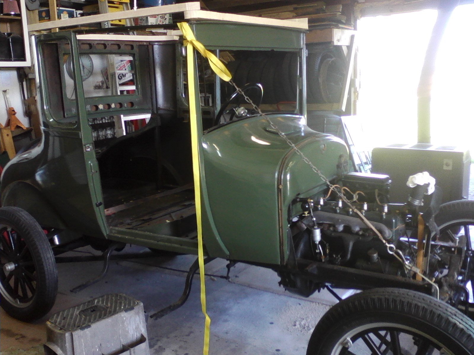

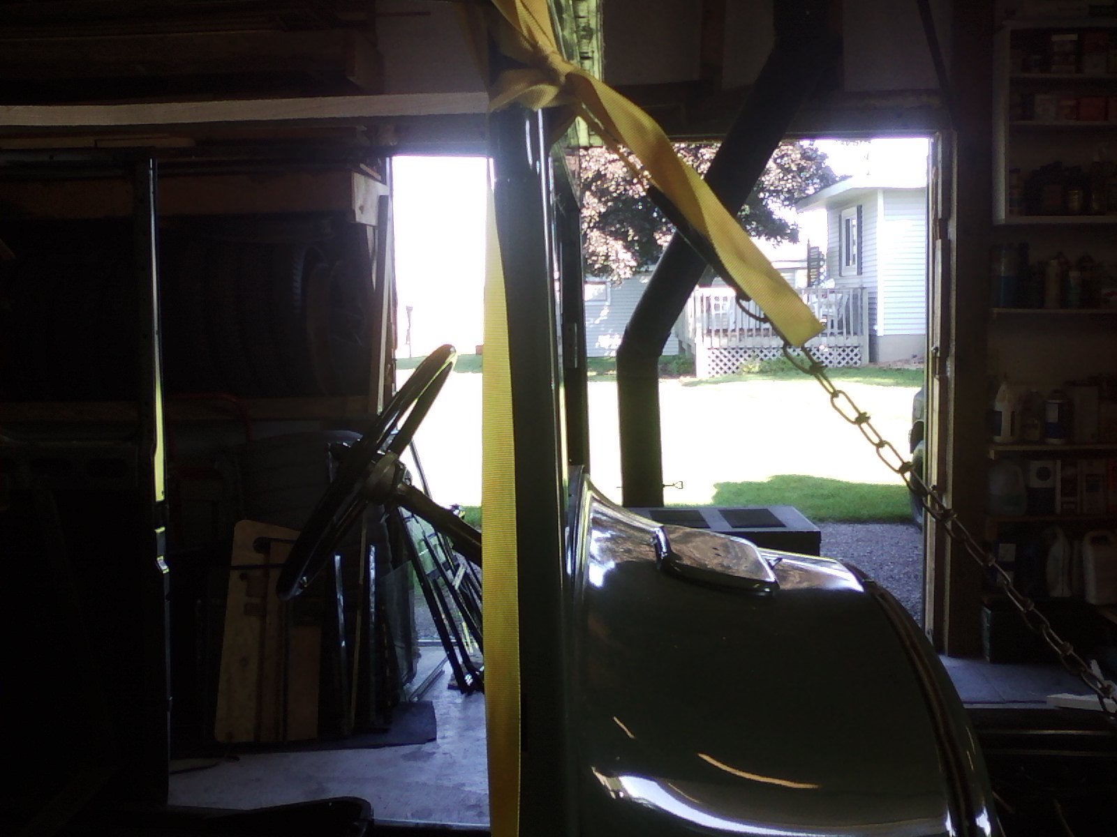

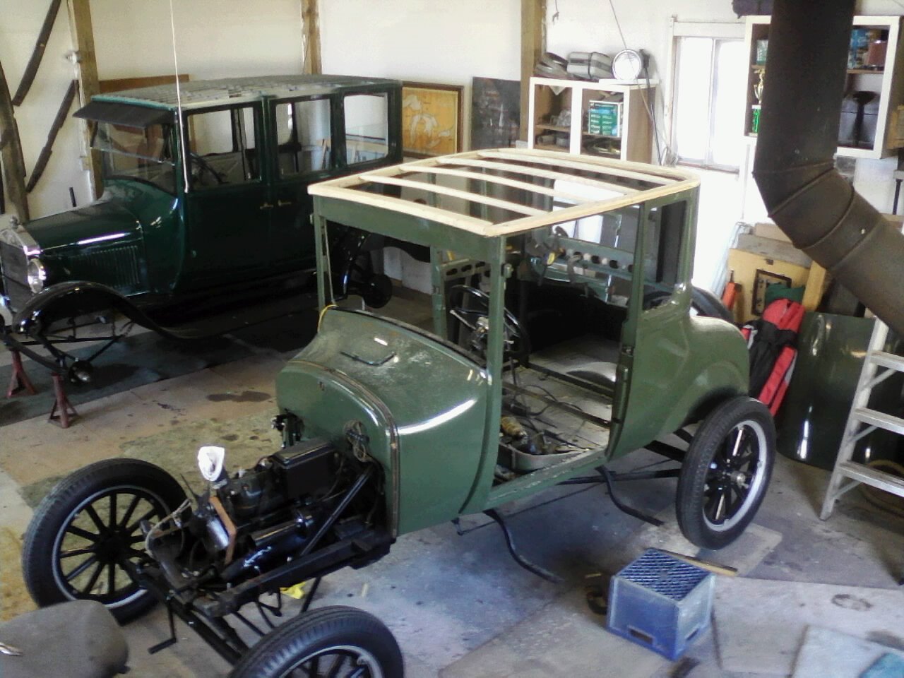

I hope it helps …. If I could just add one thing? The coupes I worked on almost all had to have the top pulled forward. The weight of the doors takes a toll and top helps hold the body shape. So I learned to check the door fitment before bolting the top wood down. It doesn't take much for the doors to sag.

Thanks Don,
All good points, I'll defiantly do that before I do the finial drill and install.
