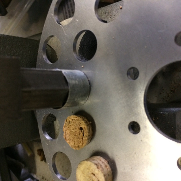

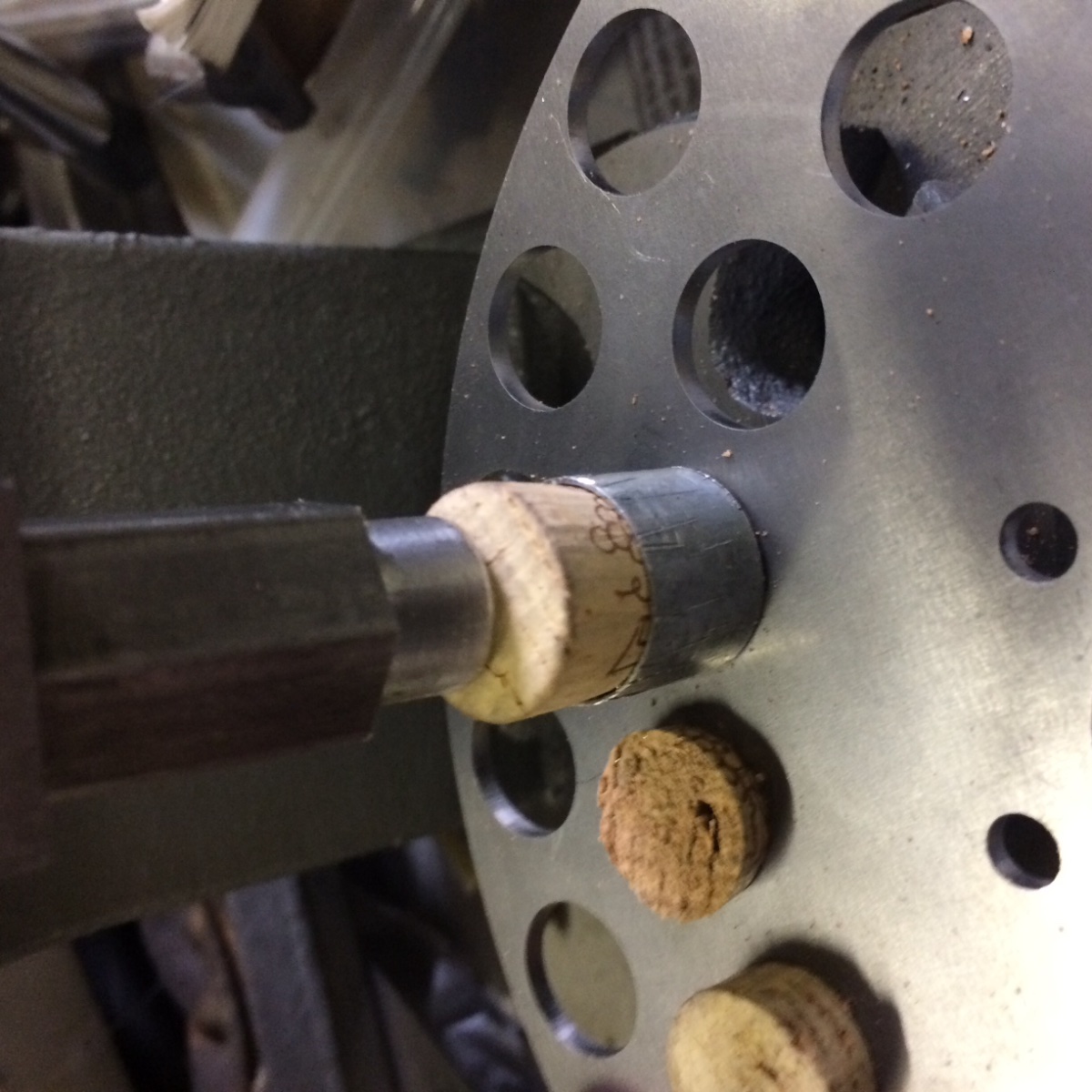

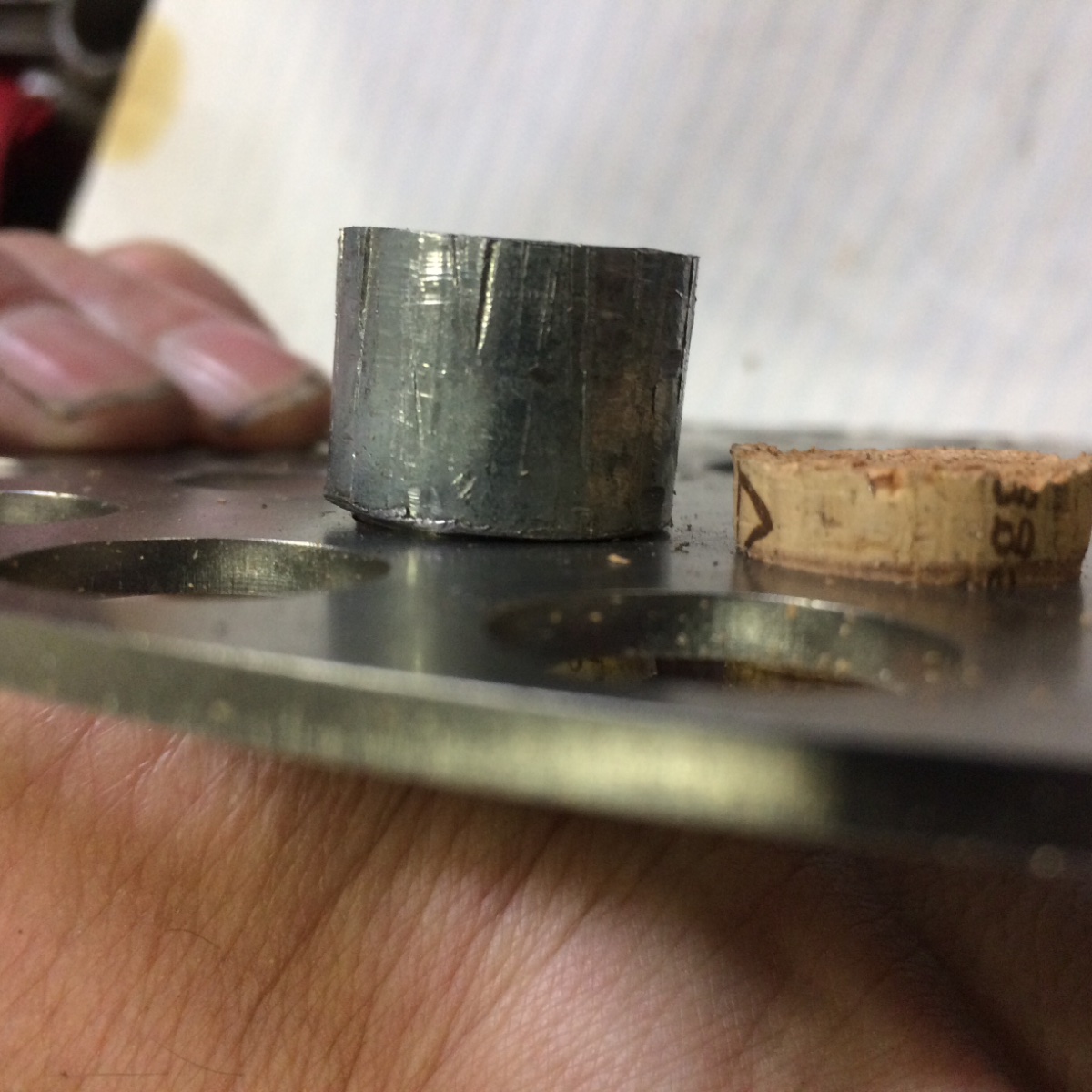

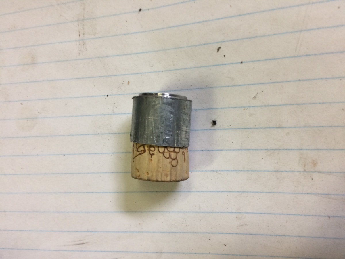

I’ve been working on rebuilding a couple of clutches for a era accessory 3 speed sliding gear transmission for the model T.
In the last couple of days I finished rebuilding the cork inserted clutch discs The corks installed the cork pressing “funnel”
attachment=2]FE7E0600-1857-43A4-85A7-BCC6C0BB8014.jpeg[/attachment]

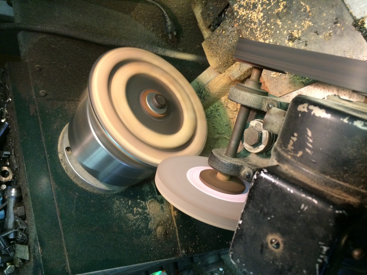

Finishing the corks using a tool post grinder

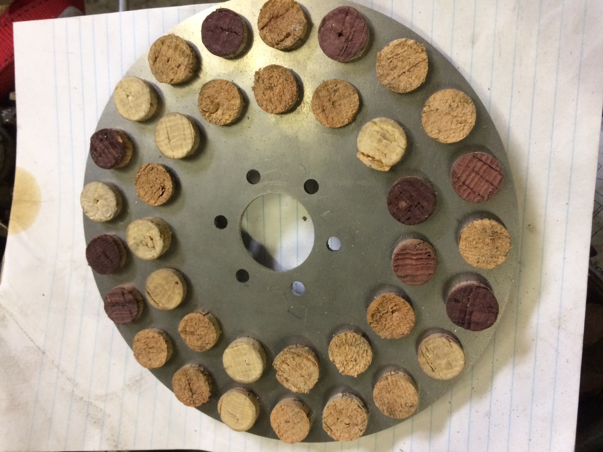

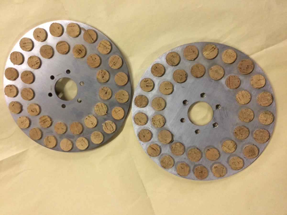

There are 36 inserts per disc and I got 3 from each wine bottle cork and did 2 discs, so 24 bottles of wine NEEDED to be consumed!!
