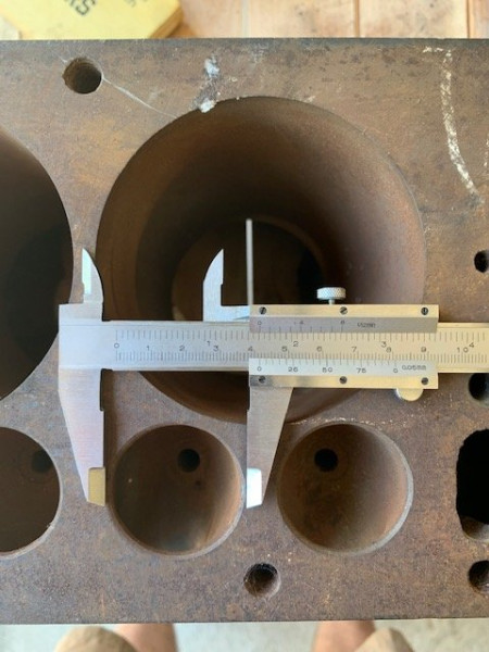

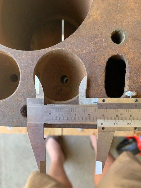

Slowly working away on my Speedster, doing a bit of fabrication here, a touch bad math there, some measure once, cut three times and it is still to short experiences. In general having a bit of fun. Came to the question of valves, the block I am using has been massaged a bit and noticed the valve holes aren't exactly stock. For those who have increased the valve sizes, beyond...just oversized, what did you do? I am assuming I should run hardened seats. What did you do about the valves? Do you order the large valve kit from Mr. Yapp and cut down the stems and press in A guides? Do you try and find a modern valve with a smaller stem diameter and go that way? Have heard that 327 bowtie valves can work? Will try and attach a picture to illustrate my situation.

You can't put A guides in a T block- too large a diameter and A valves are way too long for a T block. You don't need to put hard seats in either. Look at using small block Chevy valves- Regular size intakes and use FI exhaust valve if your exhaust seats have been enlarged. Chevy valves have 11/32" stems and you should be able to enlarge the stock T guide bores.
I see the exhaust seats on your block have been enlarged as well- try FI exhaust valves in both the intake and exhaust.

Modern valve, size 1.543 head dia, and .342 stem, (.030 over size stem from std T block) any bigger valves and you could have head gasket problems.
Agree with Dan, those seats will clean up. fitting new seat usually will warp the bore which wouldn't be a problem if you are re-boring the block as well.

Kerry- pretty sure those ports are too big for the Langs valve.

Thank you Dan, are those “fi” exhaust valves? Or F 1? Doesn’t look like the guides have been touched.

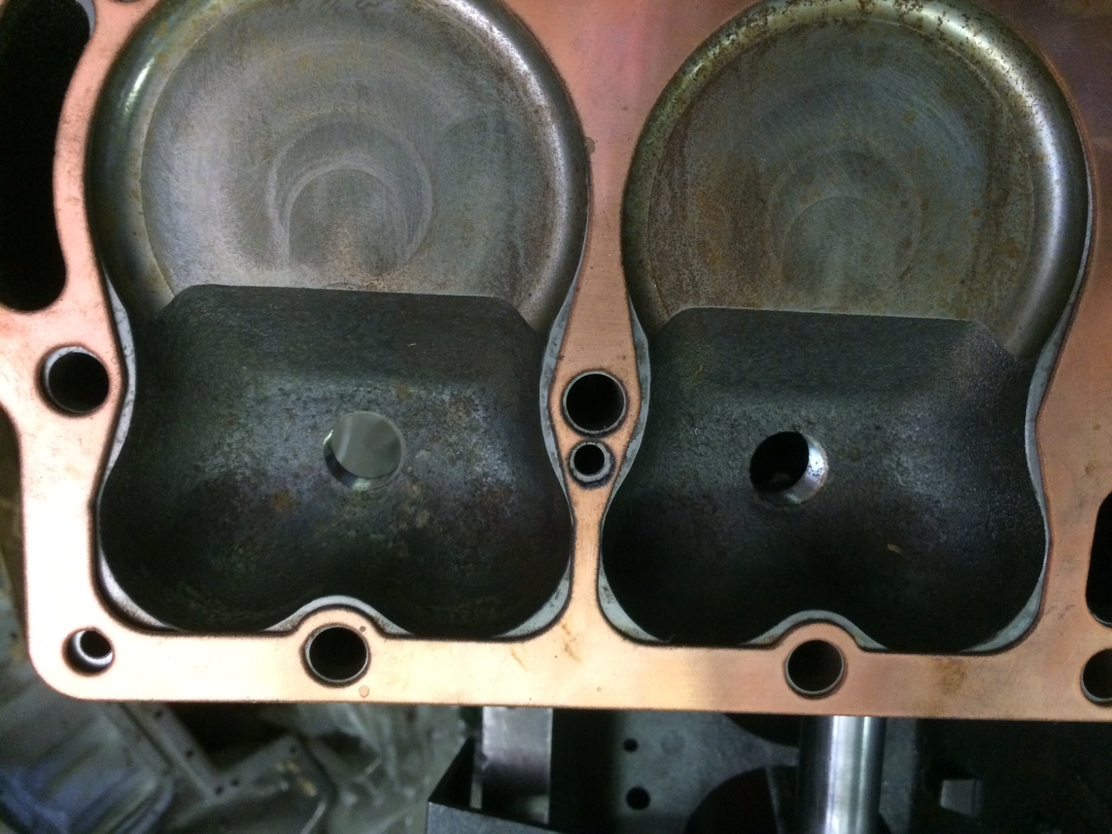

Here is another option
Fordson tractor intake valves. With my own head gasket
Prus head. It clears the valves nicely

Think the block has been bored out. Calipers show it at 3.858 inches.

Looks like you will have a problem with pistons, that's 108 thou over STD so you might be biting the bullet and do the lot on this block, new seats and cylinder sleeves and bring it back to using T parts.

I agree with Frank. The block needs to be sleeved, back to standard makes most sense. Might as well fit hardened seats at the same time and deck the block as part of the procedure. Then you have a new blank canvas to work with.

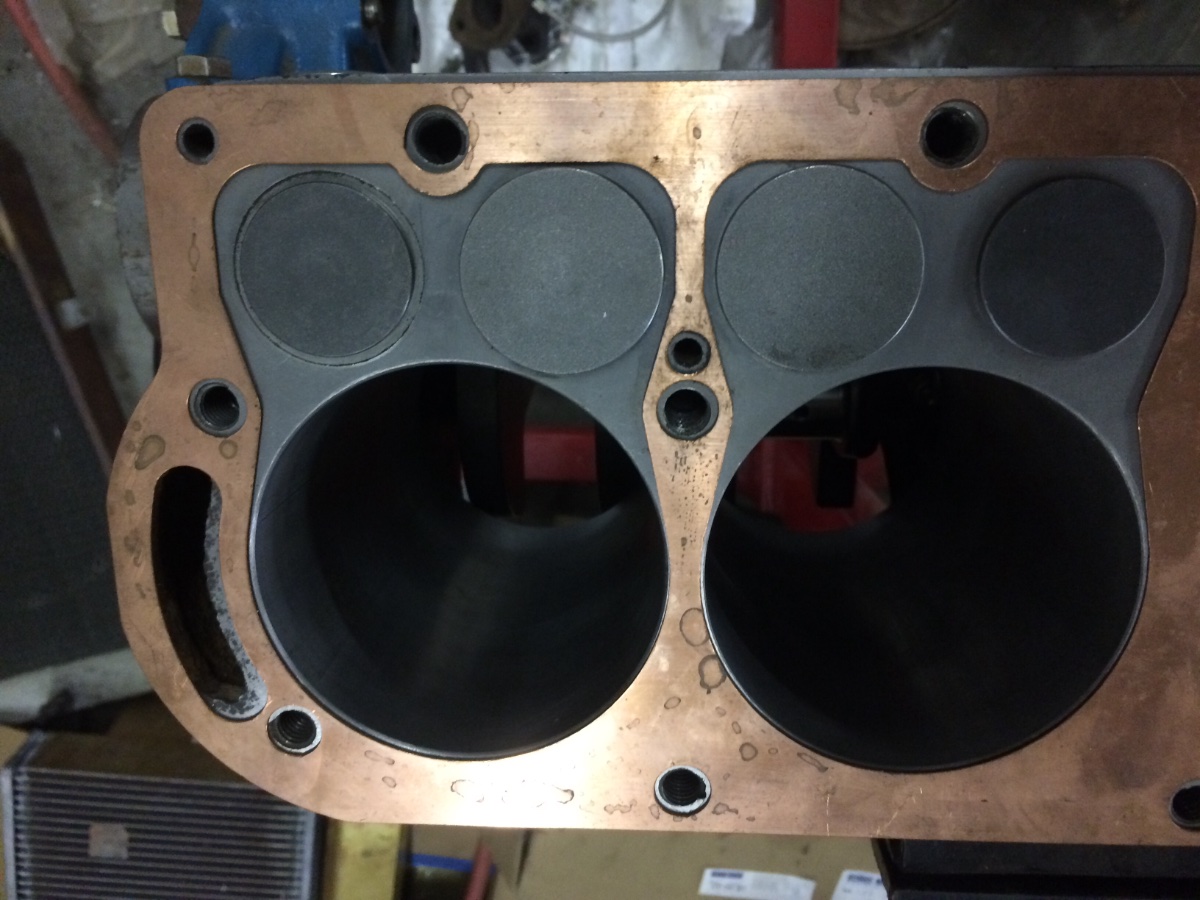

I have run several Sherman heads over the years, on a couple motors. My first Sherman was about 5:1... but the casting was machined out of parallel and so was sumpin like 4:1 at one end, and 6:1 at the other...?! The head was later welded up in areas, then surfaced 1/8” and cc machined for consistency. It ended up at about 6.5:1 with custom fit quench areas. The motor ran much smoother after all the head work.
The head I run now was a high compression version of the Sherman head. The cc does not kick up over the valve area, but instead is rather tall over the piston with no quench, and is nearly consistent depth for the entire chamber. I did work the head for valve clearance and piston position, but the head still measures out at 7.25:1 ratio with the A crank and .060” overbore. I would have used my old head with all the work into it... but I swapped motors and the head wouldn’t clear the new pistons... was a sad day
I’ve always had a heating issue with the Sherman flat heads, and it presents itself in the form of severe detonation and overheating of the rear cylinders. I eventually went to a water pump as when running at high speeds (2500+ rpm), #3 and 4 pistons would begin to stick in the bores after a few minutes. The water pump solved the pistons sticking, but I still suffer from severe detonation at high engine loads. So I have learned to drive with a lighter foot... and believe it or not, this has noticeably increased the lifespan of the drivetrain components too

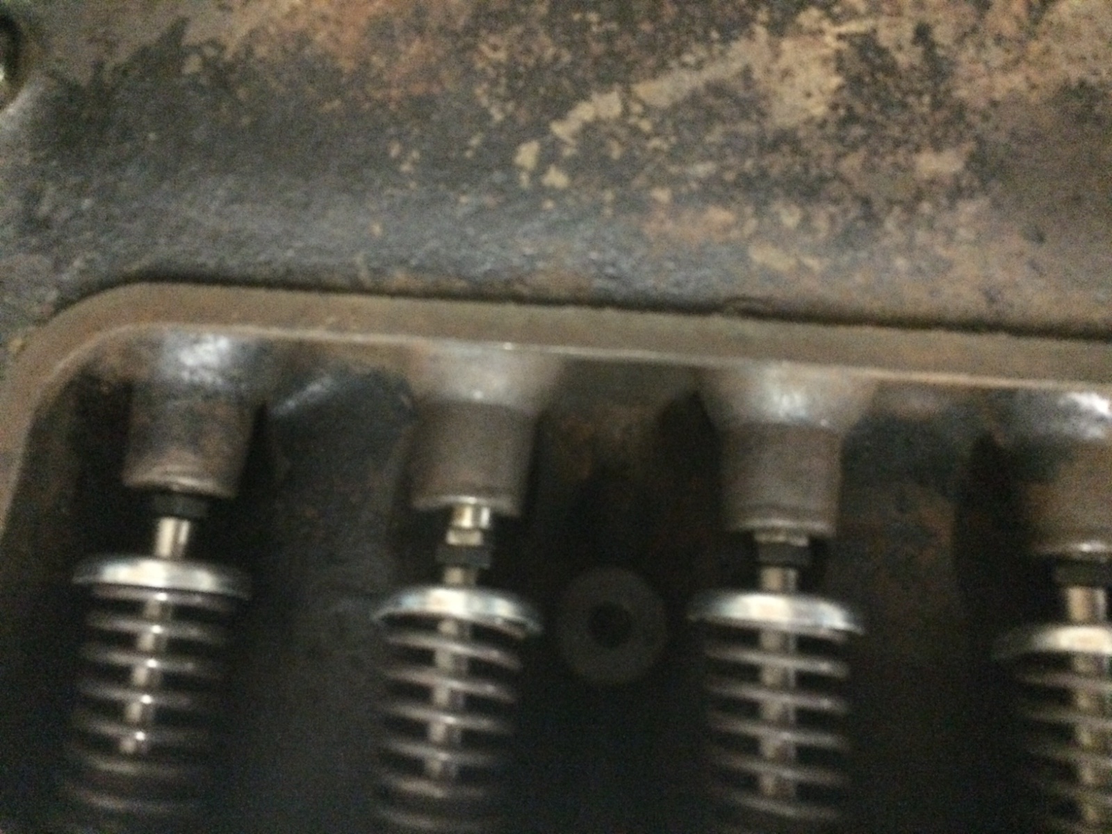

Regarding valve seats:
Have you ever had the opportunity to look over a stripped NOS cylinder block?
I have, and I was surprised by the valve seats. In a new block it almost looks as if there is no valve seat at all. If you look closely at the seats you can barely see a very narrow seat. The ones I have seen look like the seat is 1/16” or less.
I think this was intentional at the Ford factory. Machining valves, guides and seats at that time was no where near as precise as what we expect today. To get a new valve to seat it had to be ground in extensively, hence a disassembled motor usually has seats that are both deep and wide.
I learned about setting up Model T valves from an expert automotive machinist. He build race car engines that win, so I think he knows what he is doing. He taught me to use modern Ford 351 valves. These have the right head diameter, usually made from first class materials, and often come with a stellitete tip at the small end. They are also pretty much the right length.
First I true up each of the new valves in my Sioux valve grinder to an angle of 44 degrees. I check the run out on the valve face frequently during grinding. I strive for less than .001” runout. Next I cut the seats using the Neway system. Three angles, 30, 45 and 60 degrees. I also use an indicator to check the concentricity of the seat too, striving for no more than .001” runout. The difference in the valve seat angle helps insure a tight fit between the seat and face. These require little if any grinding to get a perfect seal. I time my valves using a degree wheel. I have been very satisfied with the result and a good valve job lasts for many years.
These is more to be said, but this is enough for now.
