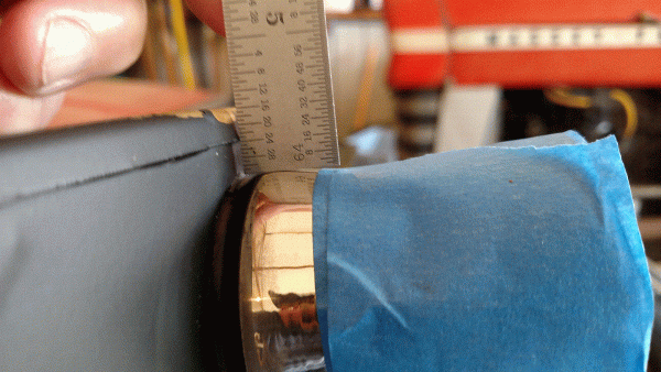

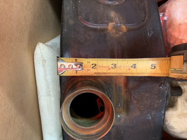

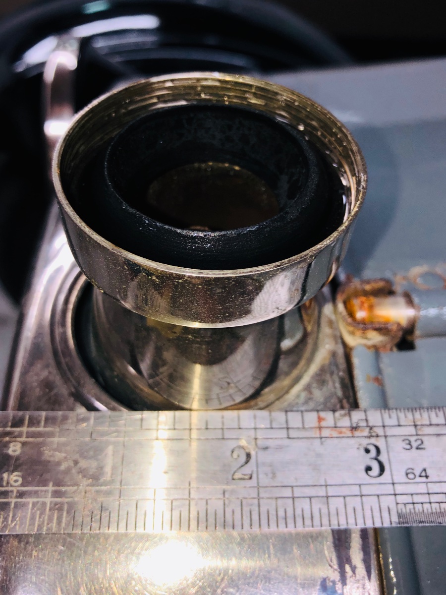

I bought a new radiator since my old one was not repairable. Much to my dismay, the radiator shell on my '26 does not fit over the new radiator. The hole in the shell is too far forward or the radiator neck is too far back. These are photos of my new and old rads. The neck on the new one is 1/2" back from the face of the rad. The old one is about 3/8".

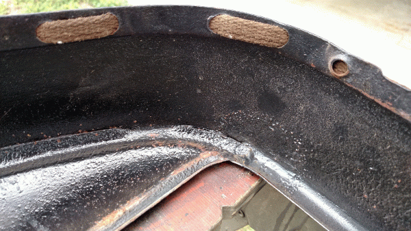

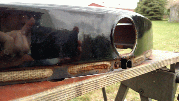

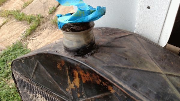

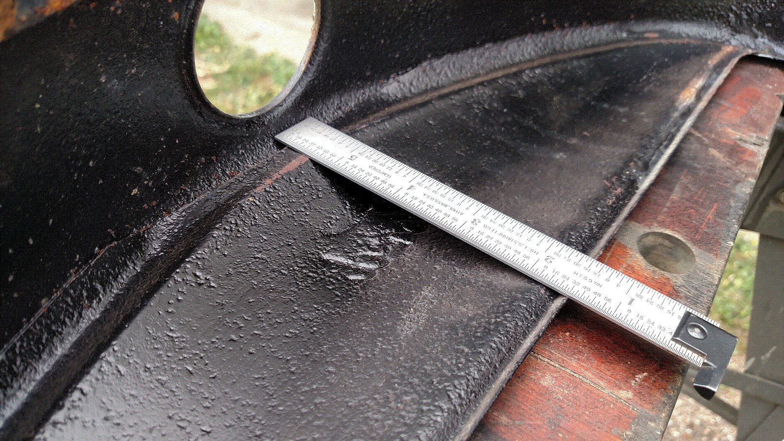

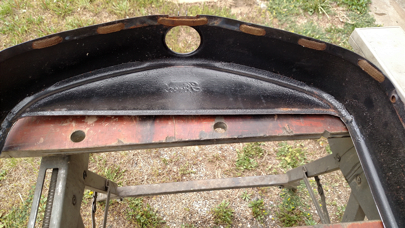

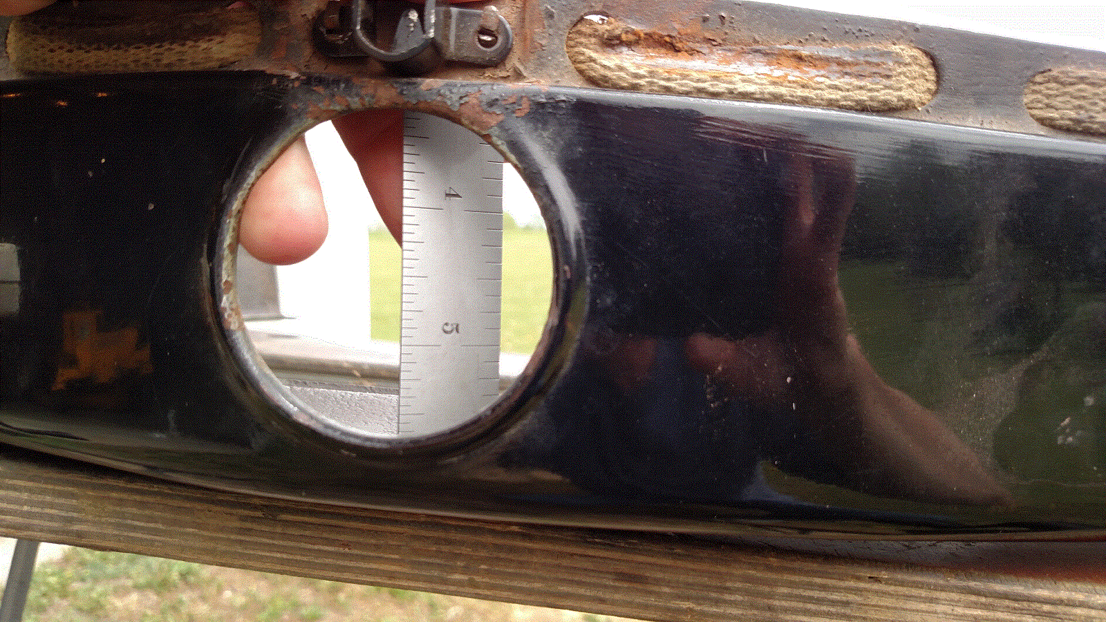

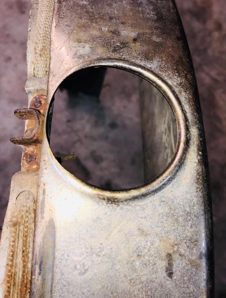

This is the shell. I measured from the area where the paint is worn.

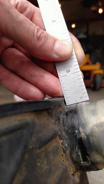

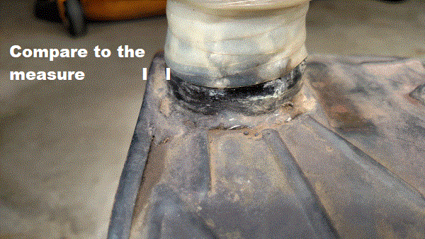

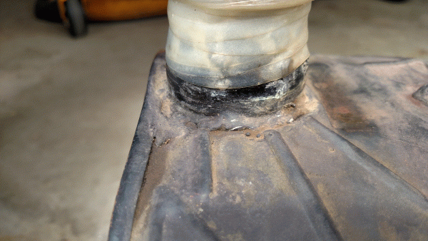

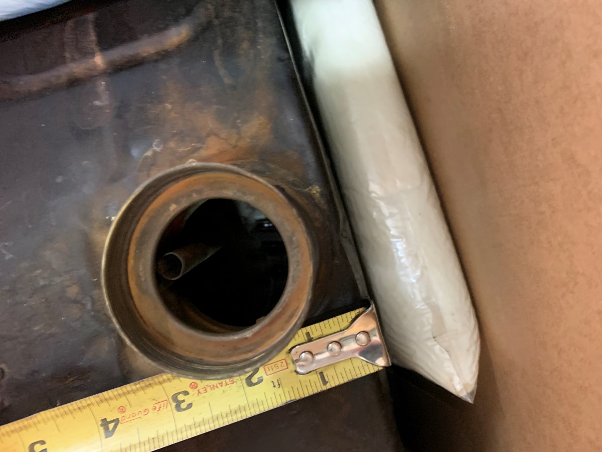

This is the old radiator. The neck has been resoldered. I suspect that my shell is one of those infamous bad reproductions and someone moved the neck to fit.
Can anyone measure their radiator or shell and tell me which is wrong? I spoke to Brassworks about this and was told that they have been using the same shell as a baseline for 47 years. I assume they made mine correctly and I will be searching for a replacement shell. I will post a few more photos in another post.

These are a few more photos.

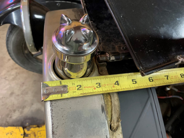

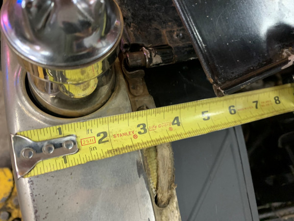

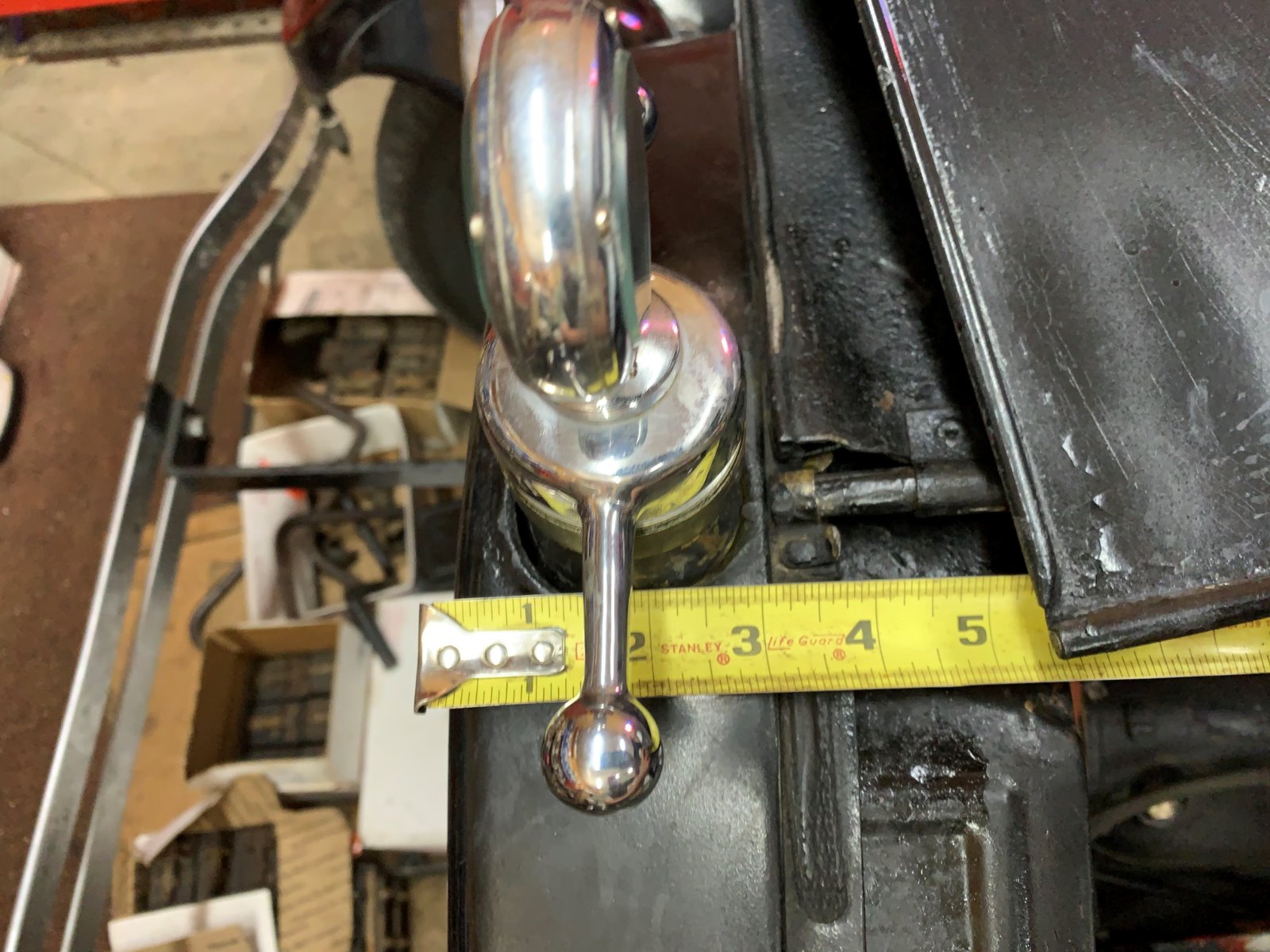

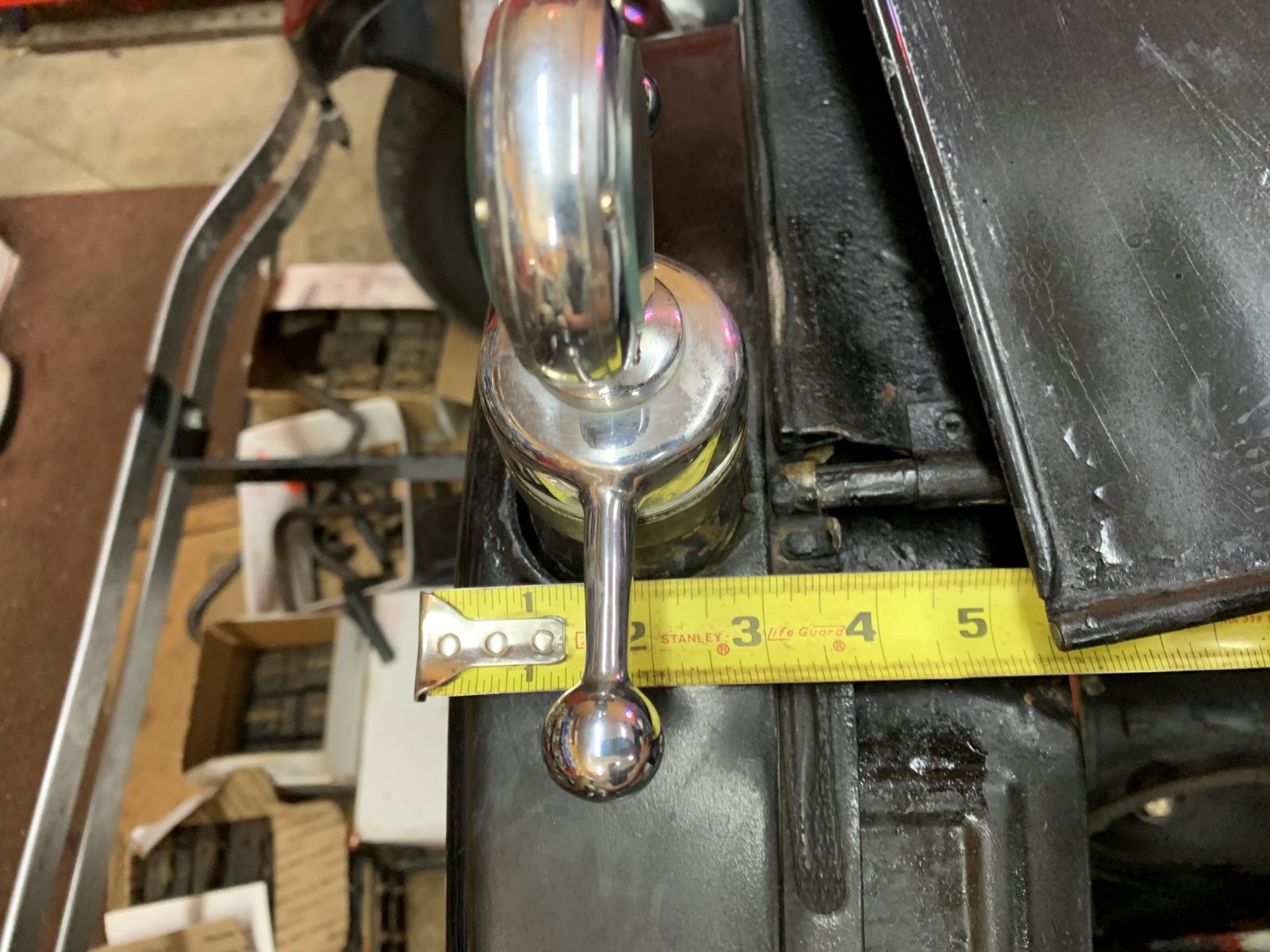

I have a Brassworks radiator in my 26 coupe. I snapped a few quick pictures.
Scott C.

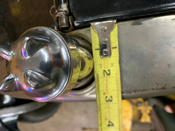

Here is my 26 roadster. It has an original thin radiator still in it, along with the longer fan pulley. Sorry, I just noticed that the tape measure is off the front 1/4".

They look like the same shell. They both measure about 3 1/2" front to rear. When I ordered the new radiator from Brassworks. Lee told me that if I had the thin radiator and long fan pulley, that I would just have to swap it out for the shorter pulley. My coupe had the thick radiator and short pulley.

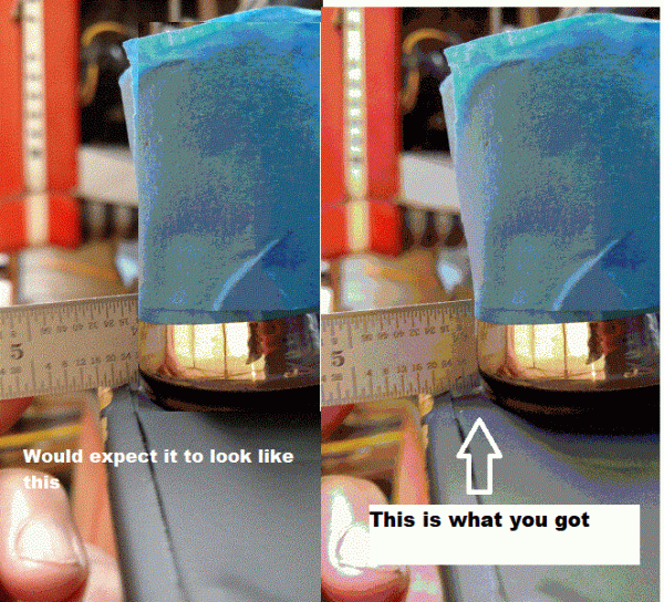

A visual compare - looks like the Brassworks needs to be a little more towards the front almost to the seam for the front face plate

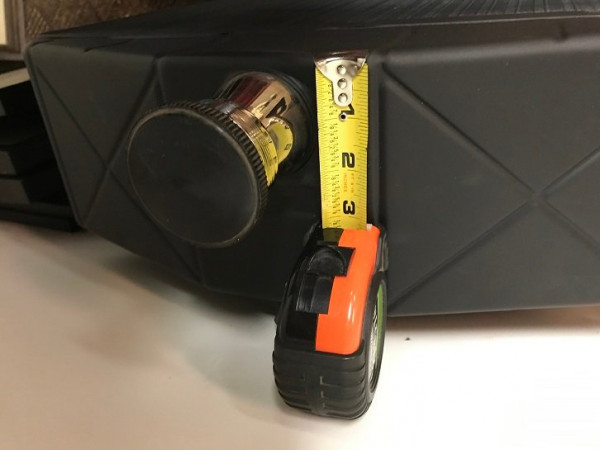

Here are a couple of pictures of my old radiator out of the coupe. Just as the others the neck is within 1/4" in from the front. I would contact Lee again and present these comparisons to them. He should make it right.

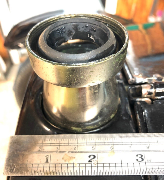

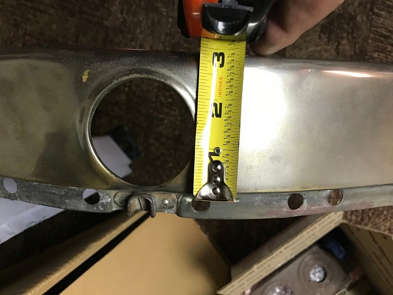

The distance from the tank front to the fill neck is 1/2 inch on a new Brassworks radiator that I have not installed yet and is 1/4 inch on the radiator that had been installed for about 40 years.
The original one fit and worked OK.
I have no idea which is correct, perhaps 3/8 inch would be the best choice.

James, my original is a little over 3/8 (13/32"). I can't post photos from my phone. I'll reformat them and post tonight. I recommend checking fit of your shell if possible.

Mark: The original Ford round tube radiator on my '26 coupe sits 5/16" back from the front top edge of the tank. FWIW, jb

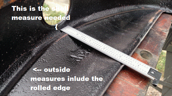

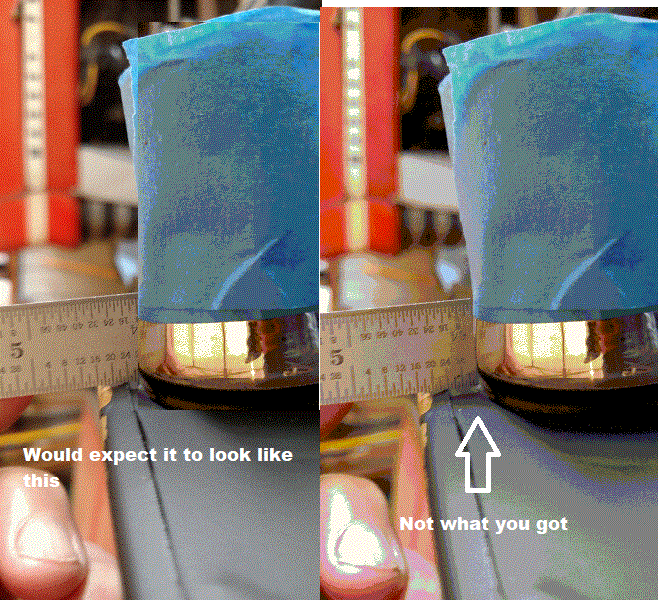

Measurements of the radiator neck to the outside of the shell are inaccurate and misleading because of the rolled edge of the shell. The shell needs to be measured from the inside as shown and the radiator from the neck to the front of the radiator for a comparison. From the picture of the Brassworks radiator theirs appears to be too far back. I remember reading somewhere that new repro shells didn't fit the old raddiators because the neck hole was located further back. Could Brassworks have sent you a radiator for a repro shell, by mistake? Have them tell you what it they say it should be and compare to what they sent. Don't send them pictures or tell them what you measured - they must tell you first!
shell measure.gif (99.19 KiB) Viewed 10012 times
Neck 2.gif (85.84 KiB) Viewed 10012 times

Mark, yours is not the first Brassworks radiator over which the shell will not fit. First, your shell is not a reproduction. The high repro shells still had the sides square to the front, rather than angled out to follow the line of the hood, so they never could fit properly.
The new Brassworks radiator on my 25 wide body Duncan and Fraser roadster had exactly the same problem. It was solved by removing the radiator neck and re-positioning it in the correct place,3/16" to the front. In a nice piece of serendipity, I replaced the new neck at the same time. The radiator cap would only screw on 1 and a bit threads before it bound up. A nicely replated original did the trick.
Brassworks didn't want to know about it. They assured me that all their radiators are checked with an original shell before assembly. I had determined to buy my radiator through a local parts supplier, as he is bound by our consumer laws to provide goods fit for purpose. He instructed me to have the repairs done and he would re-imburse me the costs, which he willingly did. I do not know if he had any success getting Brassworks to come good.
Hope this helps. Do check that your cap will fit first.

I took better photos today of the critical measurements, which I will share with Brassworks. I told Lee that my shell's hole was 3/8" from the inside surface and he said his was 9/16". I didn't have a photo to share and don't know if he was measuring the same way. I'll send photos tomorrow so he understands the problem.
My shell is far from perfect but it is a Ford stamping and not a repro. I spent some quality time this afternoon with a hammer and dolly and I got the shell to fit better. I think I can make the shell fit somewhat.

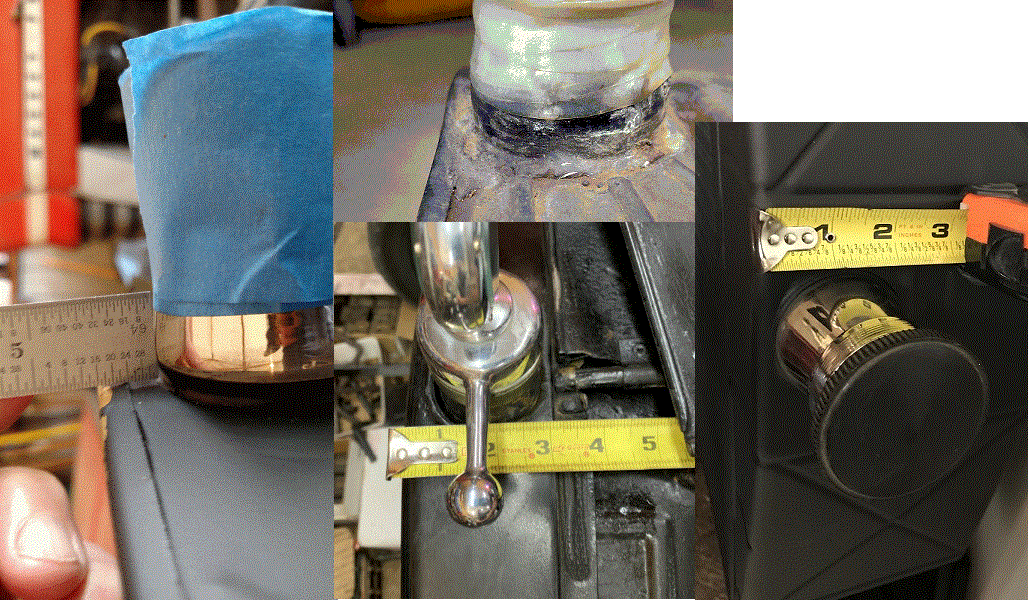

Mark, a couple of words of caution. If you can work around having to send the radiator back for correction, and then having it sent all the way back to you again, I would do that. You will have ruled out hundreds of miles and any chance of rough handling damage that may ensue. If you have a competent local radiator shop in which you have confidence, have them quote for the alterations and let Brassworks know. it will almost certainly be cheaper for them not to have to pay for two lots of shipping plus the time involved. Be sure to take your shell with you to the repairer so he has the two components to make the job good.
Do NOT alter your shell. Juggling the hole for a tight fit will invariably result in the shell chafing against the radiator neck and wearing a groove around it, which may even develop into a cut.
Do NOT accept assurances that this is a 'one off' problem with a Brassworks radiator. It is not.

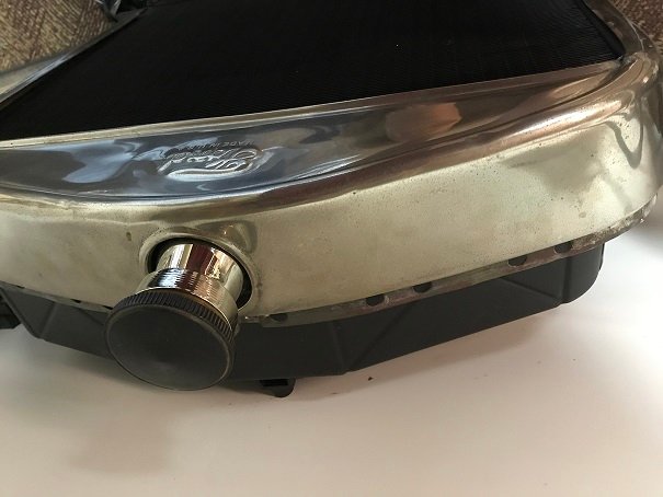

Have 2 newest (5 years) Brassworks on the ‘27 and the ‘25, both shells fit neck area fine.
IMO the 26-27 brass nickel plated shell neck opening is bit rearward, lots of nickel shells show wear at the backside.
Here is my ‘27 fit:
And this is the steel shell’25 fit:

I received a call yesterday and stopped and measured. The radius of a neck to the front panel measured 9/16". You would typically not measure this way but that is immaterial. The dimension is not a number I readily know because we use an OE shell (as a fixture) to locate the neck. If you have a shell with a different neck hole placement that would be an obvious problem. It seems Mark does.
We could advance every neck forward for every radiator but I fear it would create an un-desireable gap between the core and shell and hood and shell. I can also put the neck anywhere you want and I have created a new item https://b22jg8vysc1wt8v6-1582039129.sho ... 7-model-ts for everyone that allows you to specify the neck location. We did this for the 1980s shell and have yet to sell one.
Anyone with any insight on the 1926 shell neck location, please email me at sales@thebrassworks.net. Jim Patrick please manage the rest of this forum. You are well informed and seem to have a real knack for it.
PS
Thanks for the images:
The neck on this radiator is not original.
I cannot determine whether it is paint or an upward flange on this tank wrapper. It does not appear to be consistent with any Ford radiator I have seen.
There is significant solder around the base of the neck which is not characteristic of a Ford but might suggest a repair or modification.
A piece of wood is used for the straight edge and there is daylight visible. The wood may be warped or the tank may be malformed. Can't say but would not rely on that for a dimension.
The shell images look OE but the shell photos with dimensions are not a help.
I appreciate the other radiator photos provided, they're aftermarket too.
