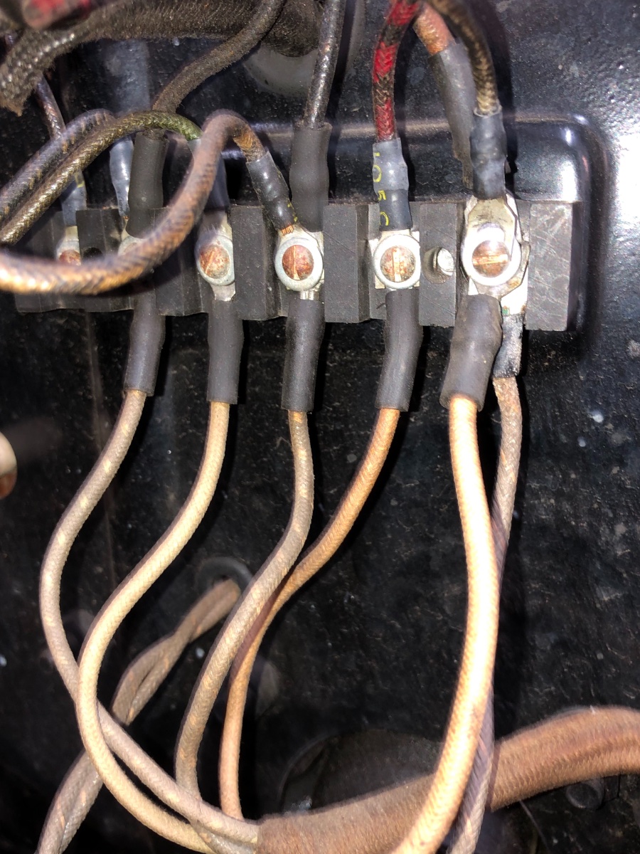

Well, first thing the morning, checked oil, good, and clean too.
Put the 2013 battery on charger, had lots of fluid in it, used the battery electrolyte tester, read in the high fair, then charged up 100% fine.
Put on known good carb, and gas tank was dry but very clean, put in some gas, drained the sediment bulb, let the gas run clean thru the gas line before plumbing to the carb.
Drained the radiator, very little debris ran out, flushed and refilled with anti-freeze and distilled water solution.
Aired up the tires to 60psi all around.
Turned on the gas, climbed in, pressed the starter button.....nothing.
Key on, no coil buzz.
Headlamp switch on, just dark
Pressed the horn button, and BEEEEP....??
Here's the wiring at the terminal block, note where big fat hot Yellow wire is placed...Oops, time for wire trace and check.

Well, didn't take long to suspect that older 6v storage battery, thought it got charged too quick. So pulled it and sure enough the re-test showed poor condition.  Could barely spark the coils, when it did, pressing on the starter button quieted the coil buzz.
So removed and installed a good trouble free Optima 6v, maybe a few years old, but strong enough to turn over the engine multiple times as I set the carb adj. After that, starts fine and runs pretty good for a very old restoration.
So with Doc warmed up, took him around the 'hood. Back home walked around with engine running.
