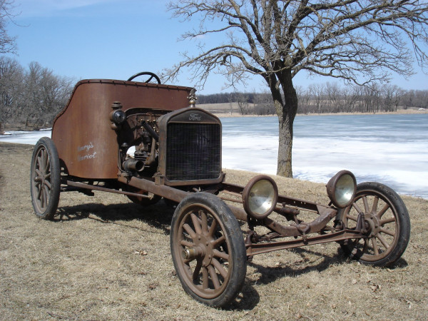

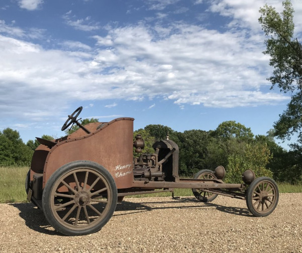

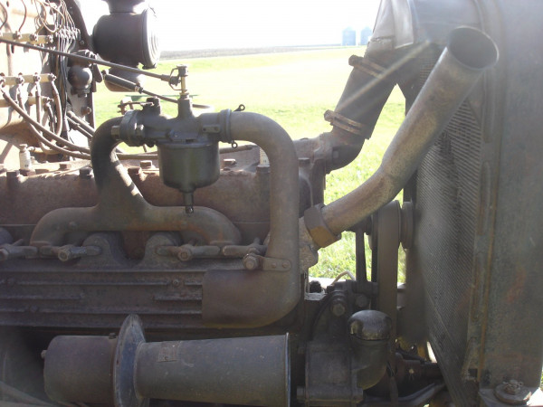

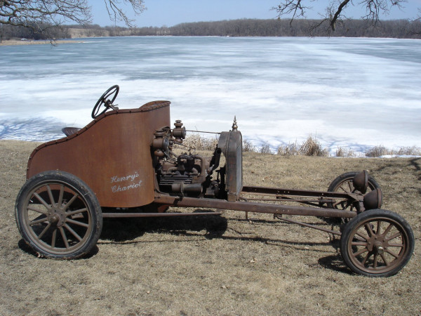

MTFCA Forum,
A few years ago, I put together Henry's Chariot to use up leftover parts,
and except for the body, it is all Model T. Things did get rearranged a bit. :)
Mechanically, the insides are all rebuilt, and it goes down the road well.
It has been fun to take it to car and threshing shows.
I have been finding good information on this site for years. Thanks Forum!

Cool! Like the upside down intake.

I love your downdraft arrangement! I've always wanted to do that and use a vaporizer type exhaust manifold with an exhaust port in place of the vaporizer plate. Cool!!!

Ok, I too would like to see more photos. I want one. Drag bar???

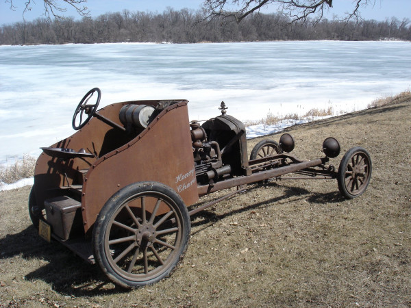

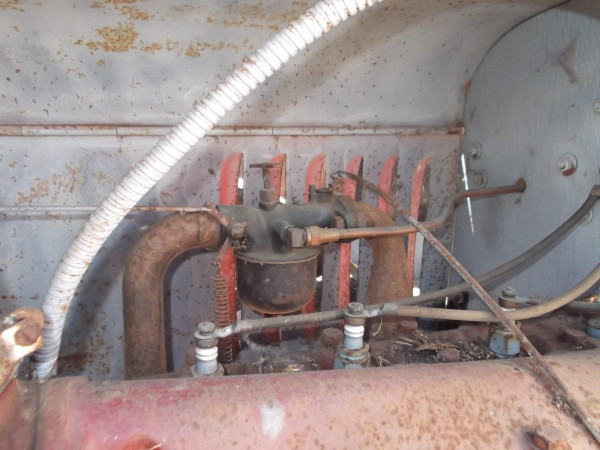

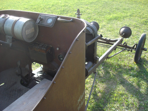

Here is a pic showing the "interior" of Henry's Chariot.
(The car is not yet equipped with wheelie bars and a parachute. :))
I liked those motorcycle chariots. Crazy!
Nate

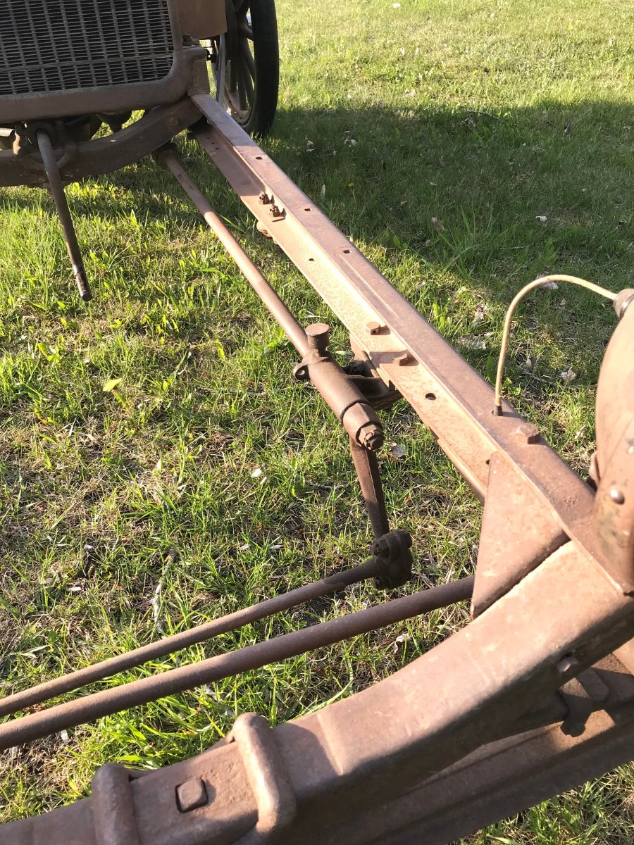

How does the steering work? The steering column ends in the middle of the chassis. Also does the vehicle steer with so light weight on the front end. Would the car skid forward then the wheels are turned? This has to be one of the strangest T modifications I have seen.

Re: Chariot Steering
Norm, the ball arm is removed from the end of the steering column
and a u-joint is fastened to the end of the column. A 3 foot long 3/4 inch shaft then
connects the u-joint to the front of the car, goes through an additional frame bracket, and
connects to the ball arm. From there, the drag link, tie rod, and spindles are basically stock.
So it really steers just like a Model T but with a u-joint and extension.
There is enough weight forward so there is no skidding while turning.

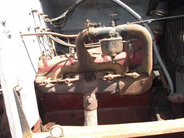

This picture shows the front end better:

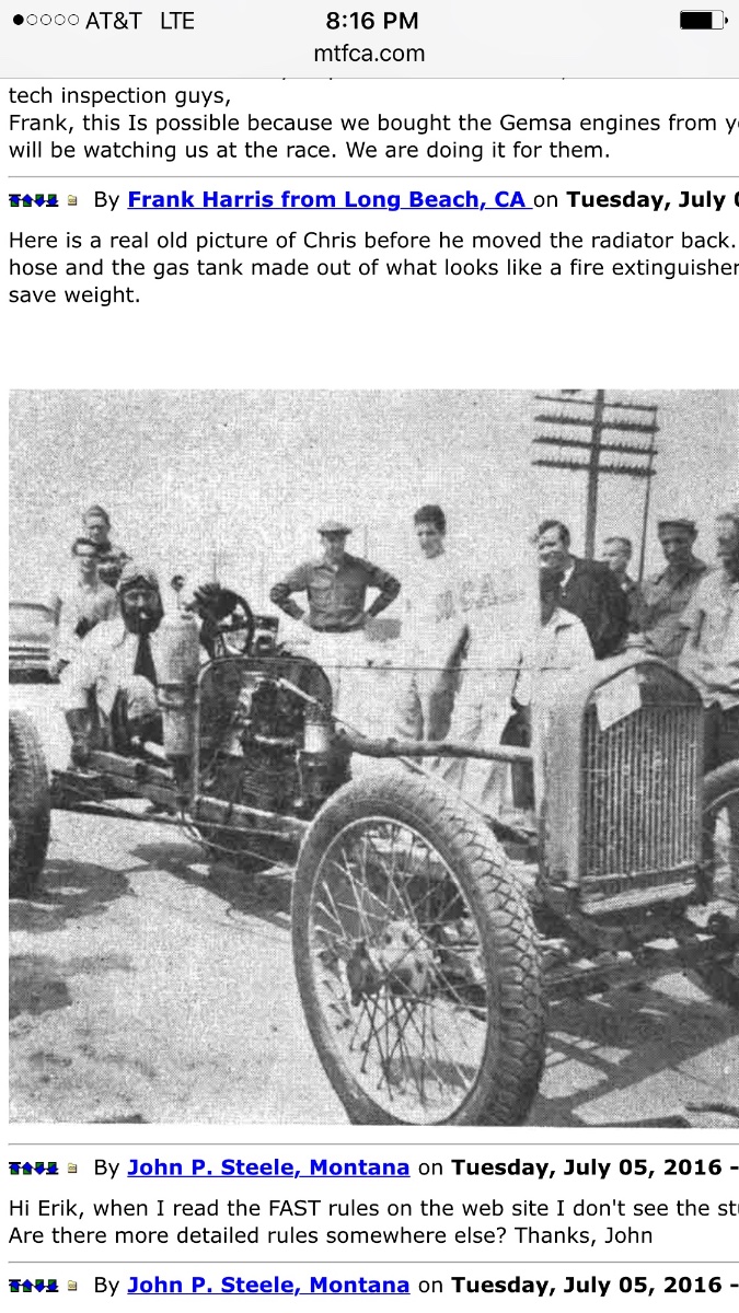

Reminds me of this.

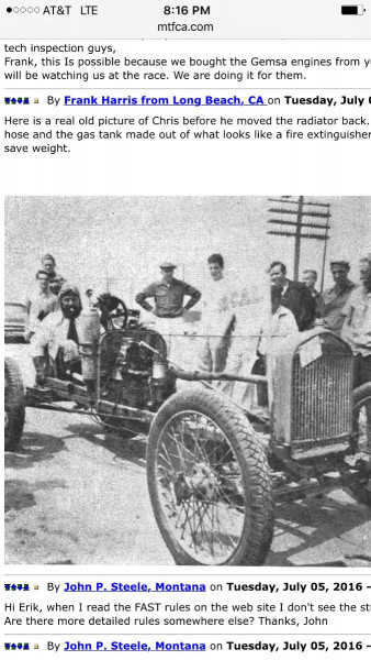

Erik Barrett wrote:
Wed May 13, 2020 7:31 pm
Reminds me of this.
Erik, I looked in the 2016 Forum archives for more pictures of the original "Wild Cherry" car.
There is also a picture of the "Wild Cherry" car you worked on.
Those are quite the Model T machines!!

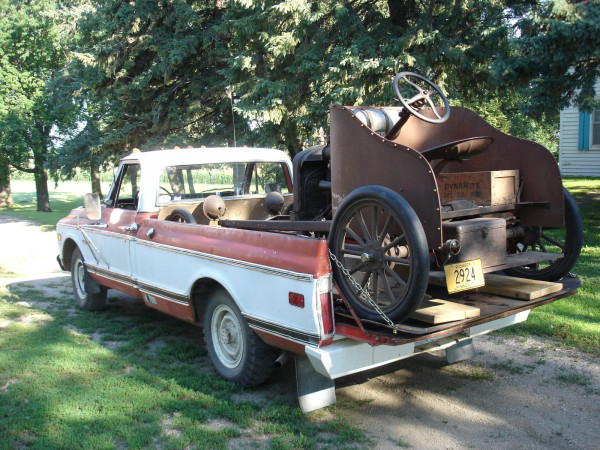

Here's a pic showing the chariot hauler (it's a non Ford, oops)
loaded up and ready to go to the race. The box of dynamite is
just there for any co-pilots to sit on.

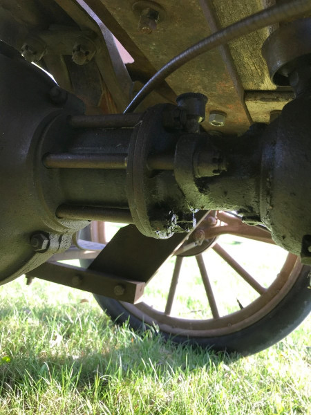

Super. I bet the drive shaft is pretty short? Those front wheels were not a simple task but really look right on it. How did the body come about?

More pictures as requested:

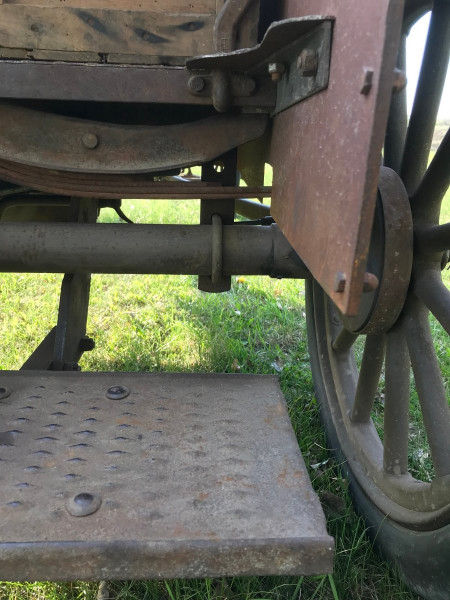

Driveshaft is 14".
Because of the short driveshaft/long radius rod arrangement,
the rear axle has to be bolted directly to the frame with irons and u-bolts.
This prevents stresses on the oil pan/crankshaft.
It also wants to make you want to drive on smooth roads.
Body is 1/16" steel. The front curves were shaped on a roller.
To make the top edge, two flat pieces of 1/4" steel were
cut out into an S shape, bent to fit the corners, and welded
together in the middle.

Post by Nathan Pederson » Sun May 17, 2020 8:54 pm
Rear brake drum speedometer drive
Updraft carb
Briggs and Stratton horn
Steering extension is connected to column with U-joint
"Ben"
Forum Friends,
Have A Model T Great Day!
Nate Pederson
Posts: 2832
First Name: Dallas
Last Name: Landers
Location: N.E. Indiana
Re: Henry's Chariot
Post by Dallas Landers » Sun May 17, 2020 9:19 pm
Thaks Nate, I was wondering how the speedo worked and steering. Not a simple project. Nice rig for sure.

Post by Nathan Pederson » Mon May 18, 2020 6:12 pm
The comments were all appreciated. Thanks.
Henry's Chariot is named in honor of Henry Ford, although I am not sure if he
would have considered it to be such an 'honor'. :D Figuring things out and putting
things together took time, but it wasn't work at all, it was fun. I am sure people
on here can relate. The original plan was to drive while standing up and with hand
controls. I decided to go with a spring seat and use the pedals. I have sometimes
thought about trying to make it pretty in gold paint, still might do that.
It runs well and drives and handles just like a stock Model T. Of course, an
overhead valve T engine in there would be interesting, maybe someday...
