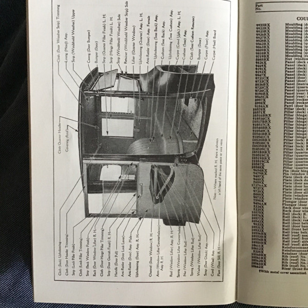

- Posts: 4529
Re: 1920 Coupe Side Window Glass Molding
Fords body parts book showing the pre 23 Coupes interior. Don’t know if all the pre 23 Coupes were the same but the metal trim strips go around the window frames. Not sure if there were any metal strips going around the windows themselves. Click on the pic to rotate it. Sorry about that!

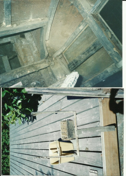

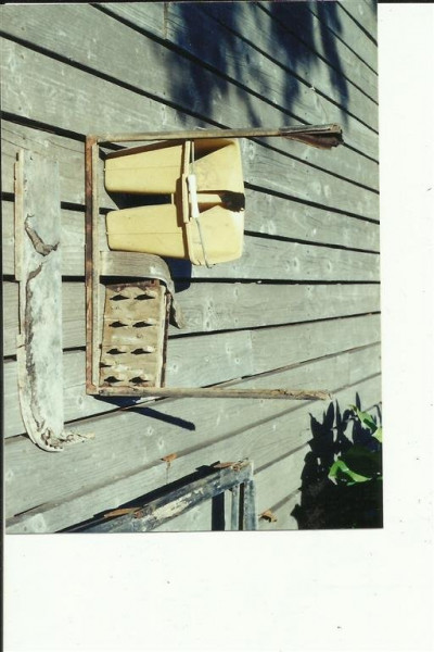

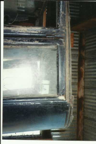

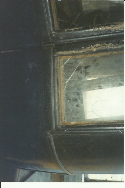

Wish all the photos of my 21 were not on a hard drive that crashed!
I seem to recall asking where I could get the channels that fit in the pillars because of their odd shape. The 22/23 were different the earlier coupes, they used the slotted piece on the window that the locking lever fit into instead of the lifting strap. This link might help (?)

- Posts: 5435
Not great but might help
- Posts: 5435
Before you ask, the ones shown in the photos are long gone. You might want to put ads here, Facebook, fordbarn.com etc and watch eBay. Not an item that is reproduced so you are going to have to do some searching. If you have them or samples, you may have to repair what you have or see about having them made.
