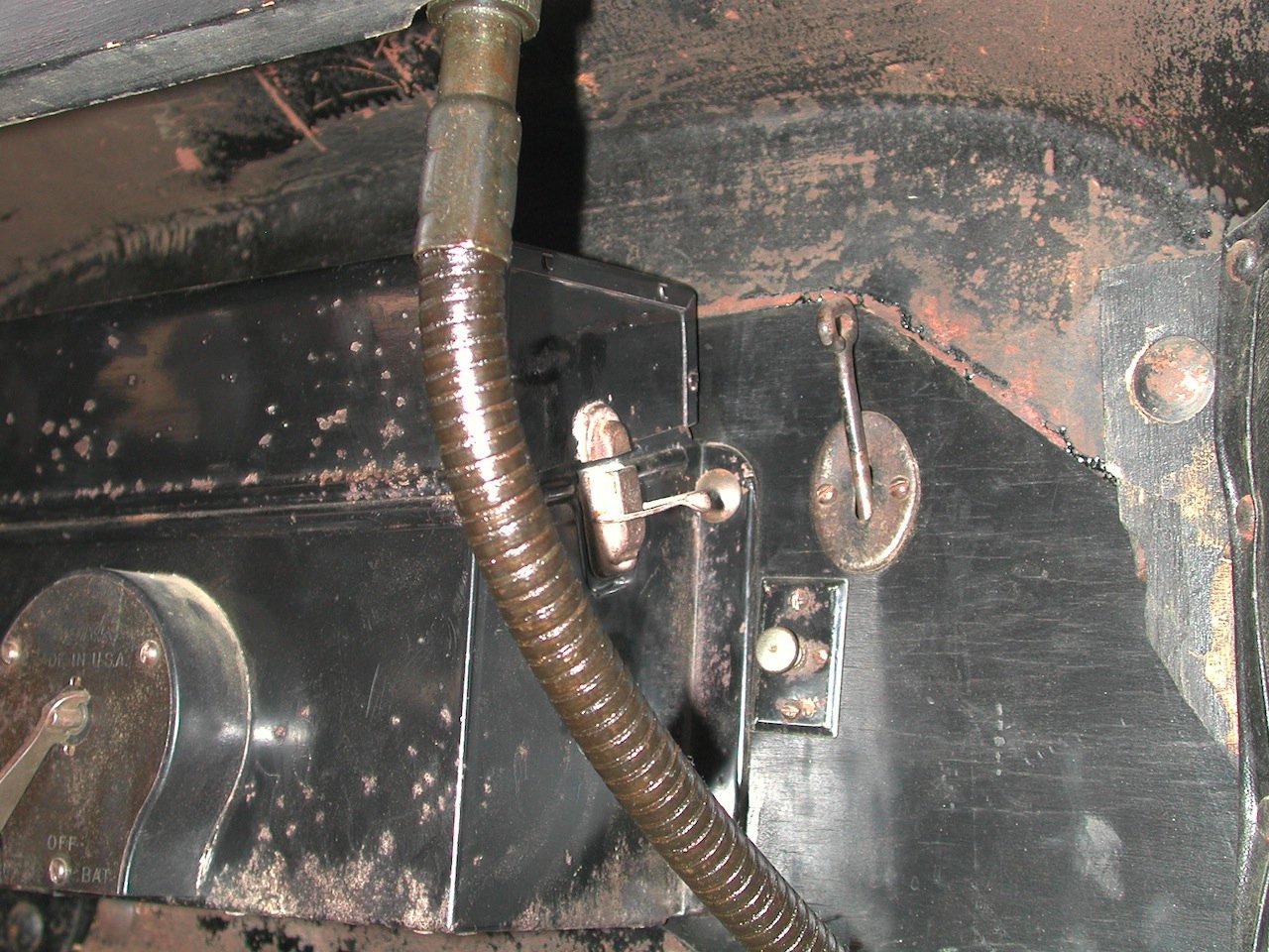

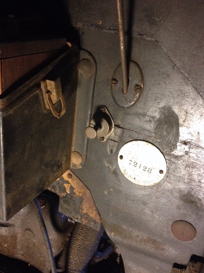

There should have been no need to cut anything. If that firewall is original to the car, if you strip the paint you may find the correct locations.
First photo is of Paul Iverson's unrestored 1916 touring. It is a very good example of a complete and unrestored car. Note that it has the "round" light switch but the location is the same as if it were the rectangular switch.
The second is of the unrestored 1917 "Rip Van Winkle" touring. The measurements/locations for the light switch and choke rod should be the same as 1915 and 1916. I have an unrestored 1917 roadster and the locations of the switch and carb rod plate are the same.
