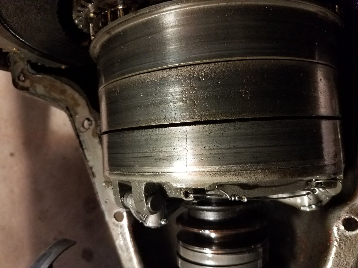

Pulled apart my transmission today... Had a cracked brake drum in two places. Ordering a new one.
Showing pics of old brake drum: Outside of clutch basket: Inside of clutch basket: Over half the clutch disks were either cracked or broken. Ordering Watts disks from R.V. Anderson.
Looks like I can't add more photos, so will in a reply.

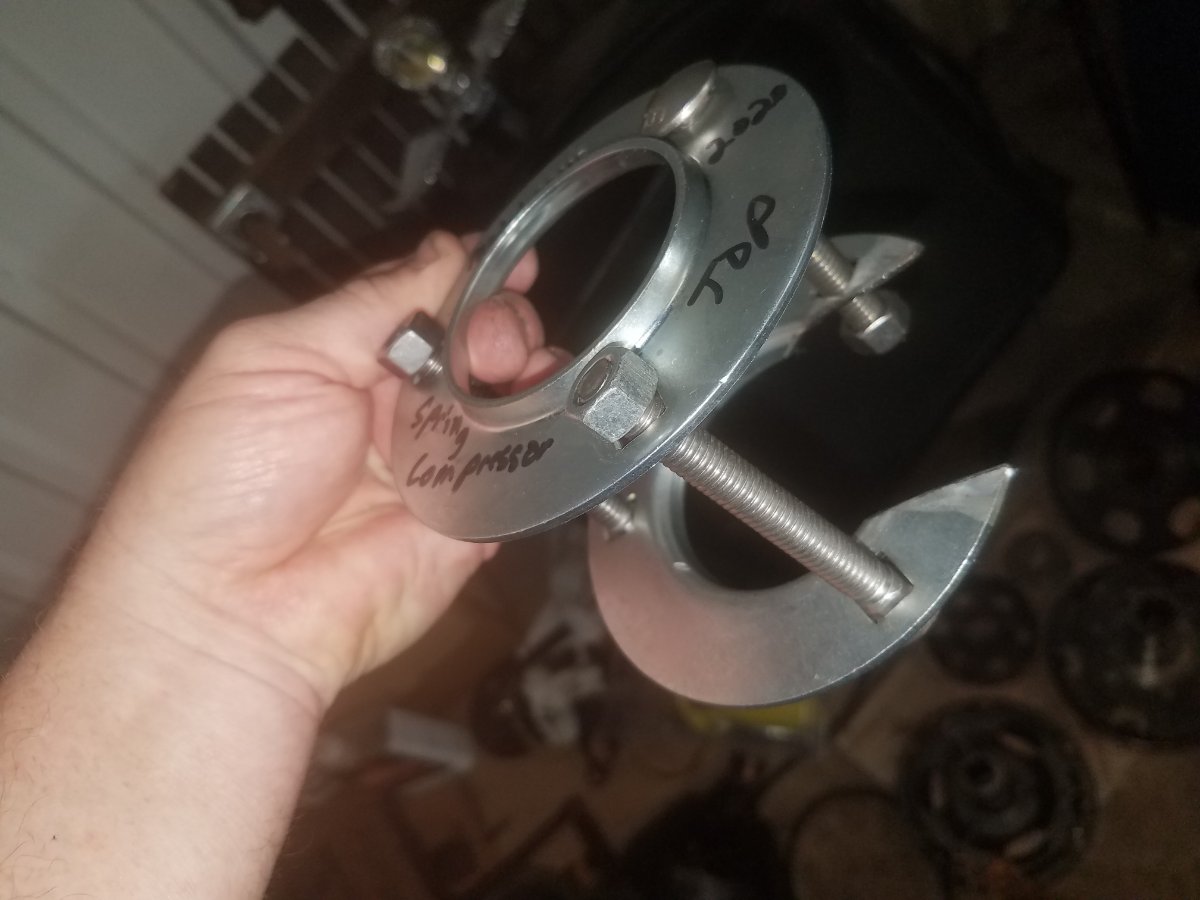

I made a clutch spring compresser from a couple flanges from Tractor Supply, as I didn't have any spare wheel hubs.

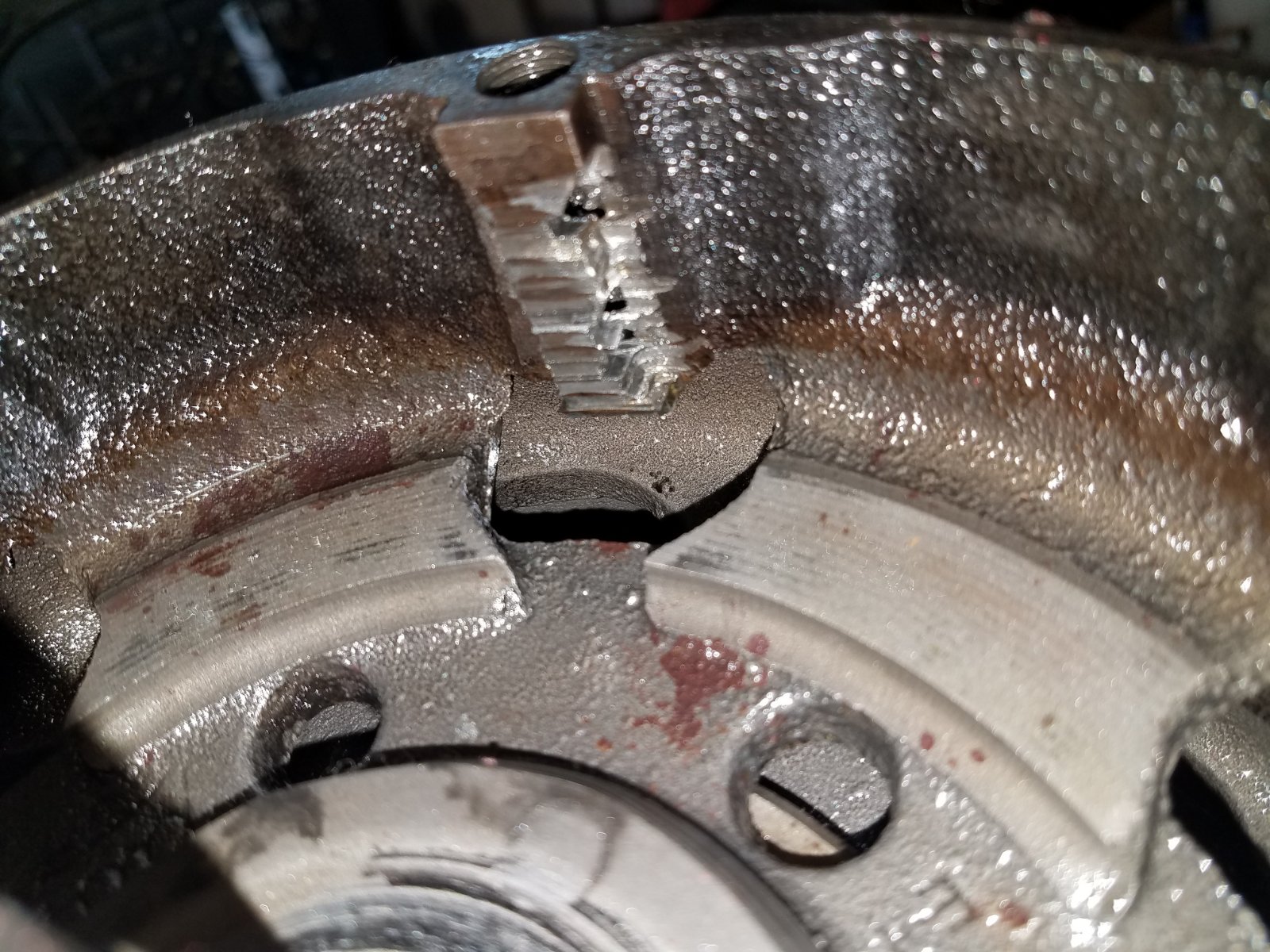

The clutch discs were cracked because the brake drum lugs are all chewed up. About half of the large plates in the transmission in my 23 runabout were broken too. The watts clutch works well, but with your new brake drum and some replacement original steel plates the stock clutch will work just as well. Save you a little money.

The spiral mark on your clutch basket is most likely a manufacturing mark and harmless. BUT, given the nature of all the other damage you've got, check it out to be sure. Clean it up and see if the spiral continues down in and through the slot, as a crack would do. I think you'll find that it won't, but again, check it out.
And yes, this would explain the rocking back & forth when you stop.

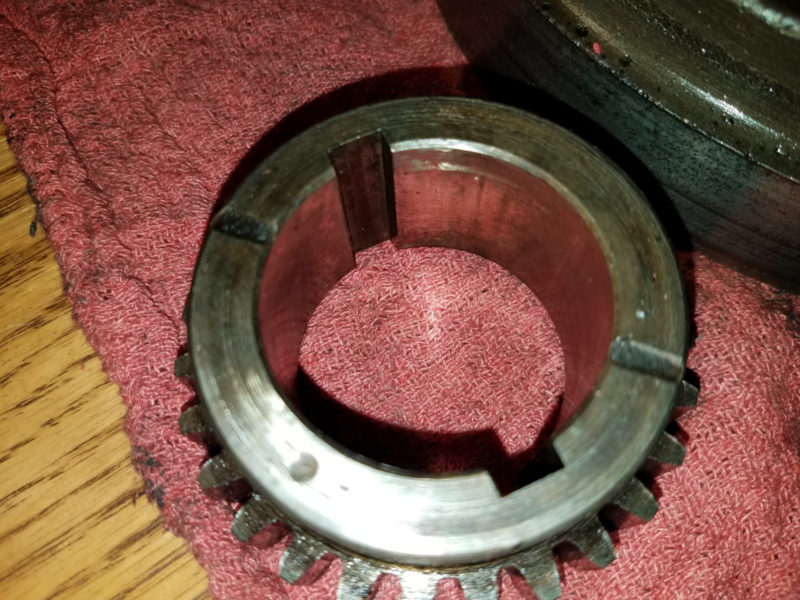

The driven gear bore per the Ford drawing is 1.651"/1.652"

That has to be one of the most chewed up brake drums I've seen and I've taken quite a number apart !!!

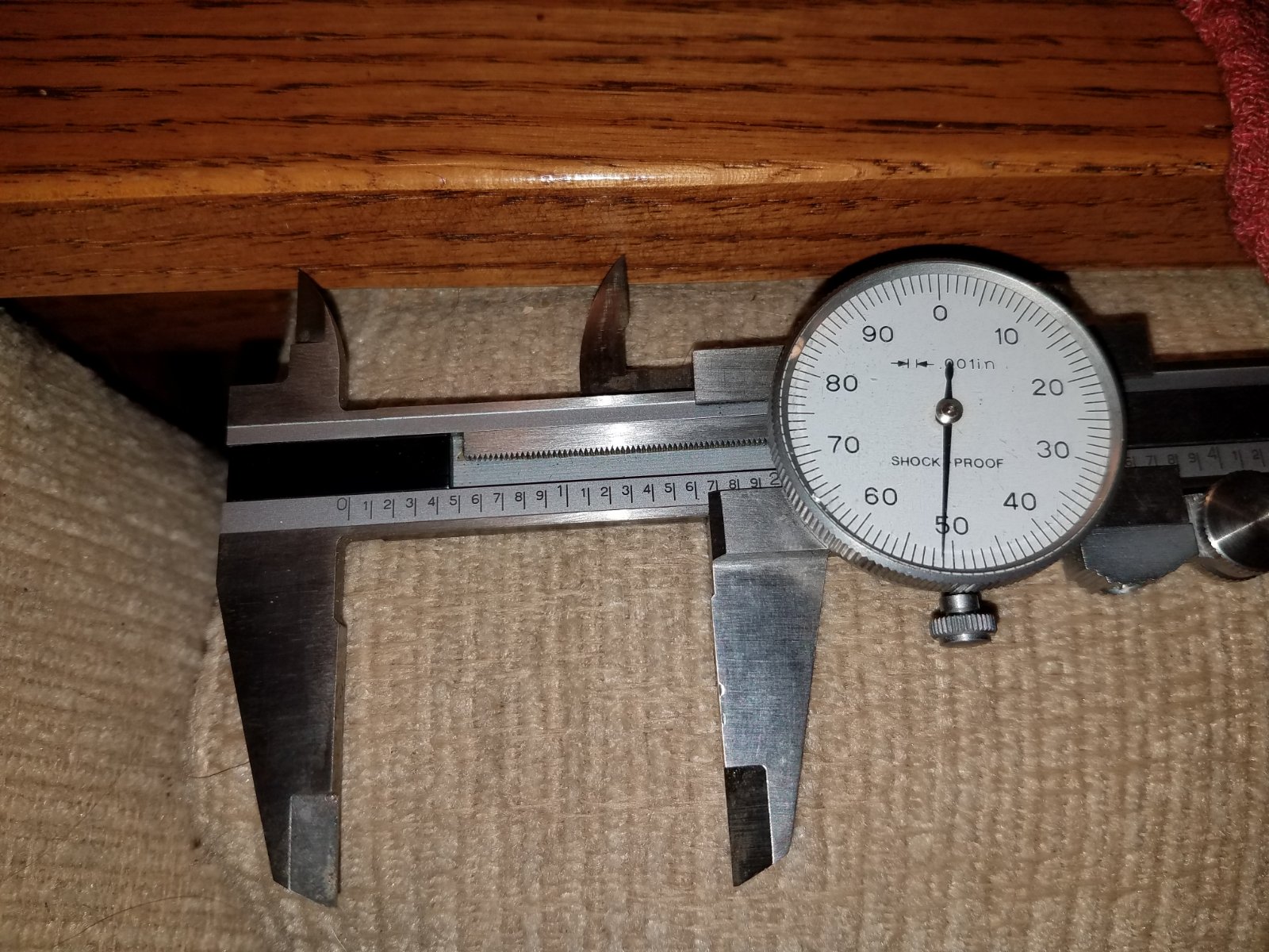

The readings I get with my calipers are 1.650" ID on the driven gear, and 1.651 on the area of the brake shaft where the 2 keys are, with 1.652 in the 'unused' area if the shaft above where the opposing holes are, then back to 1.651 in the bushed area, down next to the drum.
Interestingly, the driven gear won't just slide back on. With some effort, I can 'wobble' it back on, maybe 3/16".... To go further, I would have to drive it on.

If that gear was in my shop, it would recieve 9 separate measurements using telescoping gauges and an appropriately sized micrometer that had been double checked for "zero" against a 1" standard block (there are admittedly other ways to measure, including inside mics, but I find telescoping gauges combined with a good outside micrometer to be satisfactory for the accuracy needed). Those 9 measurements, mapped, would let you know what's really going on. You've already found a slip fit situation for some portion of the assembly which the dial calipers did not pick up. Though they appear to be built for it, they really are not the tool for this job.
Good quality dial calipers are my go-to tool in my shop but do not trust them to be accurate under .002" if it is an important measurement, and this one is. ID measurements can be particularly problematic and give bad surprises even if you're used to using them carefully and correctly.
As an aside, if you're used to the method, standard Starrett hand calipers can guide you to a remarkably close size "to size" on a lathe and save you from constantly double checking with measuring tools prior to going in for the final cut, but that's an entirely different subject.

More than likely both the driven gear and the brake drum shaft are shot because the gear would have been moving slightly on the end of the shaft. Good driven gears are easy to find and cheap. Find a better one and you'll be all set.

Scott... I wish I had the skill set and tools to do proper measuring and comparison. I have sent my old drum and shaft to R.V. Anderson to mount one of his new break drums to my old shaft. If he makes the shafts as well... I will ask him to go ahead and install one of his, instead. Otherwise, one I get it back, I'll take the setup to a local machine shop, and have the shaft turned to match one of Dan's (I think I got his name right) undersized gears.
