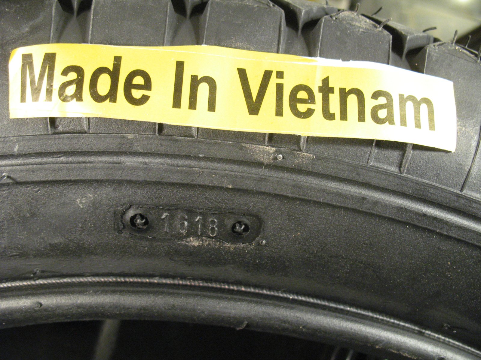

UPDATE: According to Bob Coiro, who I believe has researched the subject, clincher tires sold by Coker and most others have been made in Taiwan since 2009. Wards Riversides, sold by Lucas, are still made in Vietnam. The varying prices depend on brand name and appearance, not quality, and if one brand lasts any longer than others it's because of tread design, not better materials.

I've purchased & mounted 10 new clinchers this winter for myself - 10 Firestone & mounted 2 Universals for a friend - ALL 12 had gold paper Vietnam tags wrapped within !
Just like my Wards. Apparently the Taiwan thing didn't work out.

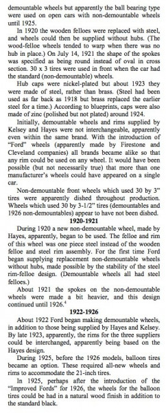

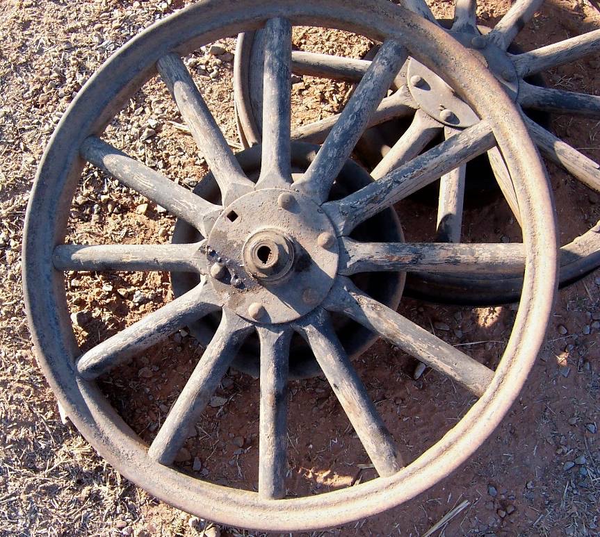

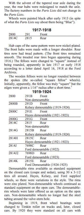

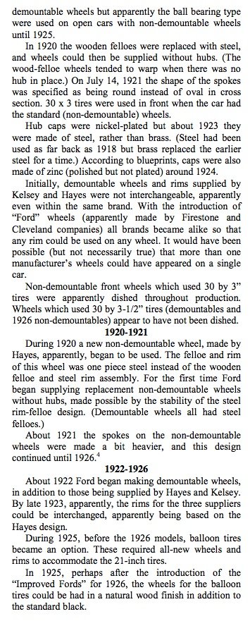

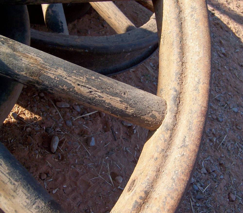

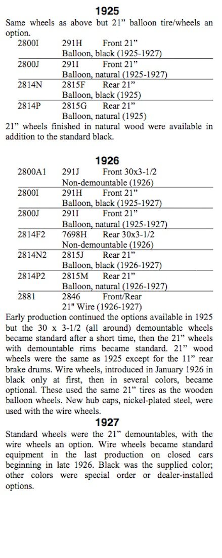

Appears the 706,408 open cars sold in model year 1926 were starter equipped and came standard with 30x3 1/2" clincher tires, as 21" split rim balloon were extra cost, but perhaps many went for the bigger nicer riding tires. Seems no record of what tire equipment supplied, so we won't know.
According to Bruce's research, only about 3,000 open cars were non-starter in 1926, and later in the calendar year these were special order only.
The non-starter got 30x3" tires in front, and 30x3 1/2" tires in rear, on non-demountable wheels, those spoke wheels had steel felloe.
No rim carrier, and kerosene tail lamp, magneto headlamps.
So this runabout was a rare bird then as now.
Steel felloe non-demountable clincher wheel, 1926, with the improved car big brake drum.

Dan, those figures are interesting. Suffice to say, the Canadians did it differently, going on my observations of cars in Australia. They used 30 x 3.5" clinchers all round, front and back, from the outset. I am aware of one 26 tourer in Australia which has 30 x 3.5" clinchers. This car was a special order, the customer requesting same rather than 21" balloon tyred wheels. The car was later traded back at the same dealer, and that dealer has it to this day.
Apart from this car, and another I have been advised of, all our 26 models came with the 21" wheels once they were available. I have found a few 23" wheels with large brake drums, so they are not unheard of, but are definitely a rarity.
