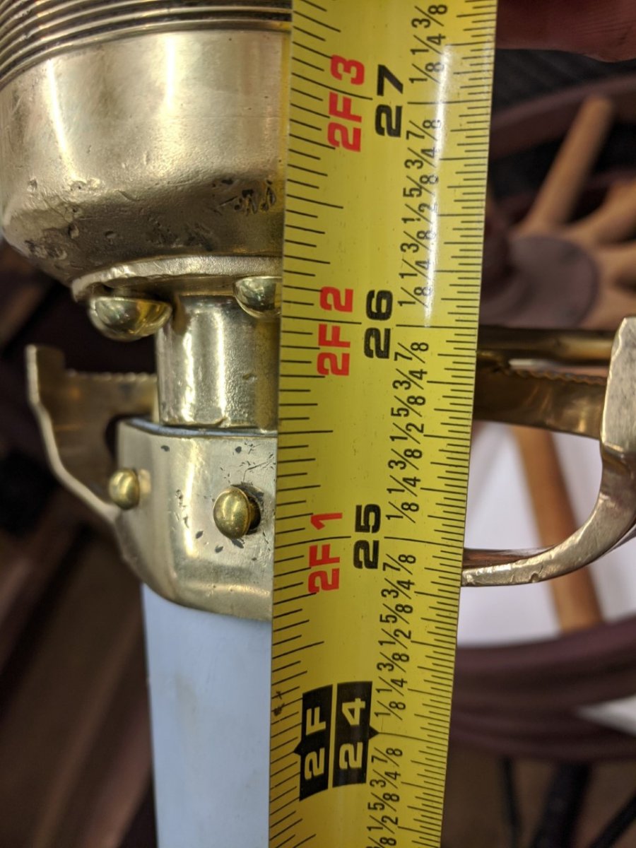

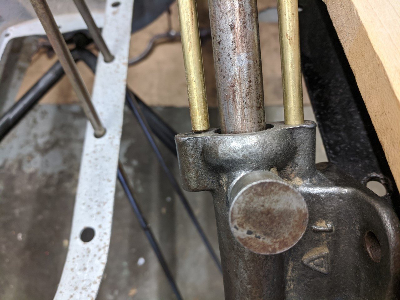

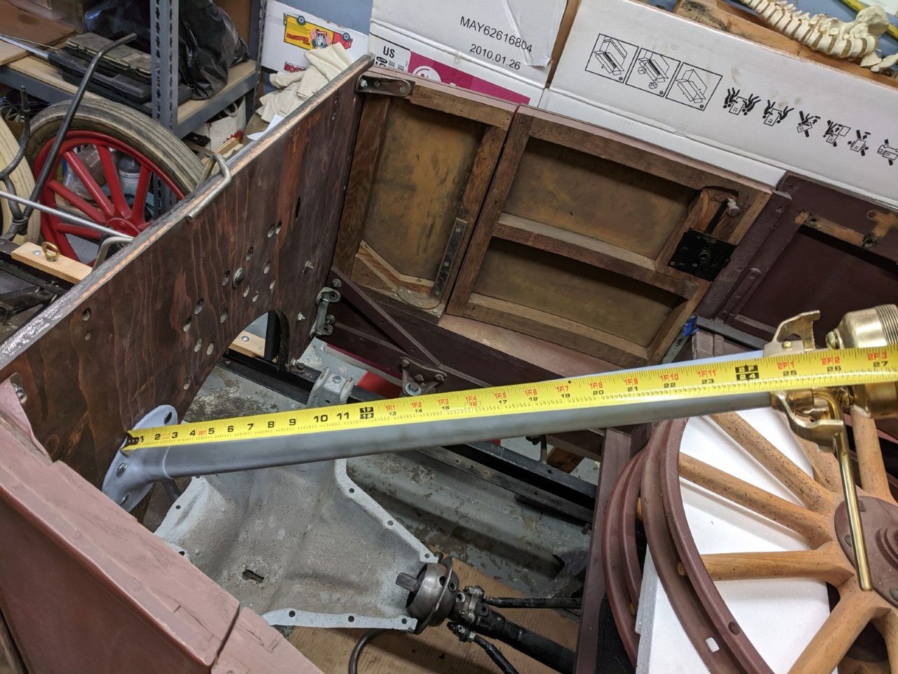

thanks Dan, but now I am more perplexed. The steering shaft length that you shared is 54 1/4" long and not 56".
The part I am referring to is in the picture. Of course now I wonder why my shaft is so short? (remember this is a family forum! No comments. lol) Deal with that next.
The column is 25 1/2" in the attached picture of the torpedo.Again the rods are too short making me think the column is too long? The gas rod touches the steering bracket but doe not go through.

Using the same standard to measure that you are there, my '11 Torpedo column tube is 29-1/2" and my 1912 column is 25-1/2". It seems that you have the correct column in your '12 Torpedo and an incorrect column in your '12 Touring.
