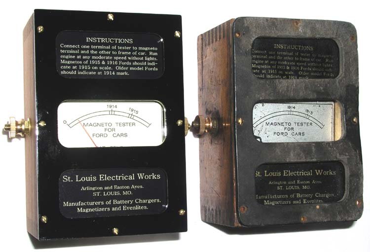

FunProjects St. Louis magneto tester is the best way to measure the output of a Model T magneto.
