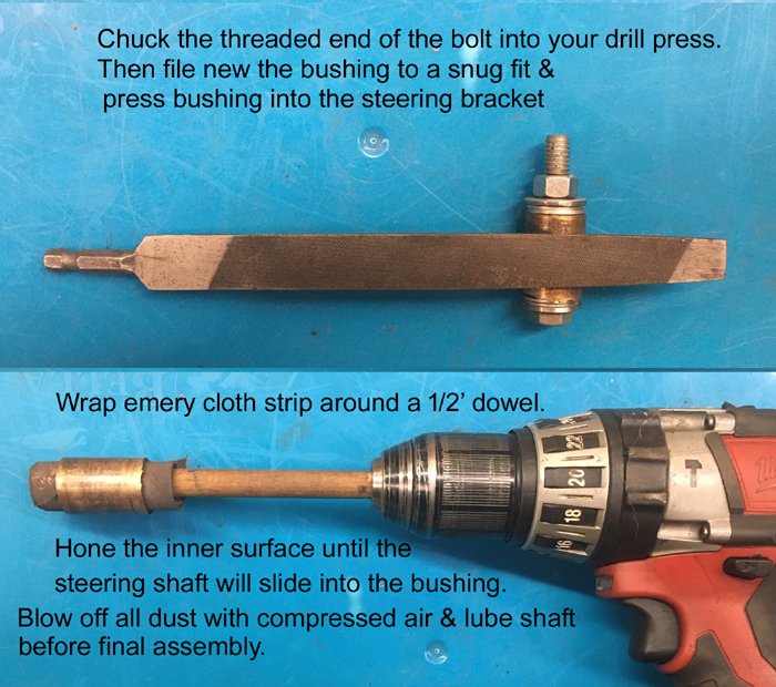

Re: Steering bracket removal
With no machine shop handy, this is how I fit the new bushing to the steering bracket. It worked pretty good.
Excellent idea Bill. Done like any farmer in the past may have done, if he had those tools. A lathe and micrometers aren't always needed for a T.
Dave - Yeah,....sort of compares to methods that can be used to replace disintegrated babbitt in the rear end with bronze without a lathe when careful use of a belt sander will do just fine, right? ......harold
- Posts: 7327
Bill, you have done well. That kind of work fits well with doing the best you can with limited resources. Even if you are a bit off, it's going back on a worn shaft, so you couldn't have done much better.
