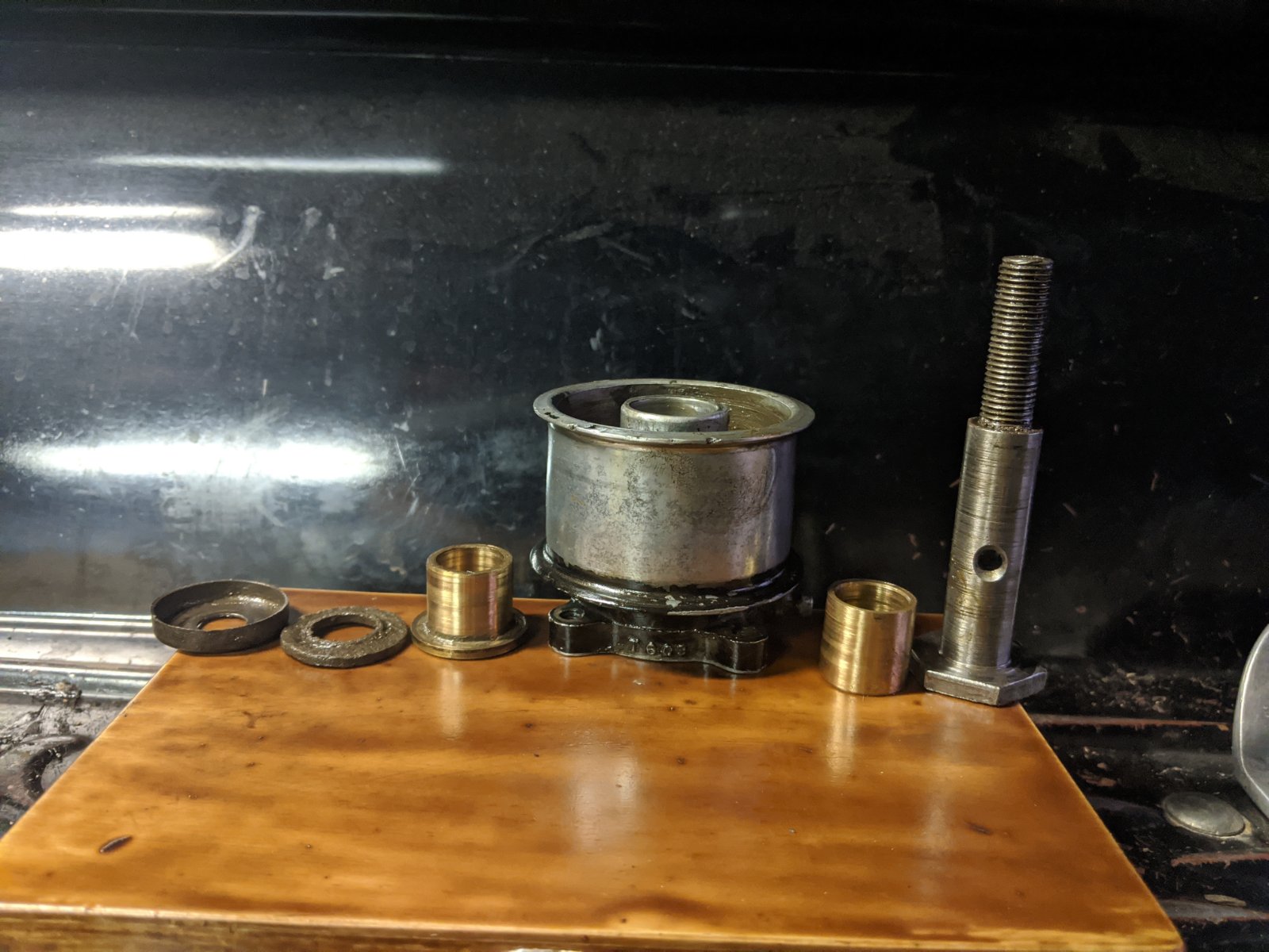

So I took the hub apart and cleaned the parts. What I have is shown in the picture.
Everything looks pretty good, almost new or at least newer. Certainly not worn. But . . .
. . . isn't that front bushing supposed to be flanged? And if so, could that bushing sliding backward on the shaft have been the cause of the dreaded wobble?
Also, just out of curiosity why is there a hole in the shaft?
Thanks!

the bushings are press fit in the hub. They are the same, both have a flange. The hole is for the oil to get where it needs to go.
Now, the experts can chime in

Yes, there should be a flange on both bushings. The whole in the shaft is for lubrication BUT originally, that hub would have had a plug in it where one would have pumped in 600 wt. oil - I'm assuming there is now a zerk fitting there.

That fan hub is for the later style fan with the plug for oiling. The shafts with the hole are for earlier fans with a greaser at the back for lubrication.
There should be a gasket between the fan blade and the fan pulley at the front, and a felt washer at the rear between the hub and the cupped washer.
When assembled, the shaft should screw up hard against the shoulder on the shaft, the castle nut being just a locknut. If this seizes the fan on the shaft, the bushes need to be faced until the fan turns freely. Some cheat by not winding the shaft up against the shoulder, and relying on the locknut to hold the shaft at the right depth in the fan arm.
I have rarely found a fan hub where the bushes are not worn. Having to remove the plug to oil the assembly means the operation is often passed over, and worn bushes are the result. Check the shaft too.

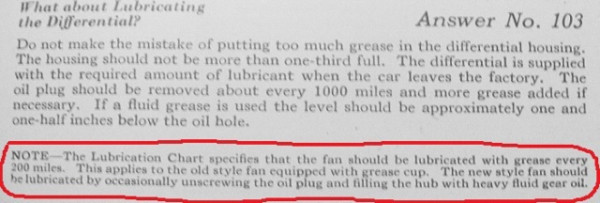

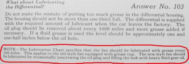

Ford Owner's Manual
Fill to brim of the opening. 600W is good for this.
