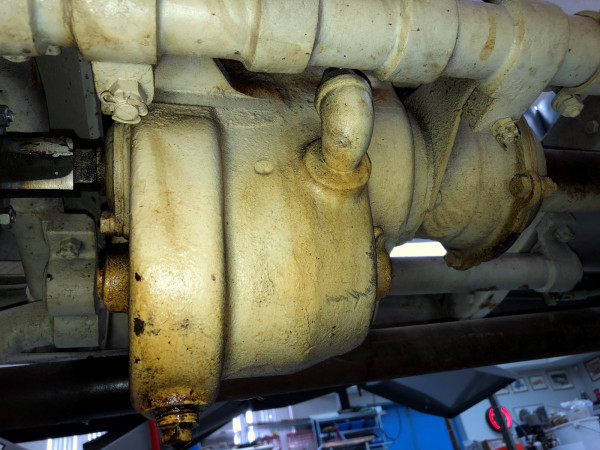

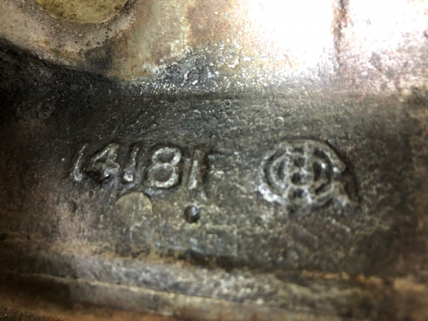

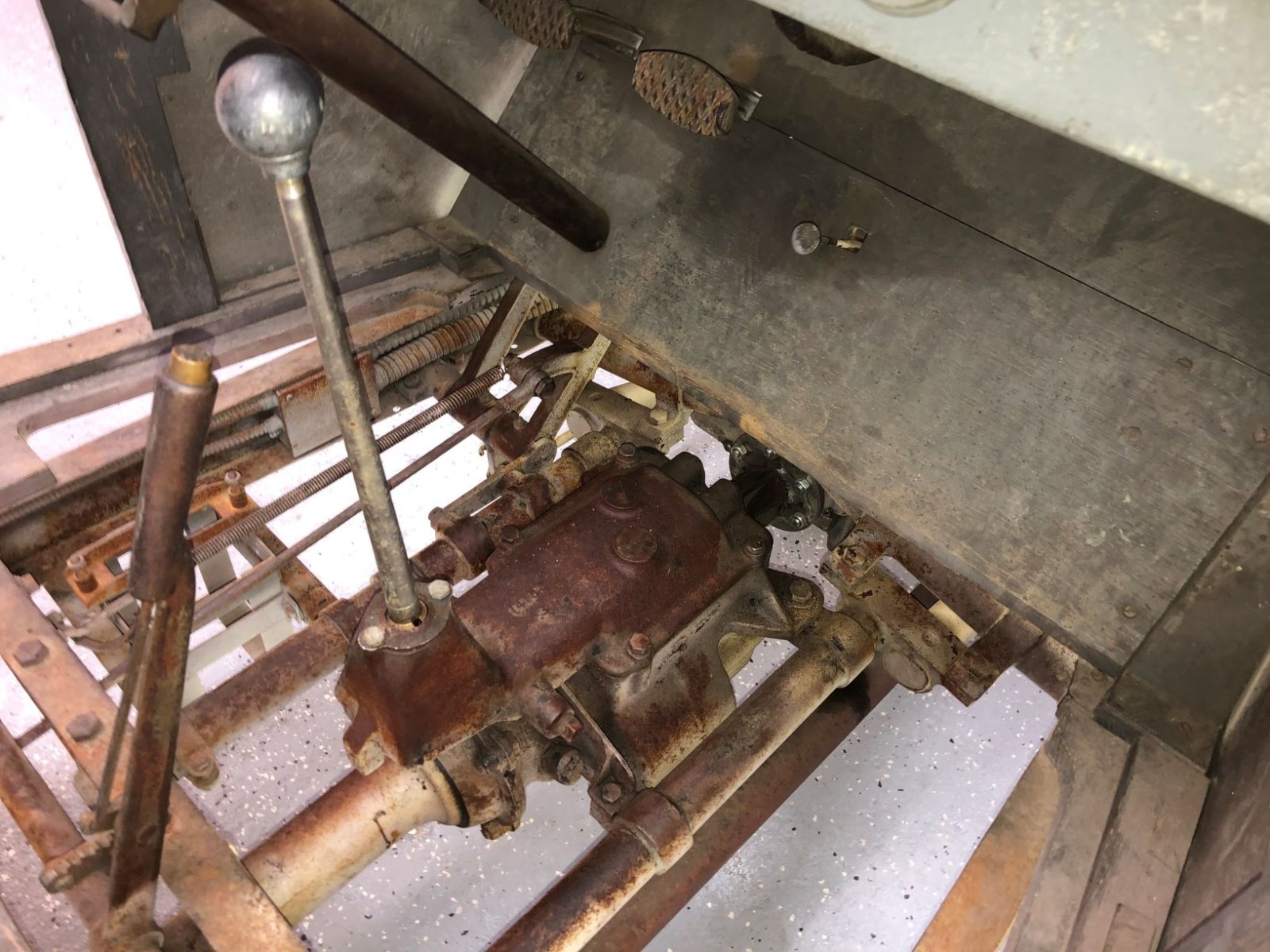

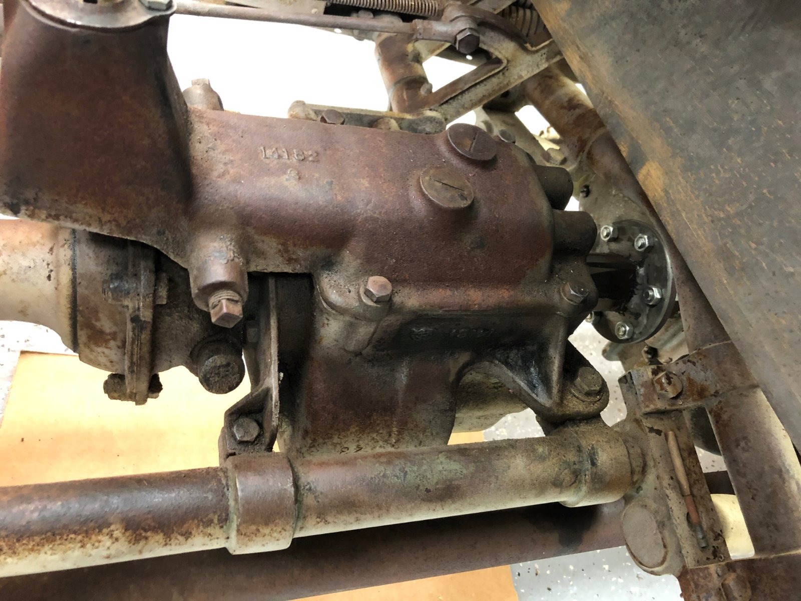

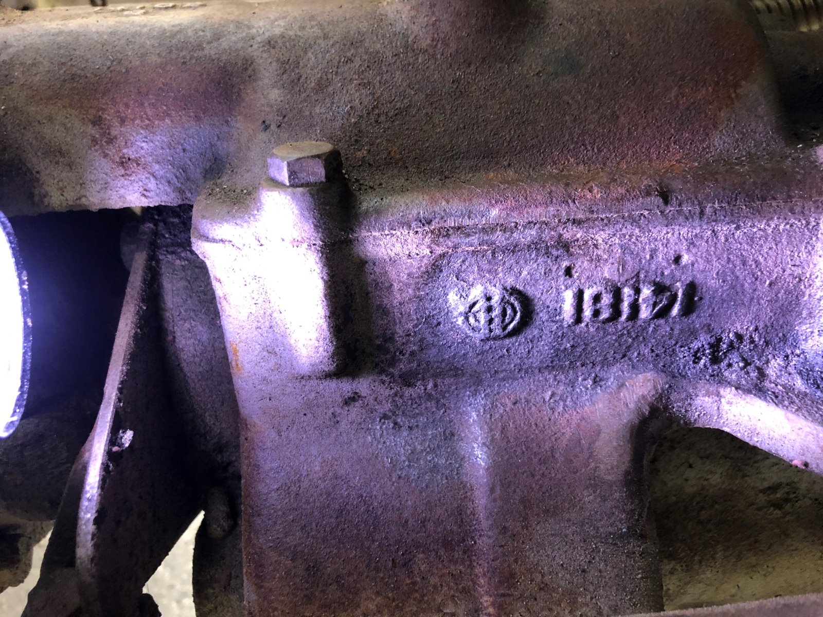

This is a prototype Cyclecar built from 1918-1925 in Hanlon, MA by a Dr. Kirk Hanson, who left virtually no information behind. The engine is a 1923 Henderson motorcycle engine. I am told the rear end is Model T. Does anyone recognize the transmission? It is a 3-speed with reverse. The input is by way of a coupling to what appears to be a 1" shaft. Does that suggest an aftermarket gearbox for the Model T? The cover has the numbers 14182 over a 3 cast into it. The right side of the case has the numbers 14181 cast into it with a curious trademark consisting of the letters H C G superimposed over each other, not necessarily in that order. I can try to post other photos if other features would help identify what the good Doctor ordered for his transmission. Jeff in Wichita.

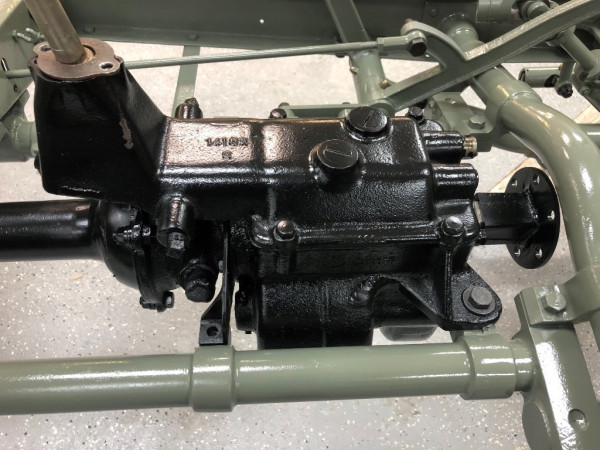

1916-21 or so Chevy k or 490? Maybe truck too.

Post by ThreePedalTapDancer » Wed Jul 22, 2020 1:02 pm

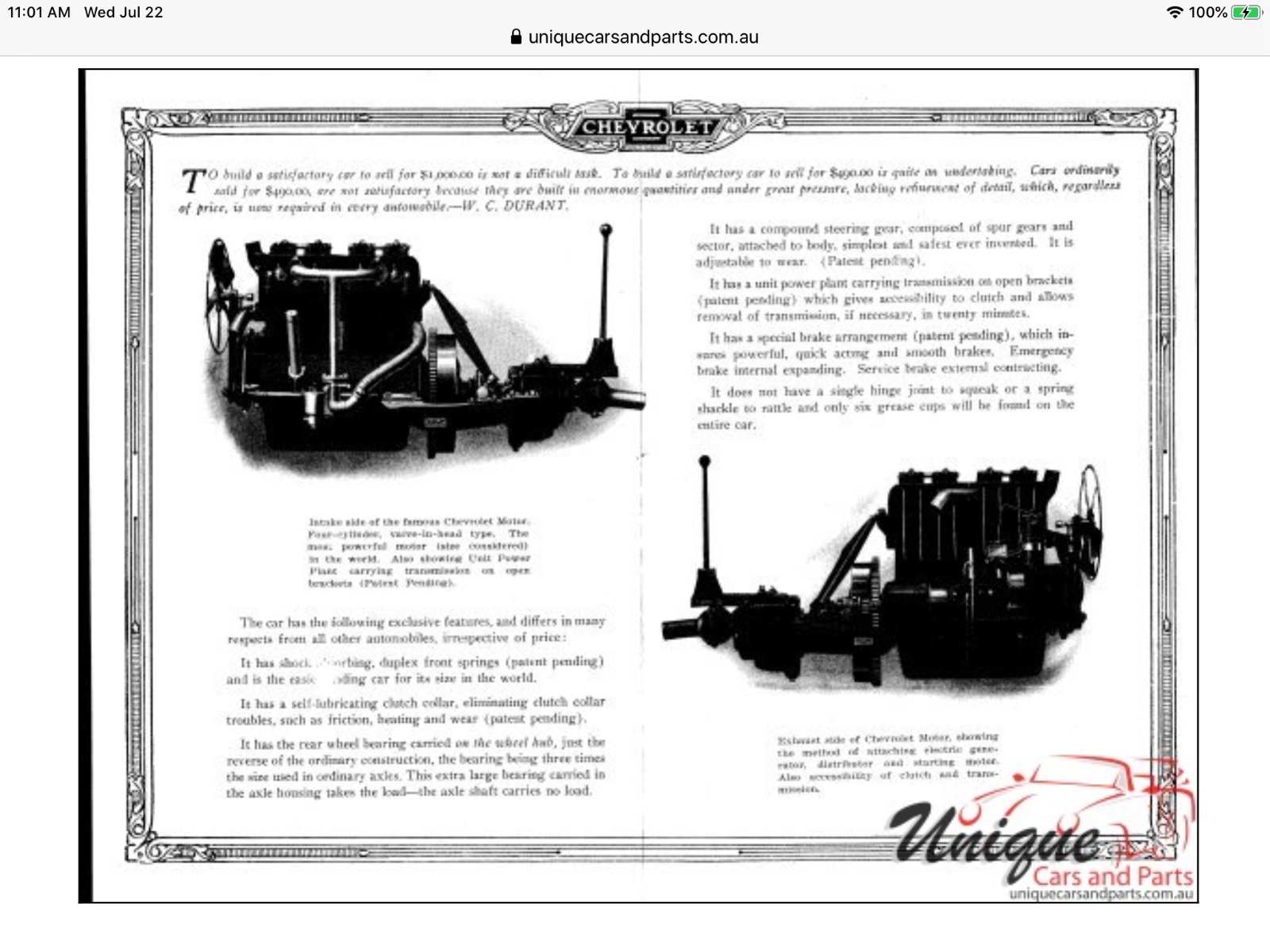

Similar transmission , probably in the same family of cars.

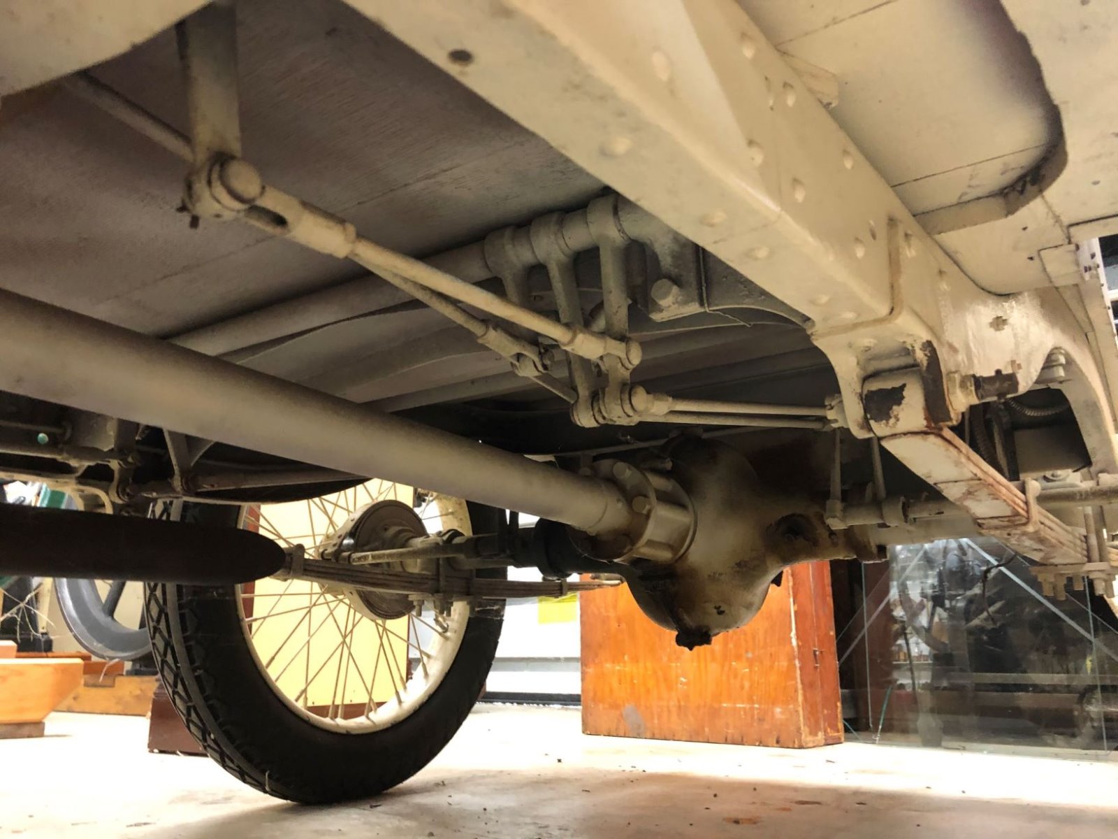

Yes, rear end is Model T.

Thank you for your posting. The ad copy, where it says the transmission is on open brackets, resembles what you see in these 2 photos. I'll be on the hunt for more views of Chevrolet transmission drawings and photos of the late teens era.

Dan, thanks for confirming the existence of the Model T rear end.

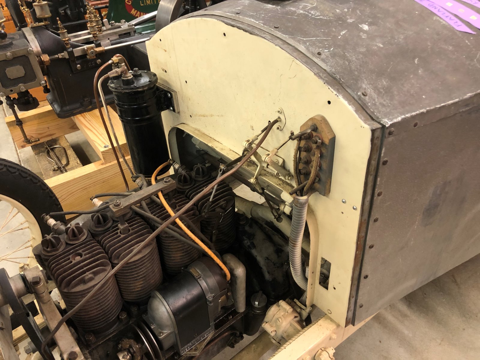

For those curious about the air cooled Henderson engine. Special bronze cast timing cover for the fan to perch on and the crank to pass through. Rear end of the engine was cut off after the clutch eliminating the gearbox and chain sprocket, closed in with another casting allowing an extension of the crankshaft to mate with the transmission. It is surmised Dr. Garland wanted to go into production but the affordability of Henry Ford's products ended the era of motorcycle engine powered cyclecars.

I believe the transmission was actually produced by International Harvester Company. The later versions of their "High Wheeler Buggy" used a similar style one. That Henderson engine alone is worth a small fortune to a bike collector. Last one in running condition I know of sold for $20,000.00.
Hank
Thanks Hank. That could very well explain the logo. Will dig further. Photo will only load upside down, sorry.

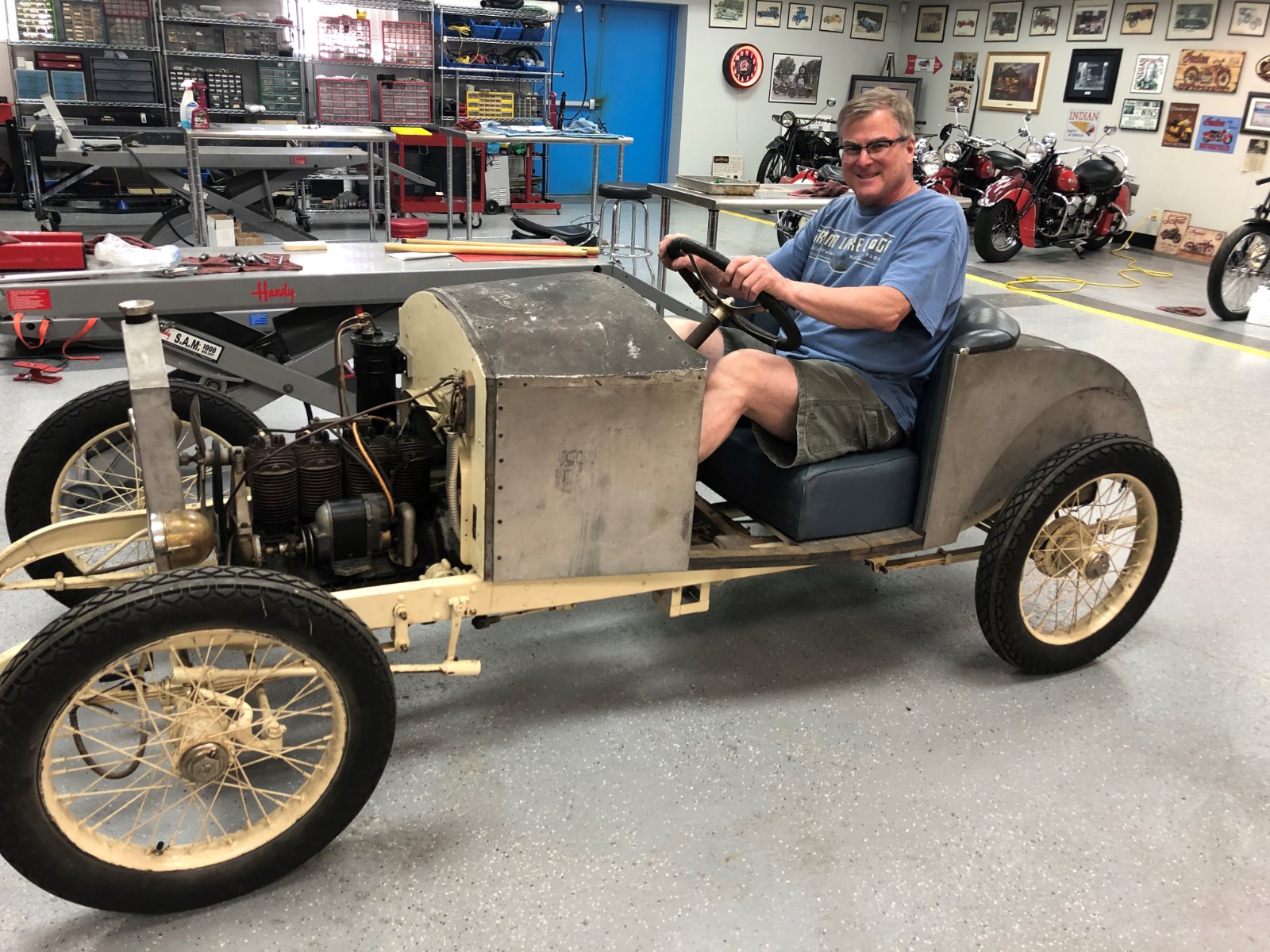

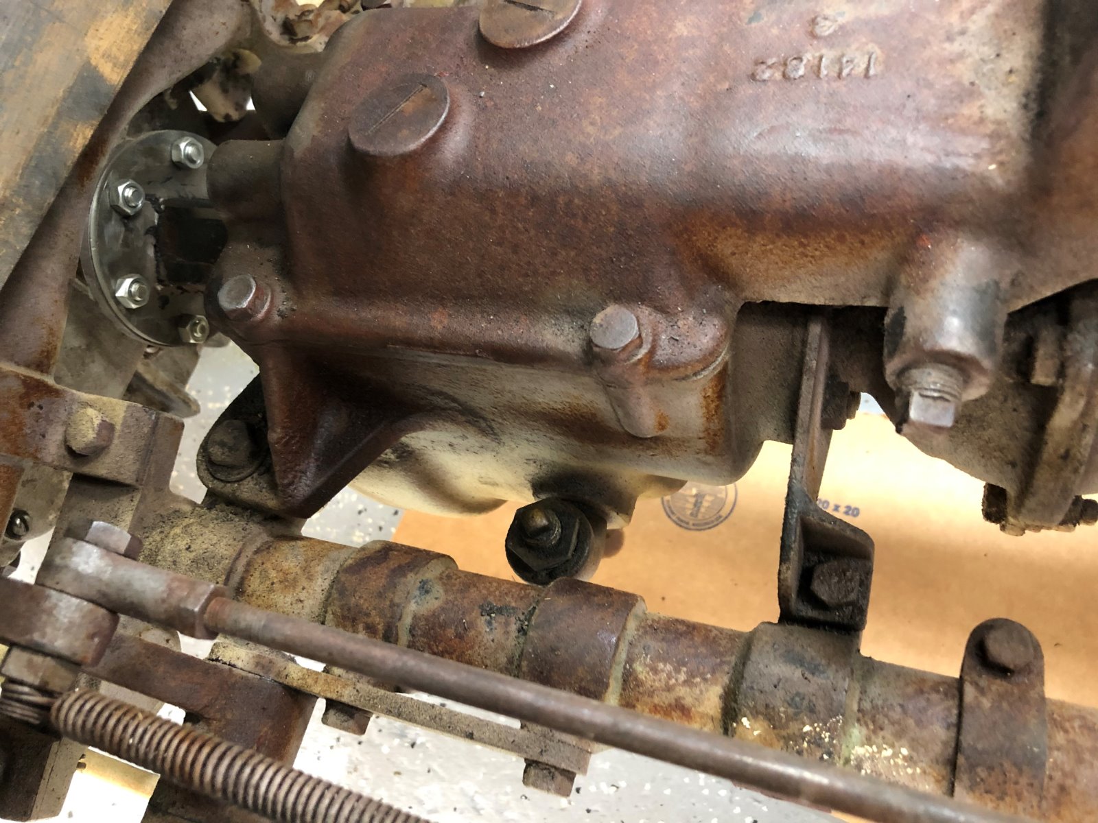

Todd, I went back to this thread and saw your comment. I'm at Chance Rides Manufacturing, Inc. To answer your question this appears to be a one-off prototype of extremely high quality engineering. I have decided to do more of a refurbishment than originally intended and in the process have discovered numerous witness marks that were left by the original craftsmen, as if they were for intended production. They have been very handy in reassembly. This is the current view in Dick's shop.
