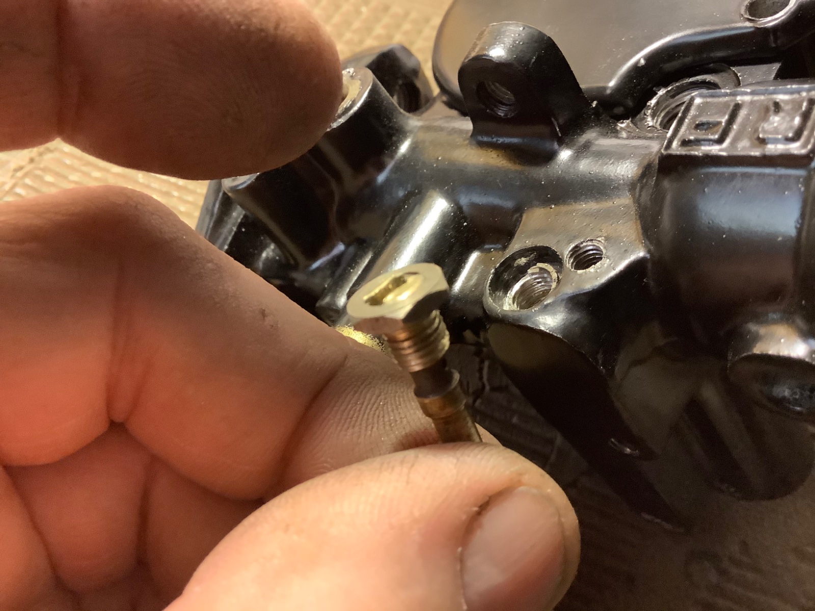

If I was doing carbs, it would just be brass for me. The “miracle” metal, potmetal came soon afterwards, and that just takes the fun out of it entirely. I don’t think it’s too much drift to show what I do with RF Strombergs. I agree with you, Stan, they can be a real challenge. I ONLY buy them when they look good and are complete. Even those can be hard to get apart, and I don’t even know what this is called, but some sort of jet right at the top. Instead of chewing them up, I use a spring loaded spot weld cutter. Then a 1/4-28 brass or nickel plated nut is used to reinstall. I silver solder the nut on. I turn the outside down to make an enlarged cap, goes right down in hole left by the spot weld cutter.
I think they are superior to OF in performance, but a challenge to rebuild, fer sure! Nobody would pay for the time it takes to do it, though.

That would sure work. The threaded insert at the top of the idle jet is all that sticks in the aluminum. I just mill it out with a quarter inch mill bit, enlarge the hole with a stepped mill cutter to 5/16 tap drill size down through the threaded area, thread it, whip up a new threaded idle jet upper and solder the old tube into the new insert. Much faster than fooling around trying to remove that idle jet if it is stuck.
Probably a half hour deal to do it this way.
More than one way to skin a cat. I like seeing how others peel the hide.
You're right, they are great carbs, I convert them to a viton tipped needle and that stops the leaks.

BTW, the threads are 1/4 x 32, good investment working on carbs.

Thanks Stan, I thought the thread was just a bit off. 1/4-28 cleaned it up nice With no damage but next time I’ll do it with the right thread. Thanks for that info. I’ve alway got a kick out the special threads on some of these old things. My theory is it eliminated parts and/or tooling going home in workers pockets.
