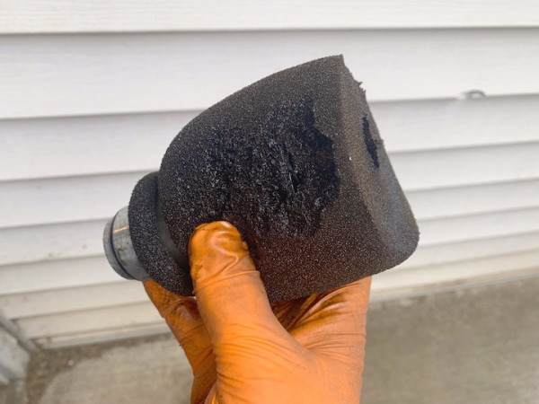

I had the bright idea to rinse the old filter oil from the foam element using lacquer thinner. That seemed to work, but gone with the old oil was the original size of the filter and virtually all integrity of shape. Oops.

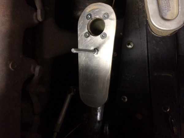

Interesting set up Steve. Any chance you have information on that filter housing assembly? Also how is the flange attached to the carburetor.

The filter I bought at Canadian Tire. The tubing is a 1-1/4” sink trap. The carb adapter and the filter mounting plate I made. Has LOTS of filter capacity for country roads!!
NO it doesn’t make the “invisible” requirement!

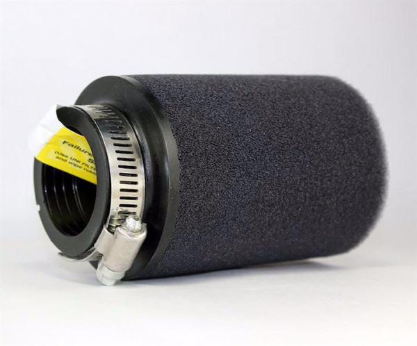

Here is the link to the UNI website. They are listed by diameters and length. Also a tab to cleaning.

I'm late getting back to this thread, but thanks to all who responded.
The immediate need has passed — after the lacquer thinner evaporated, my filter element returned to its original size and shape. Said element is now re-oiled and back in place.
