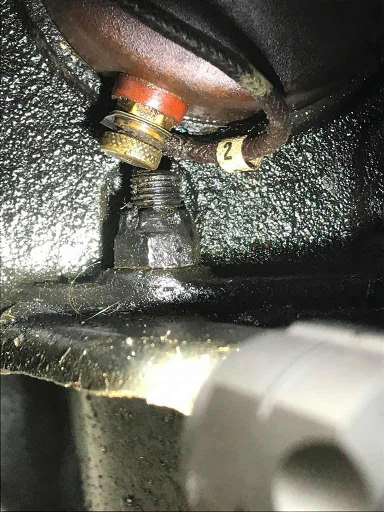

Is one of the timer posts hitting the pan bolt directly beneath the timer?

Bingo....
After some offline tech support from Scott Conger, I found that the timer should spin all the way around. I took it back off and low and behold an oil pan bolt was in upside down which was hitting a timer post and preventing me from getting enough rotation / retard.
So I got that all fixed up and now my rod was too short. I pulled it off and went to my neighbor guy's house, who just bought at TT (I'm a bad influence) and I used his as a pattern and got everything fixed up and I now have retard. My timer rod went under the water hose and my neighbor's went over the top, which game me a lot more adjustment.
I'll have to drive it this weekend before I officially declare victory.

Glad you found the problem. I never considered routing the rod over the top of the lower radiator hose, I just kept the stock routing and made a longer rod.

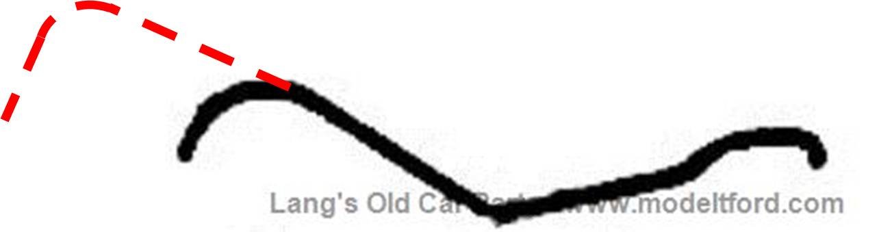

If you now decide to route the timer rod above the water tube you will be putting part of your problem back in. Look at the small lever that is pinned to the driver operated timing advance lever. To get the correct amount of timing advance you need to pass the timer rod under the water tube but NOT under the water hose. What I mean is that typically people don't know that the lower water hose should be about 3/4" shorter than the upper water hose. When installing the hoses there is a very large amount of adjustment range for water tube so people just try to center it and don't notice that if you have the lower hose not pushed all the way onto the radiator connection then the timer rod will hit the lower water hose clamp when you rotate the driver end of the timing control. They usually then bend the timing rod to try and get it to stop and that is "big mistake number 1" toward getting the timing setup wrong. If you look really carefully at actual stock setup in the T1 manual you might notice that the timer rod passes UNDER the steel tube and the lower hose and clamp is well forward of the upper end of the lower hose. A new timer rod is almost exactly correct as supplied but you should put it on first and set the timing before putting on the water hose to make sure you have clearance at the outer end of the lower hose so that the timer rod does not hit any part of the lower hose or its clamp. Usually outside oilers are installed before the timer rod and then they interfere with the timer rod too so again a mistake is to bend the timer rod to clear the oiler hose. That is "big mistake number 2". You should bend the oiler tube to clear the timer rod. I have made my own timer rods exactly to Ford drawings and they fit and clear everything and you only bend them in the "upper arc" portion above the timer itself to lengthen (pull the upper arc apart wider) or shorten (squeeze the upper arc together). The problem stems from the fact that most people put the timer rod in place as the last thing to go on the restored engine compartment when it should be the first. If you bend the rod anyplace other than the arc above the timer connection you will be off and running in the wrong direction. Start with a new rod and set the timing and then get the hose and clamp next and finally the oil tube if you are using one. I route my oiler tube on the other side of the motor behind the carb and then forward to the cam gear so that it supplies oil to the front cam gear and works it way back through the motor from there.

Good info, John! I had to trim my lower radiator hose to give clearance for the timer rod to pass under without hitting the hose.
With my Truefire, I found that if I flattened out the upper rounded end to get enough length, that part of the rod would touch one of the upper timer terminals during part of its travel. That is why I fabricated my own custom rod that is longer, but passes well clear of the upper timer terminals over the full range of travel.

Crap, looks like a might have screwed up by straightening my rod out.
Cuda, what did you make your rod out of?

I measured the diameter of the stock rod and bought a length of the same diameter music wire at a "real" hardware store that has since closed (the kind that has everything, but only the long time employees know where everything is). You'll probably have to order it online, the cookie cutter chain hardware stores likely won't carry it.
