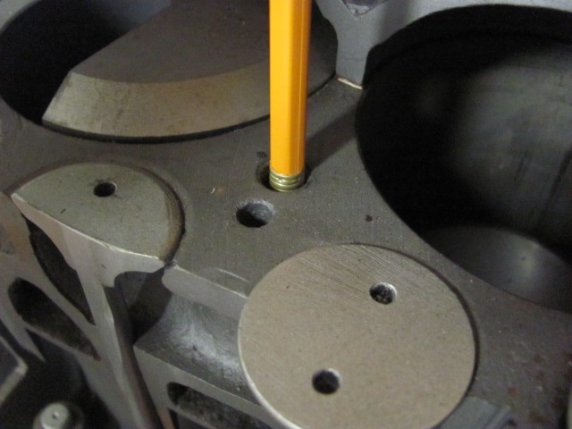

About normal. That is why good new bolts and holes carefully cleaned to full depth, with those block threads chased with a bottom tap, so threads are clean and sharp for best result.
Note the bolt in far right distance, the amount of threads still in the cylinder head, and only the end threads do the chore.
