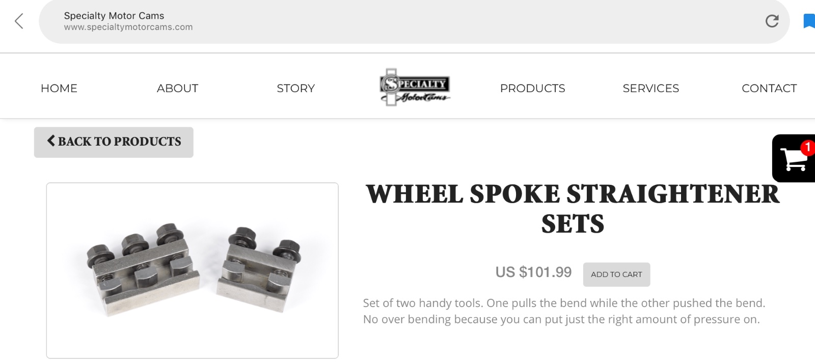

Have a set of these from Bill Stipe. Works so great on Model T wire spokes. Just tighten with wrench and the spoke is straight in a jiffy! High quality like his cams.
