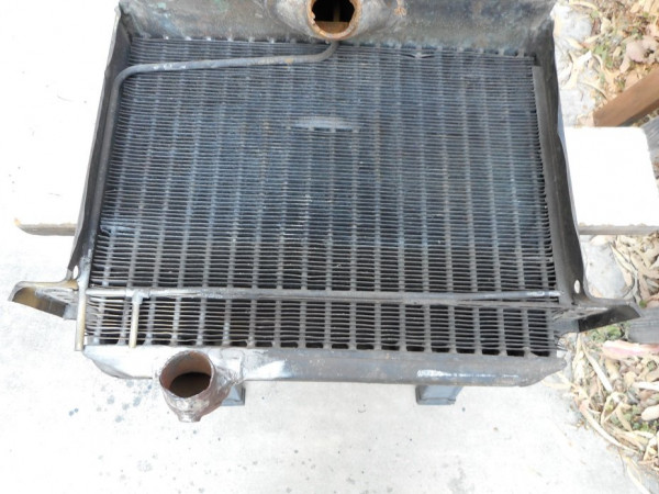

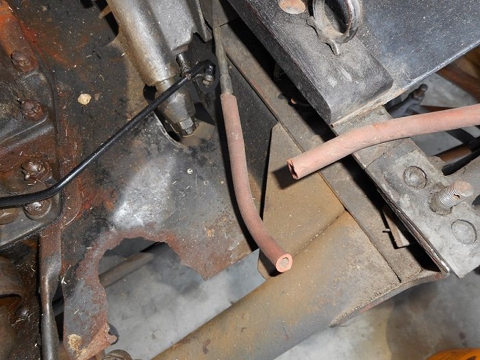

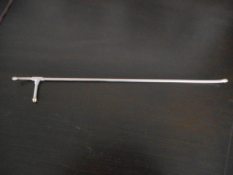

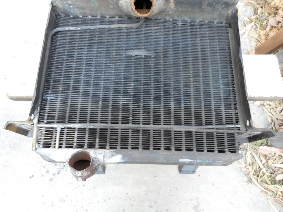

Here are some photos of the correct gas light tube on the radiator, and the frame tube at the front. Note, the frame tube is routed on the inside of the two steering column to frame bolts. This car still has the original red rubber hoses which are 7/16 diameter. The two tubes to the headlights are 10" long. The brass tubing is double flared on the ends. Believe me I've researched this stuff, and the work I did last year for my '13s turned out to be correct. The pictures posted here are on an unrestored 1914.
