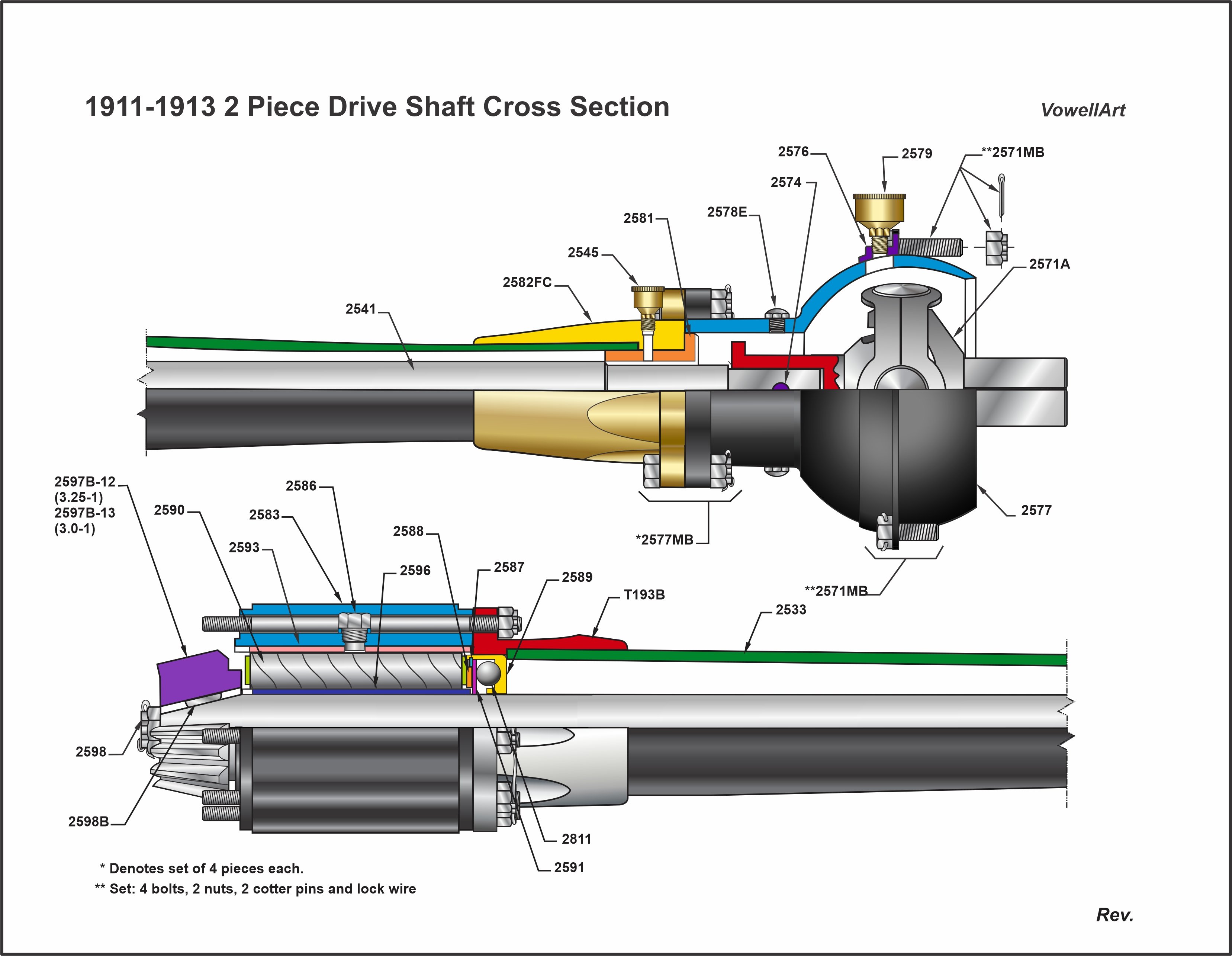

Post by VowellArt » Mon Sep 28, 2020 9:53 pm
Ok, NOW is when that hardened sleeve 2596 replaces the hardened step in the driveshaft. This sleeve design continues through 1927.

Re: ***1911-1913 2 Piece Driveshaft Cross Section***
Post by VowellArt » Wed Sep 30, 2020 5:45 pm
Larry, probably so, but I'm rather limited upon what I can use for that research, even so, my work is basically given as "in progress" state. Meaning I will continually change them until I either stumble upon (whether by design or accidentally) the correct representation, so any help anybody can give me is greatly appreciated. ;)

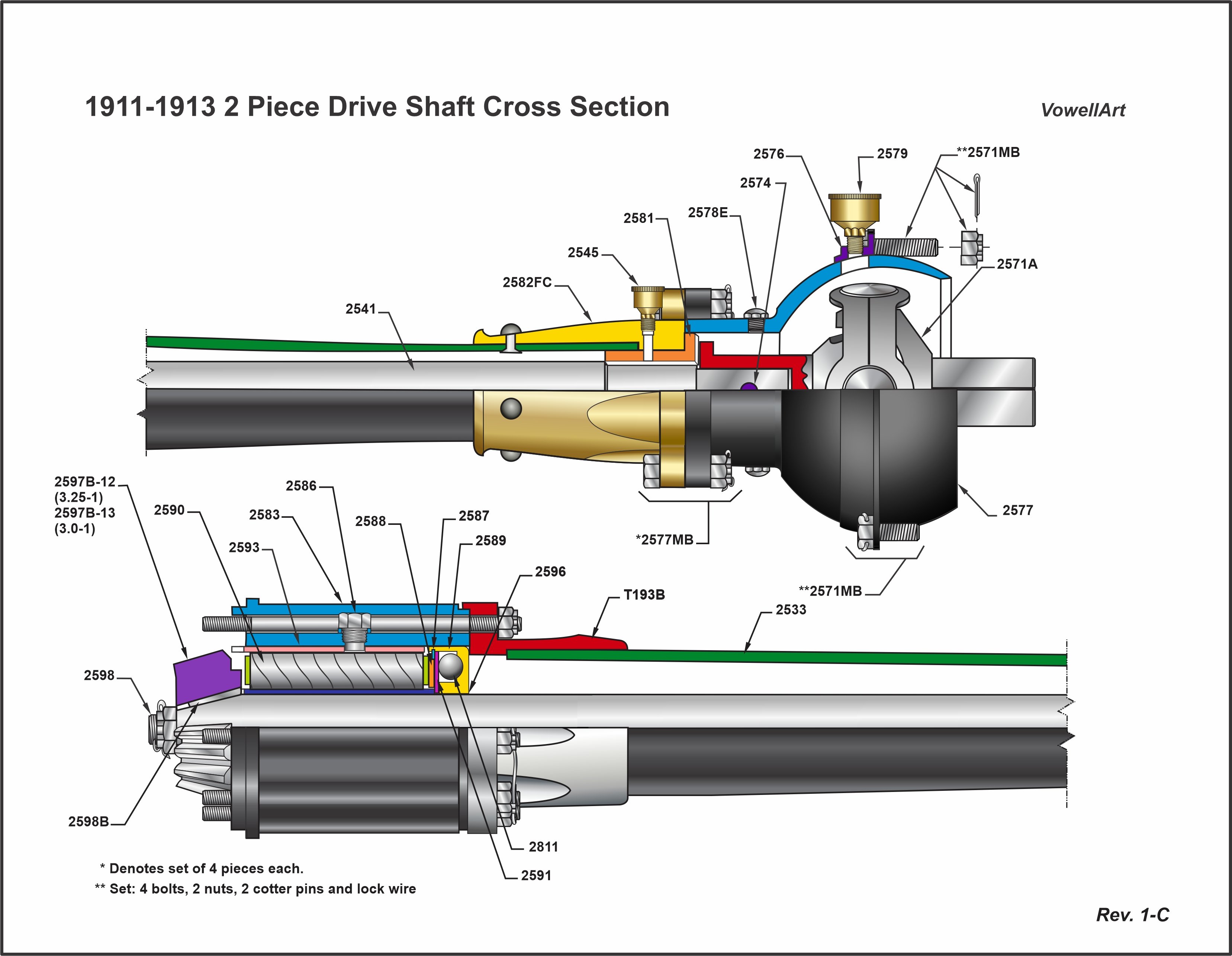

Post by VowellArt » Wed Oct 07, 2020 10:17 am
Slight Change to spool and thrust bearing and bushing sleeve.
Post by VowellArt » Fri Oct 09, 2020 6:38 am
Slight reconfiguration of the ball.
