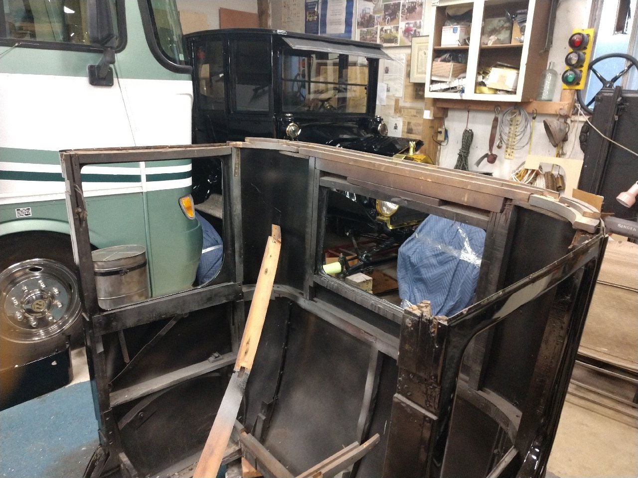

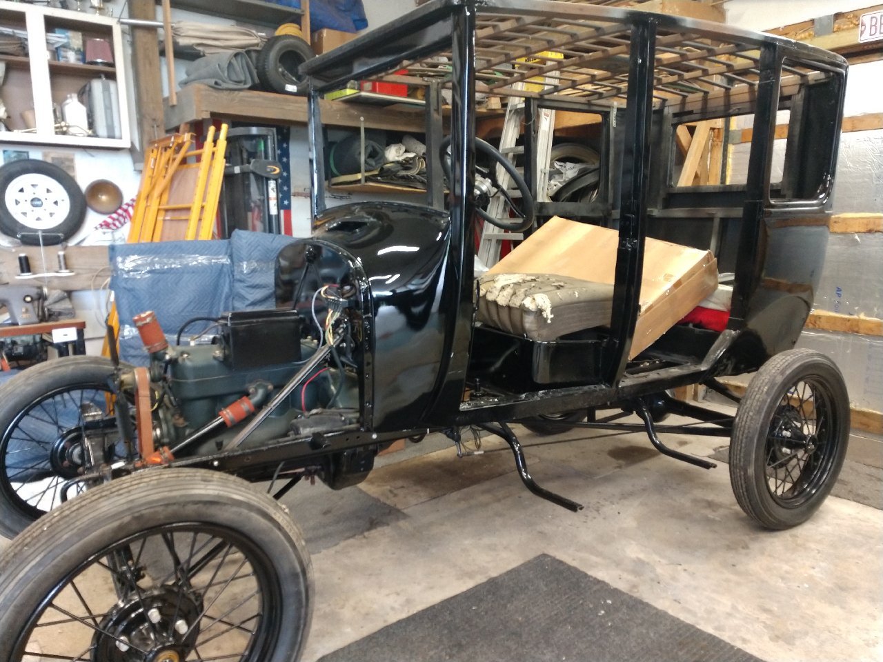

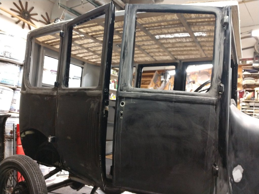

Well lookie what showed up at my door today. All the way from Syracuse NY. It should be a fun winter project. The car hasn't been touched in 40 years. She's going to running the roads once again....in the spring...sometime.. I hope. :D :D

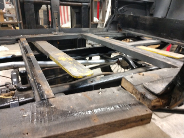

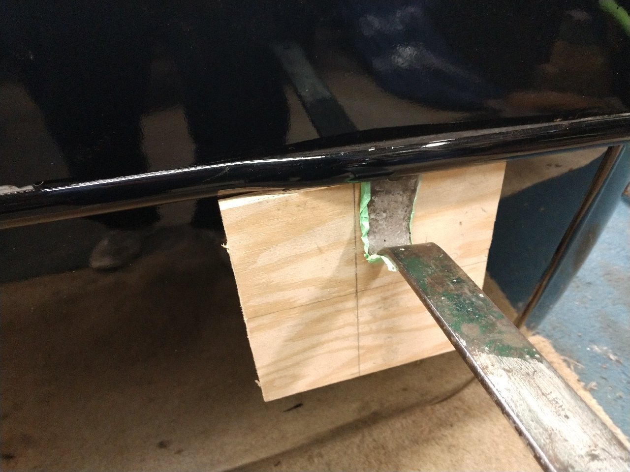

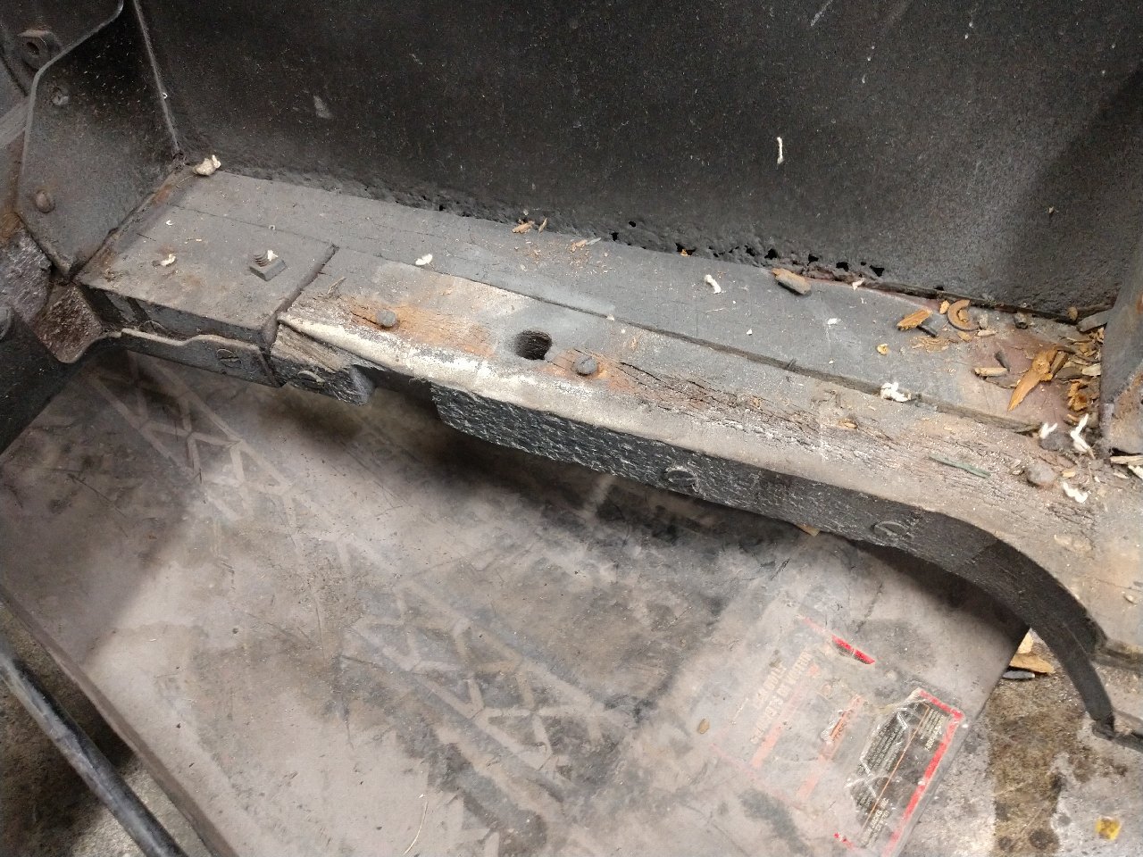

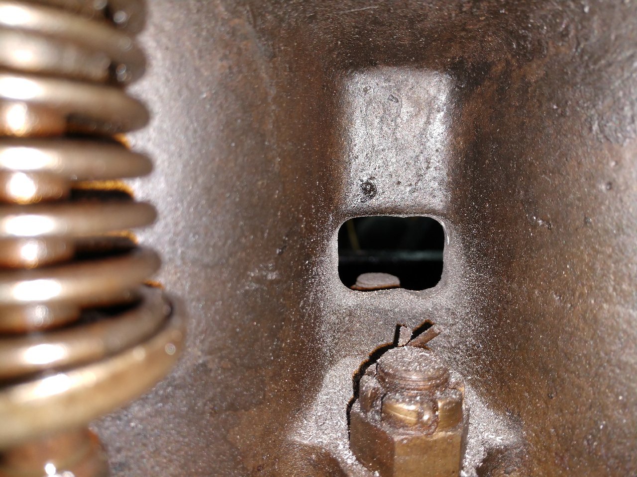

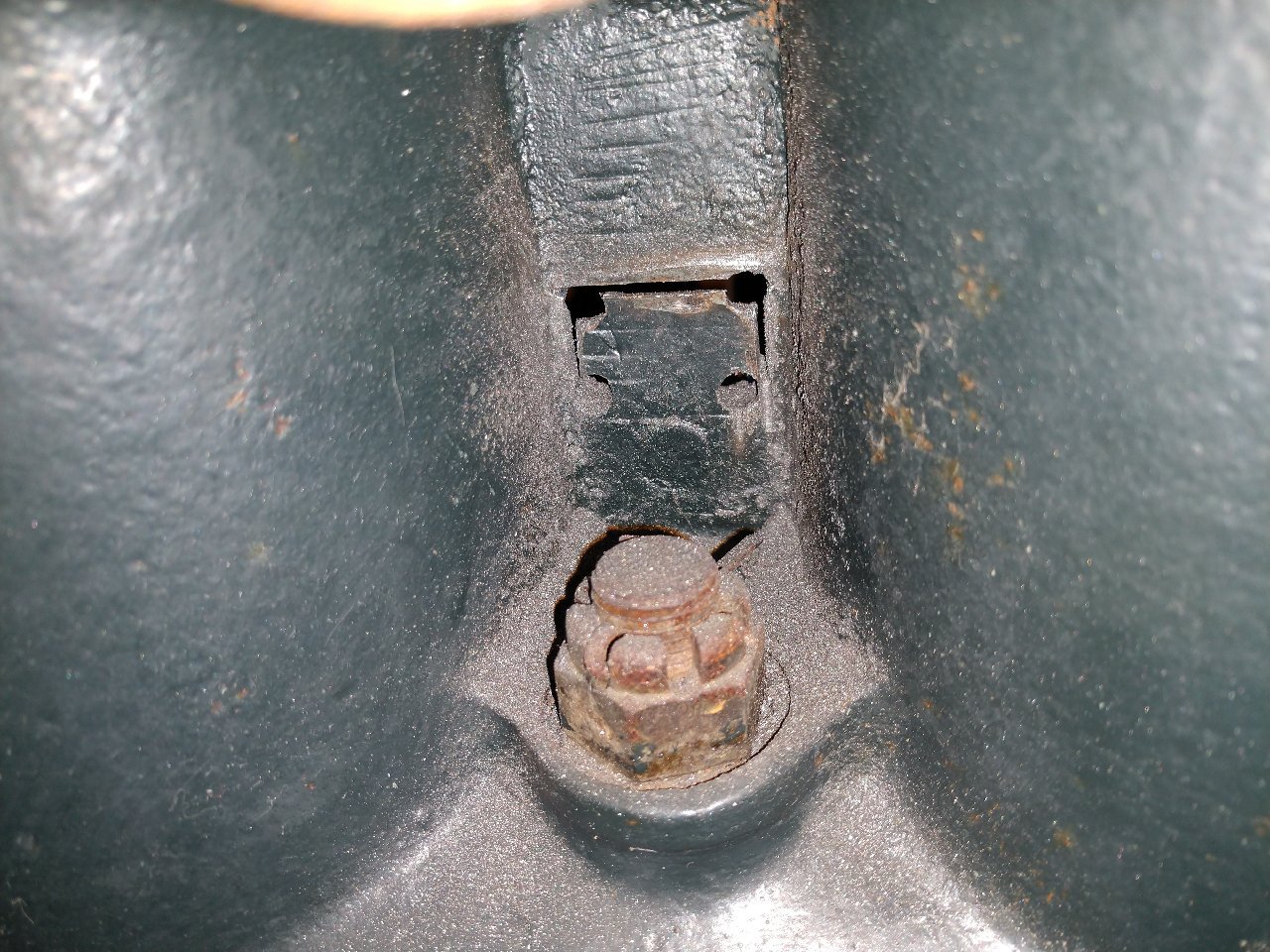

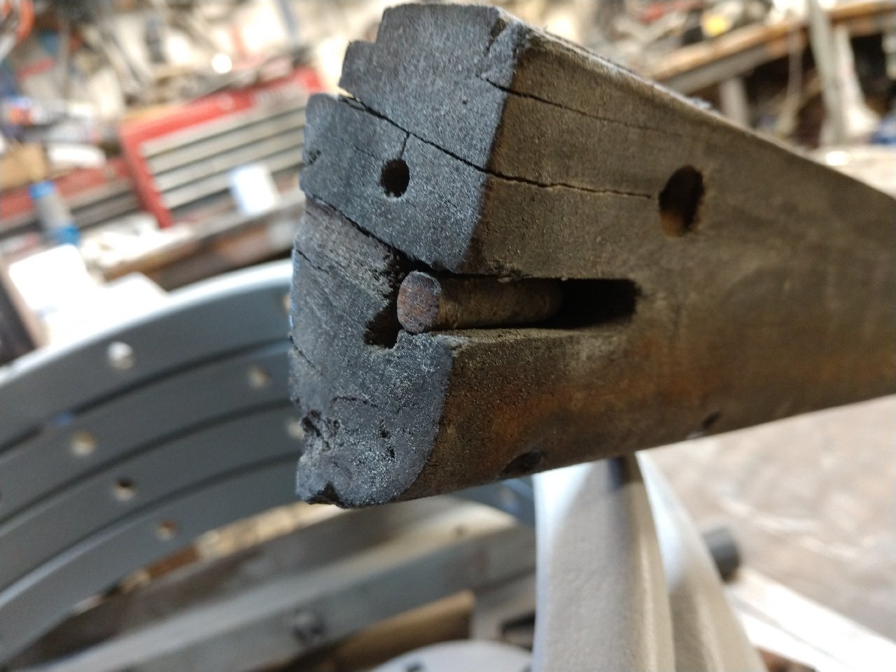

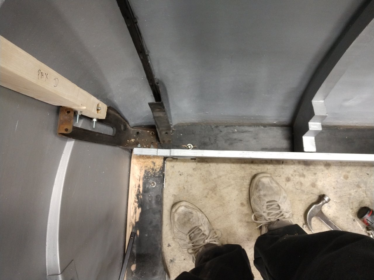

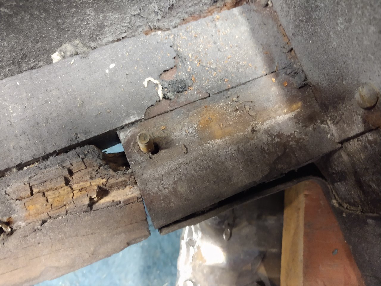

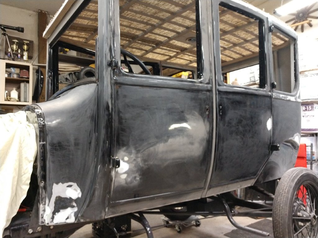

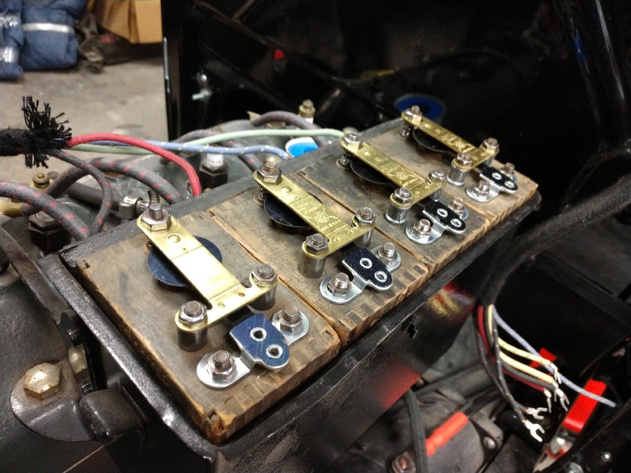

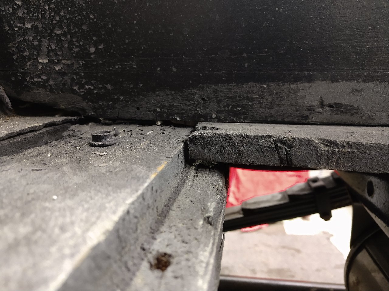

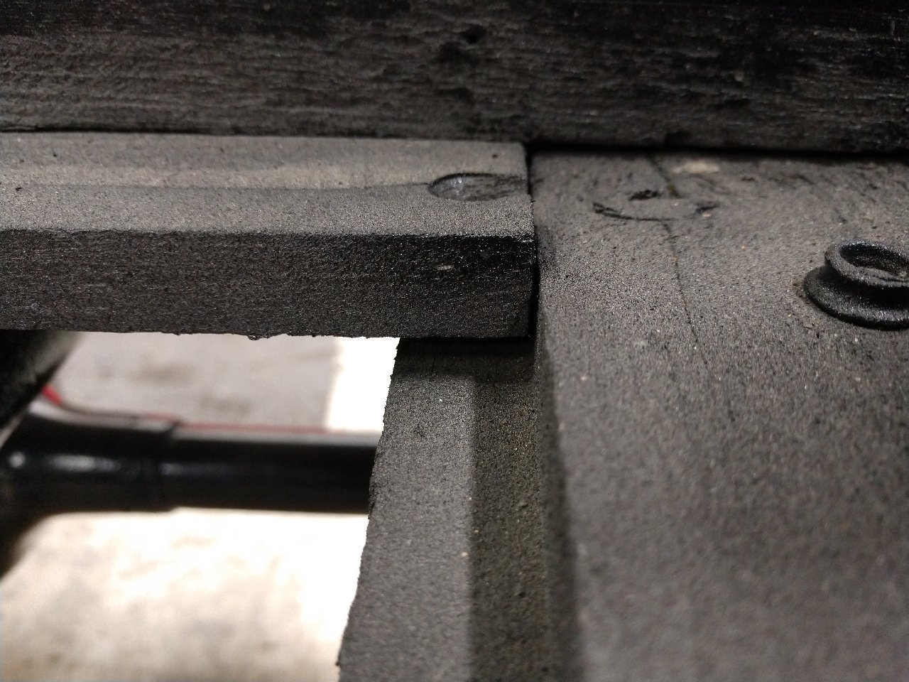

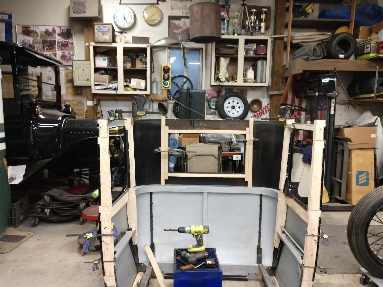

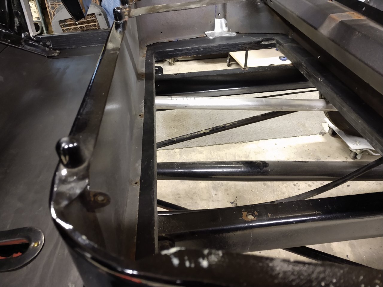

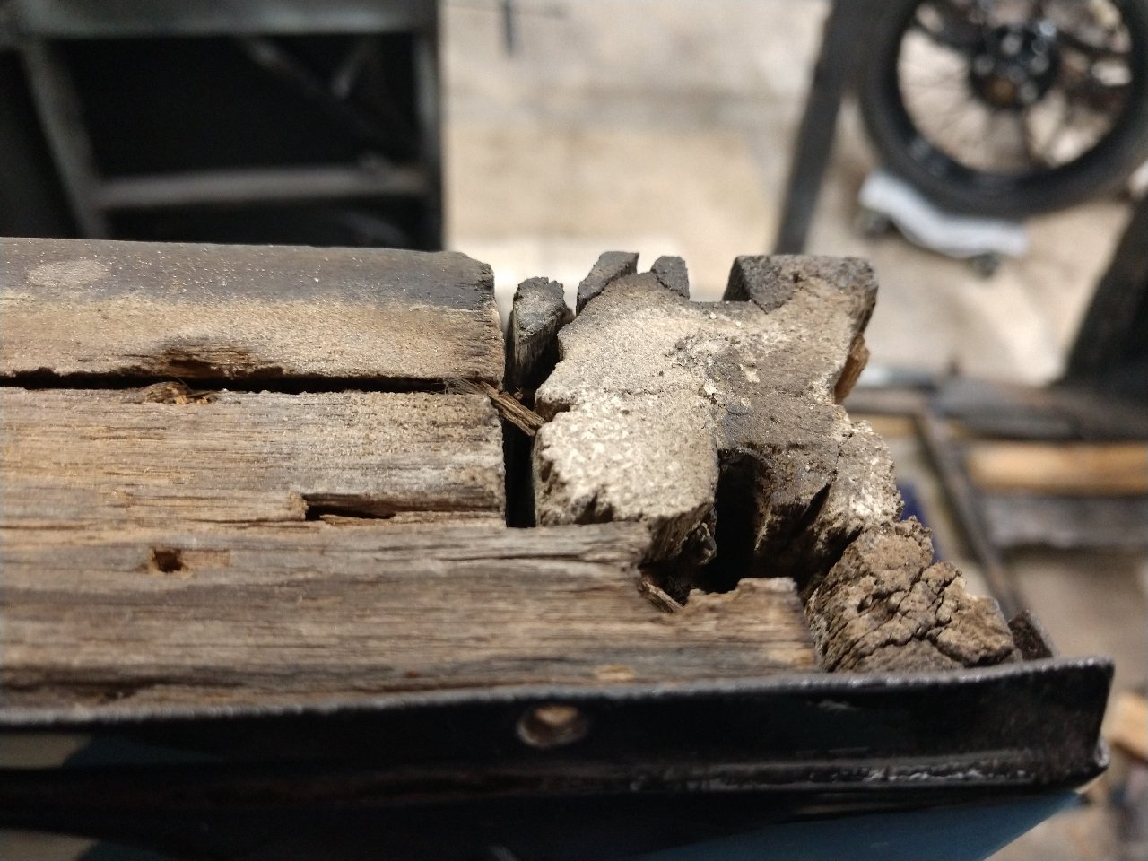

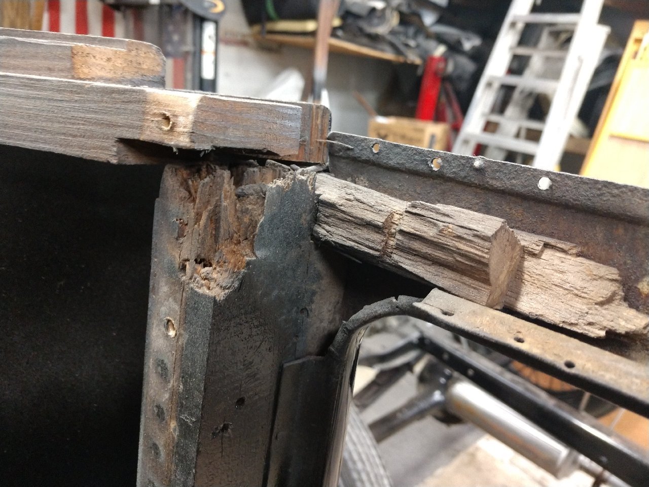

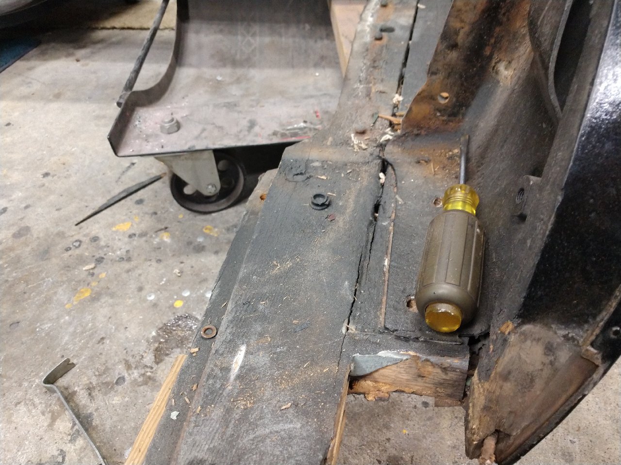

I've mentioned on prior posts about the main-rail crossmember tenon wear. Here is a perfect example of just that. The main-rail outer edge has settled more than a 1/4" on both sides of the car. This may seem minuscule but when the time comes for the final fitting and door operation it can make for a frustrating reward for a heck of alot of work.

Post by FordorGalore » Sat Oct 03, 2020 9:03 am

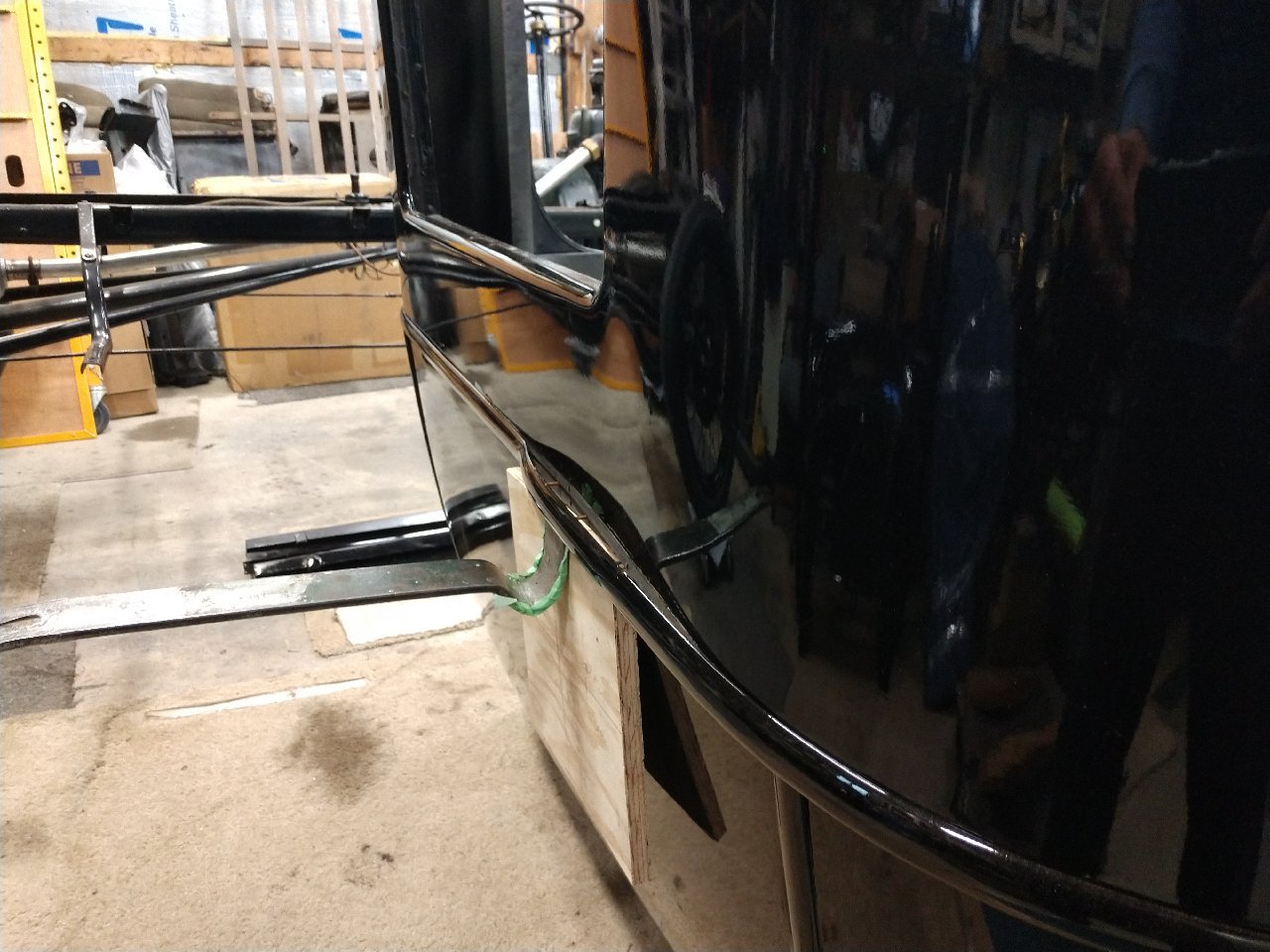

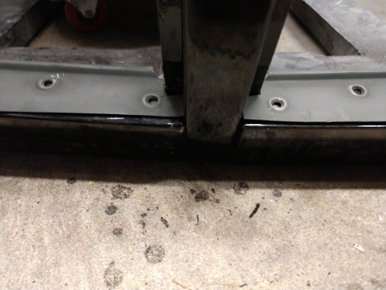

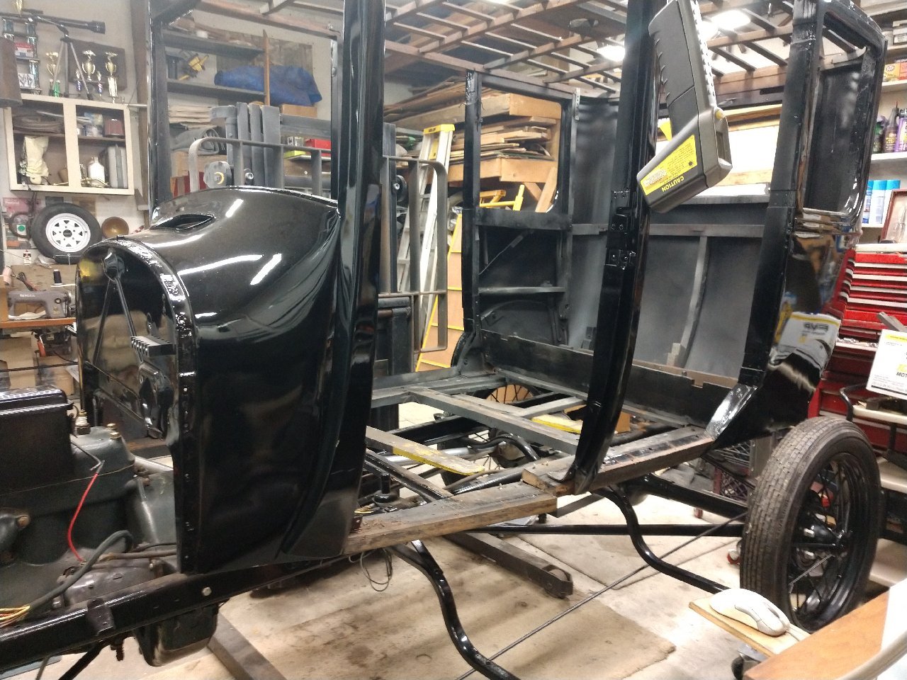

Still having fun discovering this and that.

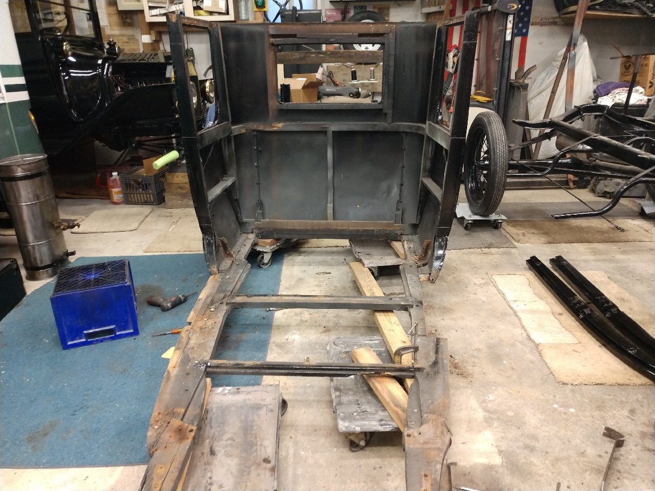

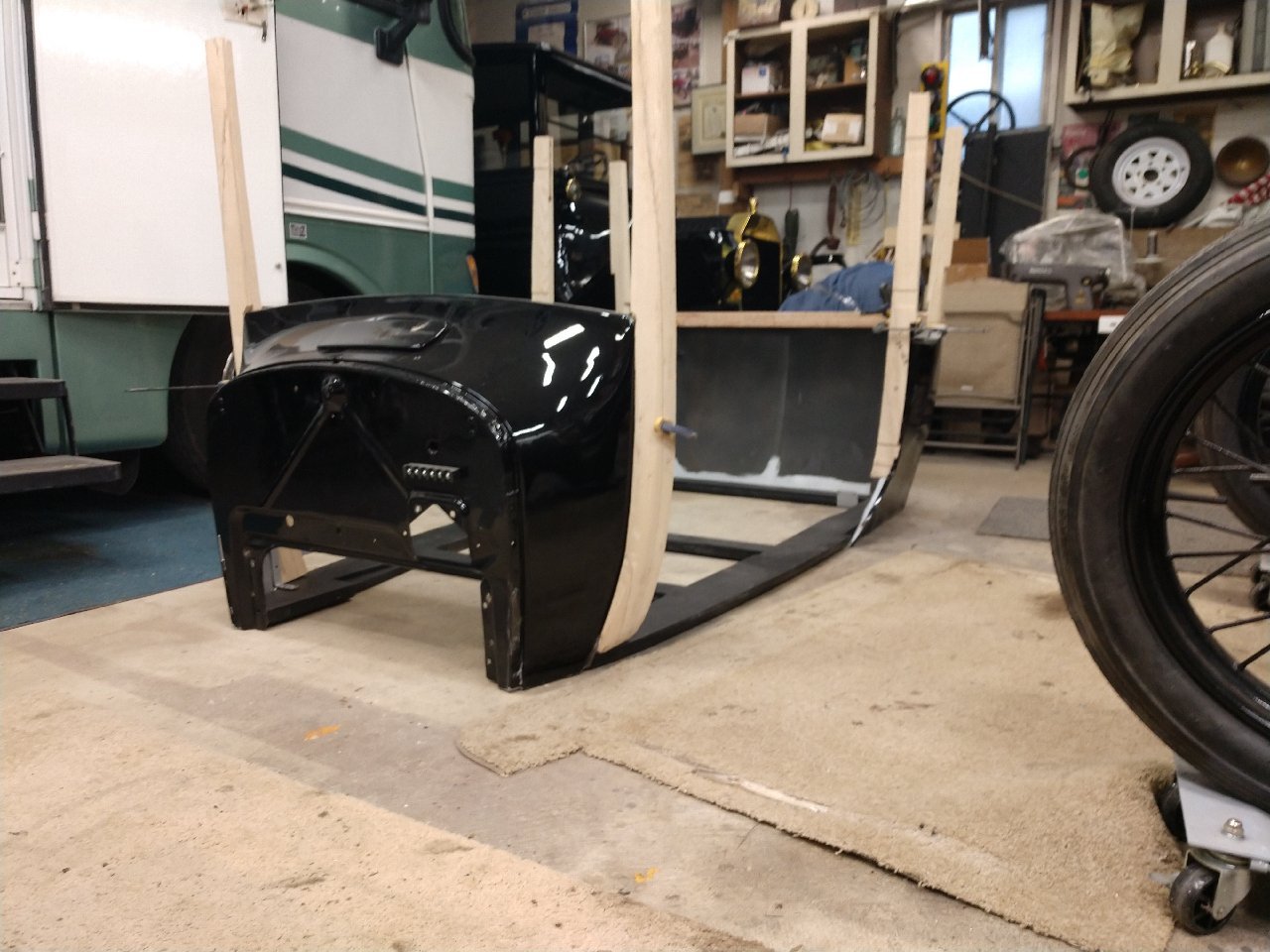

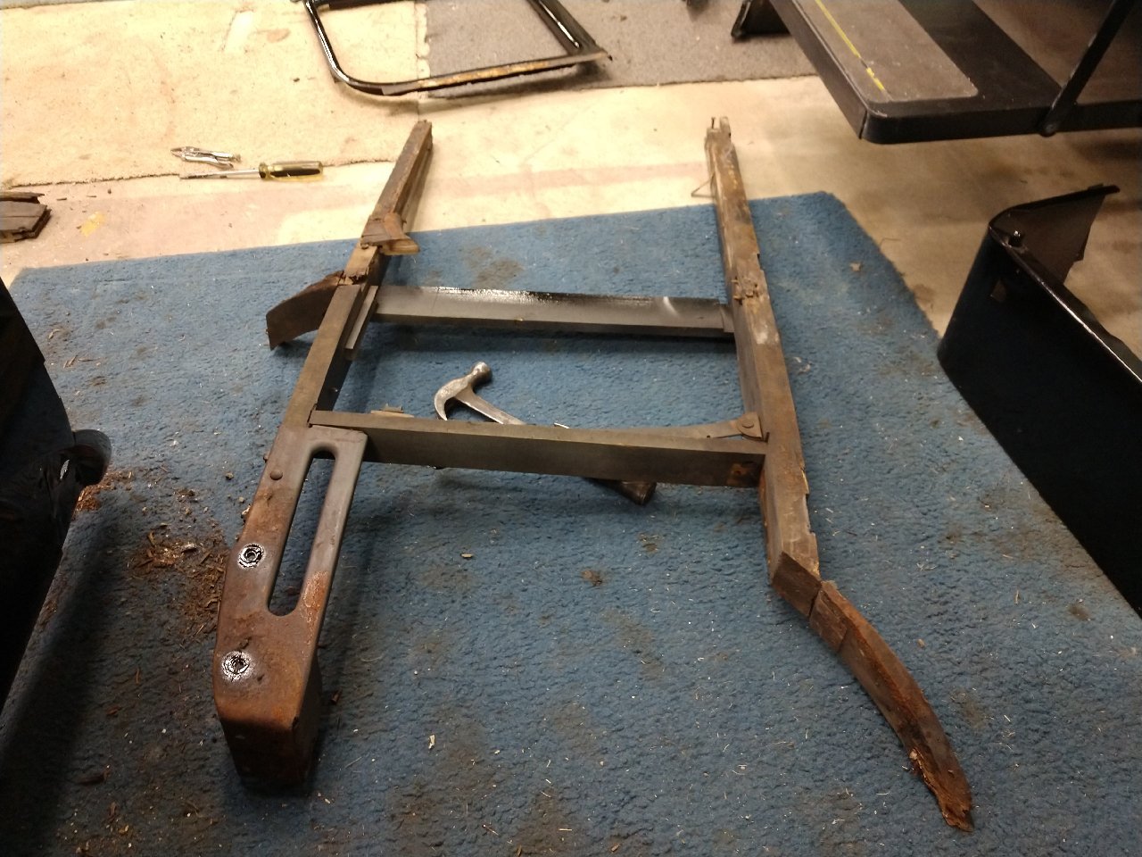

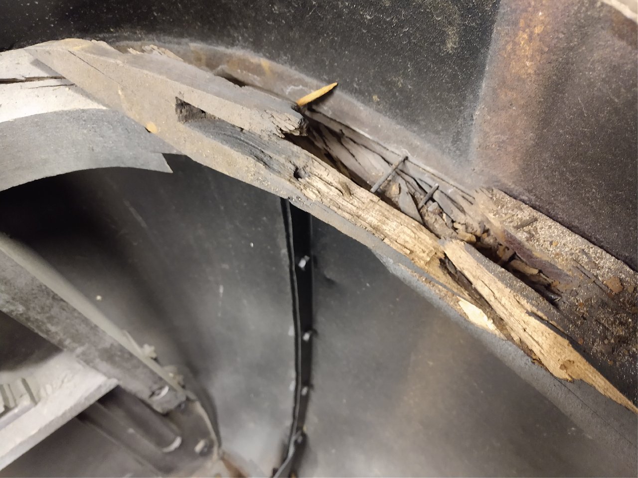

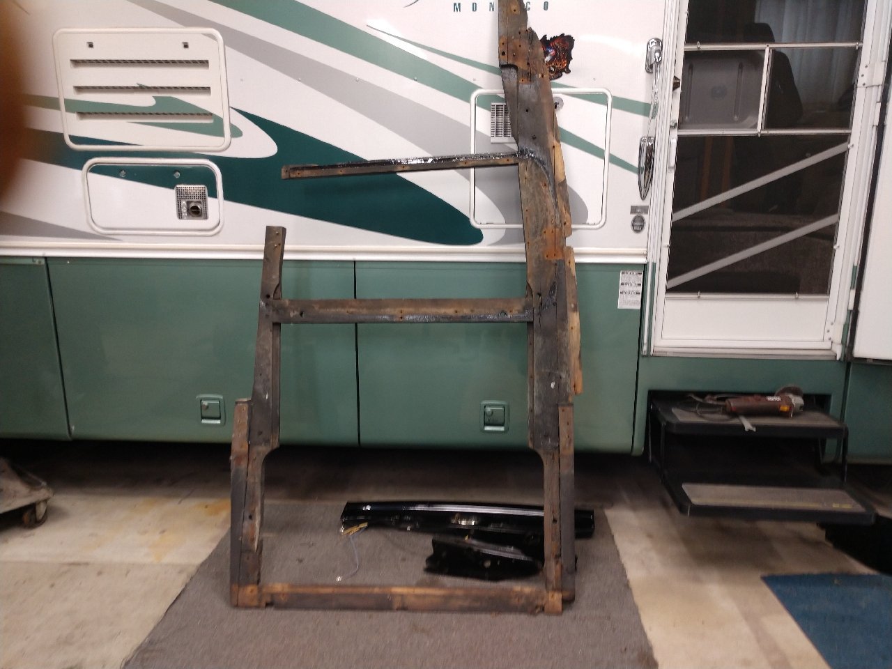

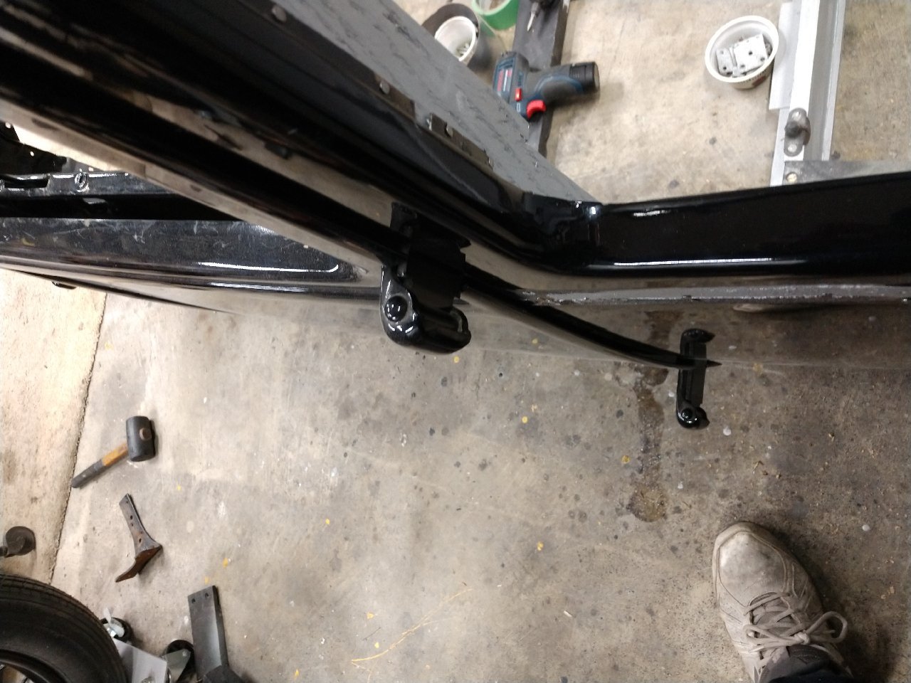

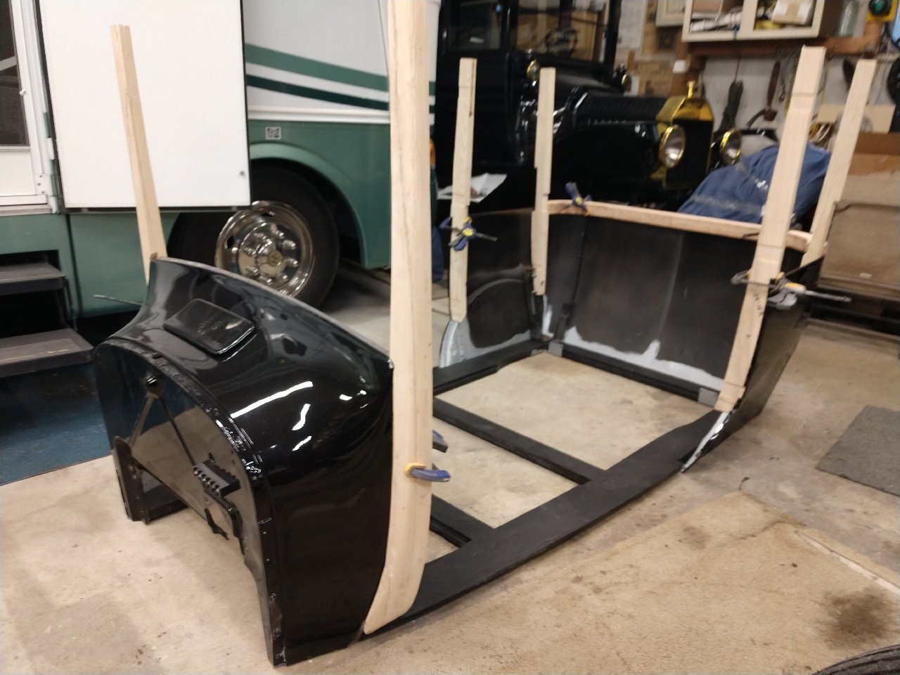

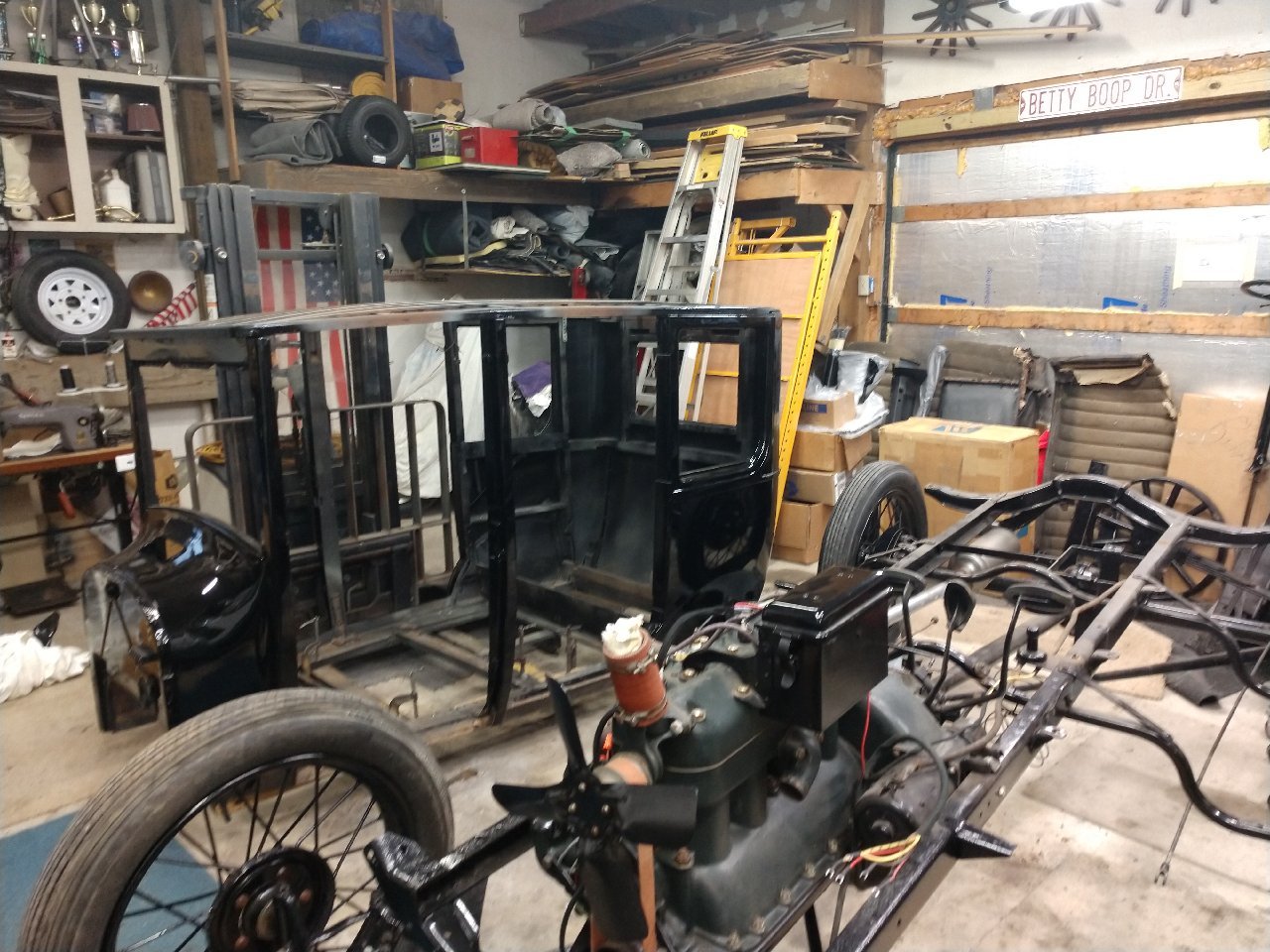

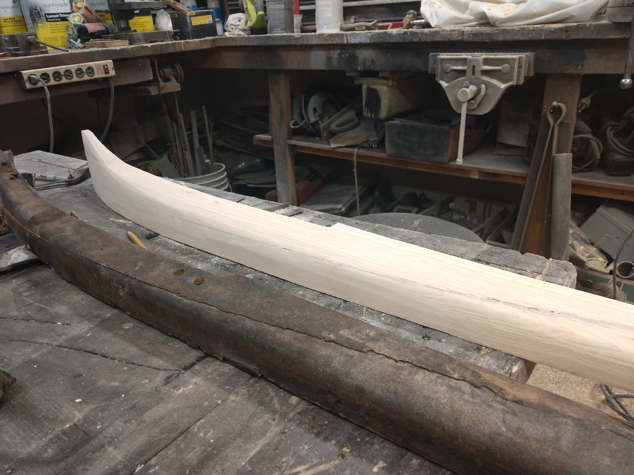

Yup, its time for a whole new base frame. Sometimes life gives you no choice, not unlike the doc ordering up a coloscopy....Thanks DOC !! (1927 Model T Fordor).

Day two....poo poo pee doo..

Finding lots to do... That's a good thing.

And the beat goes on.....

Don,

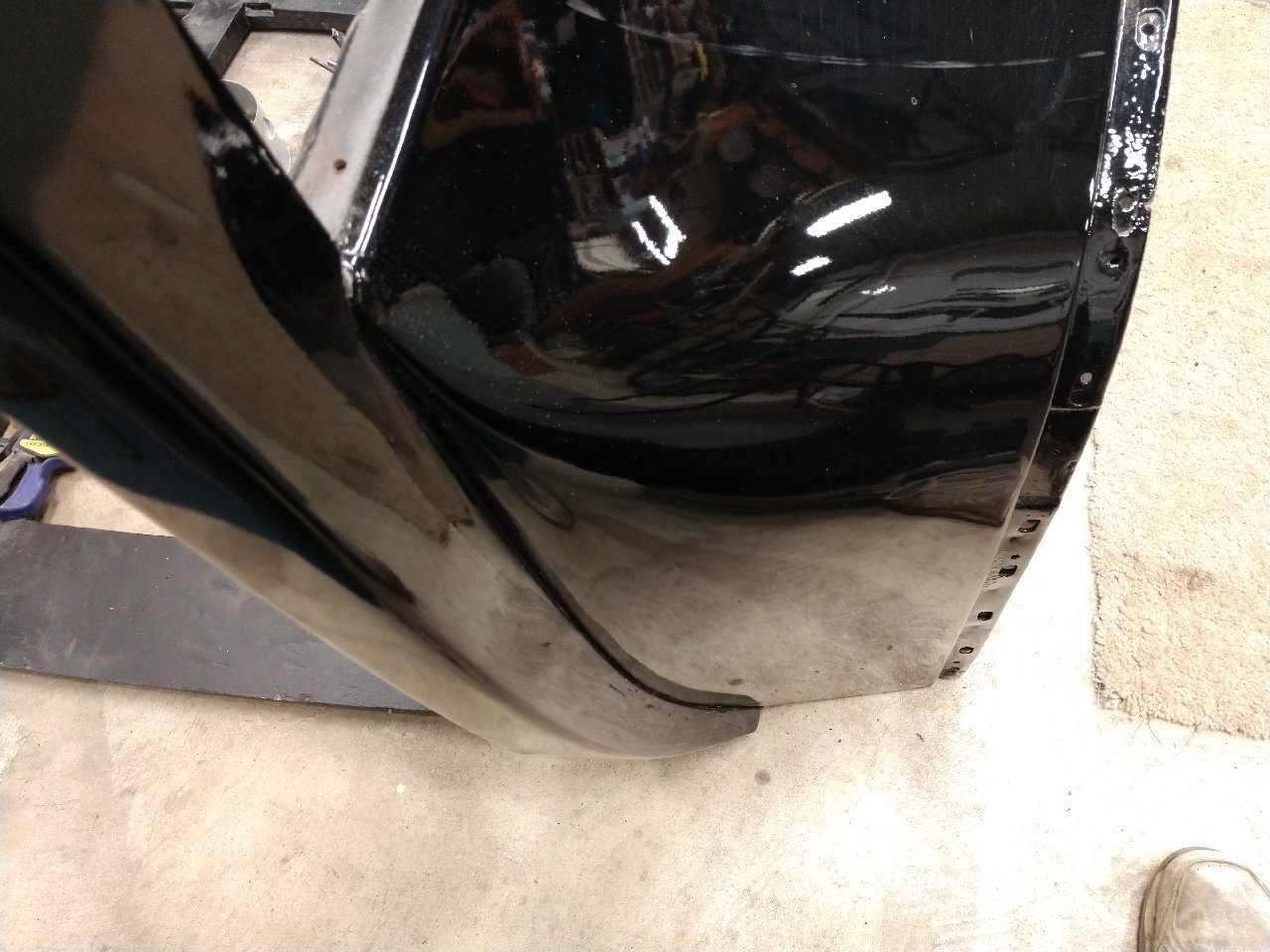

This is a good thread that shows just because the paint looks good doesn't mean the car is OK. These old cars need to be inspected down to the wood core to be sure that they are safe. Thanks for sharing and showing us what can be hidden underneath shiny metal.

You ain't wrong Dennis, but I have to give the priors credit that they truly deserve. That patch of wood or that gob of bondo may not be a good or safe way to do it but, it did help keep the car around for 93 birthdays. If the car could talk the story may justify the why's. 93 years later the car is still here....93.

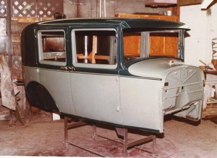

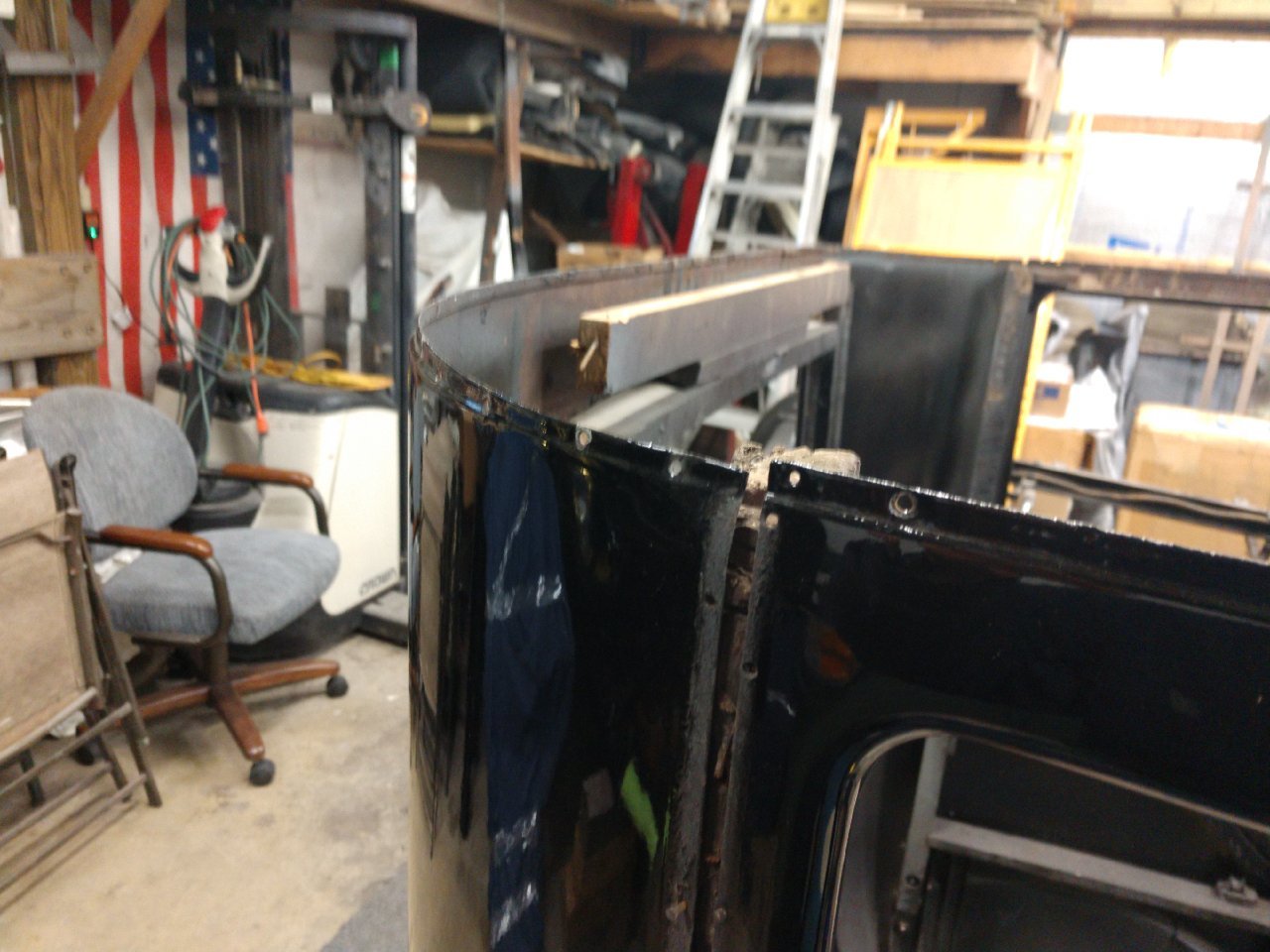

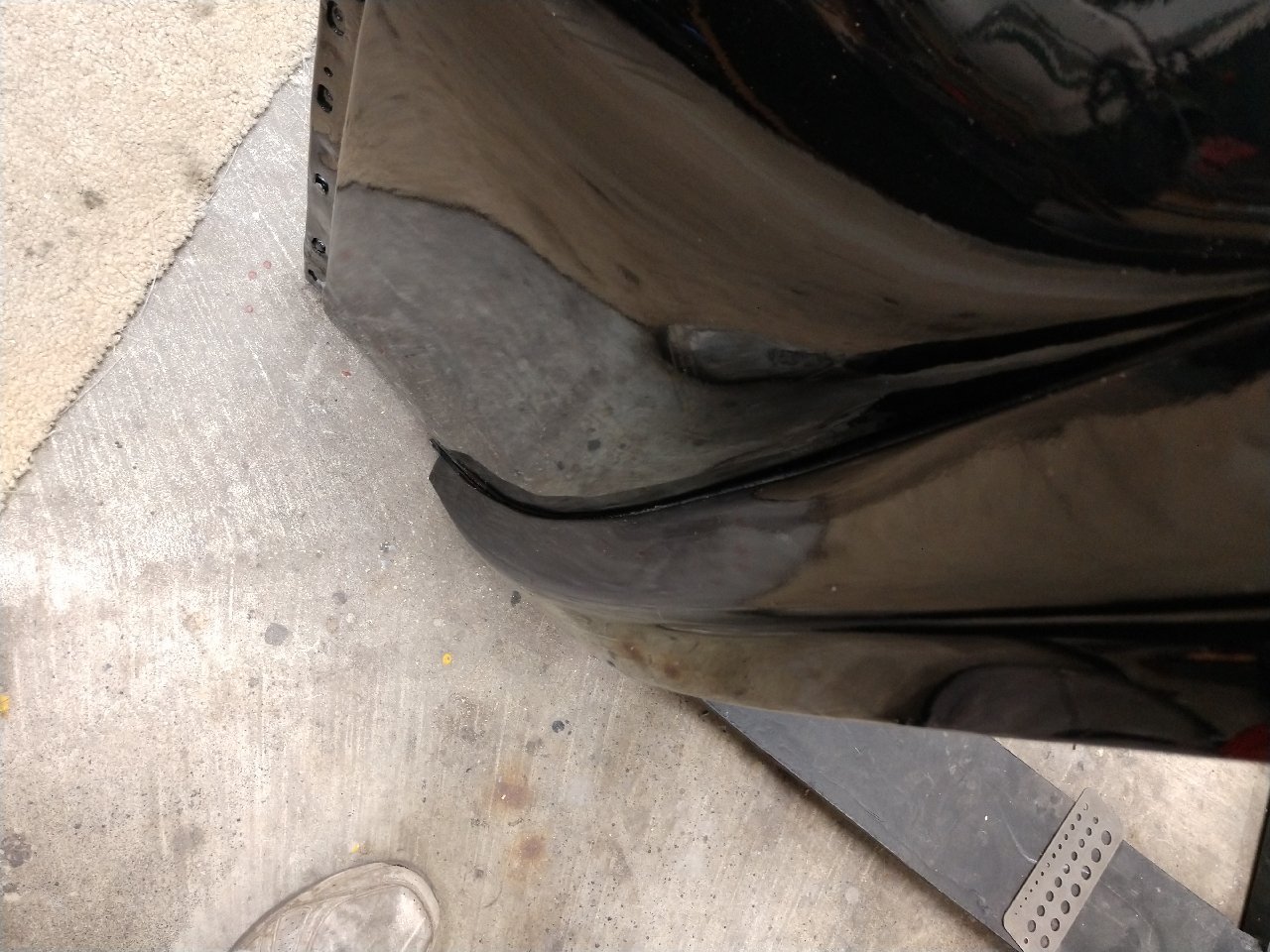

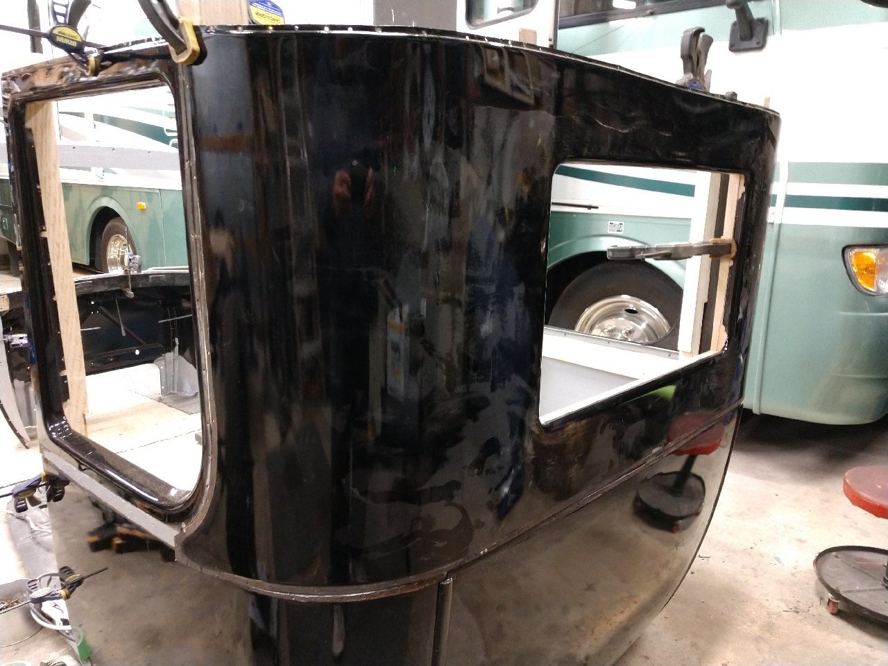

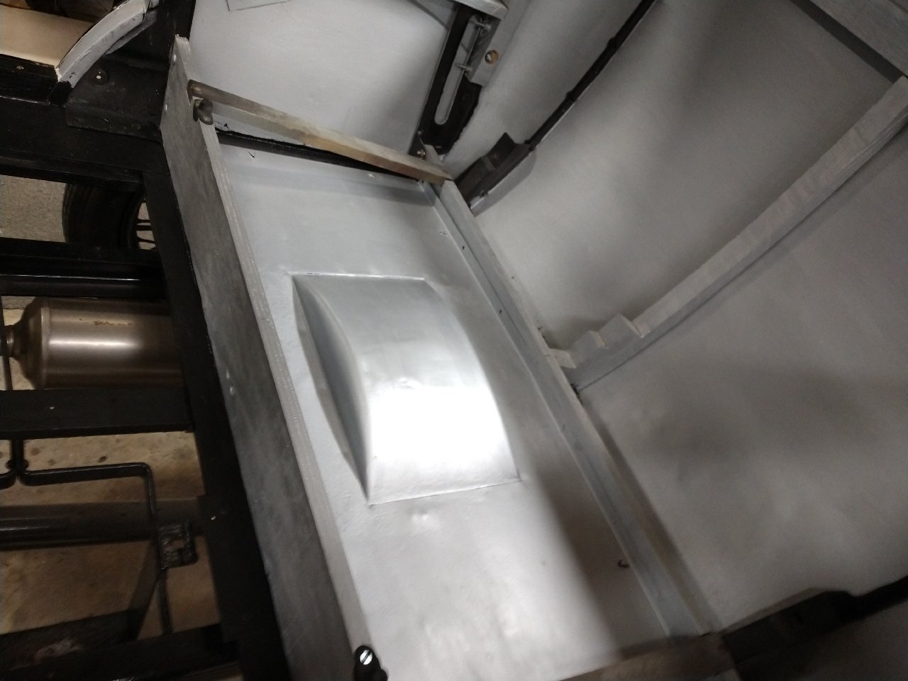

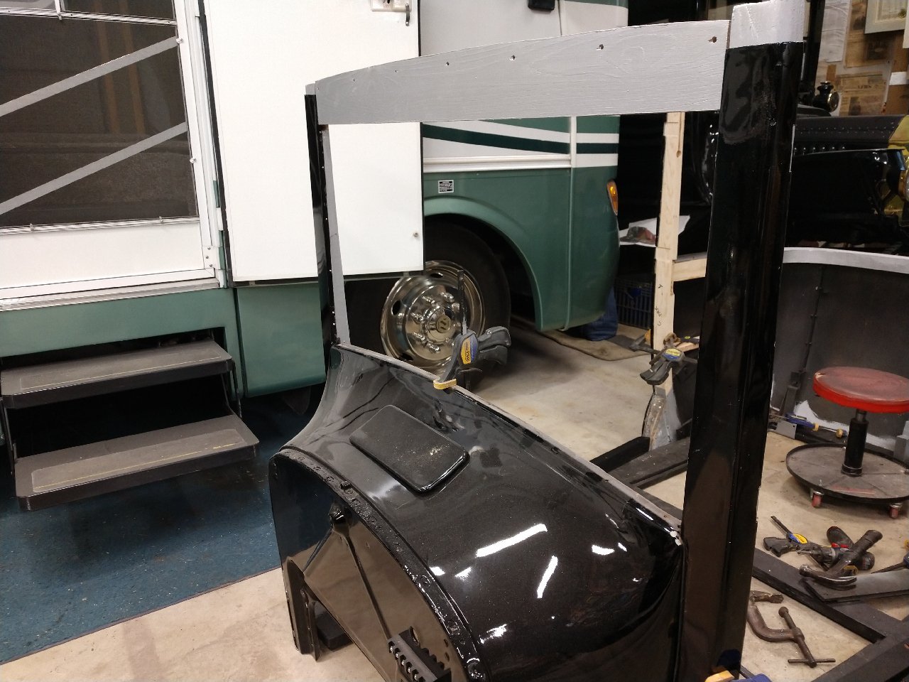

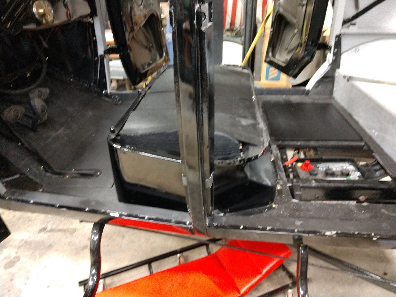

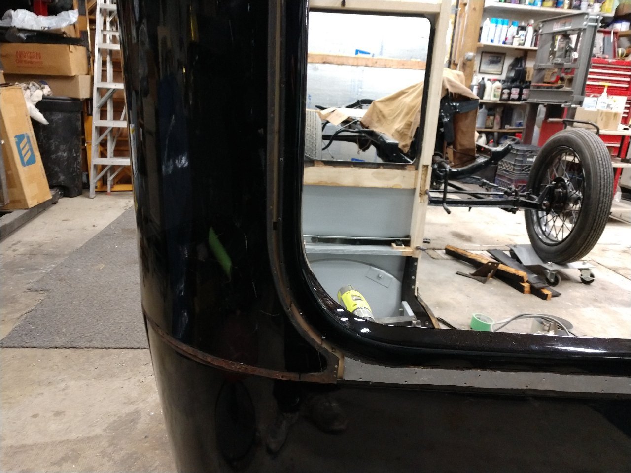

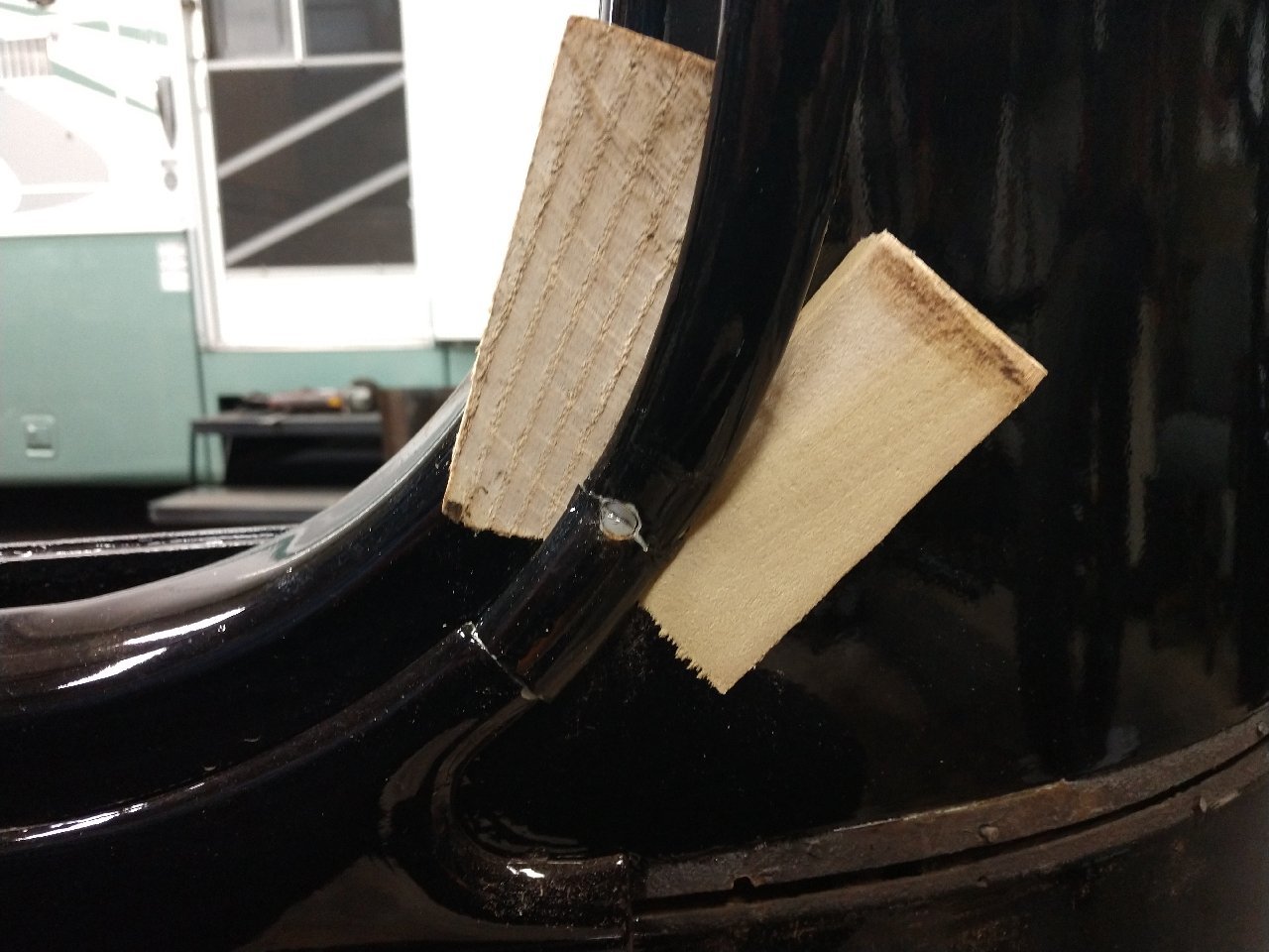

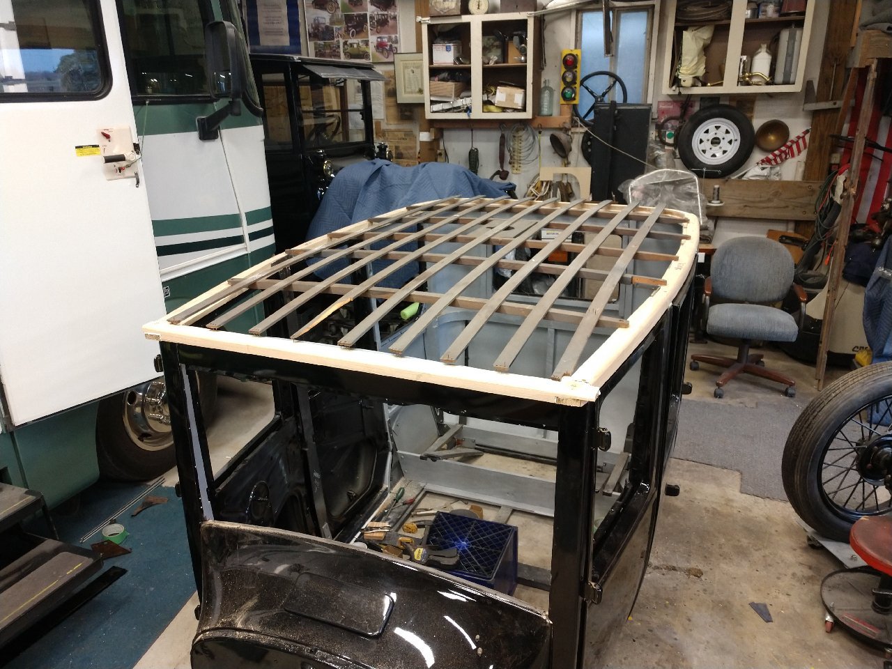

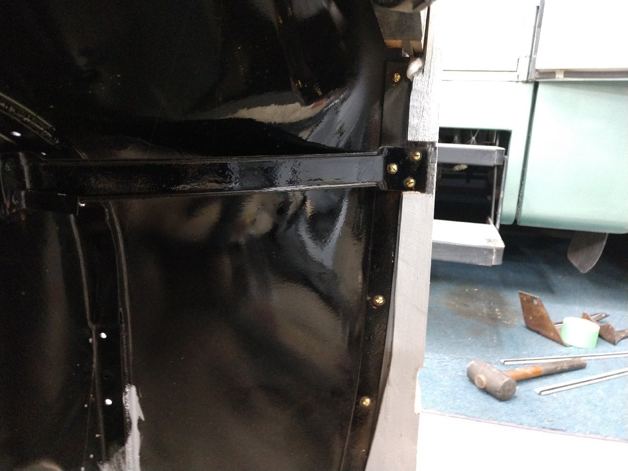

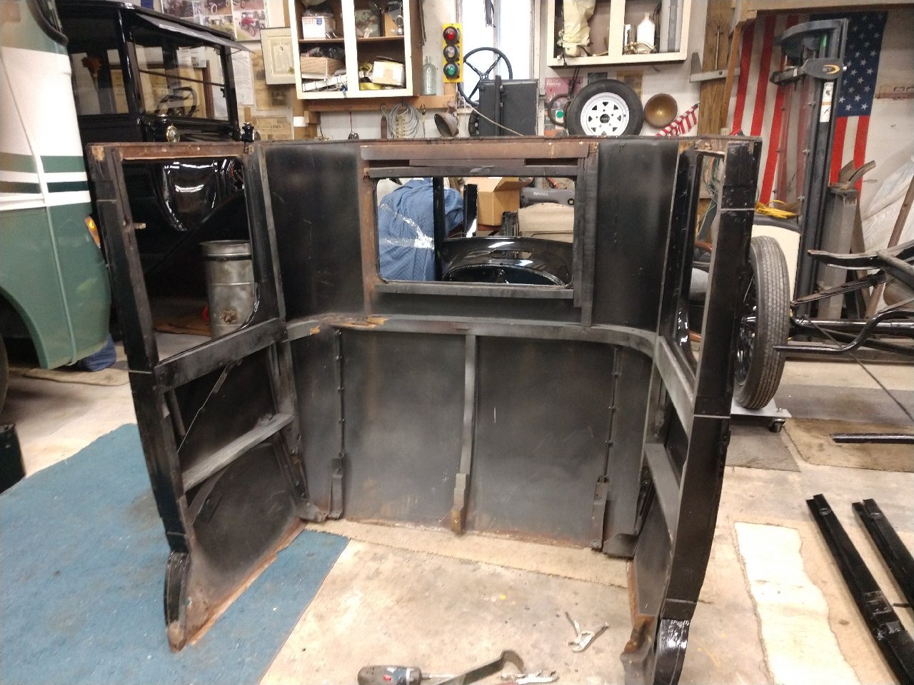

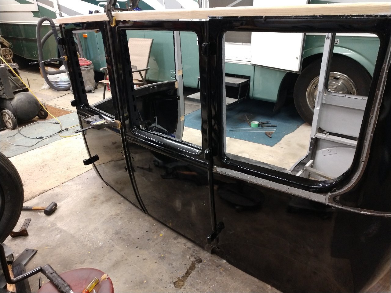

I gotta tell ya having the final finish paint on this project while you're ripping it apart......adds a unique challenge to the funky deal. ;)

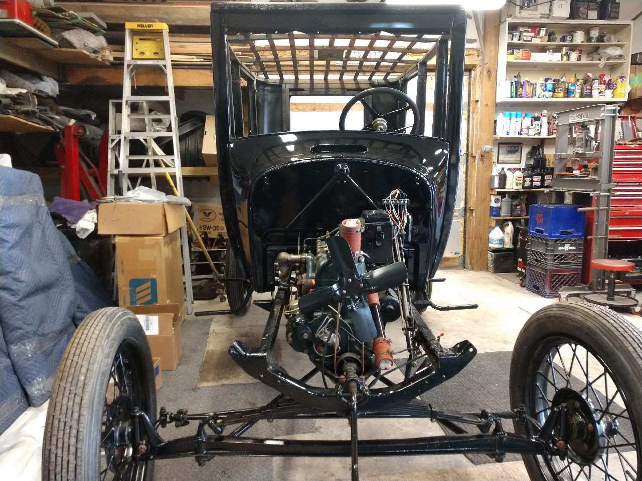

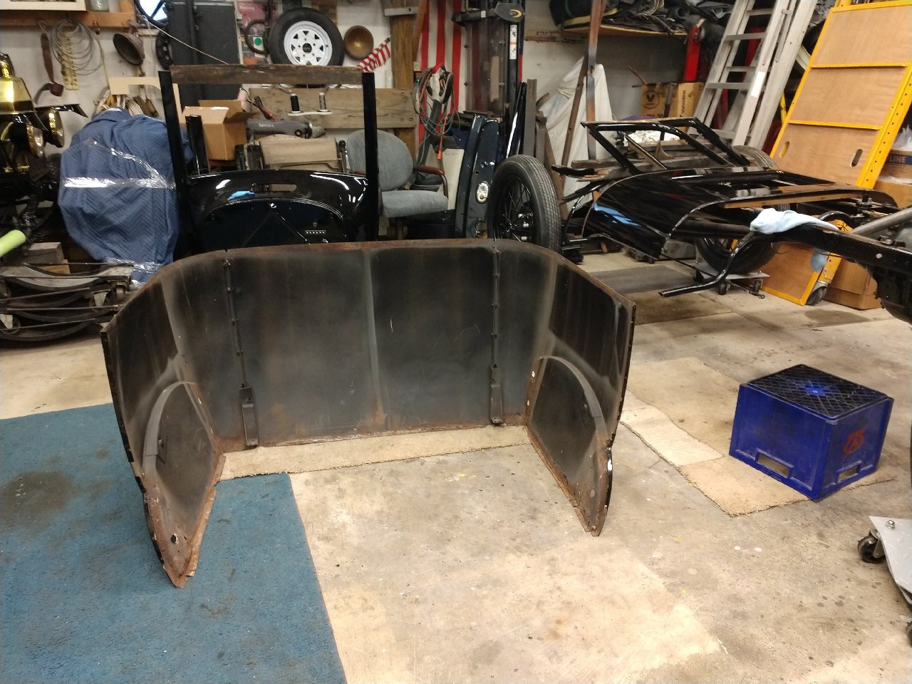

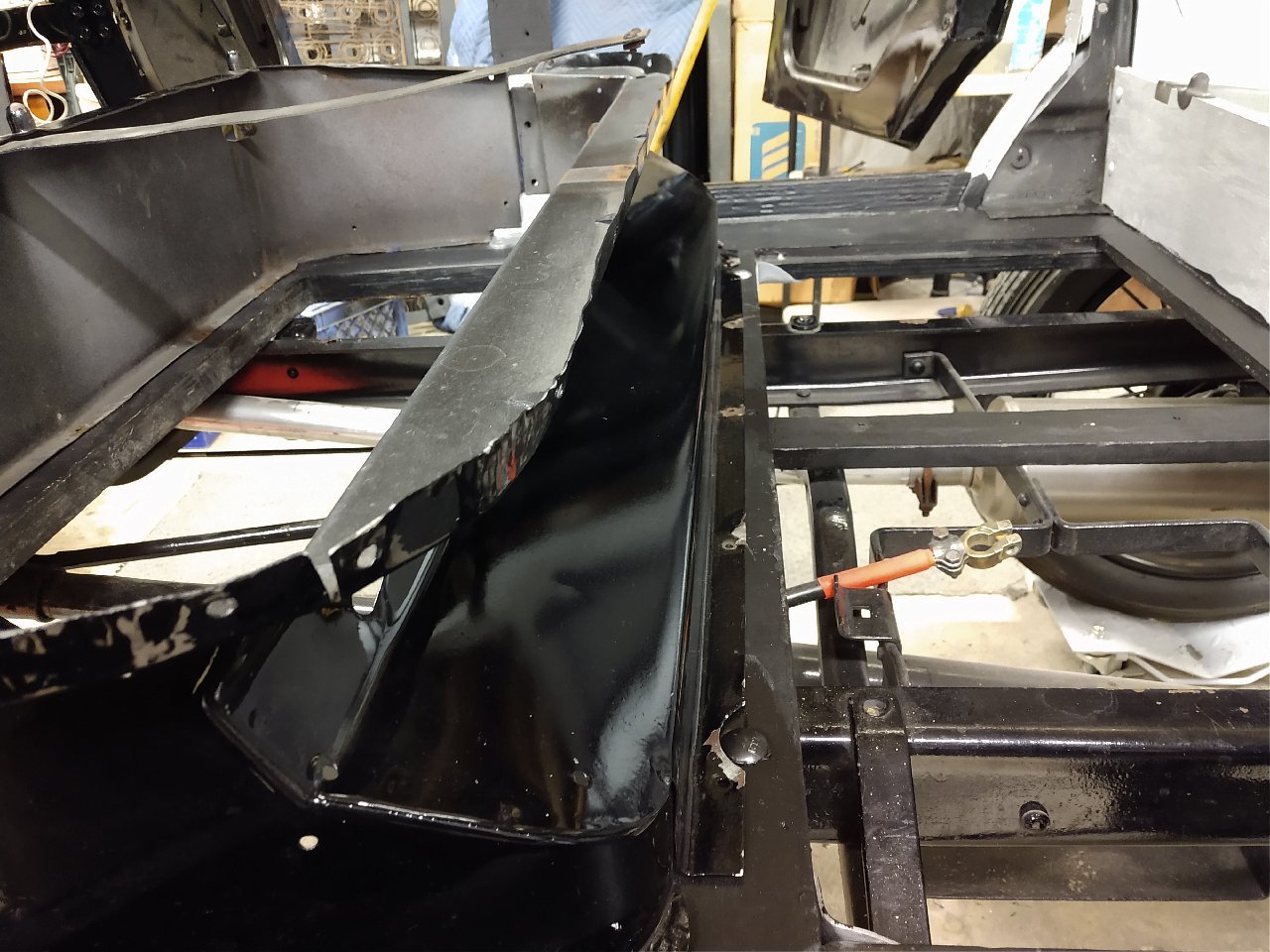

a few more pics..

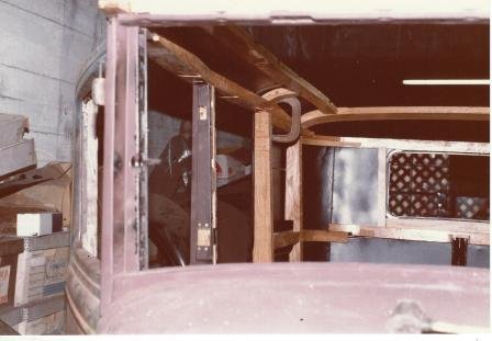

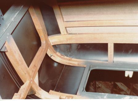

I find it interesting what has become of my simple half-joking post on this forum. I was fascinated with the pictures you posted of your Retirement Project Fordor, and asked when I could drop mine off. How many T's have passed through your barn doors since then? A dozen? You'd think that you would stop posting pictures. ;) You keep getting yourself into trouble!

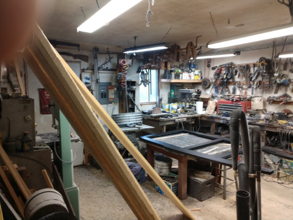

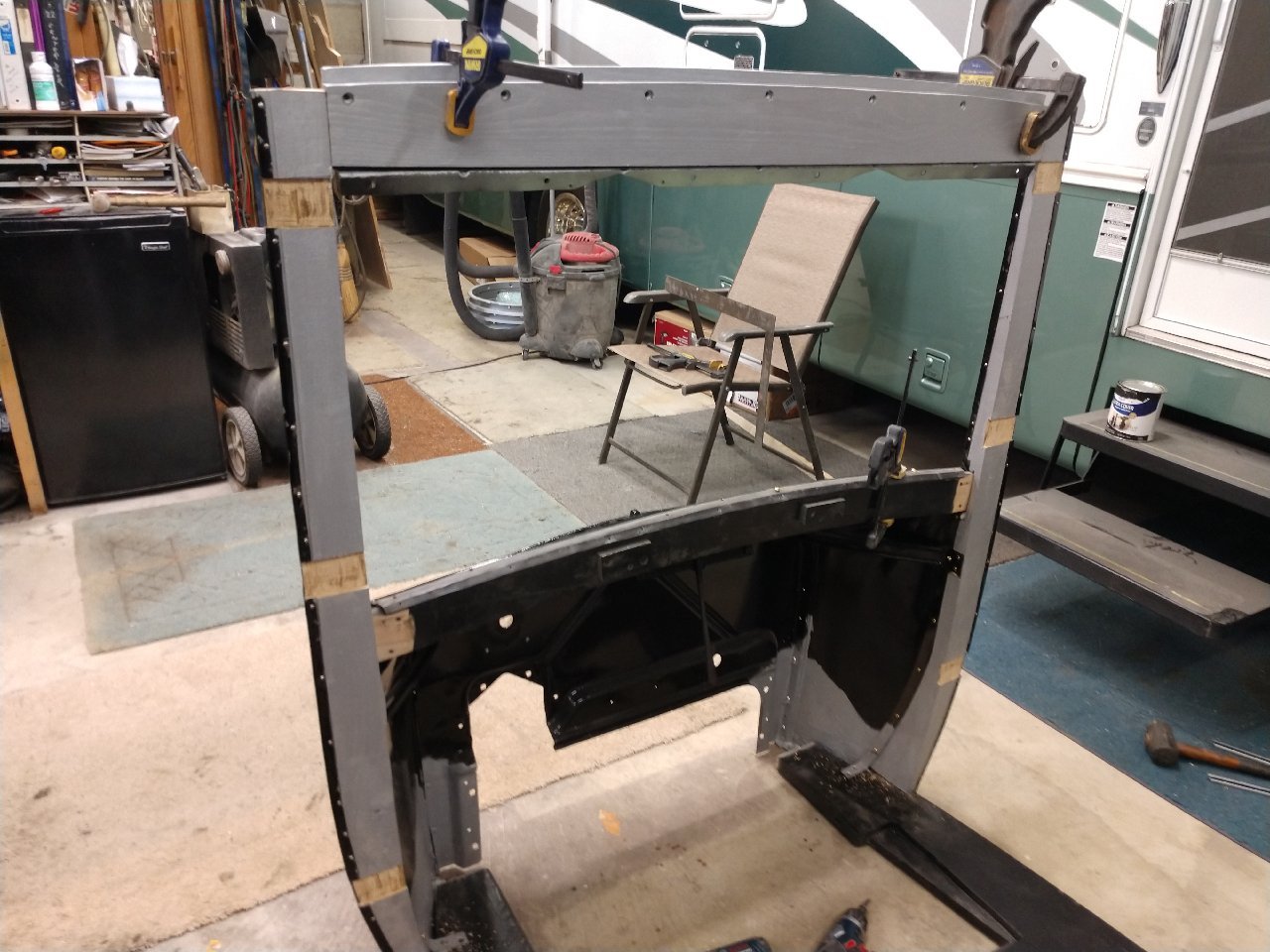

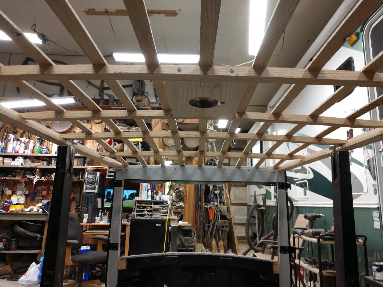

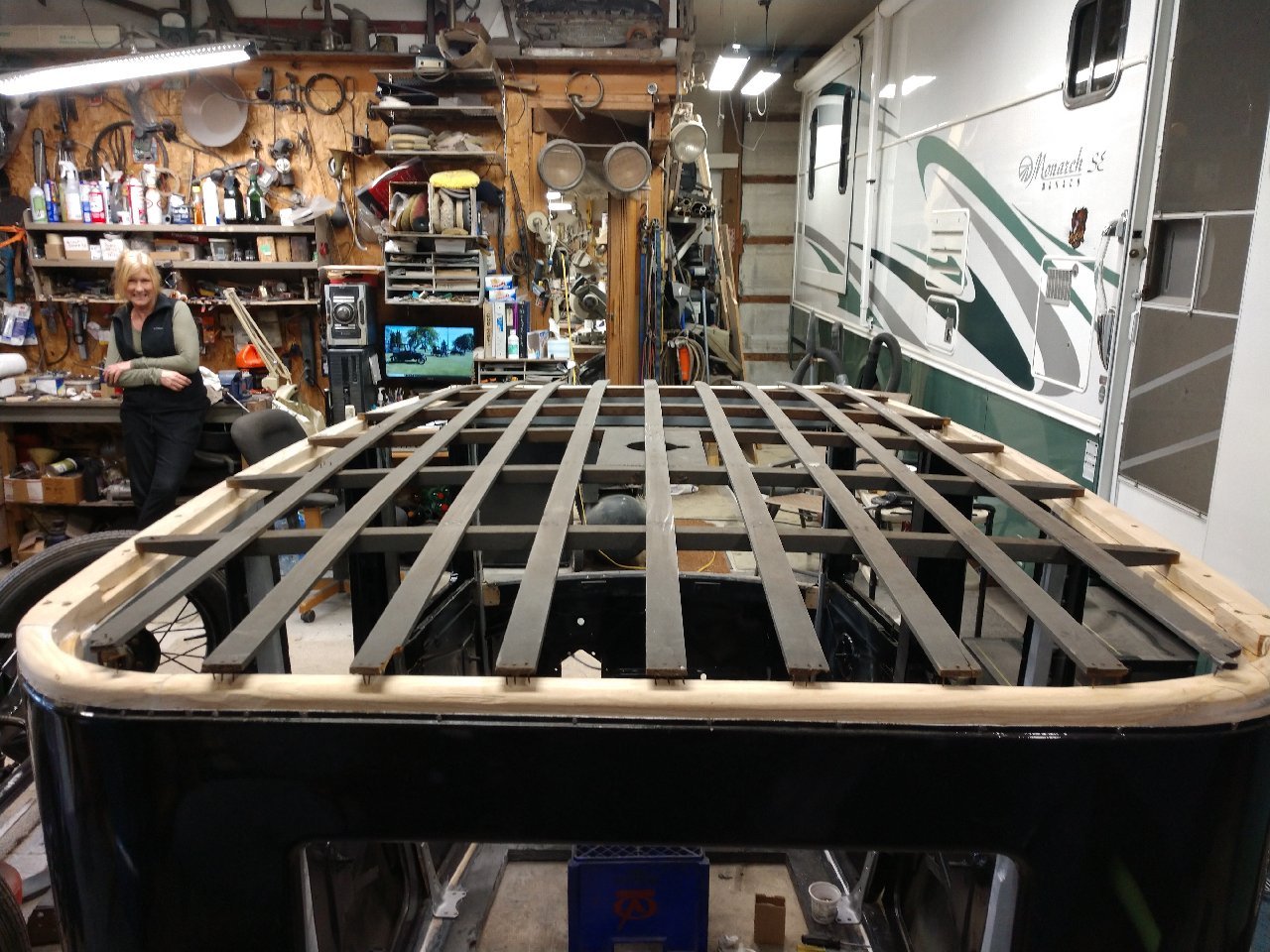

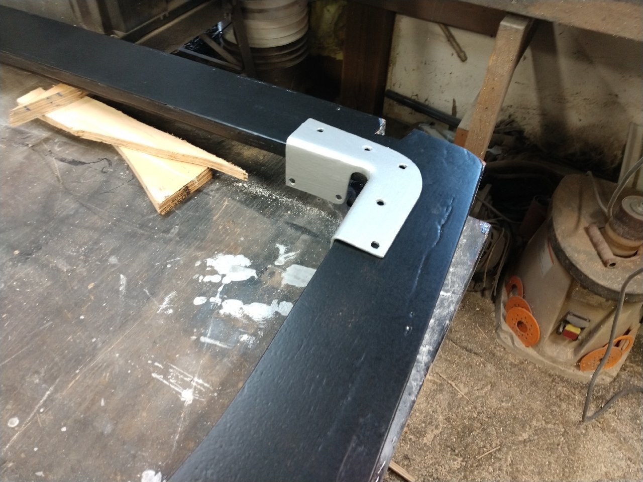

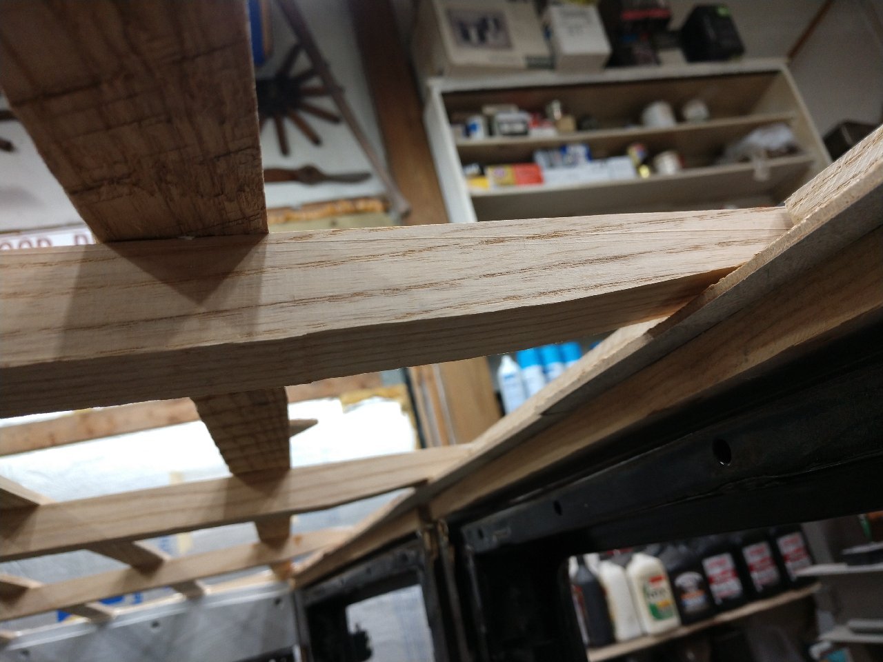

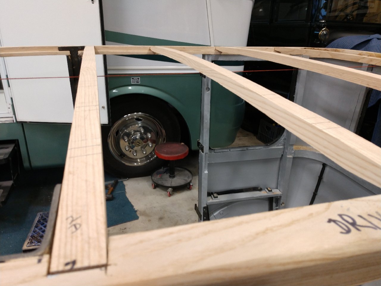

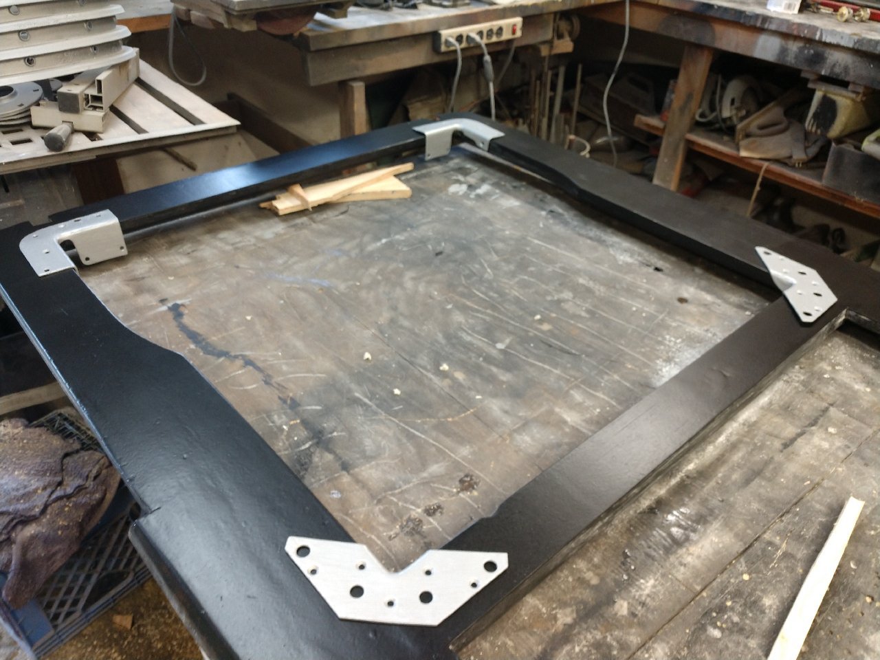

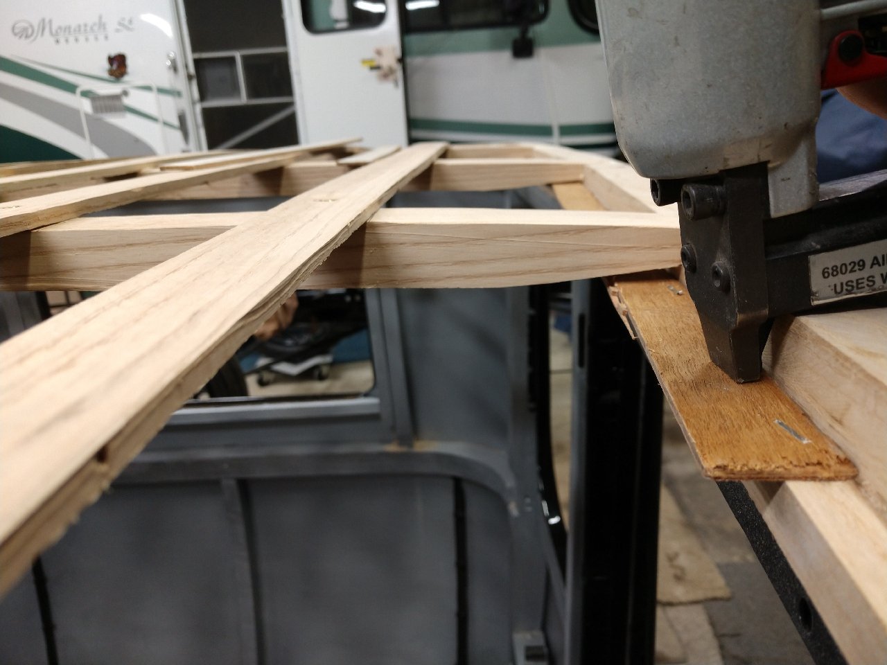

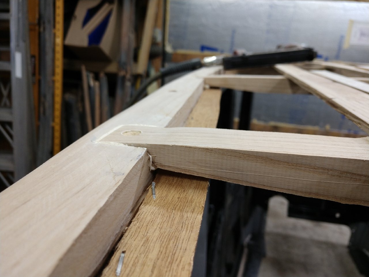

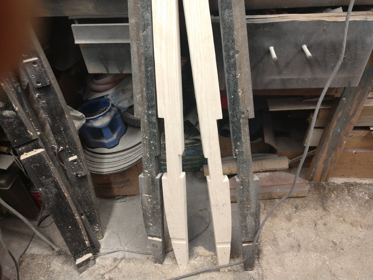

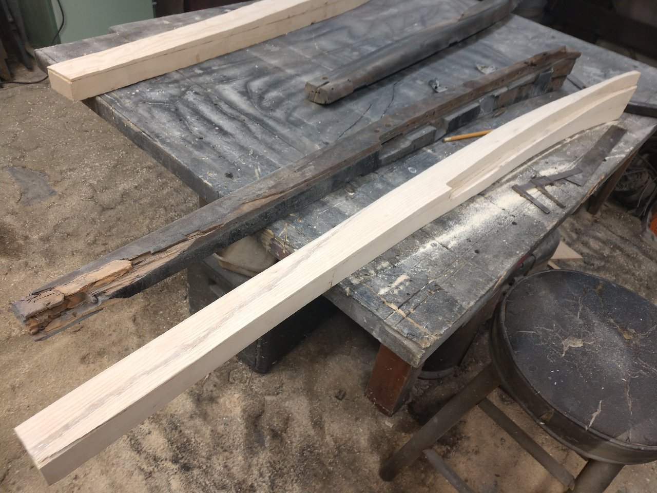

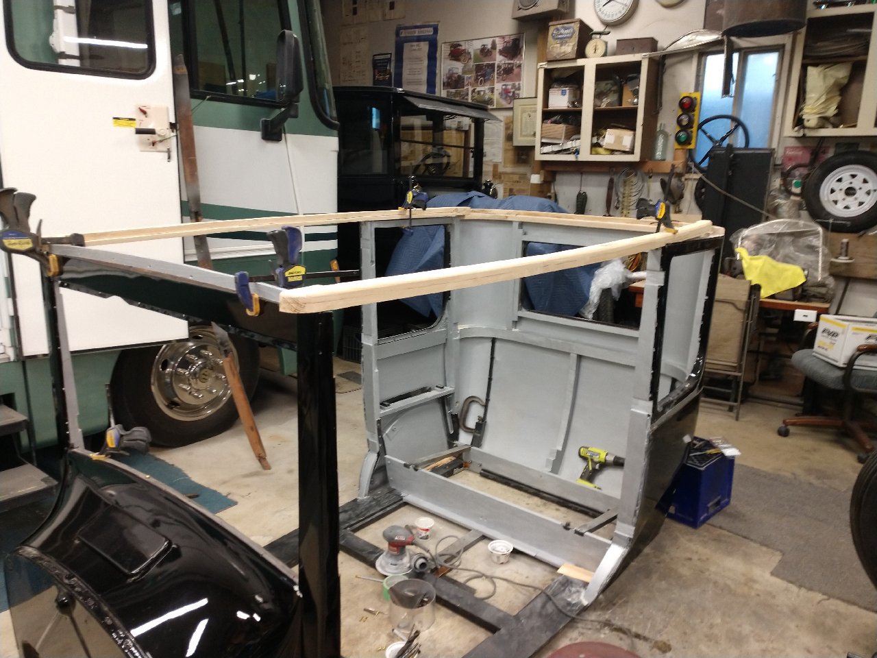

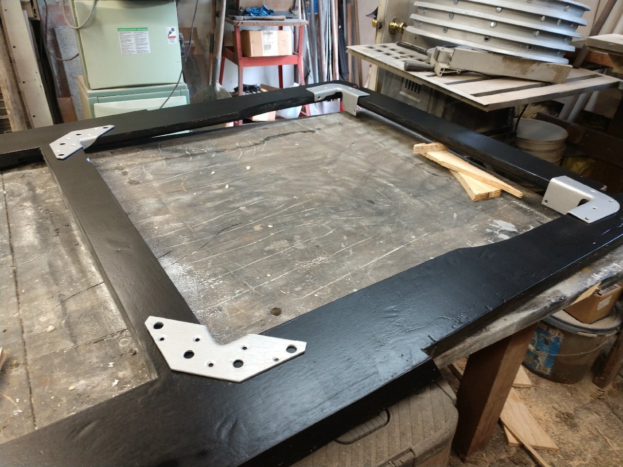

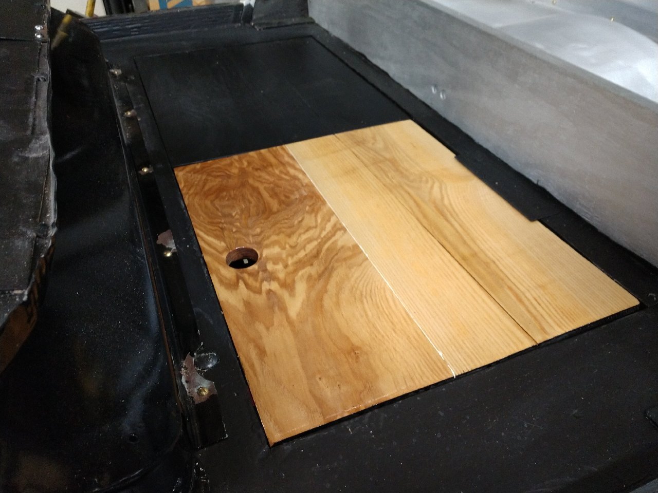

The remainder of the wood kit arrived today. Ok, I had to go pick it up but its worth it. Hand picked for this historical artifact. Let the good times roll !! ( The base is all set and fitted. )

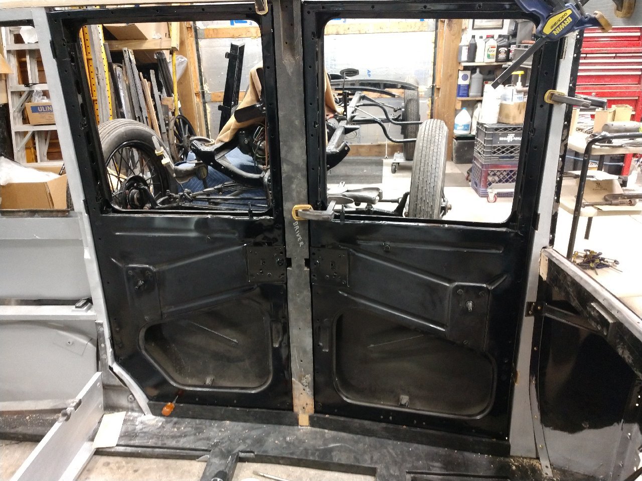

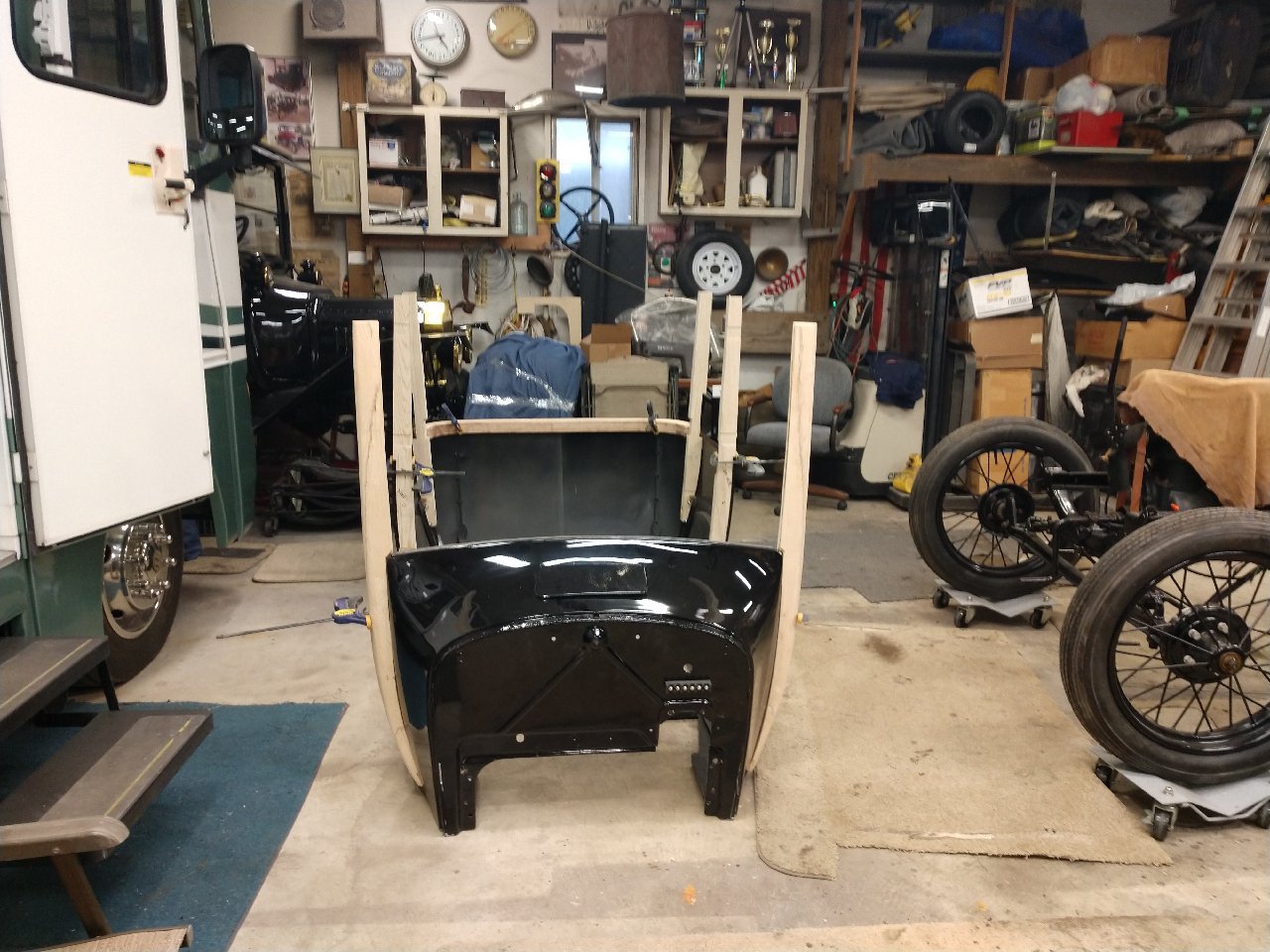

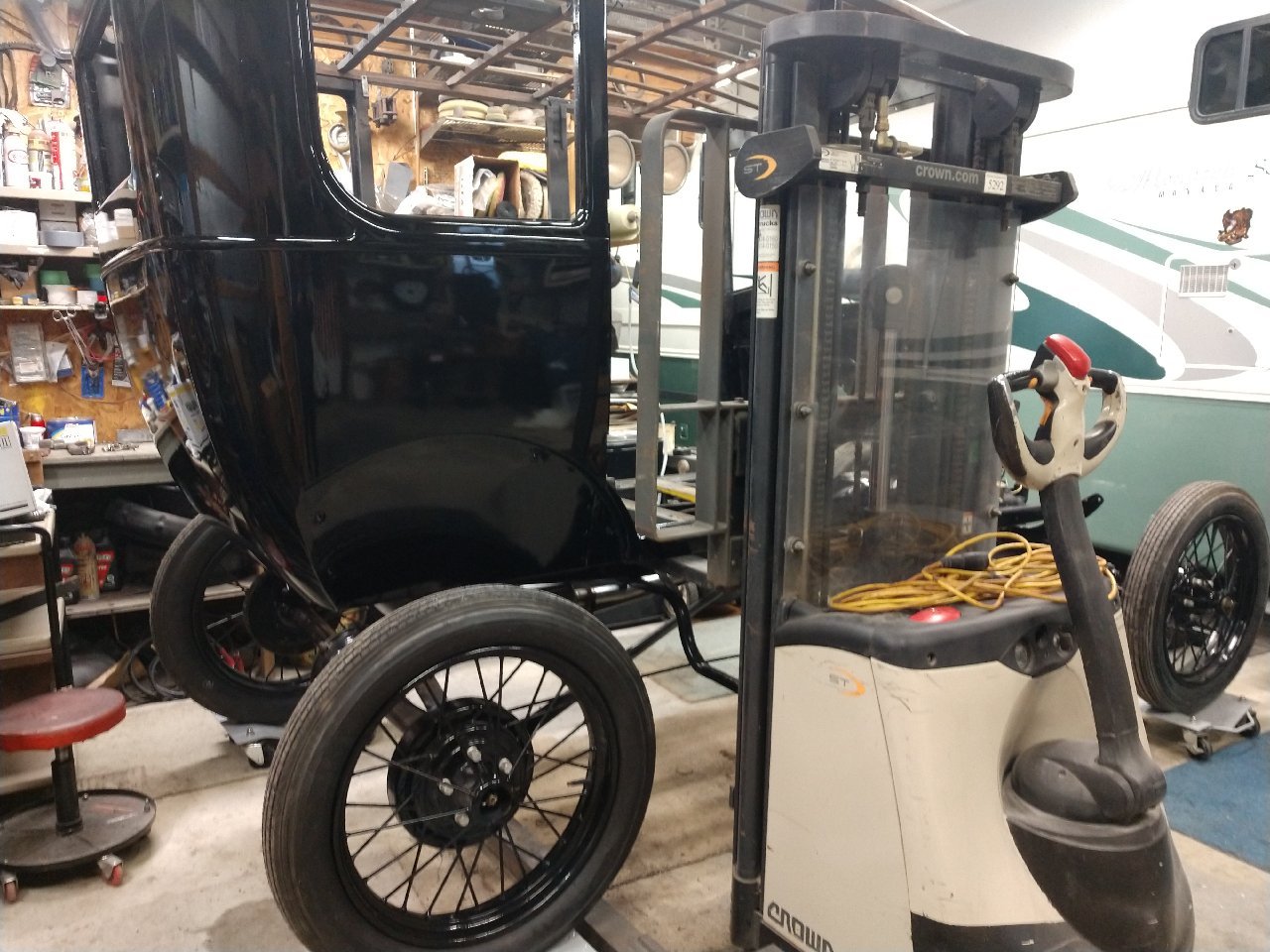

Did I ever share that early on in life I needed to get a Fordor Body off the frame so I just jacked and cribbed it until the rear crossmember was clear and rolled the chassis out from beneath? (Had to do that twice as one the first try figured would be easier if pointed in other direction :) )
So now it was up on cribbing with 2x6 widthwise under the sills like running board supports and I figured...doors off, steering column out, seats out, I'll just lasso these 2x6 cross members, toss the line up over a big beam in the ceiling, make myself a bosun chair at a long angle and then with my legs out front like a stubborn mule, knock the cribbing out and let my body in the bosun chair be the counterbalance and walk slowly forward. ??
Oh never mind....you guys all know the answer. :oops: :oops: :oops:
(Like the pallet truck idea!)

George, don't feel bad it took me a while to figure out the forklift was the way to go. And no, I don't post photo's of the screwups....LOL.

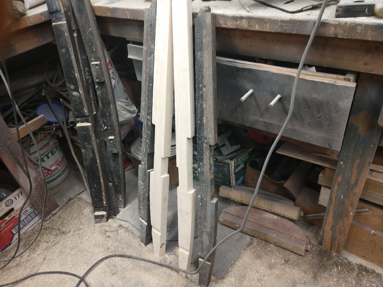

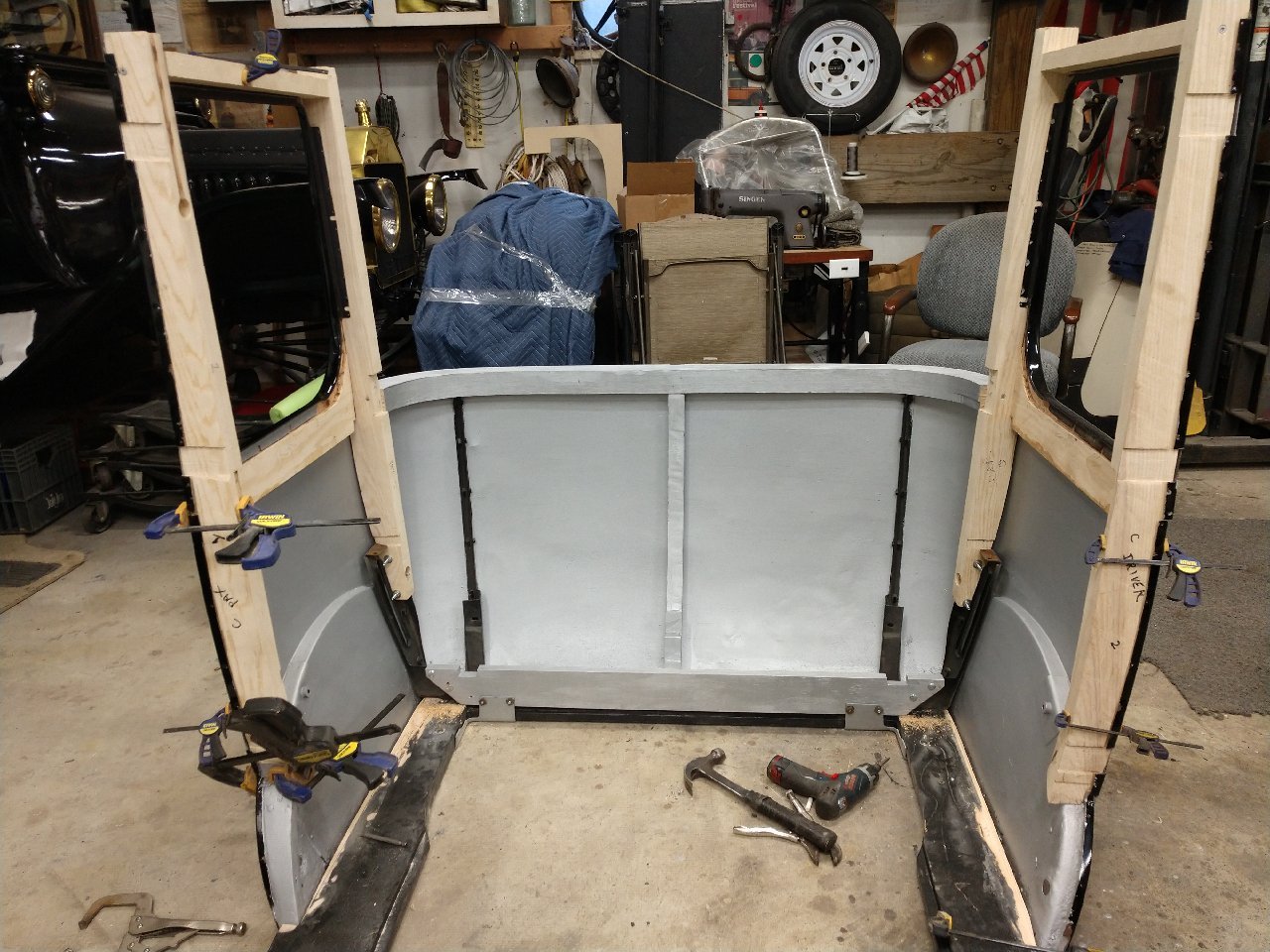

Years ago a few of us got together and made four sets of Fordor wood, I still have many pieces up in the barn, these where for the 23-25 style, I notice the base had changed in 26-7 from your pictures. Did they still use the angled bolts on the front door post to roof in 26-7? We mad some extra's if needed.

Re: '27 Fordor Restore......# 5 !!!
Post by FordorGalore » Tue Oct 13, 2020 11:41 am
Yes they used them. I won't be though, I prefer to use a tenon laced in 3M 5200 adhesive. It makes a strong flexible and waterproof joint.

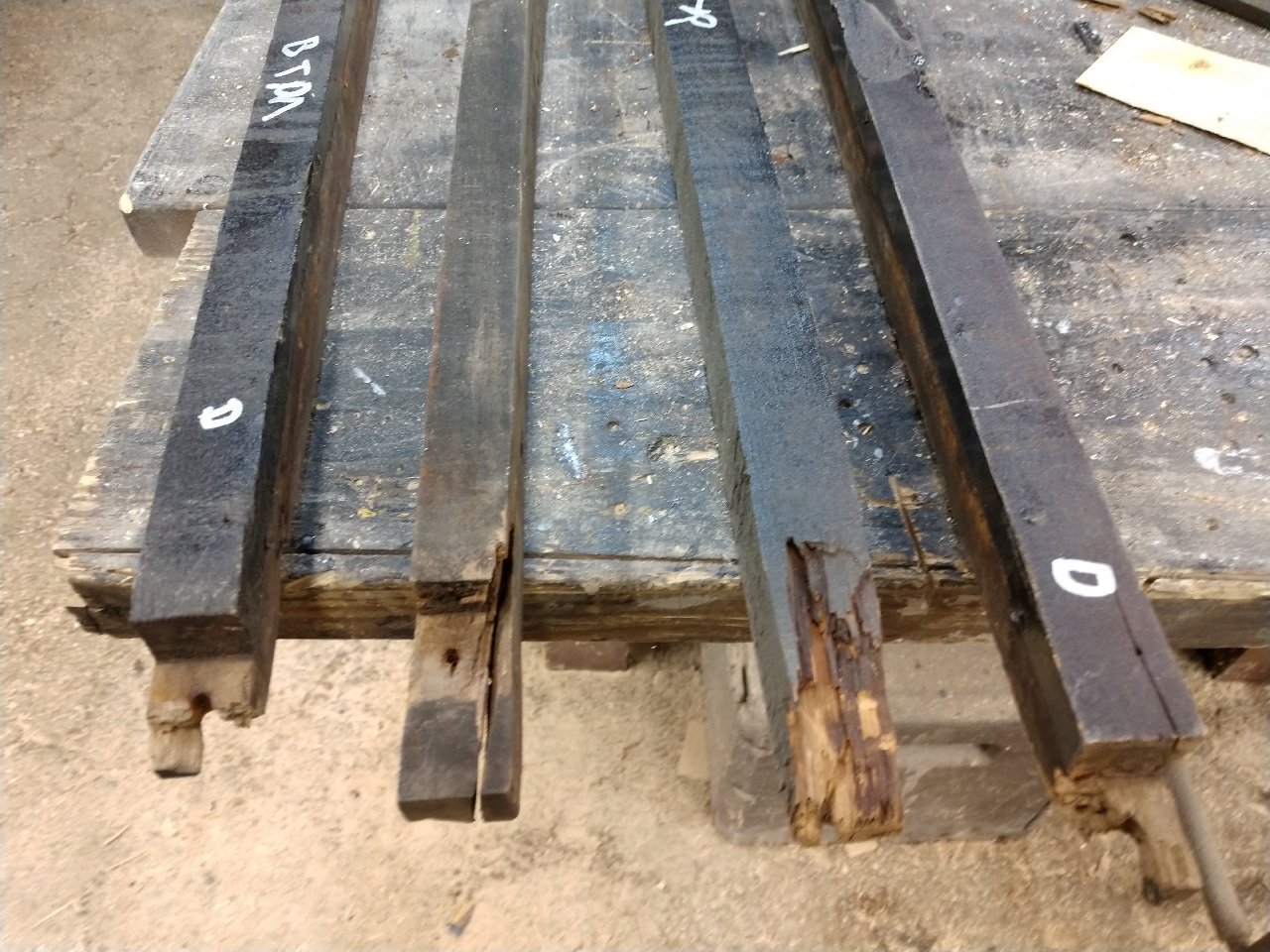

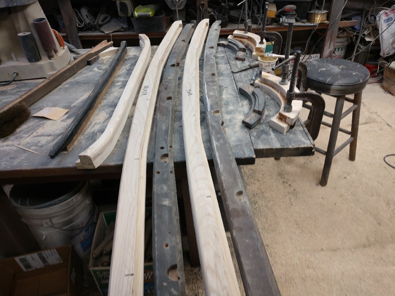

Post by FordorGalore » Thu Oct 15, 2020 8:28 am

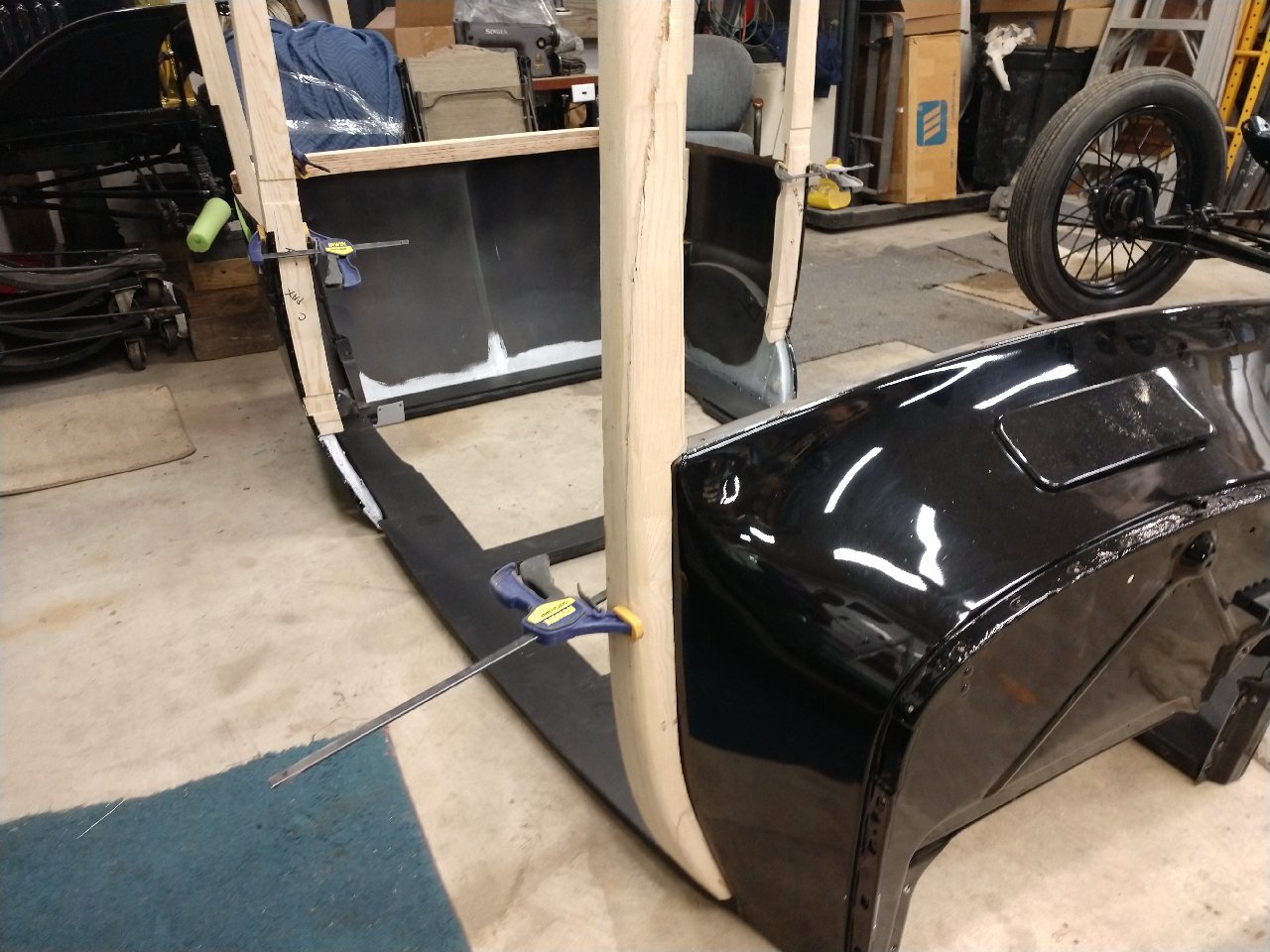

The "A" pillars are starting to take shape....still have a ways to go. :D
FordorGalore
Posts: 430
Joined: Fri May 03, 2019 8:20 am
First Name: fore
Last Name: door
* REQUIRED* Type and Year of Model Ts owned: 1922 centerdoor 1927 fordor 1916 centerdoor
Location: Nowhere Michigan

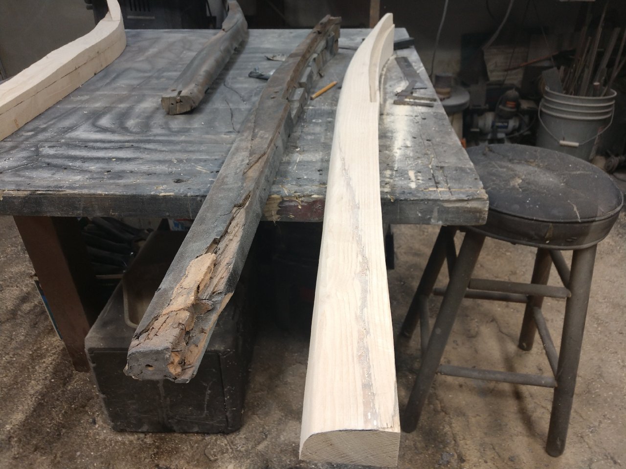

Post by FordorGalore » Thu Oct 15, 2020 8:37 am
The "D" pillars are done.... I will wait for the top rail to do the final cut and tenon. :D
Post by FordorGalore » Sun Oct 18, 2020 10:34 am

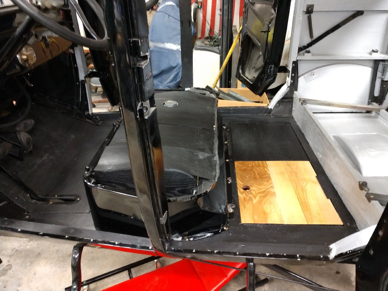

Loosely speaking, just sizing things up....

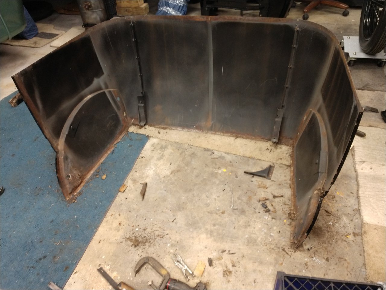

Post by FordorGalore » Sat Oct 24, 2020 7:09 pm

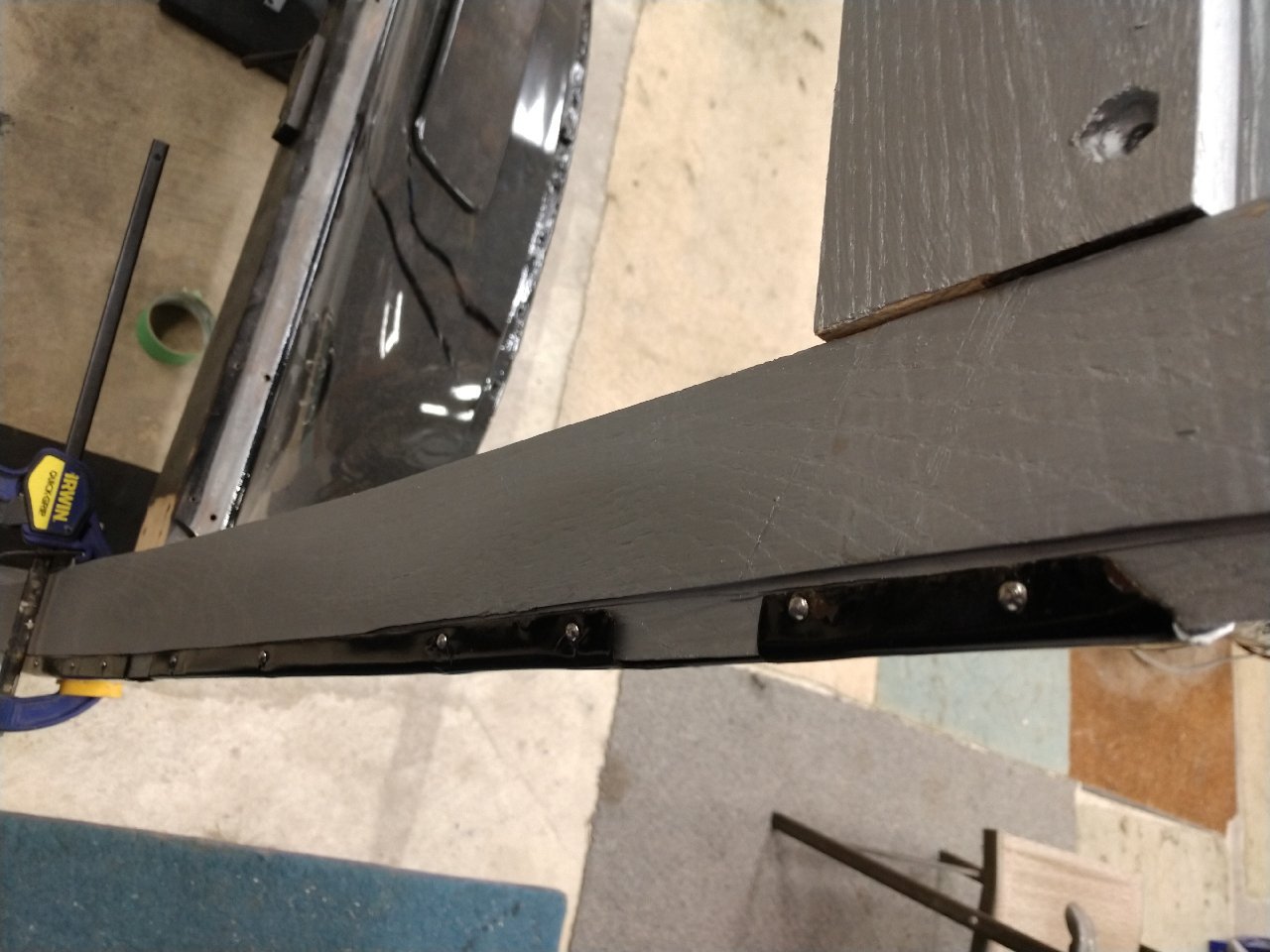

Thank you John ! Well what I consider the worse part of re-wooding a Fordor is done. The "A" pillars are finished and re-skinned. Thank goodie for that~ :)

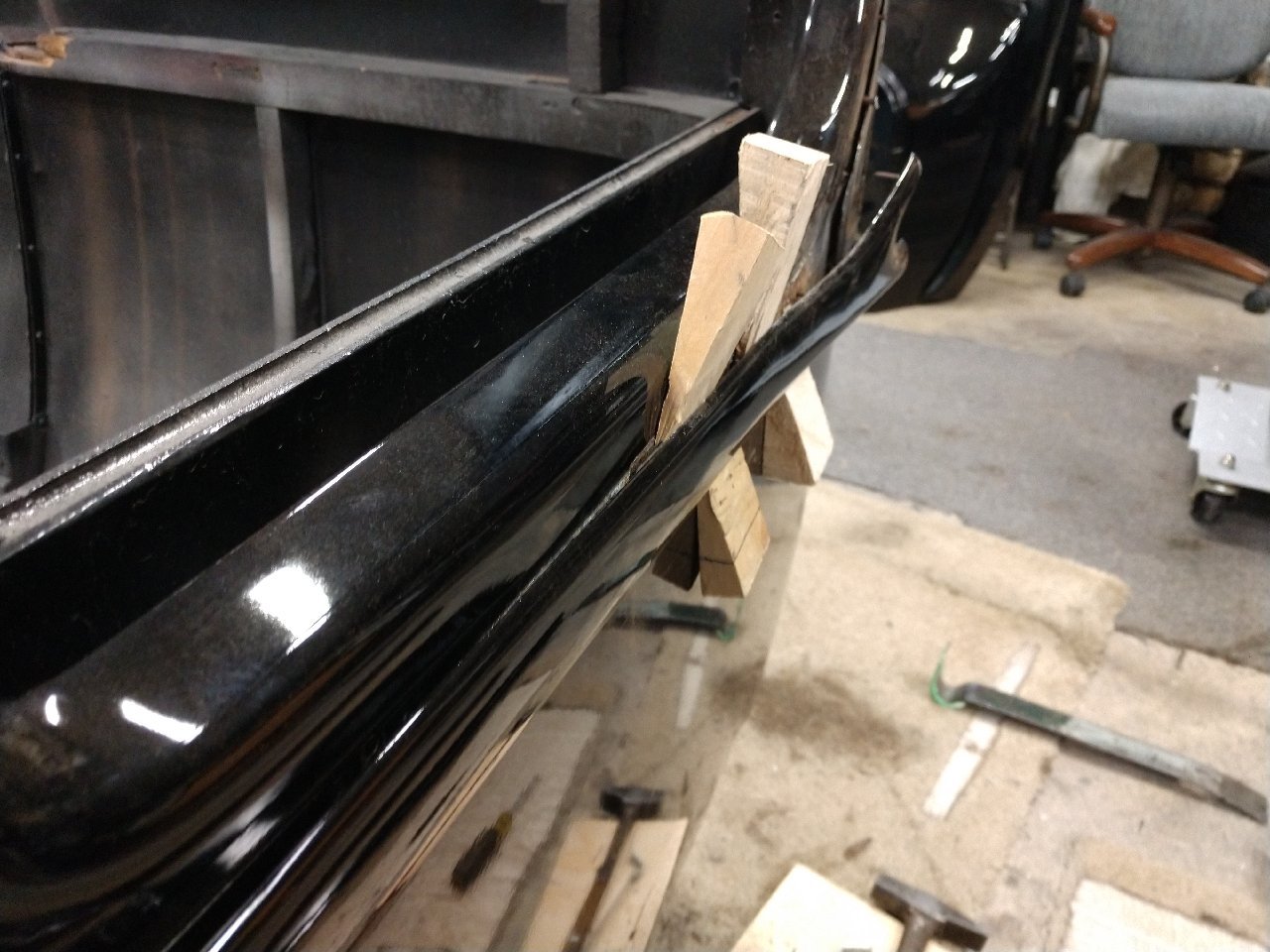

First Name: fore
Last Name: door

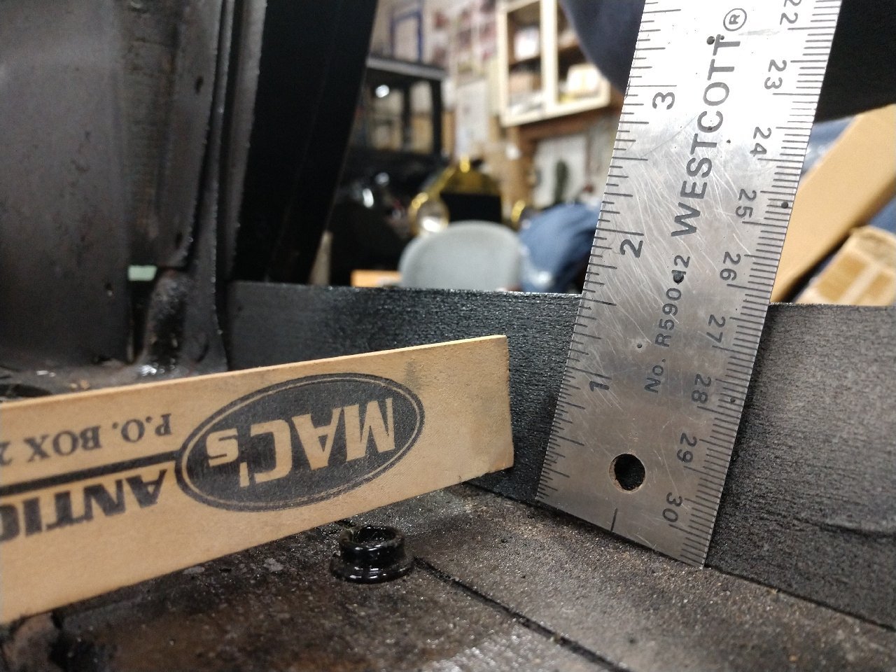

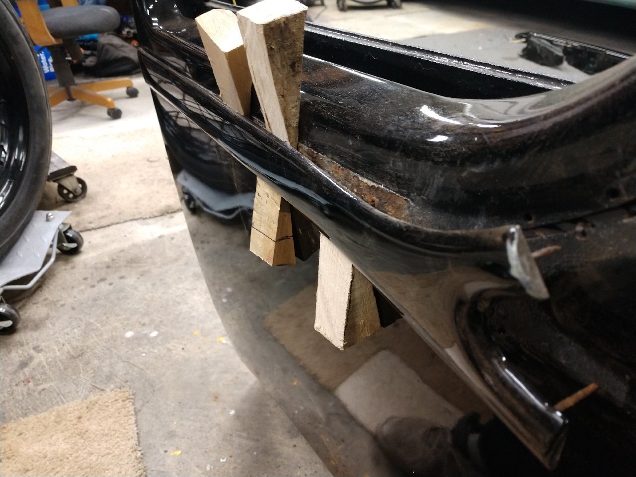

Post by FordorGalore » Mon Oct 26, 2020 4:52 pm

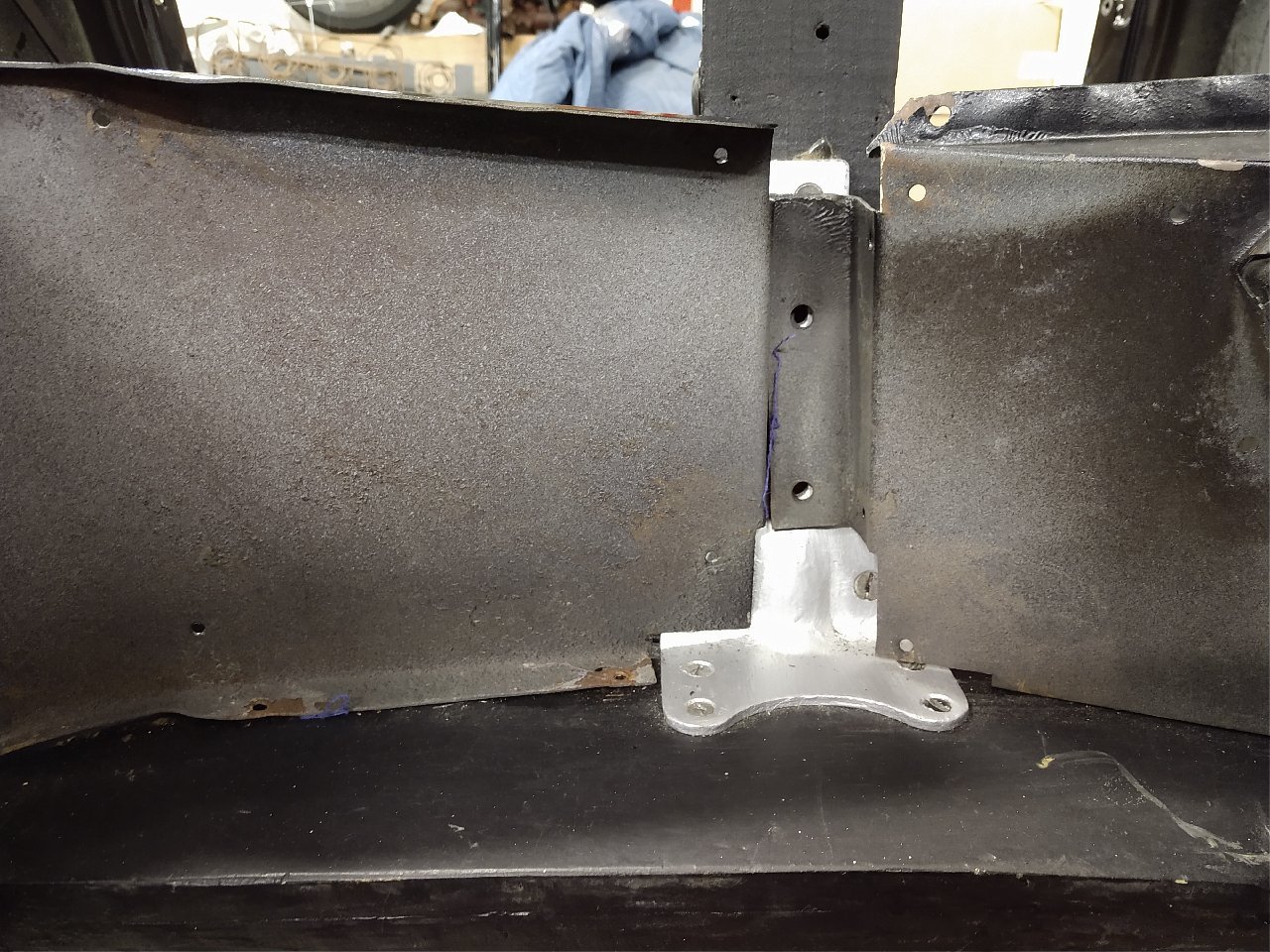

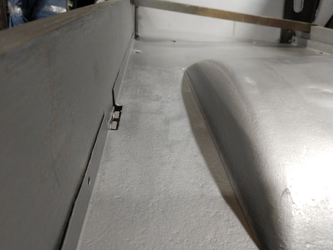

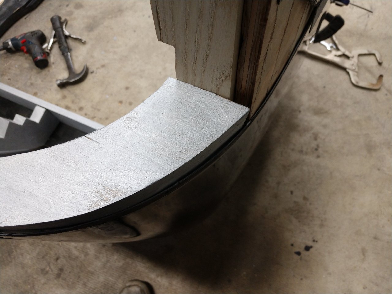

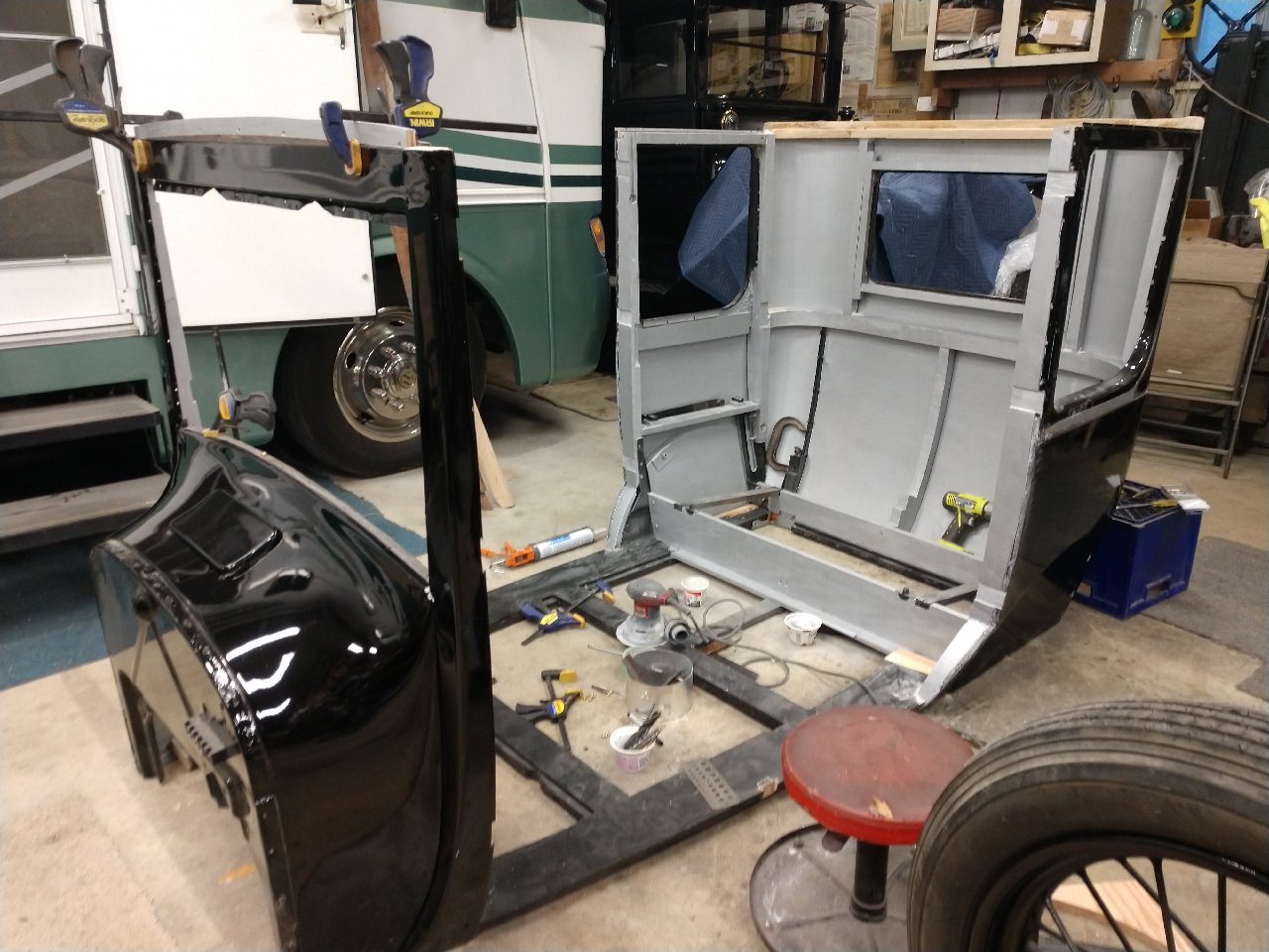

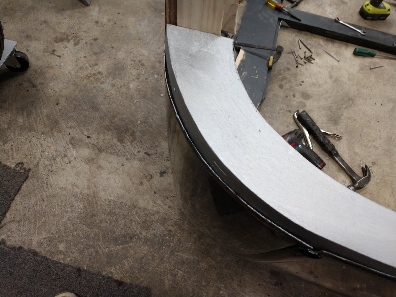

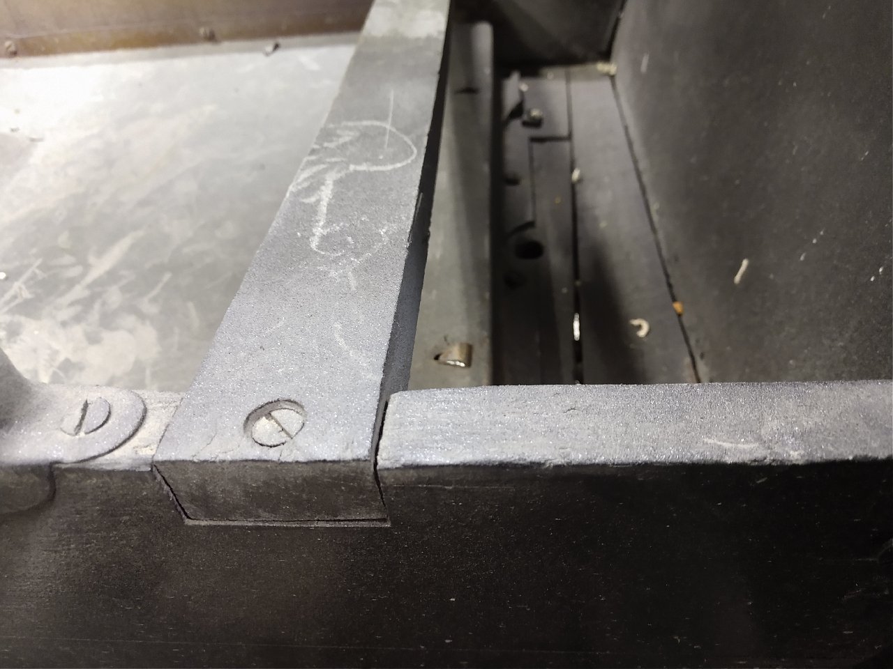

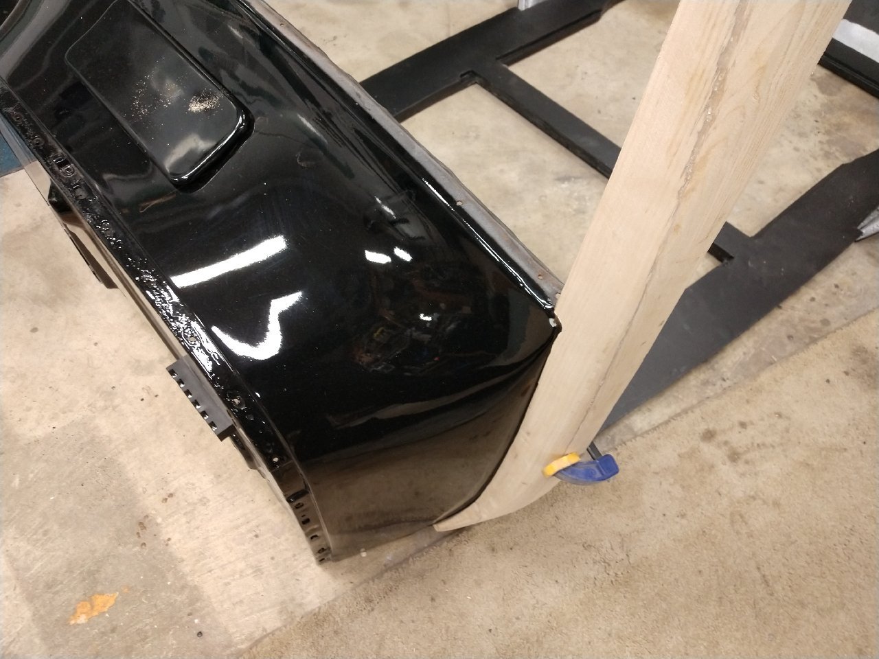

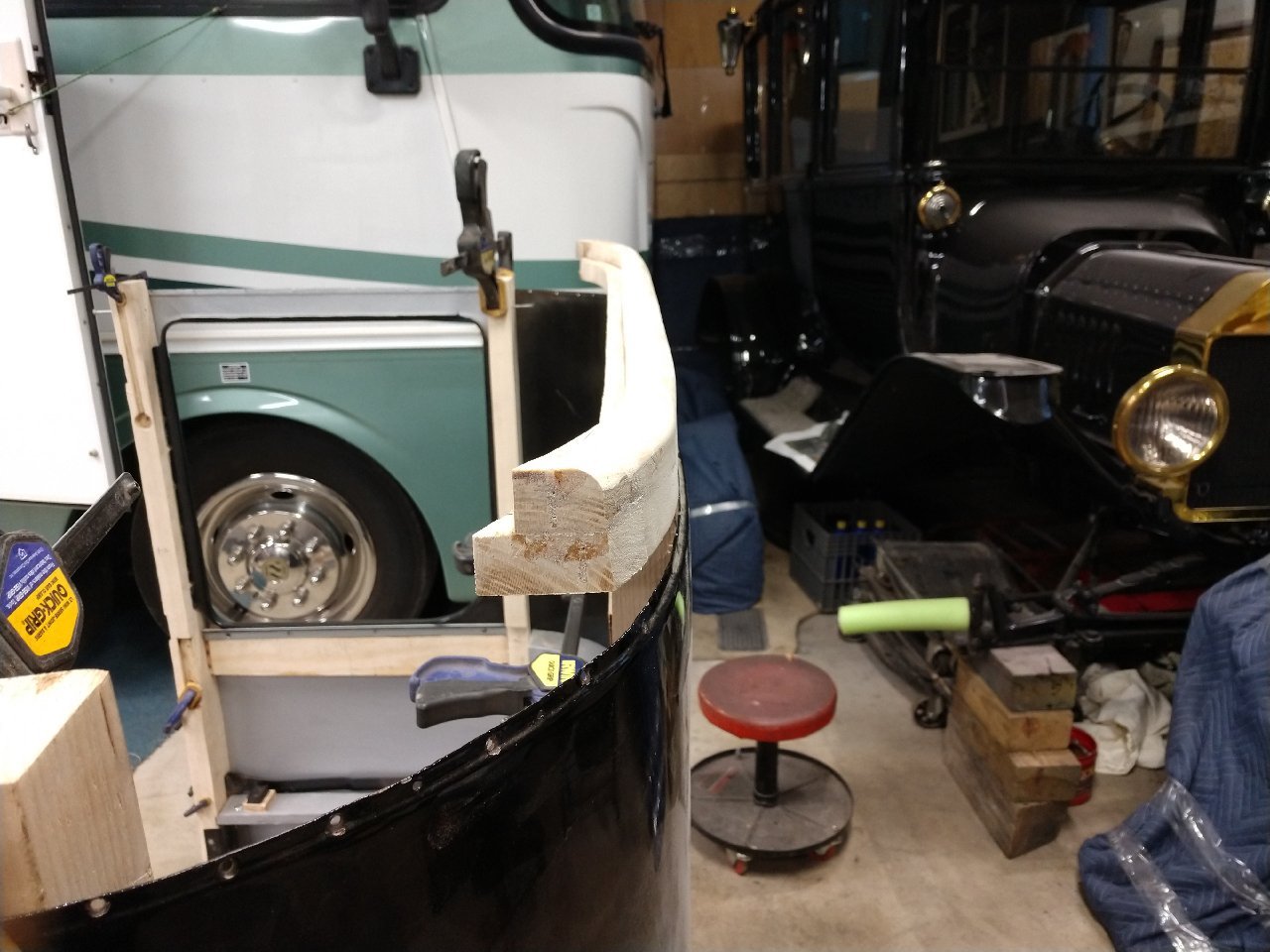

Cleaning up the fit of the base and the rear tub. I had to add 3/16" on both sides of the base to get the fit where I wanted it. Keep in mind this is all very rough yet and has a long way to go...

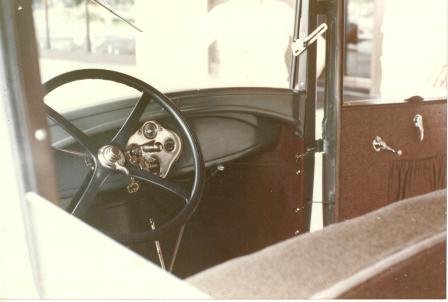

Post by david_dewey » Wed Oct 28, 2020 2:24 am
Boy, that is the truth! Some decades ago I restored a '29 A Briggs Blindback Sedan--a model that is actually more rare than the infamous A-400 Convertible Sedan. There was NO body wood, although the doors still had their wood and I was even able to save and use some of it. Somehow the body metal had survived with only a few small dings, and no rust out. And all the brackets were there too. I don't know if I would undertake such an adventure nowadays--but then I'm much older (and wiser?) now.
Rt Rear corner interior wood forum.jpg (20.37 KiB) Viewed 17537 times
Fitting wood rt side forum.jpg (27.5 KiB) Viewed 17537 times
Rt Front painted forum.jpg (32.2 KiB) Viewed 17537 times
Interior dash forum.jpg (21.97 KiB) Viewed 17537 times
T'ake care,
David Dewey

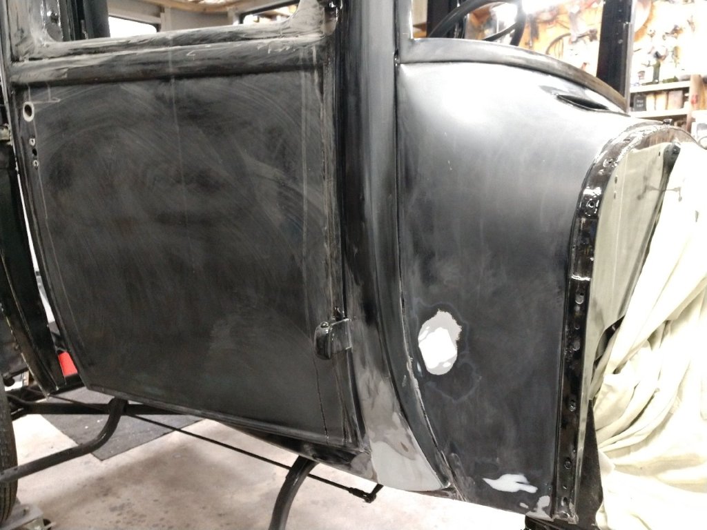

Post by FordorGalore » Thu Oct 29, 2020 8:09 am
Oh Dave you know you would !

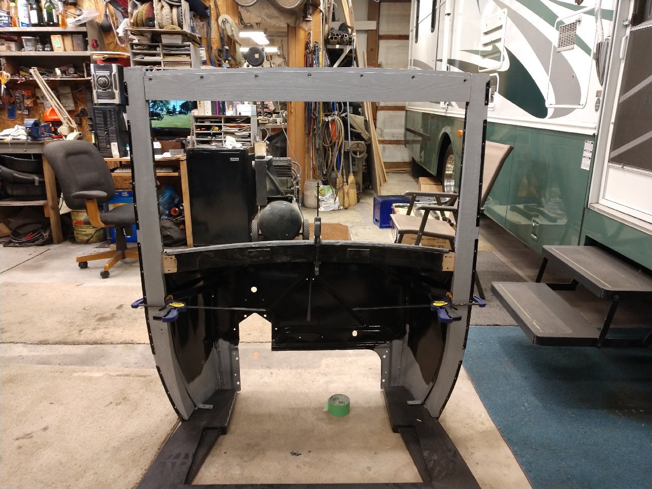

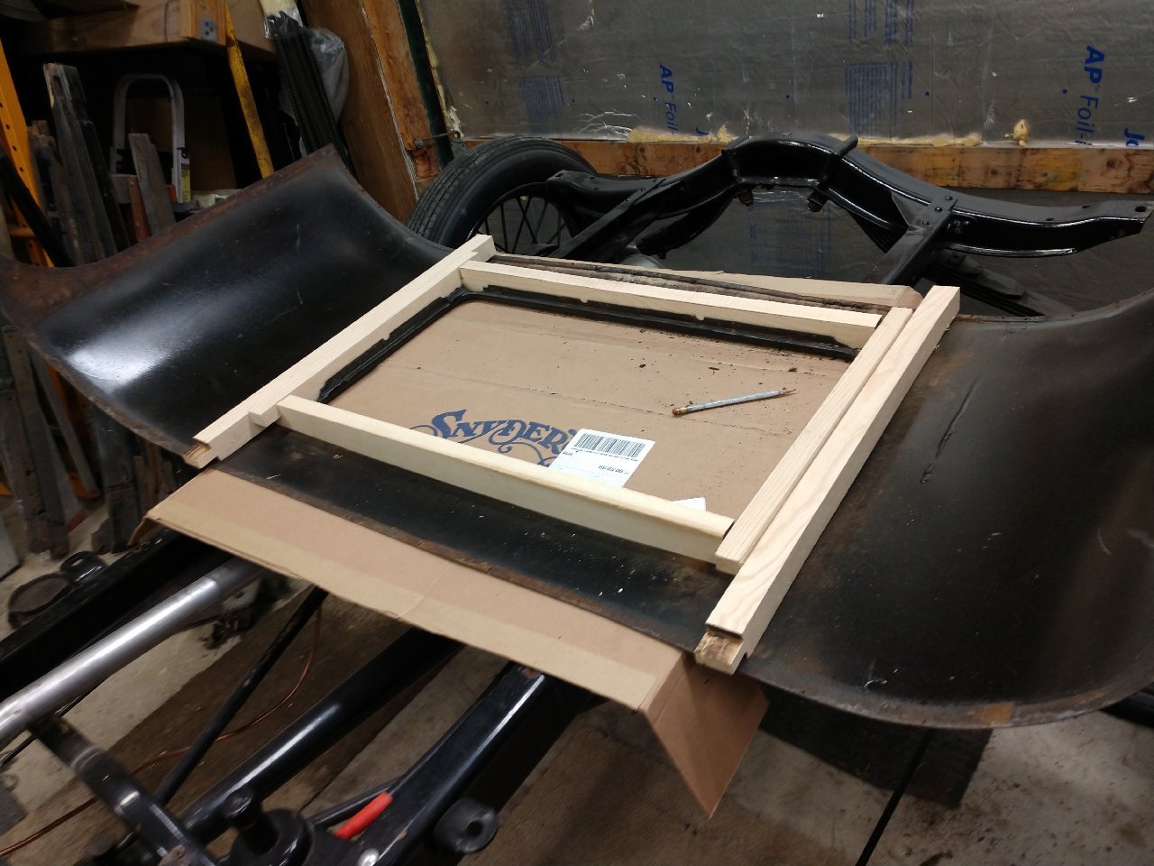

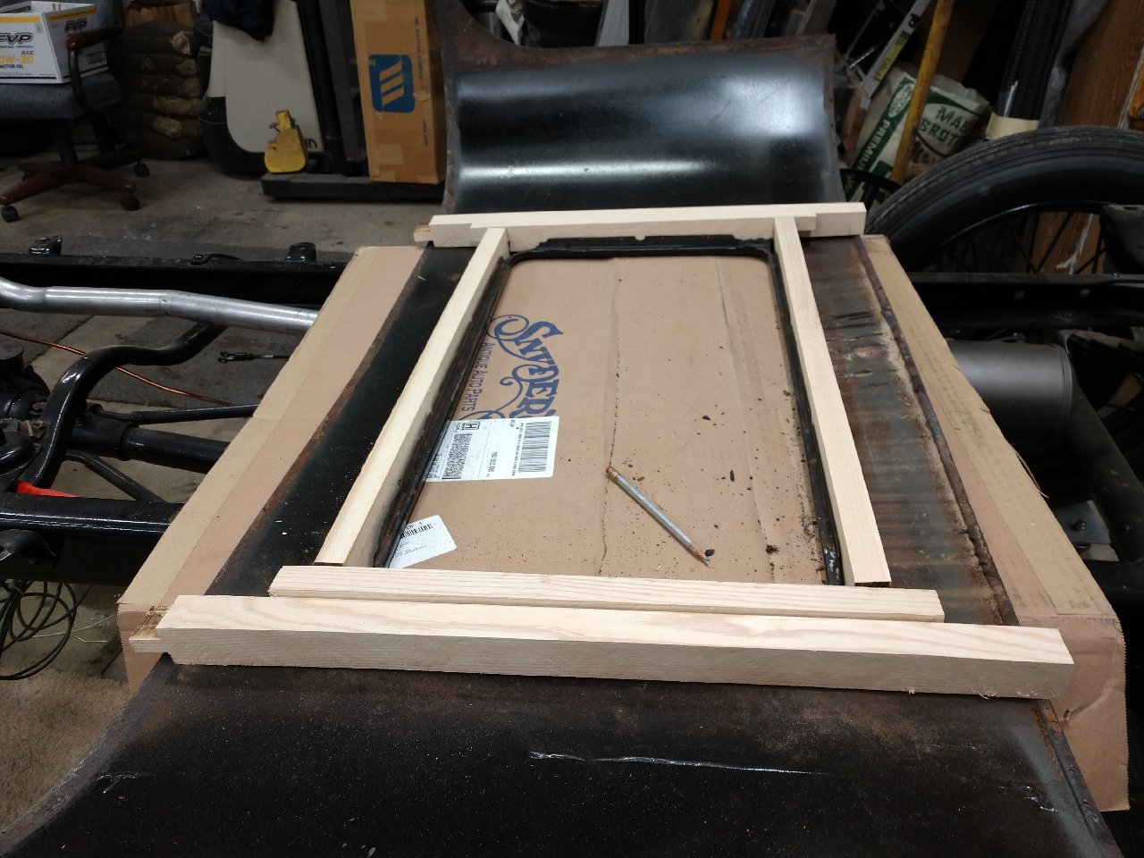

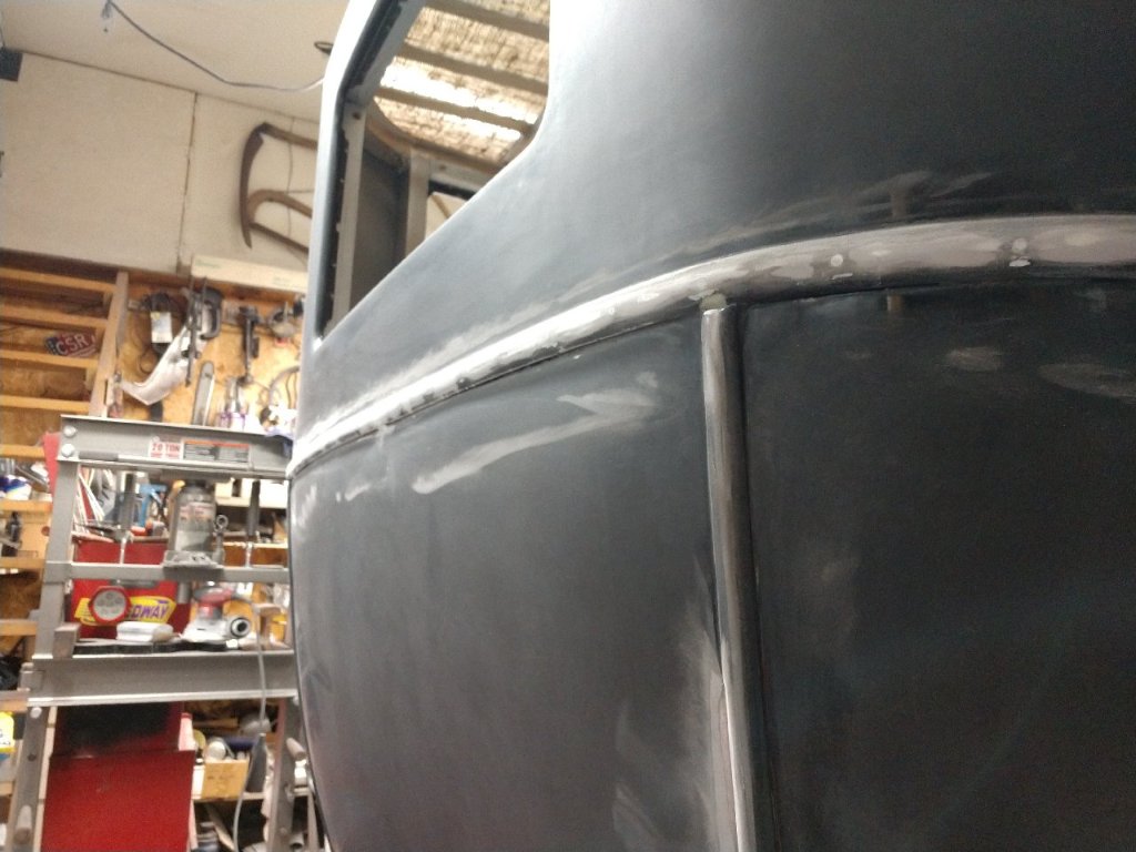

Working on the rear window framing. Square as square is square... :) :) :)

My skin should be so tight.....

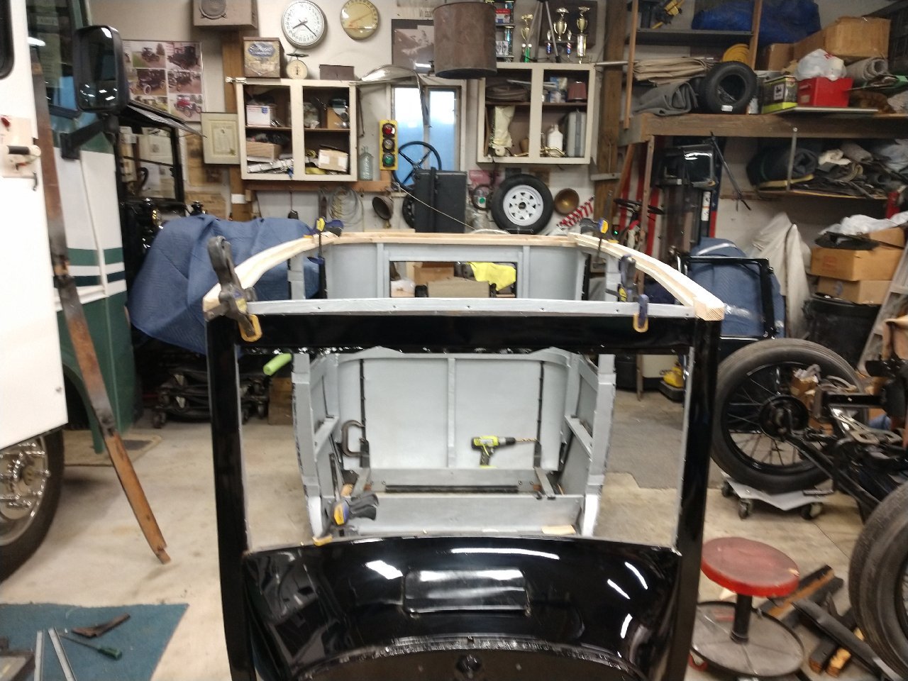

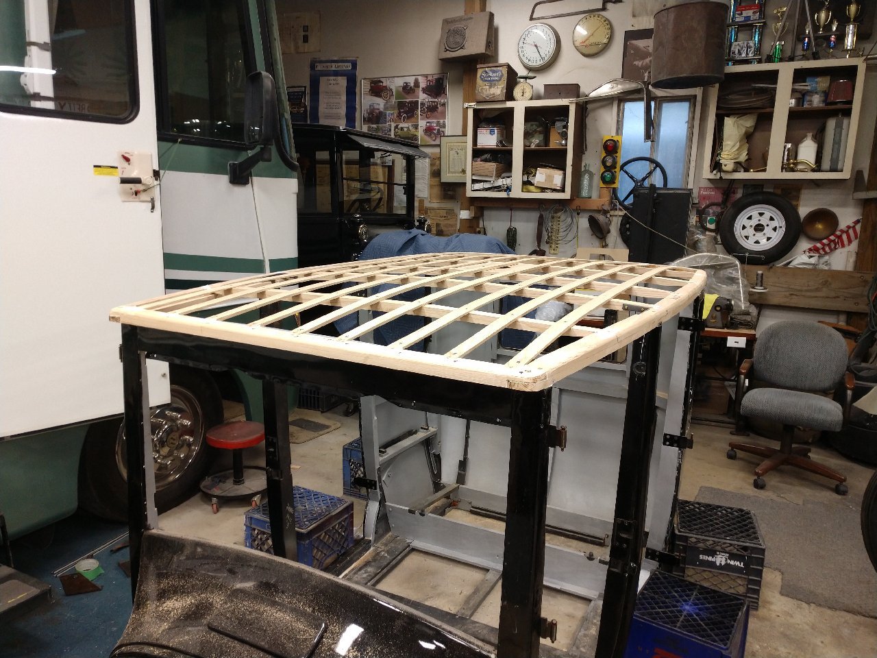

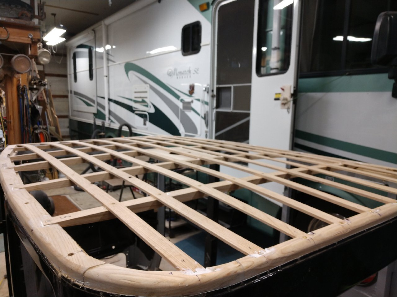

Post by FordorGalore » Sat Oct 31, 2020 6:25 am

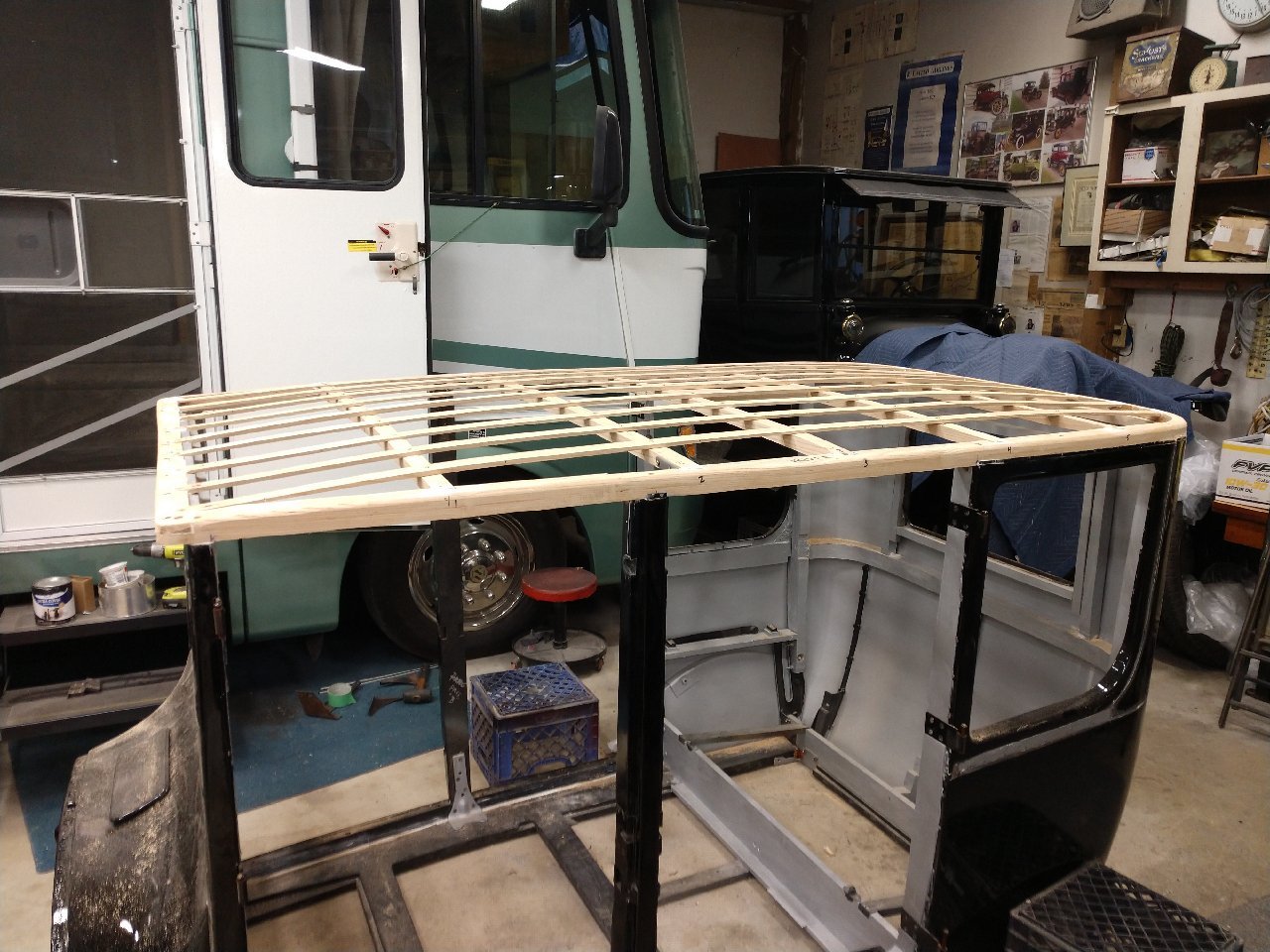

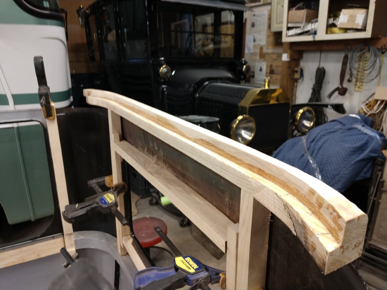

Get'n on top of the top !! I hope Henry forgives me but I'm adding a little muscle to the corner pieces. Every T I've worked on, the corner pieces had failed. So I'm making the entire rear top piece by laminating and crossing the grain so to prevent future problems. It's the hard way to do it but I'm sure it will last much longer. 1927 Model T Fordor ***keep in mind EVERYTHING is in the rough stage yet. ***
Posts: 1685
Last Name: Seth
Location: Jefferson Ohio
Post by perry kete » Sat Oct 31, 2020 8:05 am
Laminating the top is a great idea and I wish I'd known about that when I re-wooded my Coupe. The extra strength will help hold together better because of the flexing of the corners on an uneven road.

Post by FordorGalore » Sat Nov 07, 2020 6:27 pm

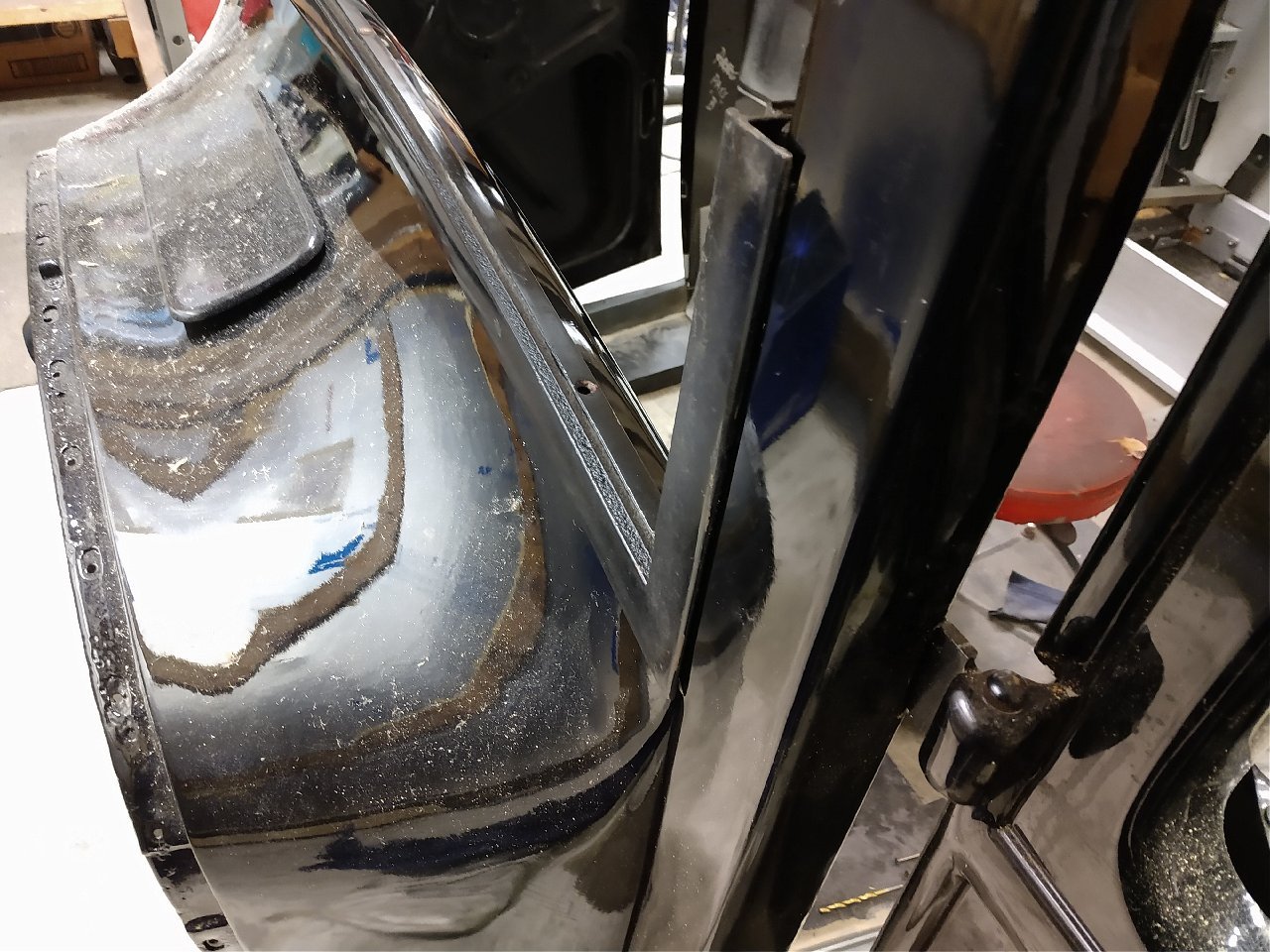

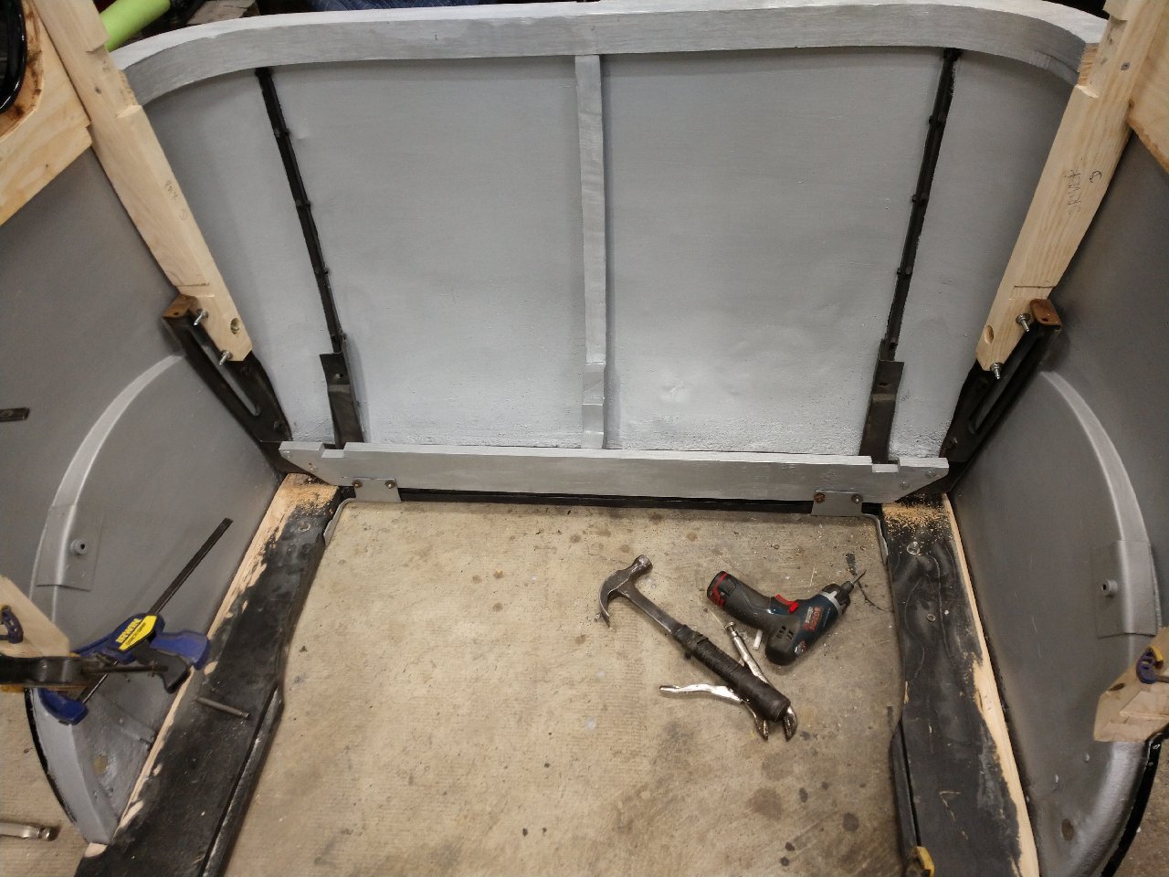

And the cowl let out a howl so I said "fowl" and put it together...

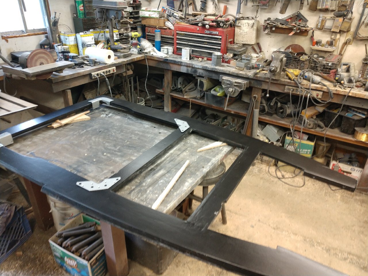

Post by FordorGalore » Sun Nov 08, 2020 11:34 am

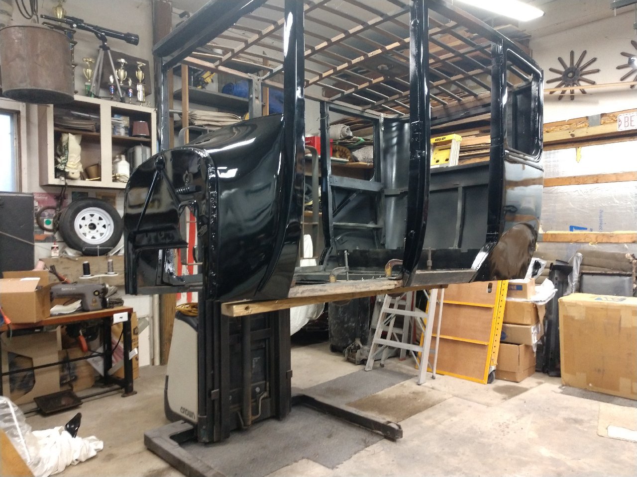

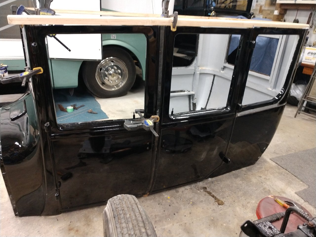

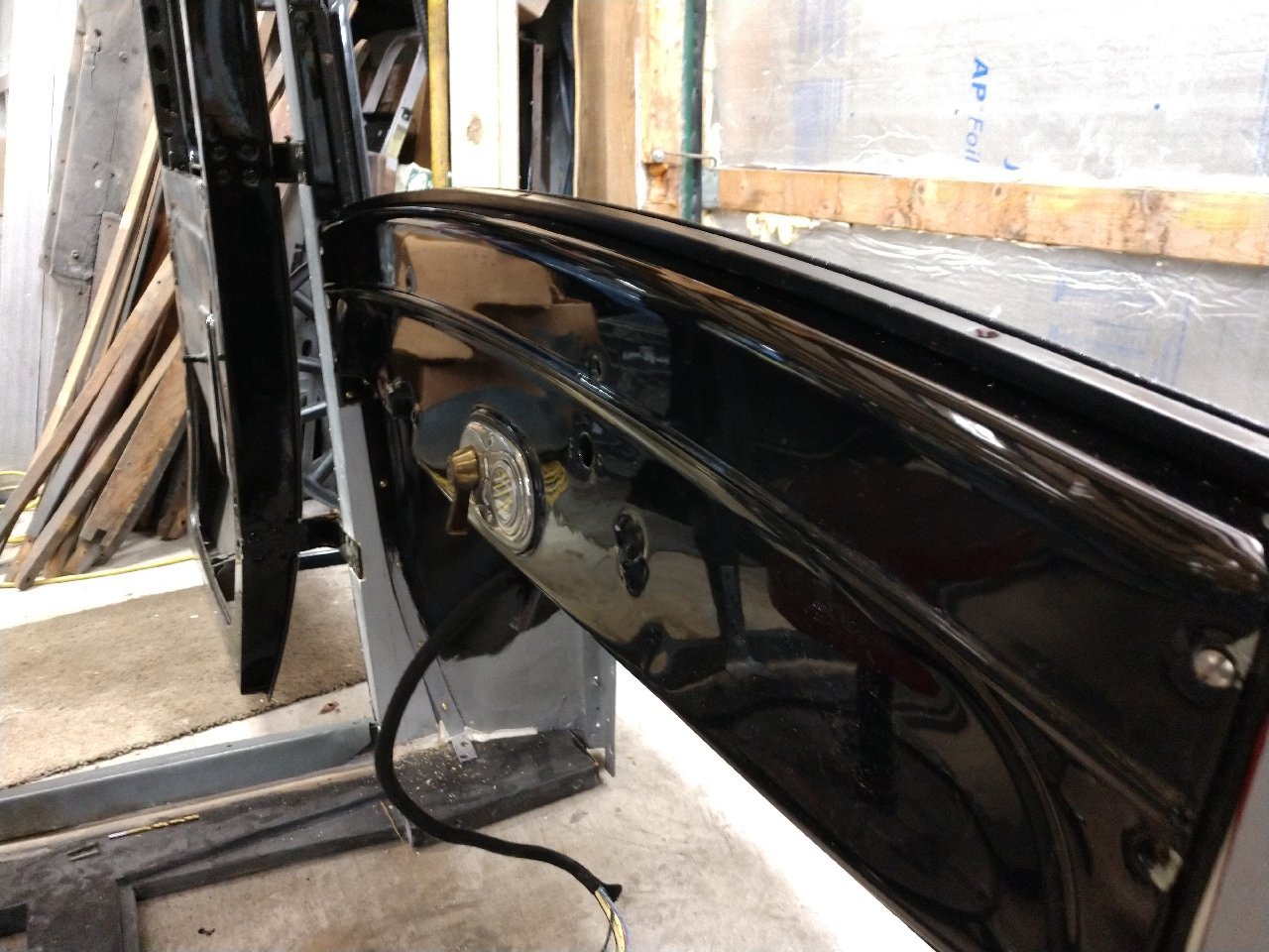

Trial fitting the doors and "B" pillar....so far so good.

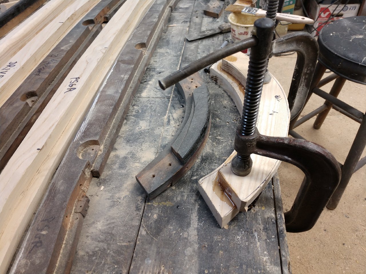

Post by FordorGalore » Sun Nov 08, 2020 4:30 pm
Thank you Roffe, I appreciate the kind words !! :)
Harass away Mr. Pairoffeets !! I too am enjoying the 70 degree November weather ! :D :D
FordorGalore
Posts: 430
First Name: fore
Last Name: door

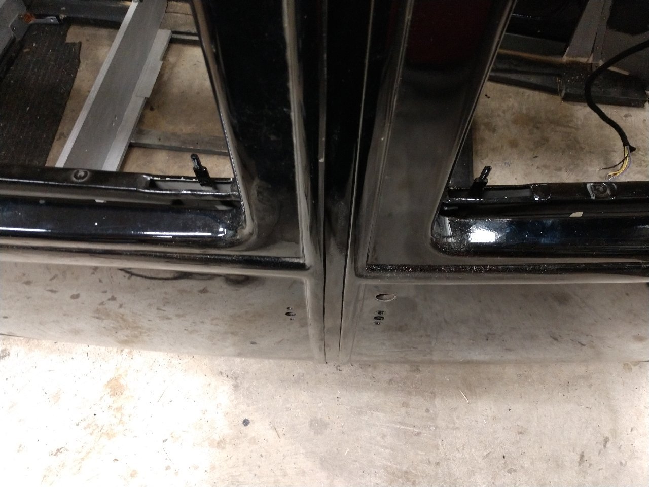

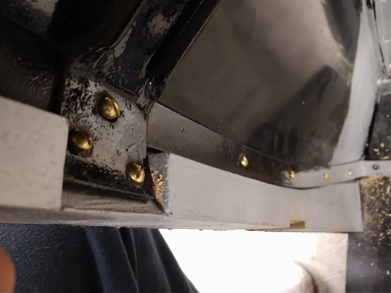

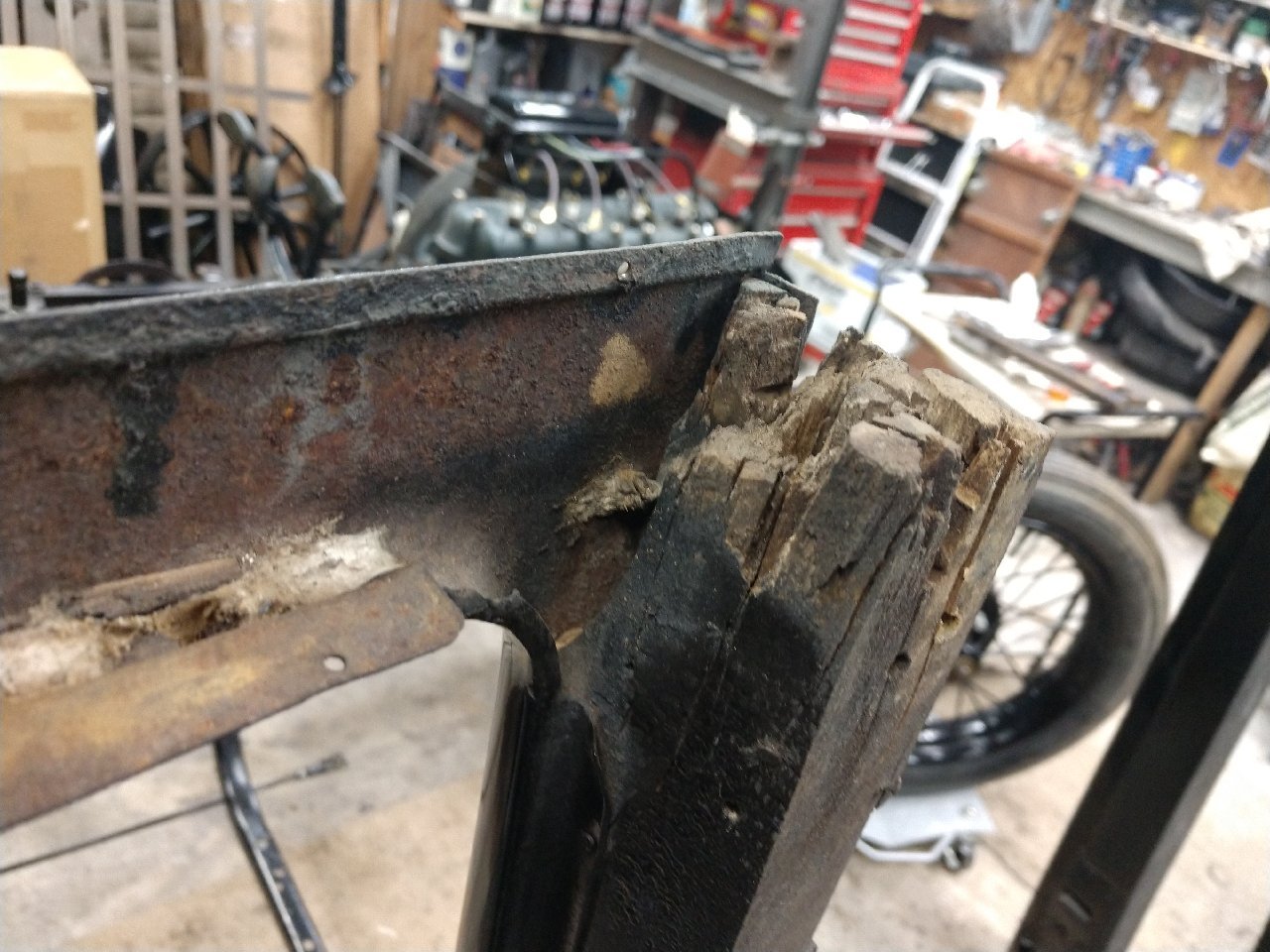

Post by FordorGalore » Tue Nov 10, 2020 4:32 pm

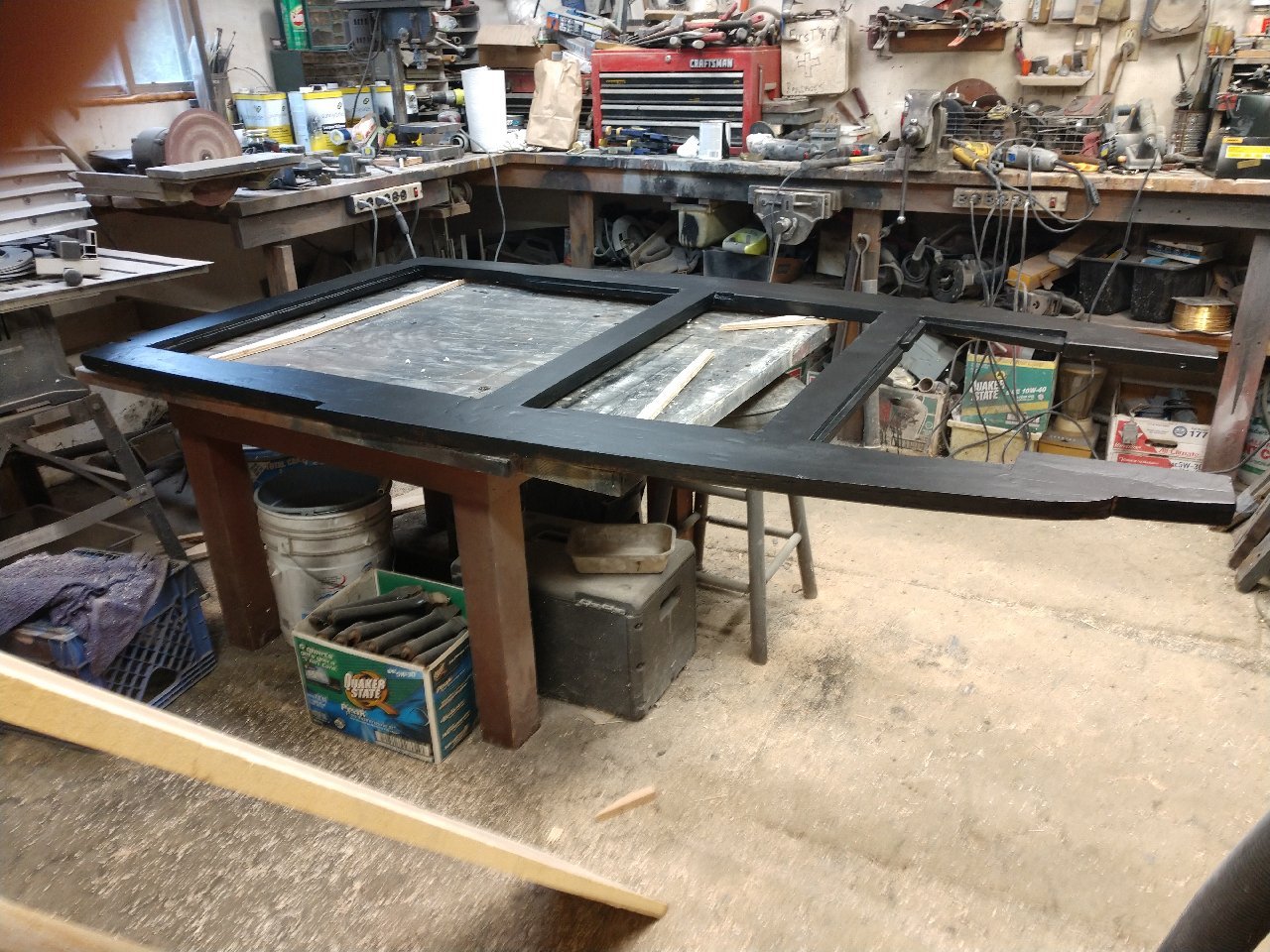

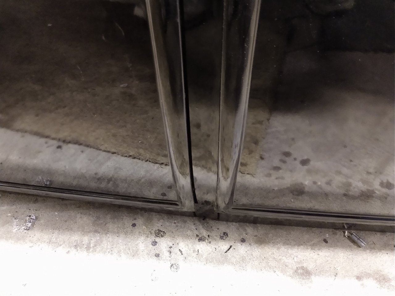

Doors are all fit and now just sizing up the old with the new. :D

Posts: 430
First Name: fore
Last Name: door
Post by FordorGalore » Thu Nov 12, 2020 11:55 am

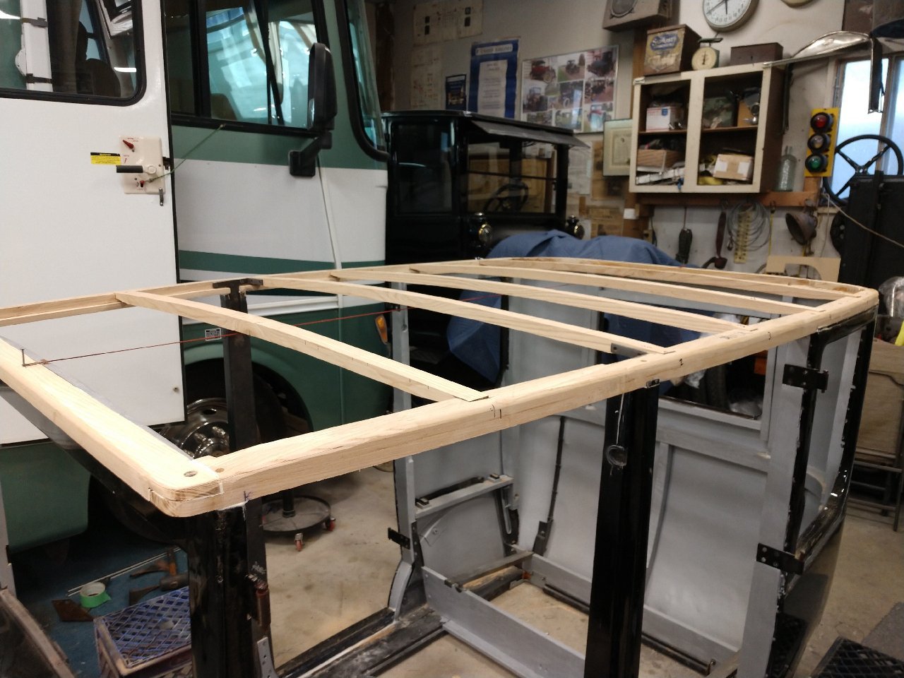

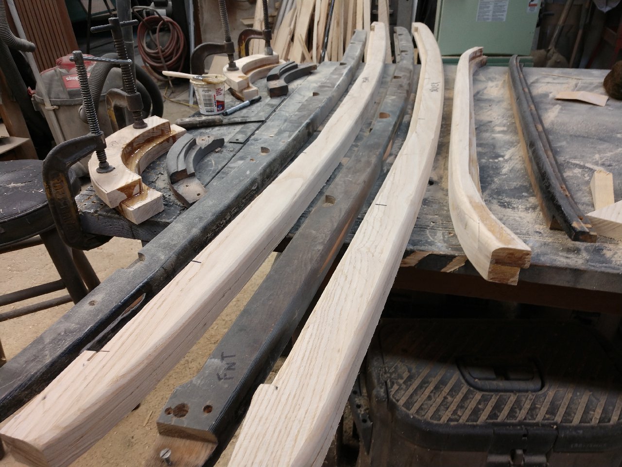

Don't give them any ideas Dallas !! LOL Working on the bow's.....we will see how it goes. :D
FordorGalore
Posts: 430
First Name: fore
Last Name: door
Post by FordorGalore » Fri Nov 13, 2020 10:39 am

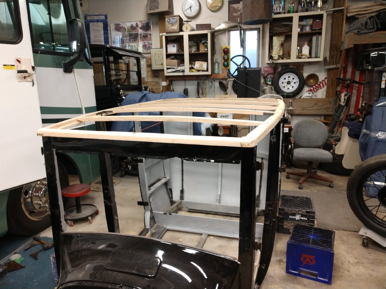

Trued, screwed and glued....she's topless no more.

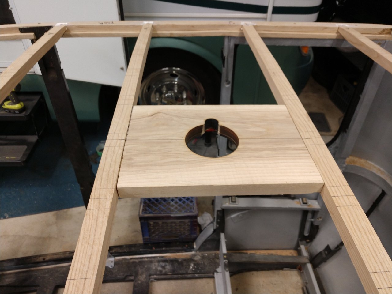

Post by FordorGalore » Fri Dec 25, 2020 2:57 pm
And more trudging .... cutting the block out for the NH setup.

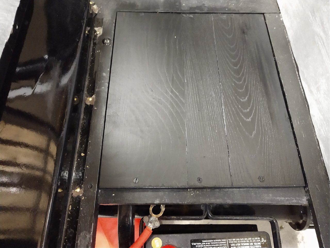

Post by FordorGalore » Fri Dec 25, 2020 2:58 pm
Trudging even further....Floorboards.
Posts: 1685
Last Name: Seth
Post by perry kete » Fri Dec 25, 2020 4:43 pm
It's all the little things that take the most time that nobody sees when your done.
Posts: 7298
Post by Allan » Fri Dec 25, 2020 7:54 pm
Don, I love the way the grain still shows through on the black floorboards. This is much better than the artificial look achieved by priming, sanding and top coating with high gloss enamel.
Post by FordorGalore » Fri Jan 08, 2021 2:34 pm
I do too Allan! Well its the third week of wet sanding. Looking for volunteers ... will train if needed. LOL
Post by Rich Eagle » Fri Jan 08, 2021 2:45 pm
Thanks for taking all the photos. It's interesting to me after going through my '25 Tudor years ago. So many similarities and so many differences.
