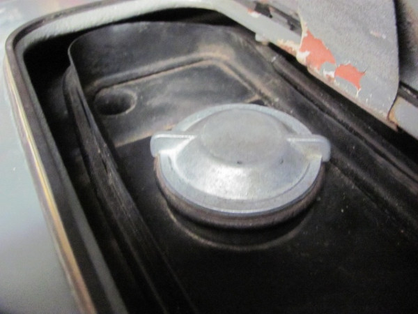

The gas cap on my 1927 coupe is "stuck". Any suggestions on how to remove it? What kind of wrench?

Picture of it would help rather than to assume what cap you have. It could be cross threaded as opposed to gummed up

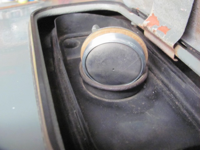

There is a paper “gas cap gasket” that goes on the cap. 90% of its job is preventing the cap from “taking a set” and getting stuck.

Good question! On all 26-27's except fordors, it is not necessary to tighten the cap, any more than snug. Even if it vibrates loose, the tray around the filler would catch it before it fell and was lost. As said above, a gasket should be used under the cap. If the cap is an original 26-27 cap, they were cast pot metal which tends to swell over time and if you haven't removed it in years, perhaps that is what happened and is preventing it. Its doubtful if it is an original pot metal cap that it has swelled over a short period of time, so if it hasn't been long since you last removed it, swelling shouldn't be the problem. I have an original cap for my 27 coupe and keep it for originality, but regularly use a brass repro cap because they won't swell.

Standard cap?

If it is anything like my original cowl tank setup, the cap is down in a trough surrounded by a berm to catch any spillage and allow the spillage to flow out a drain. My original cap (I think it is aluminum) has a raised rigid handle going across from one side to the other. Try taking a set of channel-lock pliers and position the grips downward and position each grip on each side of the rigid handle on the gas cap then turn counterclockwise. If it does not budge, gently tap the cap all around with a hammer. Jim Patrick

The cap has no bearing on the body style! That cap was introduced sometime in 1924 I believe, and as noted above is pot metal. If you aren't careful, you will break the ears off of it. If you do, there are very good looking reproductions that look the same.

The late gas cap has the metal cover or baffle underside to prevent gas seepage up the vent holes.
