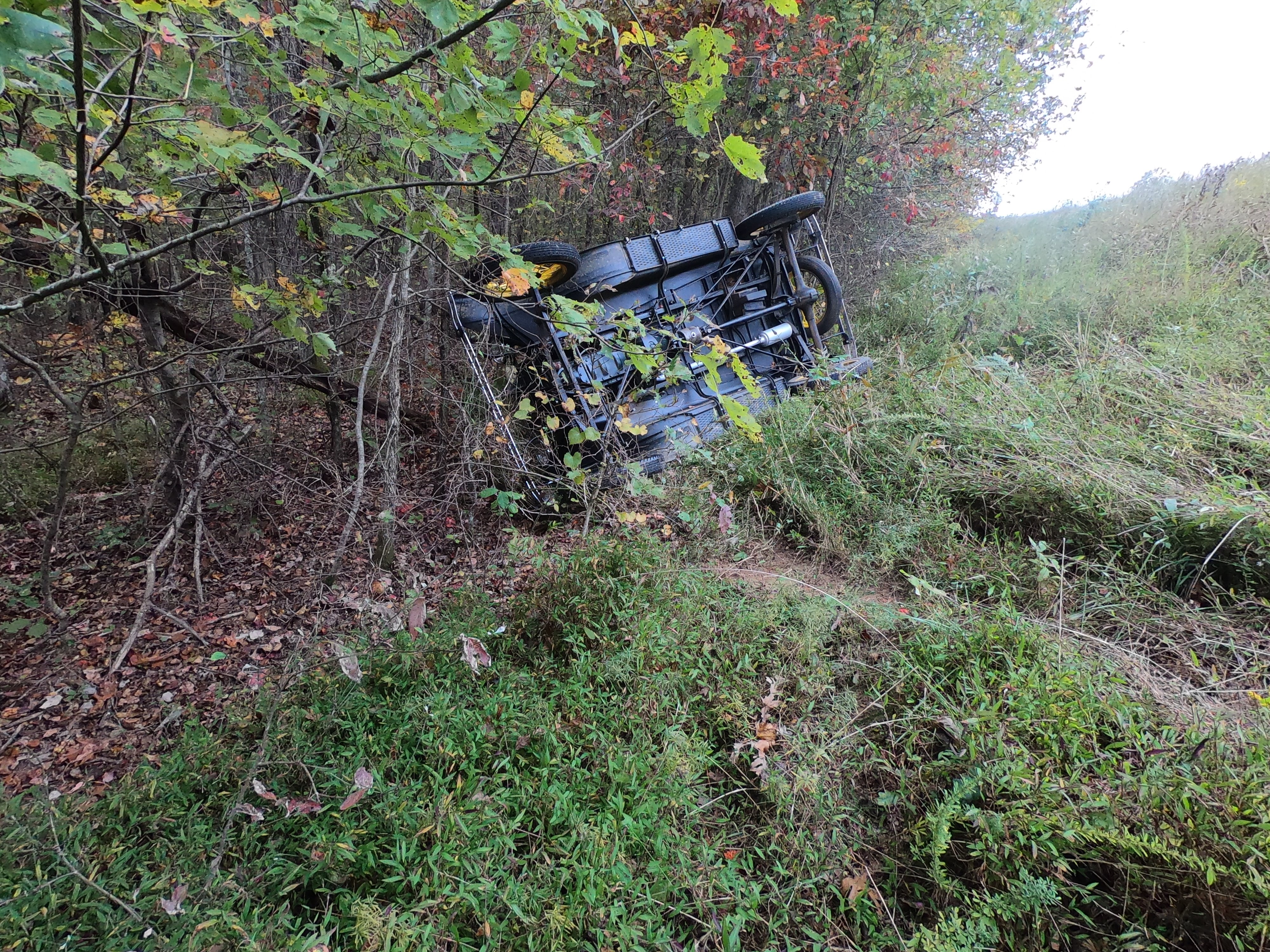

Let me say this first. My wife and I are not hurt. My wife is sore from the crash but seems OK. This week while on tour, I messed up. While climbing a hill in Warford 3 (overdrive) I let my speed get too low and missed a shift into Warford 2. The Rockies did not hold in reverse (I knew that they do not work in reverse) But because I was also in Warford neutral the Ford brake does not work either. I could not get the Warford (new KC Warford) back in gear, maybe because I had already started to roll back ???. But in the few seconds of trying to get it back in gear and also I saw another T behind me and turning to miss it. I lost my window of time to pull the hand brake. In aprox 5 to 7 seconds from the missed shift I was already headed down a steep embankment in a hard turn. then sliding sideways down the embankment and flipping over at the bottom. The person behind me said the whole event happened in seconds. Im not saying Im the best T driver in the world, but I have years of experience behind the wheel of a T. So even an experienced driver can screw up. We were very lucky the T landed in the trees or it would have flipped all the way over. So everyone please stay aware of what can happen when out driving....

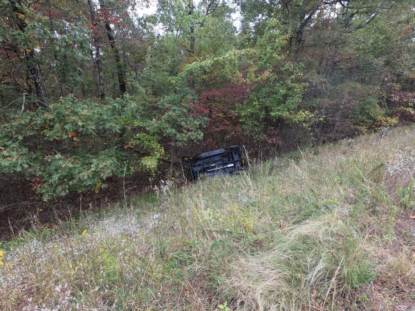

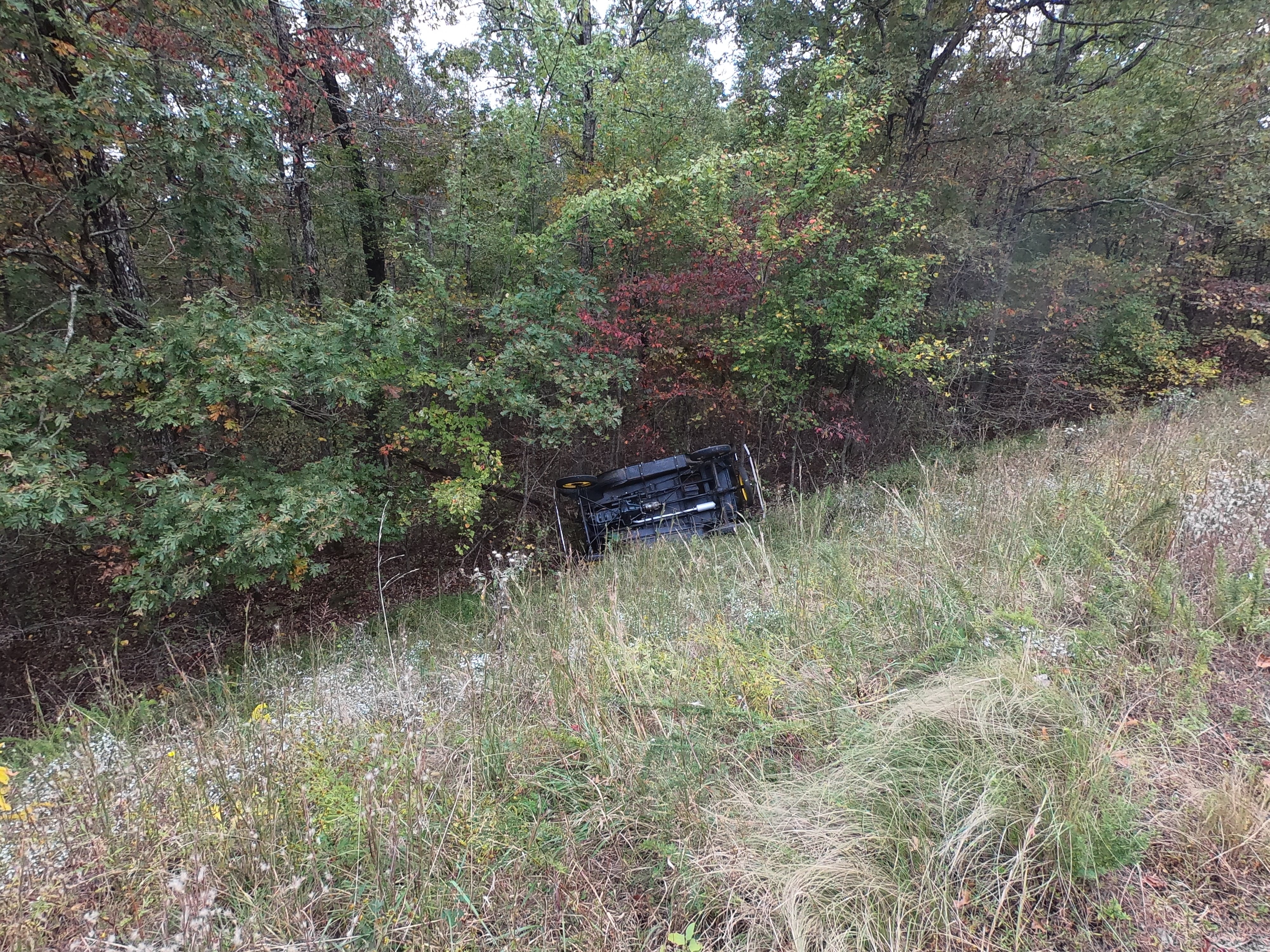

I am happy that you and your wife survived without major damage. The picture of the car looks like the top has the worst damage. How does the other side look? It shouldn't be too hard to fix. I would suggest you put on some brakes which work both directions or practice grabbing the parking brake quickly whenever there is an emergency.

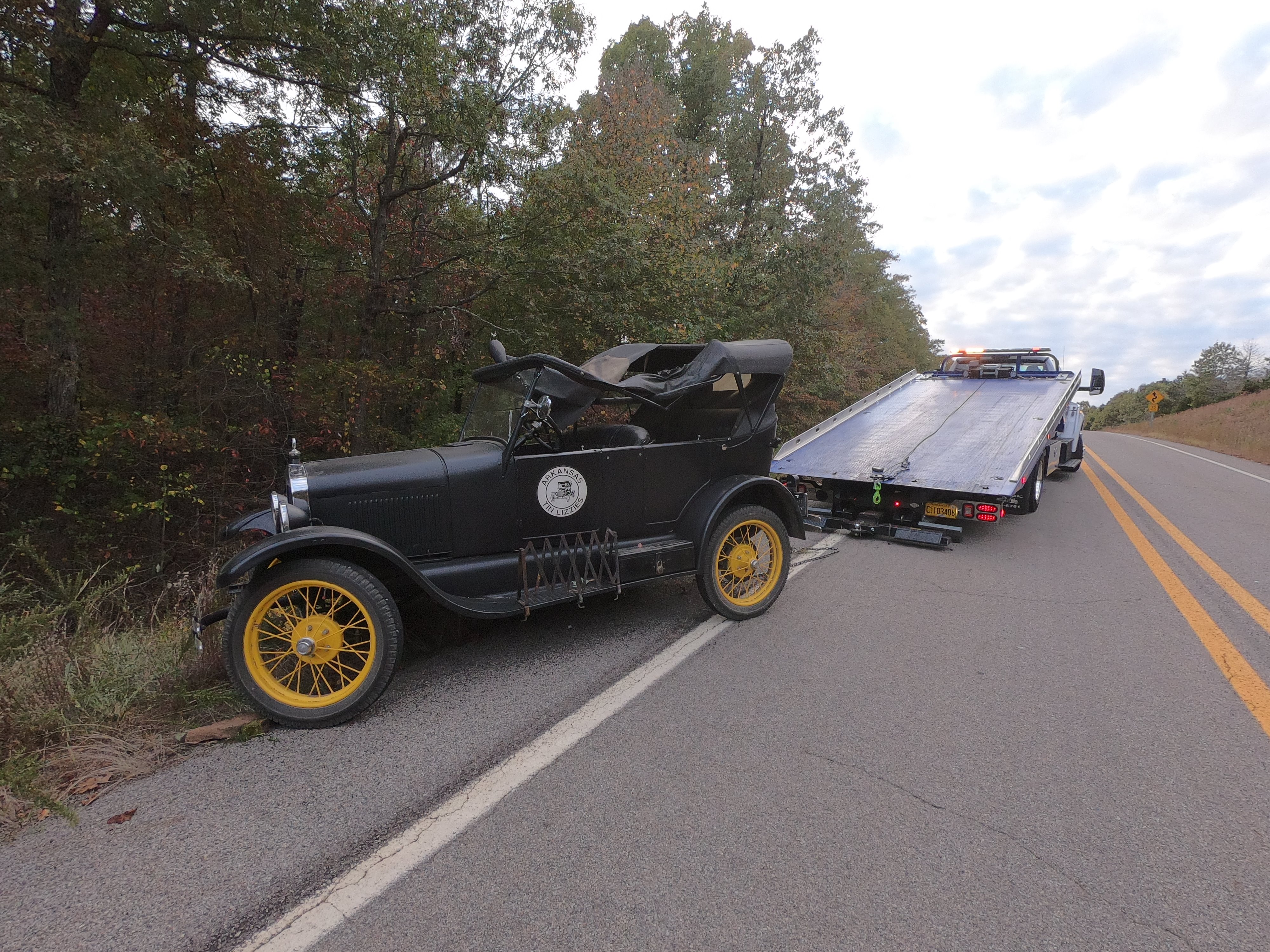

The car survived remarkably well. The top material is destroyed, but I was needing a new top anyway. It only bent the rear driver side top iron in the solid steel part .It will be a easy fix. The wood top bows are also OK. It slightly flattened out the passenger side front fender lip. A little dolly work will fix it. Both windshield posts broke at the bottom. They will be a simple fix. It also broke the bottom windshield glass. There is a small dent at the passenger side top saddle area where it came to rest leaning on a tree. It also is a simple fix as it is not even creased, so It should just pop back out.
The car was on its side about three hours. It takes a loooooooong time for help to arrive in the hills. In that time it lost 2 quarts oil, 2 gallons of water, and maybe a 1/2 gallon of gasoline. When we got home the next day I re-filled everything and the car started up immediately. It did not even turn over more than 1 to 2 revolutions. It took about 5 minutes to burn off the smoke cloud :) :) And it still "free starts" 99% of the time.
The car was fully packed for the tour. There was 2 extra gas jugs, water jug, extra oil, box of camera stuff, ice chest, and food baskets, and under the seats were tools, jack's, extra band sets, carburetor, boxes of spark plugs, set of coils, ECT, ECT, ECT. When the car turned over the seats and rear floorboards fell out along with all the other stuff. We were on bottom and all the "stuff" landed on and around us. It was an interesting ride.

Mike, I folded down the top, If I put the top boot on you could not even tell Its torn up. If the glass had not broken in the bottom windshield I could have continued on the tour. But Kathy says we "WILL" have disc brakes before we go again. :) :). There is nothing mechanically wrong with the car. I was afraid it may have bent the two passenger side wheels but they are OK. I think the ground was soft enough to not stress the wheels as we slid sideways.

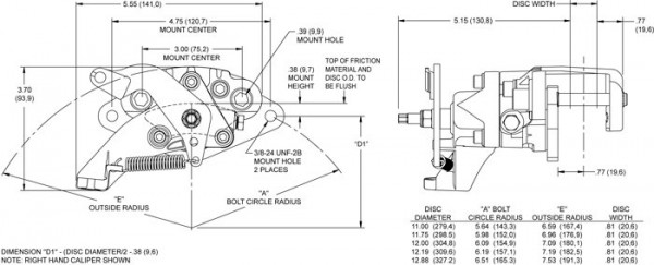

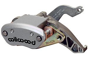

Wilwood has mechanical calipers as well. I am looking into better braking on my race car.
