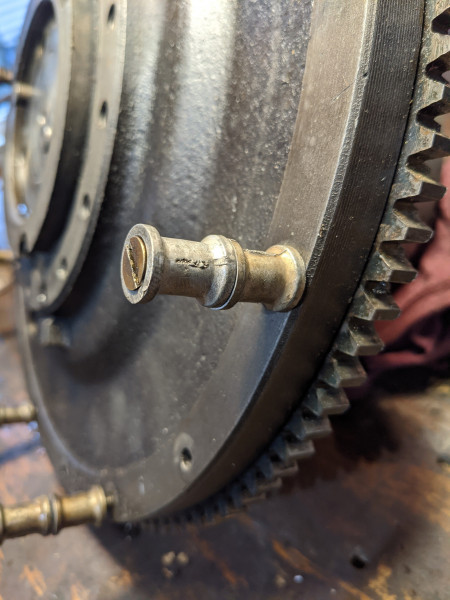

Re: Magnets Vs. Slingers
Am I setting myself up for failure here? Do the brass screws fail without the magnets?
R/Roger.
R/Roger.
- Posts: 5435
"Am I setting myself up for failure here?" I am going to say yes. There is a LOT of centrifugal force being applied esp when you add the oil to the mix. Even just having the teeth on the ring gear moves a lot of oil around.
- Posts: 1170
- First Name: Adrian
- Last Name: Whiteman
I would say "yes".
Are the screws new? Don't use old ones which will be work hardened (brittle) and prone to break.
Having them sit out like that will flex them, which will make them brittle which will break them. There is a LOT of force when they spin around and smack into the oil.
Slingers (as much as I don't like them) would be a better solution.
Maybe fold up your own slingers using heavier gauge steel plate?
Cheers, Adrian
Cheers, Adrian

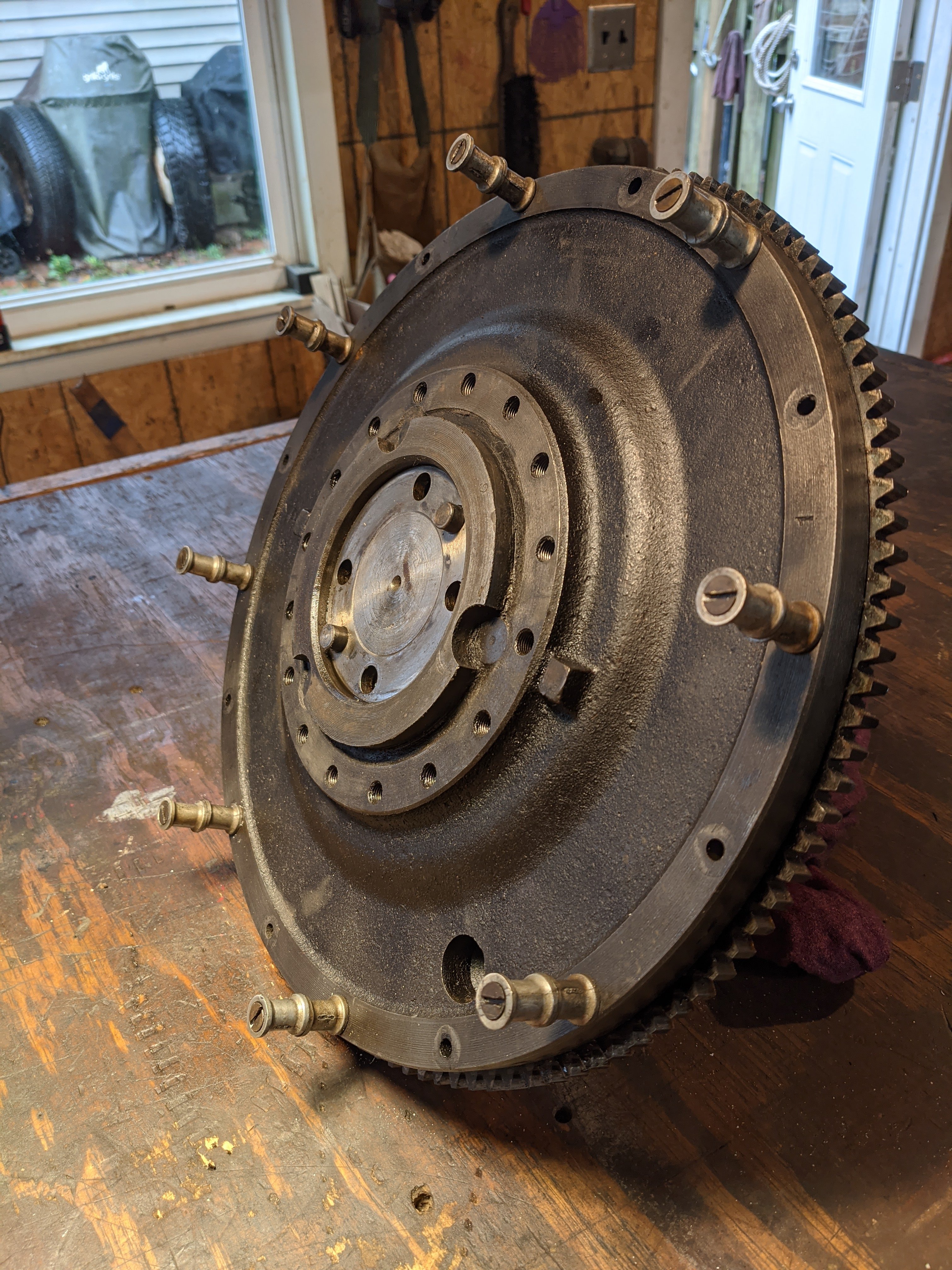

- Posts: 265
- Last Name: Kelly
- Location: Noxon MT
I'm using spools on my speedster, only one per screw. They move a lot of oil.

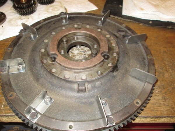

- Posts: 5340
These are the only slingers I install - manufactured by a well respected T guy !!!
