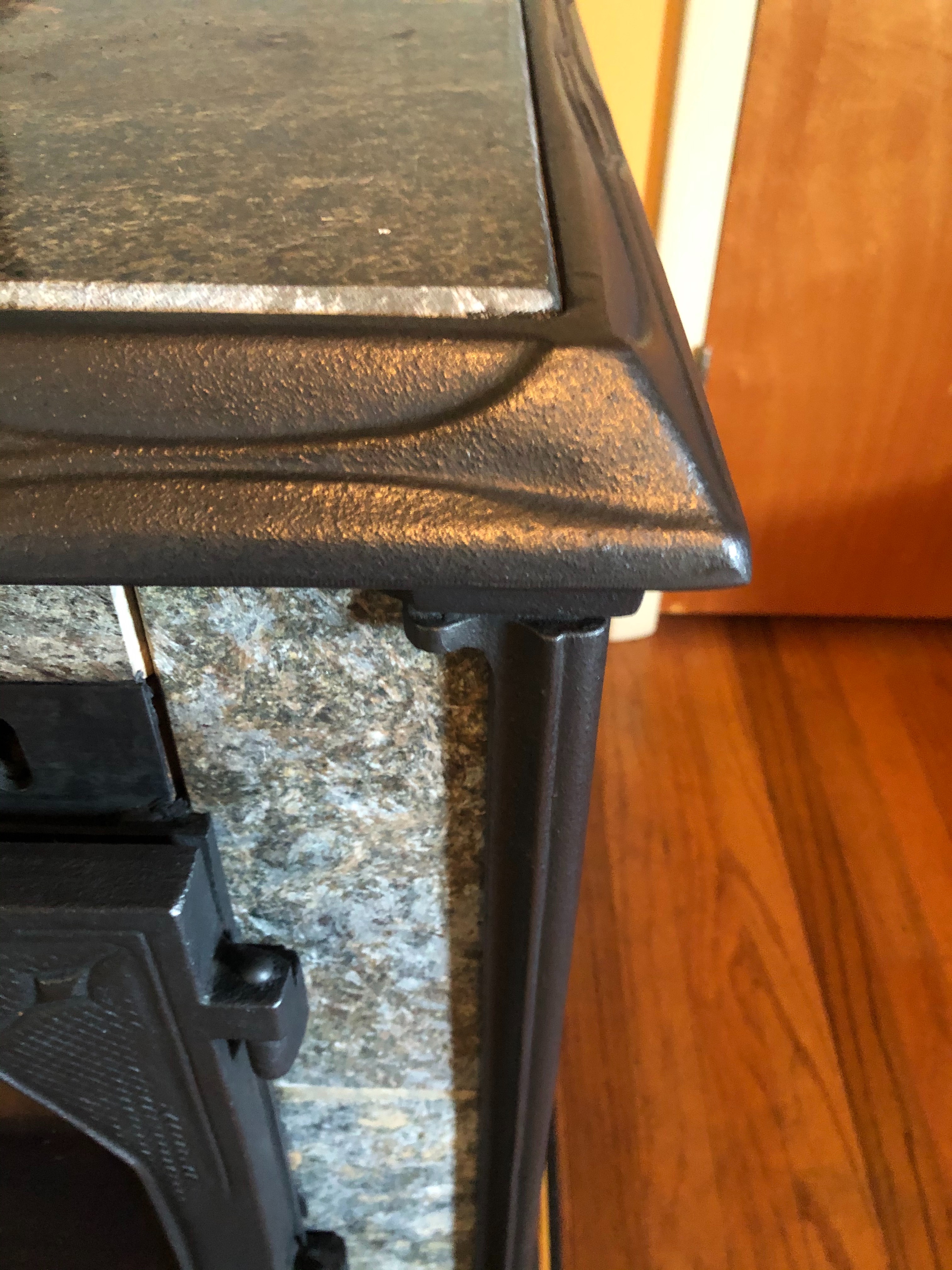

If anyone is wanting a natural looking cast iron engine, hogs head, etc, here is the ticket! After cleaning the engine very well, no paint and minimal surface rust, apply cold with a tooth brush, let sit for about 20 minutes, polish off with a cloth. Big WOW factor! You can apply more than one coat. Holds up well and easy to touch up too. Works best on cast iron and small bare steel pieces. Takes about two tubes for a complete engine/transmission.

Nice Hearthstone...
