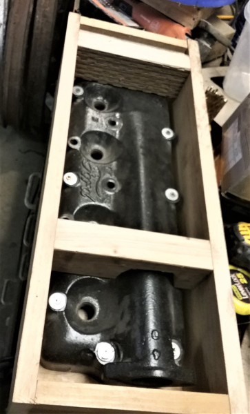

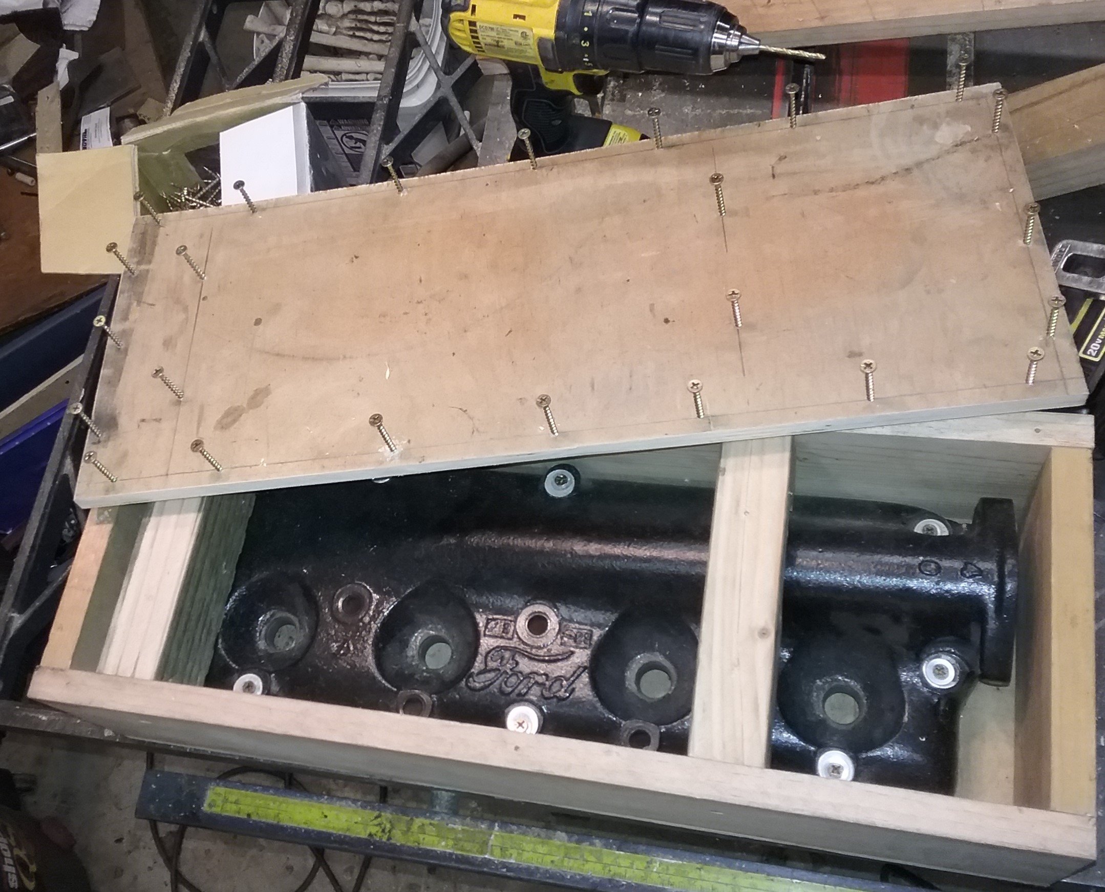

Topic author - Posts: 1466
- First Name: Keith
- Last Name: Townsend
- Location: Gresham, Orygun
Re: shipping a head
I actually thought about using foam...
Since this head is going halfway around the world, I chose an all-wood construction.
The head is attached to bottom of the crate and there is 1/4" clearance on all surrounding points.
Thank you for all the suggestions and input.
Keith
Keith
